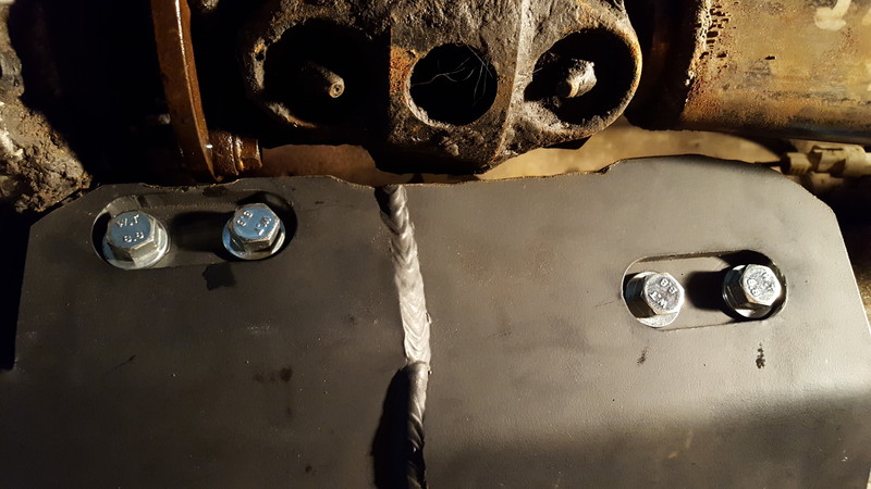

Hey guys. I'm getting ready for another trip to the offroad park in November so I clearanced the skid plate.
It amazed me that I had to trim so much to clear the double cardan because supposedly this was specifically designed for this exact application. How the company screwed that up I dont know, and they never replied to my email about its failings. I also put washers on the bolts because it didn't even come with those. So hey front range offroad, you failed here.
I also discovered that my drivers front hub does not actually unlock when set in "free". So thats neat.

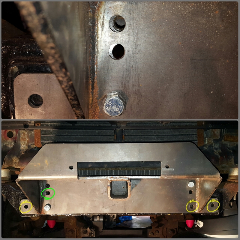

A few of the passenger side holes don't line up on my winch plate.
The yellow circled holes line up and I just gotta buy the bolts. The green one I'm going to drill it out and run a bolt with a nut on the back. That should do it!

The frame tab behind the green circle is pretty easily bent. A couple bumps with a hammer should be able to move it to right behind the hole in the bumper.
Old Oct 13, 2016 | 03:28 AM
  #205
crashburnoveride's Avatar
Joined: Dec 2012
Posts: 613
Likes: 33
From: Lincoln, NE
I already have a frame brace welded onto it thats 1/4"
That changes things. You could also slot out the hole in the bumper. Saves you from having to reach around and hold then nut every time you install or remove the bumper. Just ideas.
I like that idea. Just use a big washer. Thanks for your input.

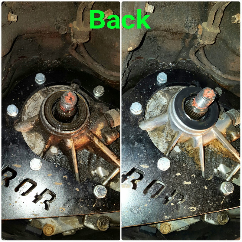

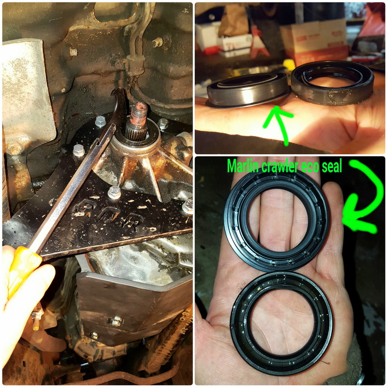

Putting two marlin crawler HD eco seals into the transfer case. Its definitely beefier. Also putting rtv behind the washer and nut.

FYI, If doing rear seal dont drain the tcase. If doing front seal just drain it first.

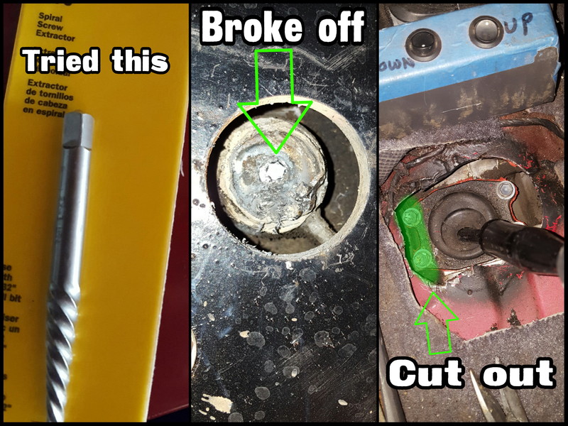

Never used a bolt extractor before. Didnt work. Probably needed a bigger one.
So I ended up cutting out more sheet metal around the shifter to access the bolts without lowering the transfer case. I just used tin snips and a drill bit. So i put oil in from the top and will worry about the fill bolt later. On to the next item which is drivers hub rebuild.

Originally Posted by Gizler00
I can help you get that off easy.
How? I tried welding a nut to it. Couldn't get it to stick. The bolt may be alloy??
I believe it is an alloy drain plug.
I have some other extracting methods. I can see if I can slip away over a weekend or one night during the week, when the wifes back in town, to come give you a hand.

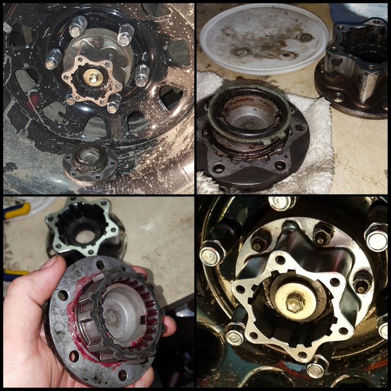

Rebuilding the hub.
So I took it out for a test drive. No weird noises or anything. I think that bad sound I heard last time was the front square driveshaft clanking because it has some play in it.
