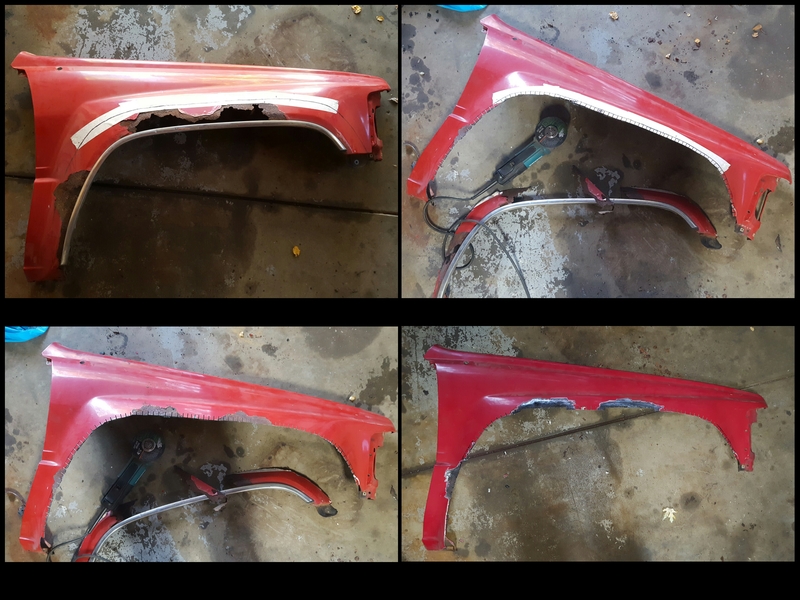

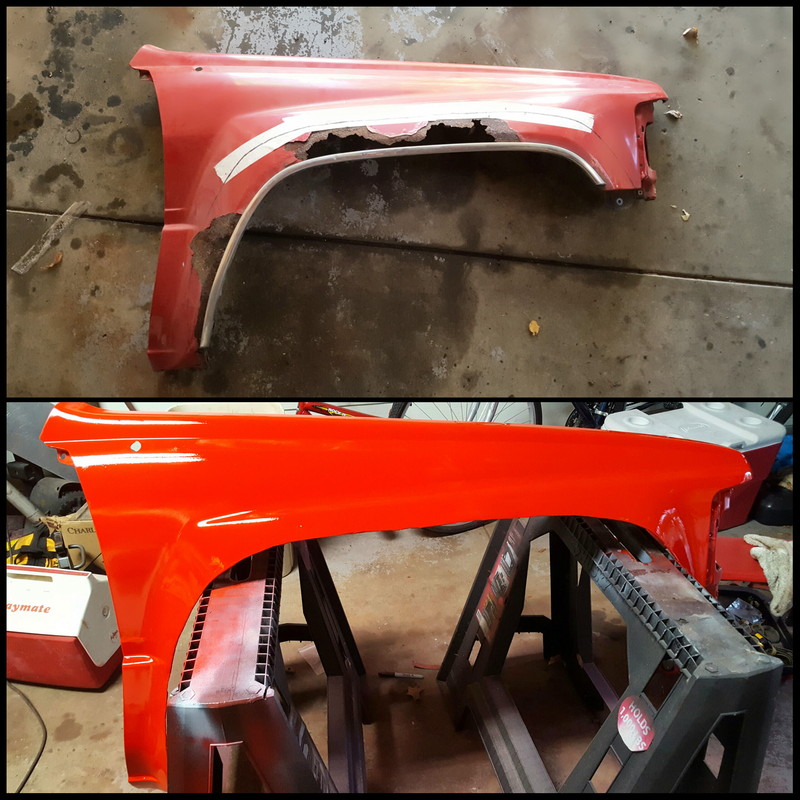

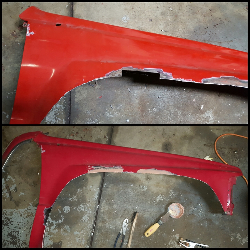

The rust was too bad in a spot so I decided to just cut it out. Welded in a new piece, and slapped some bondo on it.

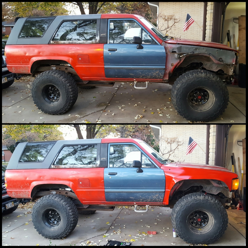

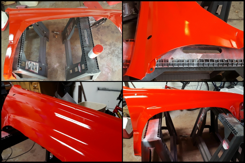

Fender finishing
And before and after
Putting it back on today after work. Can't wait to see it!

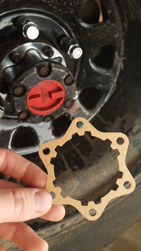

Alright well I threw a gasket on the drivers hub because it had none when I pulled it apart. Its just a cool lookin gasket.

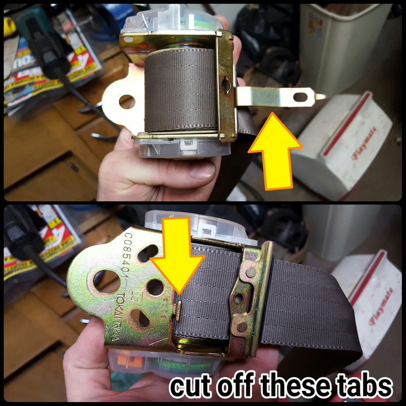

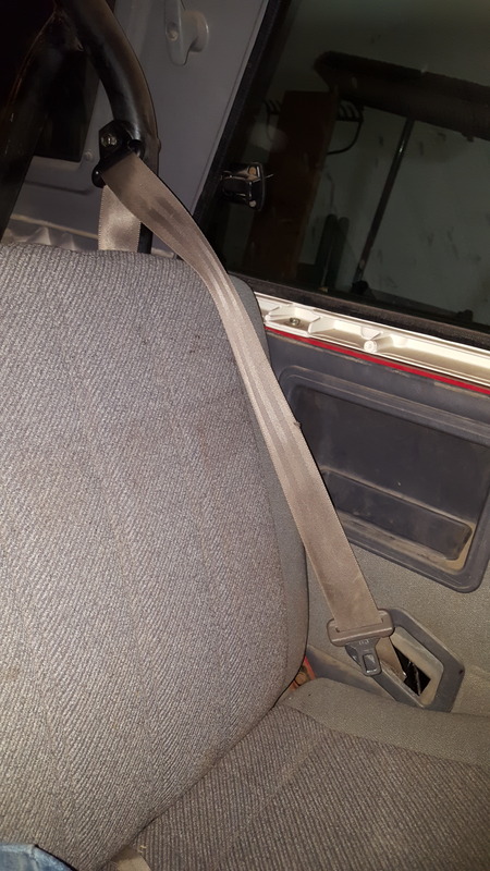

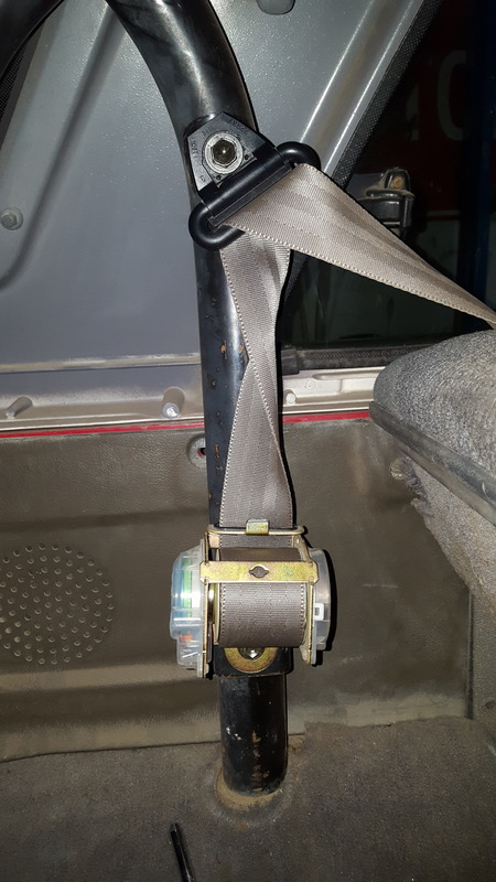

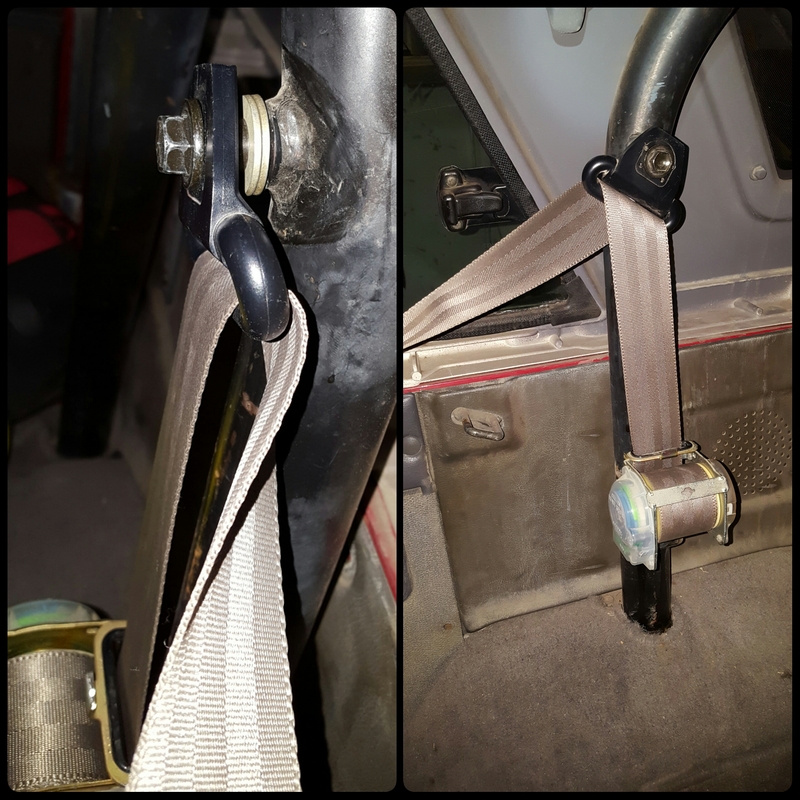

I went and grabbed some seat belts out of a 3rd gen 4runner back seat today. It was the best I could find. They require some modification.
And it has to twist here for it to work. I didn't notice any problems from this.
I'm sure my passengers will appreciate them this next weekend!

Nice work on the Seat belts. I also did this mod on my old 1st gen. I was able to strap in the boys car seats. I really miss that.

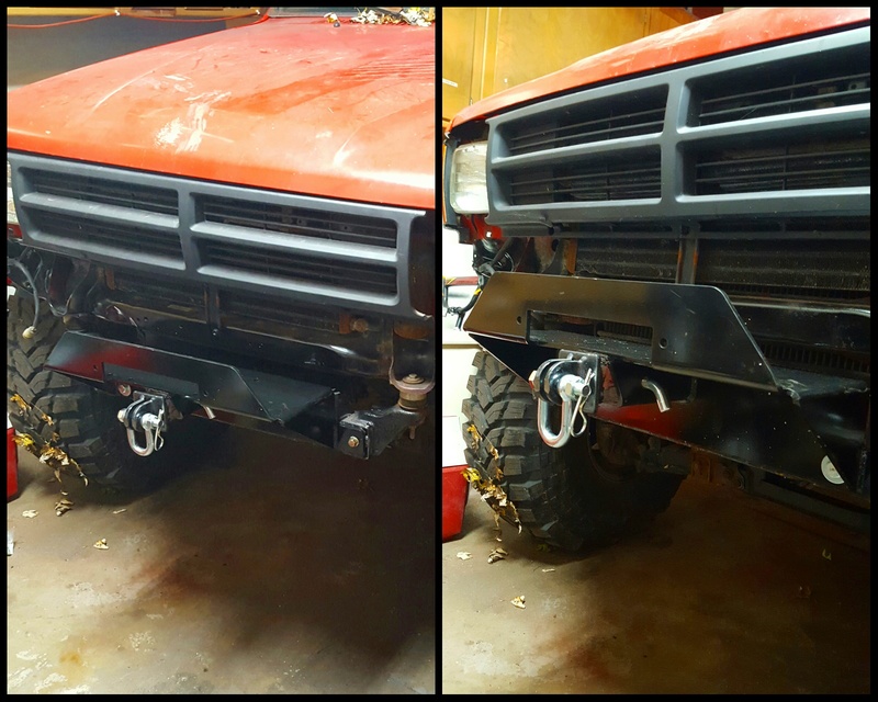

Trail-gear winch plate, harbor freight D ring hitch. Nothing is ever as easy as it should be. The reciever on the bumper plate is exactly 2" ID so literally no 2" hitch actually fits inside. I had to grind down the hitch and hammer it in. Then I had to grind down the hitch pin too!! Ridiculous. But its in.

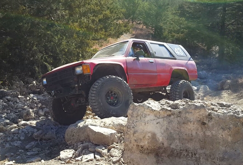

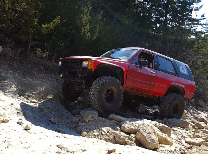

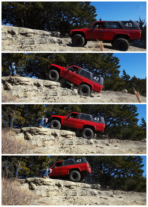

Had a great time this weekend!
I made it up every obstacle I attempted. Pretty easily actually. It was awesome!

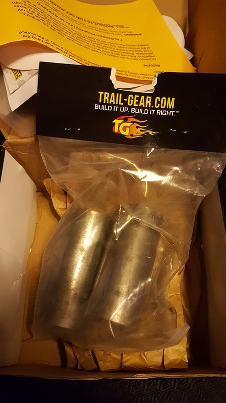

Well my frame tubes for the sas came in. Slowly piecing my sas parts together.

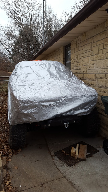

And I bought a waterproof cover for the ol gal for storing it this winter. It's already parked and battery pulled out.

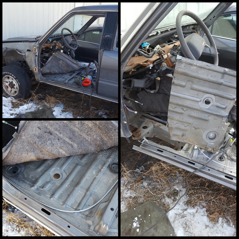

might have to start working on the 4runner again!
