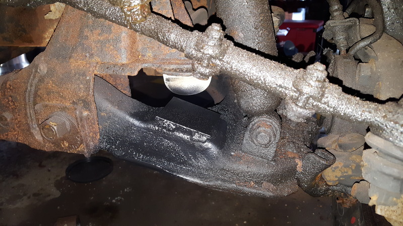

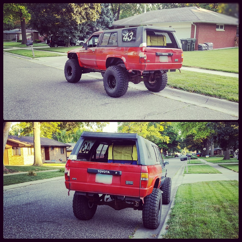

Ok, gizler said this wasn't too redneck to post so here you have it. I went the ez quick route to adjust my bump stops in an effort to eliminate tire contacting the body. Welded 1/4" plates to the A arms.
I figured I'm doing a sas in the future anyways so F it. I just wanna wheel. 😃

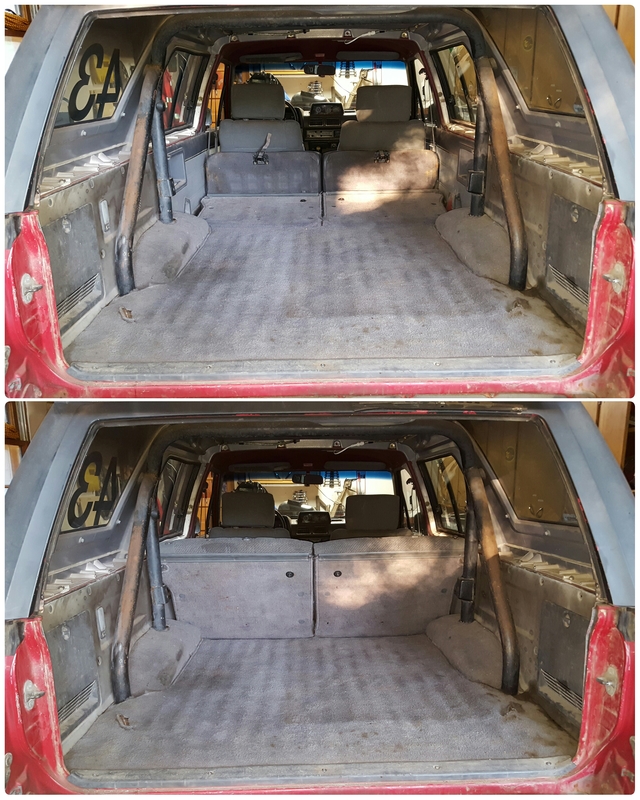

I should make it this time. Interior put back in.

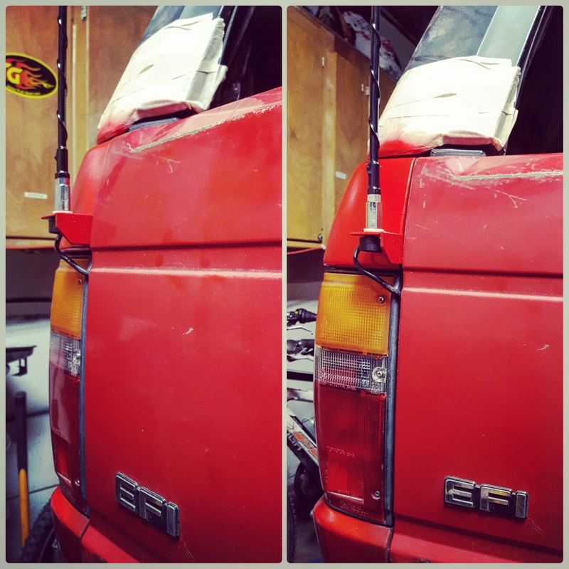

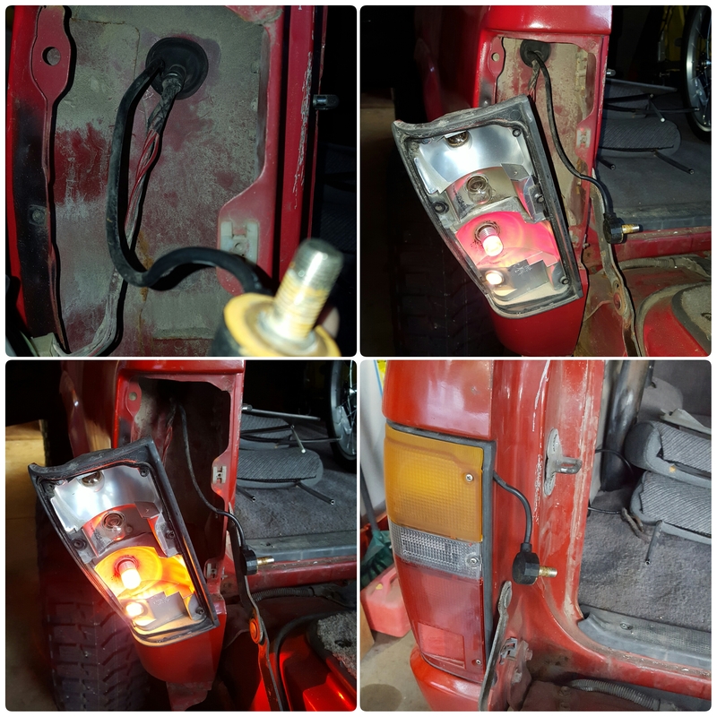

Going to be mounting the cb whip out back. Routed the wire theough the driver tail light area. Going to fab a mount.

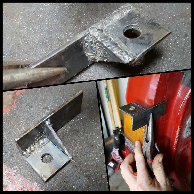

Made the mount today. Needs some red paint.

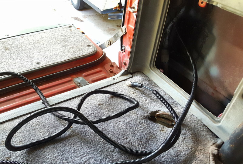

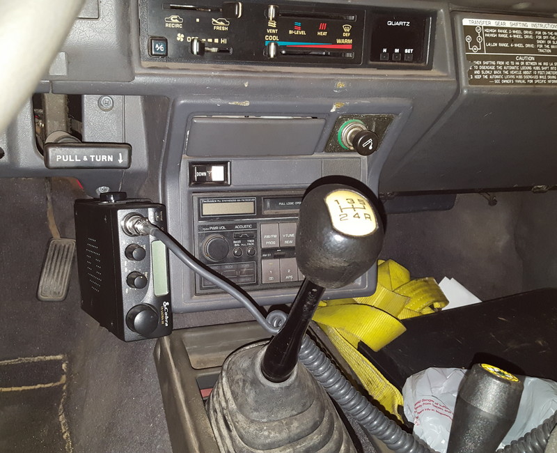

The CB wire was barely too short so I got an extension yesterday. It runs behind the wall panel to the front seat, under the carpet, then to the dash.

Put the radio in the same spot I had it in the pickup.

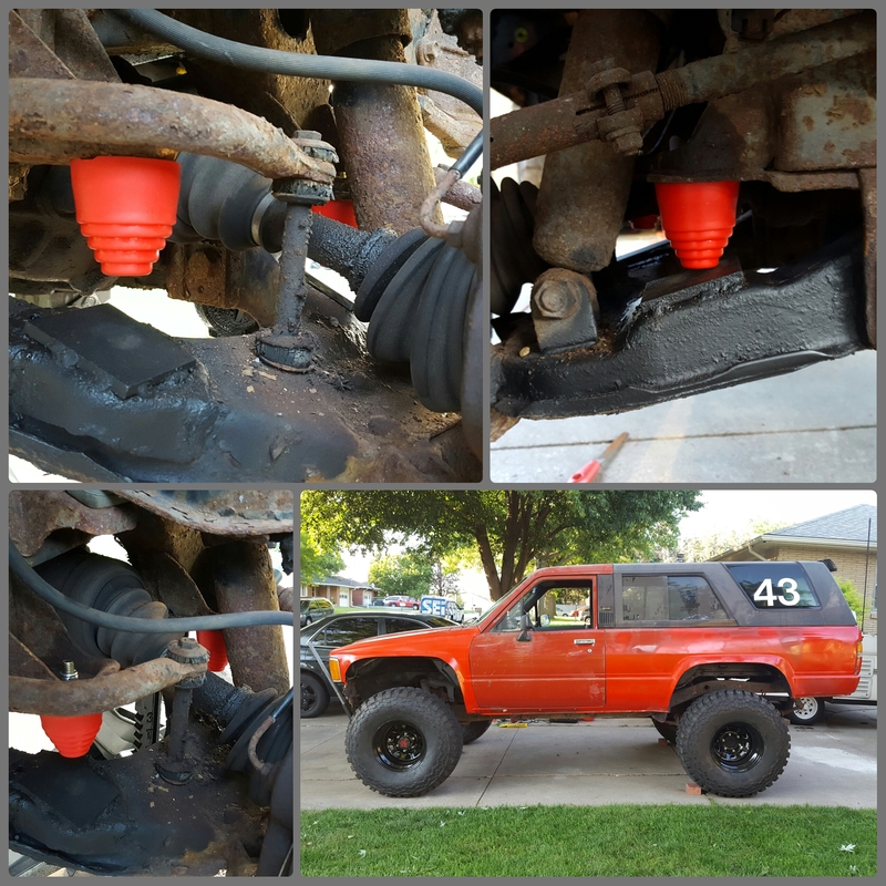

I cranked the torsion bars, and installed the new bump stops. It basically rides on them but on the test drive it felt fine and i didnt rub a tire. So we'll see how it wheels.
It definitely looks more leveled out. Just gotta finish the front square driveshaft and I'm good to go. Always more little things to do, I wouldn't mind doing the quick disconnect door mod if I find time. But this trip is happening!!

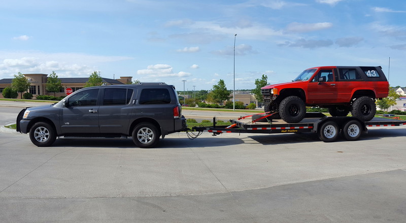

I finished my square front driveshaft and am all ready to go. Here's some pics of it on the trailer, the good side and the ugly side. Haha.
So we'll see what breaks! Super excited to see what it can do.

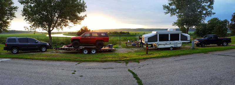

The campsite. Beautiful view.

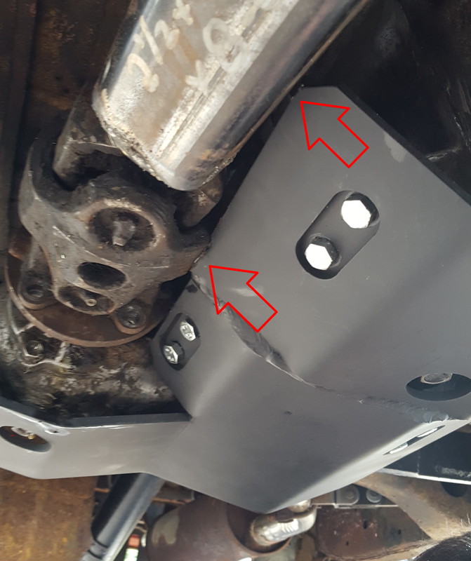

We pulled into the ORV parking lot, and went to bolt in my square front driveshaft. Did all the bolts but the top two on the xfr case end. So i moved it a bit to access them easier. Thats when I heard a terrible loud sound. The DS hit the xfr case skid plate bad. Two spots.
The impact must've damaged the output seal on the xfr case cuz oil was dripping out. It was a slow drip but I wasn't sure of the extent of the damage, and we hadn't even got it off the trailer yet!! I ended up pulling the skid plate and running it like that for the day. So I didnt get too crazy on the rock ledges. But I did a little.

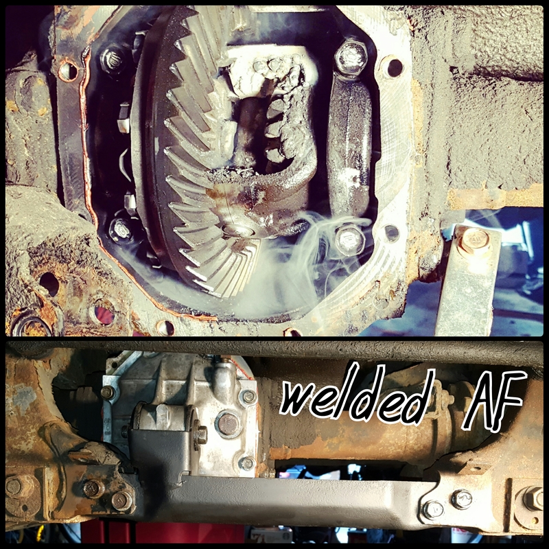

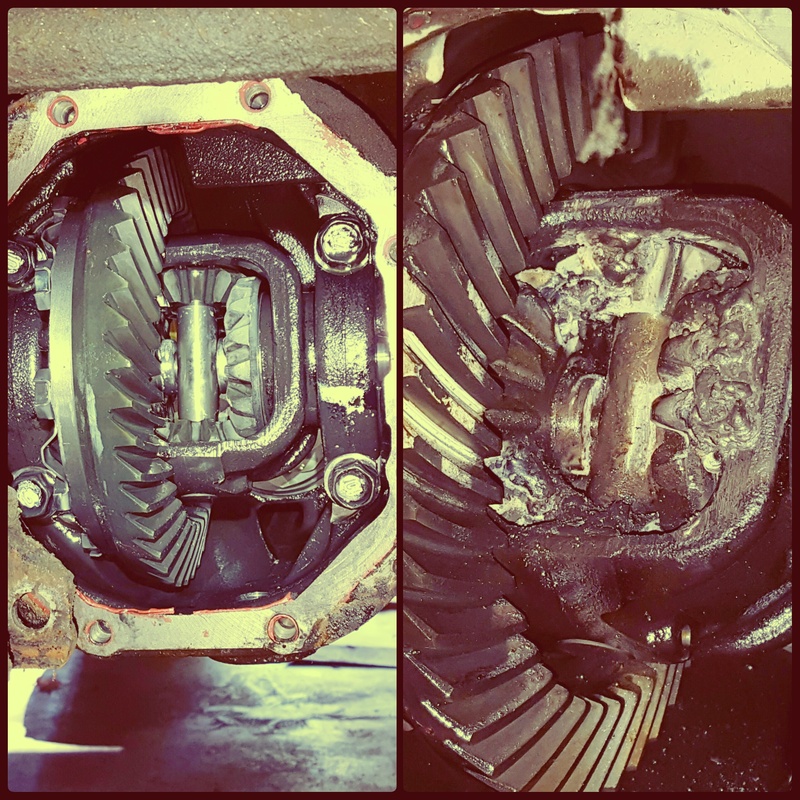

Since I'm doing a sas eventually I didn't want to spend money on a locker or even a spool. So welding the front diff it was. I think I'm going to weld in there even more before I close it back up. Getting weld into the spider gears isn't easy!

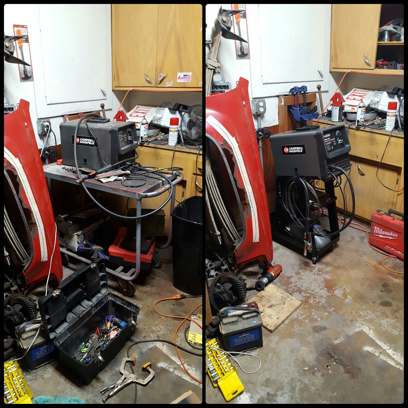

Well my garage is tiny. So I bought a new welder cart to save space. It has a smaller footprint and is easier to move around.

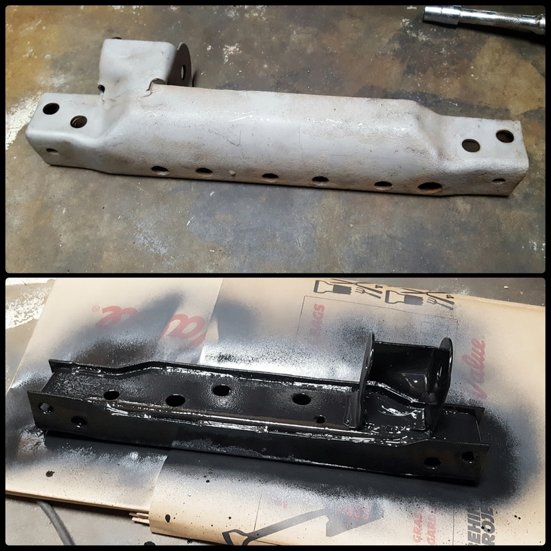

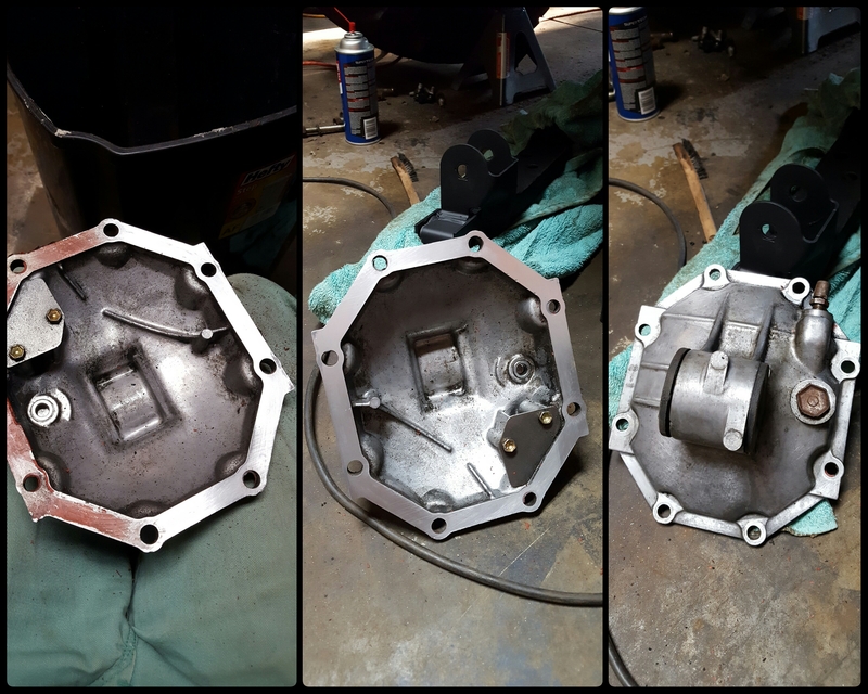

Spent $35 on it and I'm happy with it. Now... to organize the rest, lol. The front diff cover and cross member were caked in an eighth inch of a mud/oil mix like the transfer case was if you remember back when I had that out. So I cleaned up the cover a bit and prepped the gasket surface.
I actually took the crossmember to work for sandblasting because of the rust too. Cleaned up nice. I want my own blast cab!!!

Project welded front COMPLETE

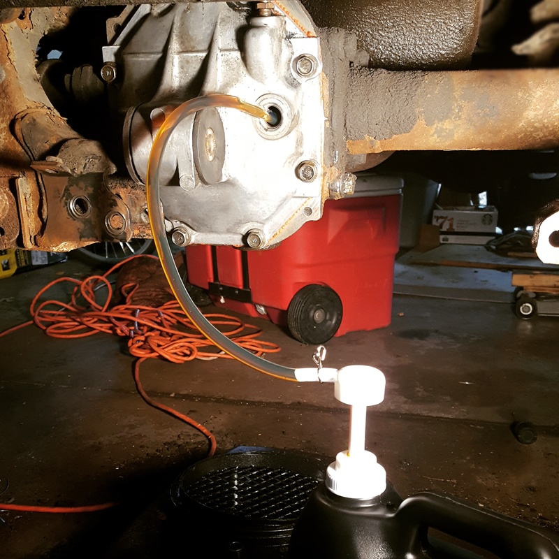

Found a bit of time to do 4runner work. Torqued the bolts and filled with oil.
I love the pump it works great. I had some trouble getting the crossmember back on and getting the diff mounting point to line up. But a pry bar and a hammer worked in the end.
I really wanna go test it out but its not licensed so my range is limited to my neighborhood. 😑 Glad I blasted and painted the cross brace and cleaned up the diff cover. Someday I want to pull the body off and restore the entire frame. Someday.... 🤔
