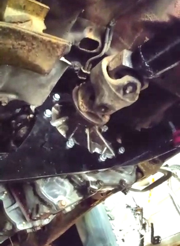

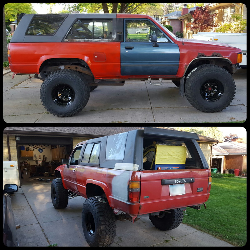

Yesterday I swapped the rear transfer case flange, bolted on the cv driveshaft, added rear diff oil, and pulled it out of the garage. Drove it around.
And here is a pic showing the tummy tuck. Once that gas tanks gone it'll be real nice.

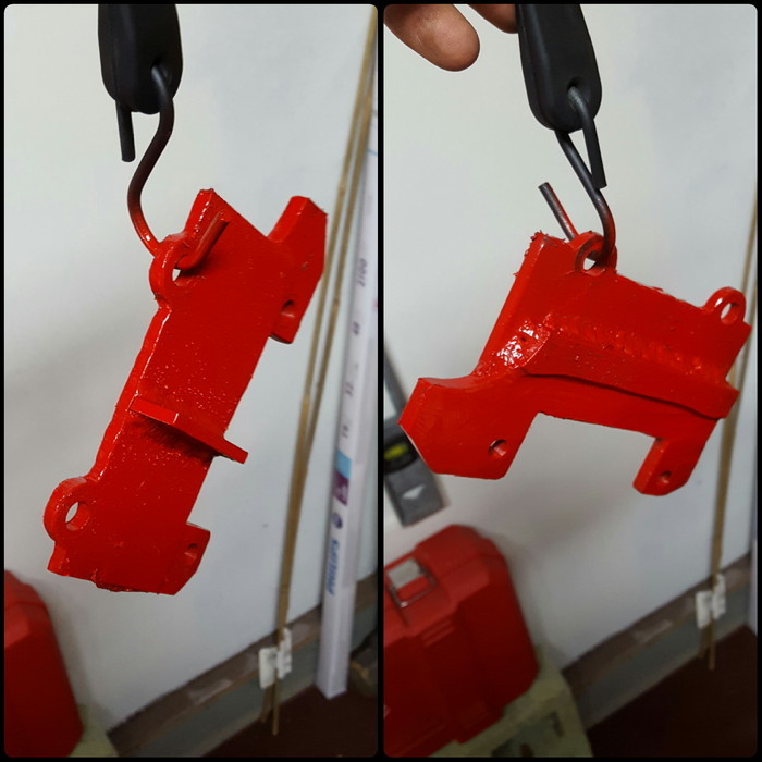

So the little test run was good. It told me the caliper brackets are still rubbing the rotors. So I'll be pulling them and doing more grinding. Maybe weld a back plate for more rigidity. It has to be bending a bit towards the rotor when it clamps down. Still some work to do before its maiden voyage.

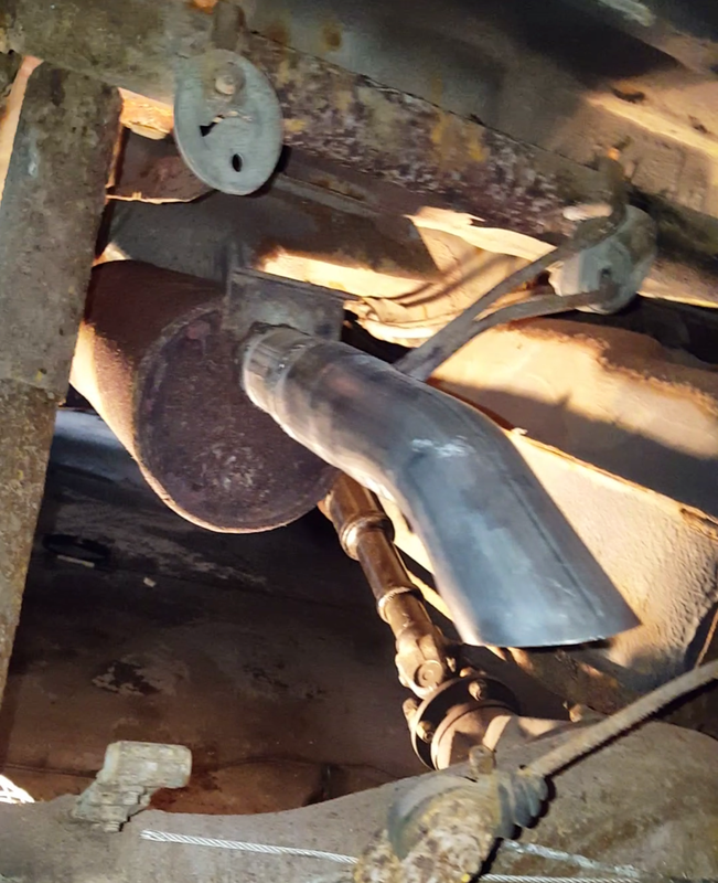

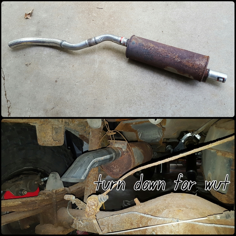

I'm just reusing the muffler the truck came with. It's rusted bad but no holes yet. It really fits in with the whole "broke dad build" theme for this rig. Put a turn down pipe on the back. I still have to put on the hangers.
It goes from the header pipe to 2" then 2.25" out the back of the muffler. I was told I cant swing hammers or use power tools anymore because the lil dude is sleeping, so I had to quit for the night. I think I breathed in too much welding fumes. Aaaaarrgh.

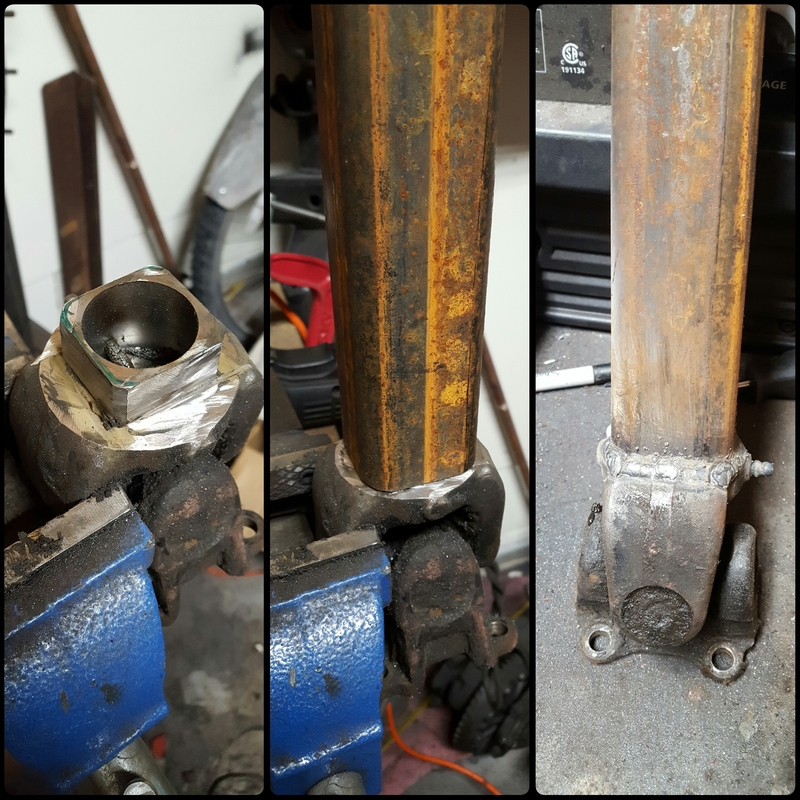

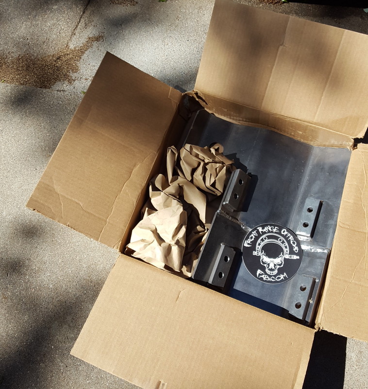

Some last minute stuff is showing up in the mail. FROR skid plate baby!

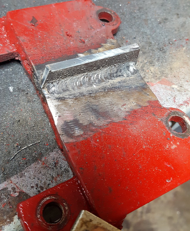

Welding on a little bracing for the brackets.
We'll see how bracket v2.0 works.
Making a square pipe fit on a round hole.
Only got one half of the driveshaft done. Sleep time!!

Very nice work Buddy.
I would like to see that Skid plate up Close! Take some measurements from it.

I hear that. I pulled off the rear calipers and surprisingly the brackets did not rub the rotor. So those are actually good. It might be the transfer case output flange cuz the dust shield part was bent. I bent it back a bit but thats probably whats rubbing.

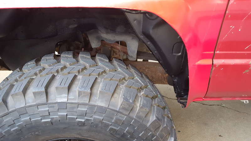

Started tinkering with the runner again. Trying to stop the tires from rubbing the body.
I cut off the pinch weld and even hammered it in a bit. The tire seems to rub on what little piece of fender I have down there at the bottom.

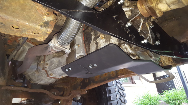

So im gonna have to trim that part more. And heres a pic of the xfr case skid plate on.
