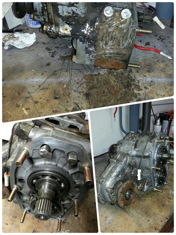

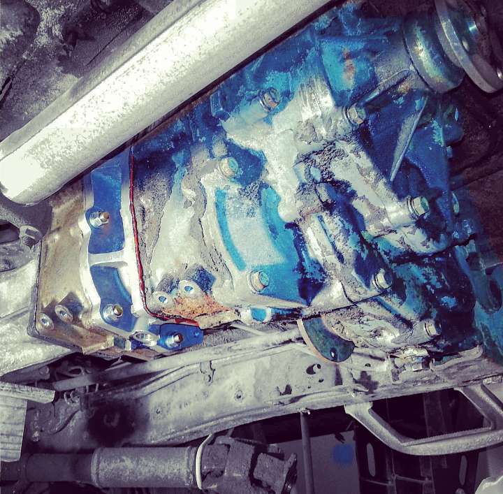

Thanks to El Niño for keeping winter temperatures at bay. It's been hitting the mid 50's and allowing me to do some runner work.

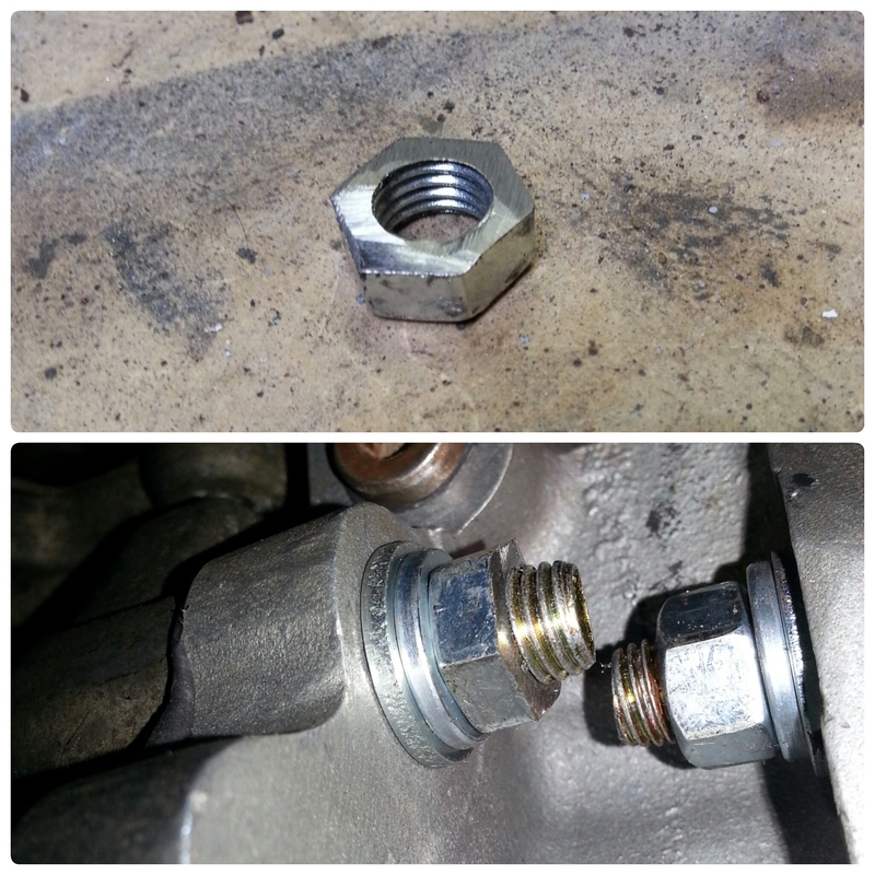

You can see the dirt and grime on this damn thing. Eventually I gave up on completely cleaning it and just bolted it on. The top drivers side studs on the adapter got in each others way. With one nut on the other wouldn't fit. Took one nut down about 1/3 and it snuck on. Might only be an issue for the 10* clocked adapter.

So its bolted up!

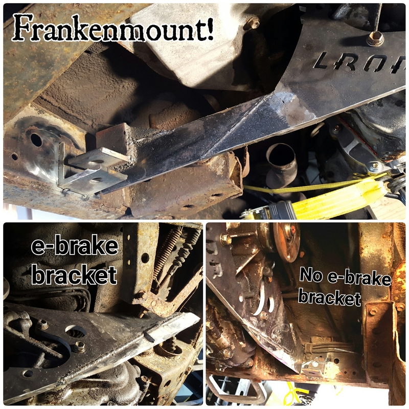

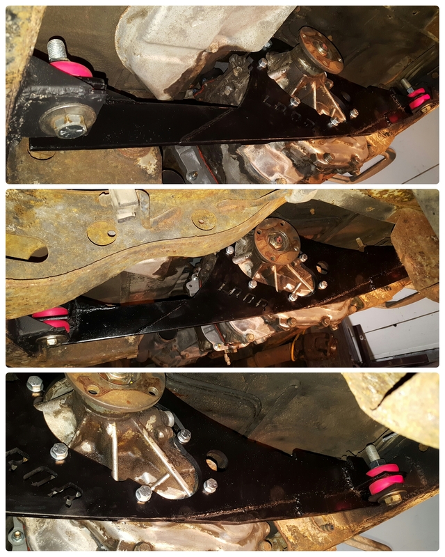

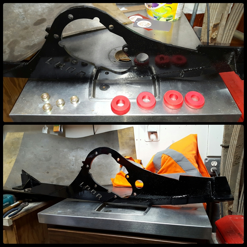

Been working on mounting the transfer case with the mounting plate i got from low range offroad. I ordered a 10 degree clocked mounting plate. I assumed thats what they sent. I was wrong. That has resulted in multiple attempts at getting this mount right. Alot of welding, cutting and re-welding has happened. And I call it the frankenmount.

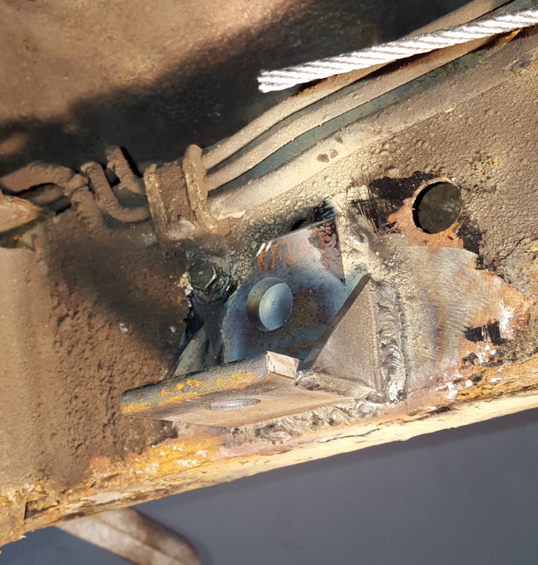

Yes its ugly. Will it break? We'll see in due time. Do I give AF at this point? Absolutely not. This style mount got in the way of my e-brake bracket. Since I'd already cut the cable at the rear axle I had no problems with cutting out the whole bracket.
Note: using this type of mount would not be easily done with just a single transfer case setup. The torsion bars would be in the way.
Since im cheap I didnt wanna pay $45 + shipping for the stupid bushings that low range offroad sells so i bought some from energy suspension for a ford (chevy? Dont remember) transfer case. Uses 5/8 bolts. Should work fine and cost $22.

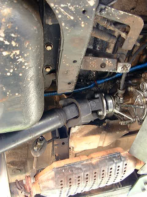

The next issue after the mounts totally done (still needs braced) is the "horsecollar" being in the way of my driveshaft. This guy on pirate (boogerwelds) just cut his out in the middle.
Not sure if i should do that or just notch it. BW claims it hasn't had ill effects. Thoughts?

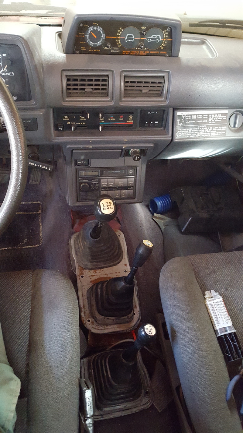

Thanks man. I got done daydreaming and modified the rear shifter. Cut up a big bolt and welded it on to accommodate the angle.

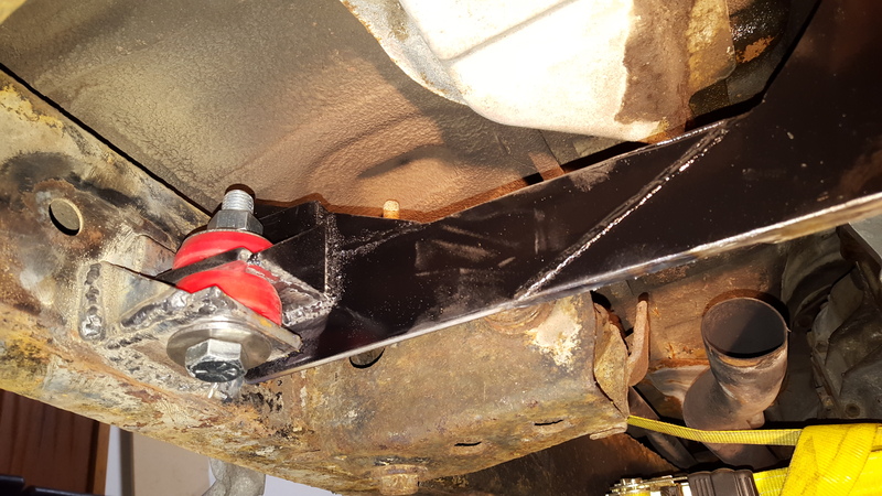

Passenger side frame mount.

Frankenmount one coat of paint.
So what are your exhaust plans?
Looks like it won't clear
Old Mar 25, 2016 | 05:16 AM
  #94
crashburnoveride's Avatar
Joined: Dec 2012
Posts: 613
Likes: 33
From: Lincoln, NE
There is room above the mount for the exhaust to go over. Might just not look like it in the pic.

So I think I decided I'll cut the horsecollar crossmember in half so the driveshaft can clear. Then probably after a few wheeling trips I'll do a ford gas tank swap in the spare tire location. That will then allow me to put in a new crossmember back where the stock tank previously was. I'm buying an open 4.10 diff on monday for the future sas. Slowly collecting parts...

Nice work Pat! I love the twin sticks!
