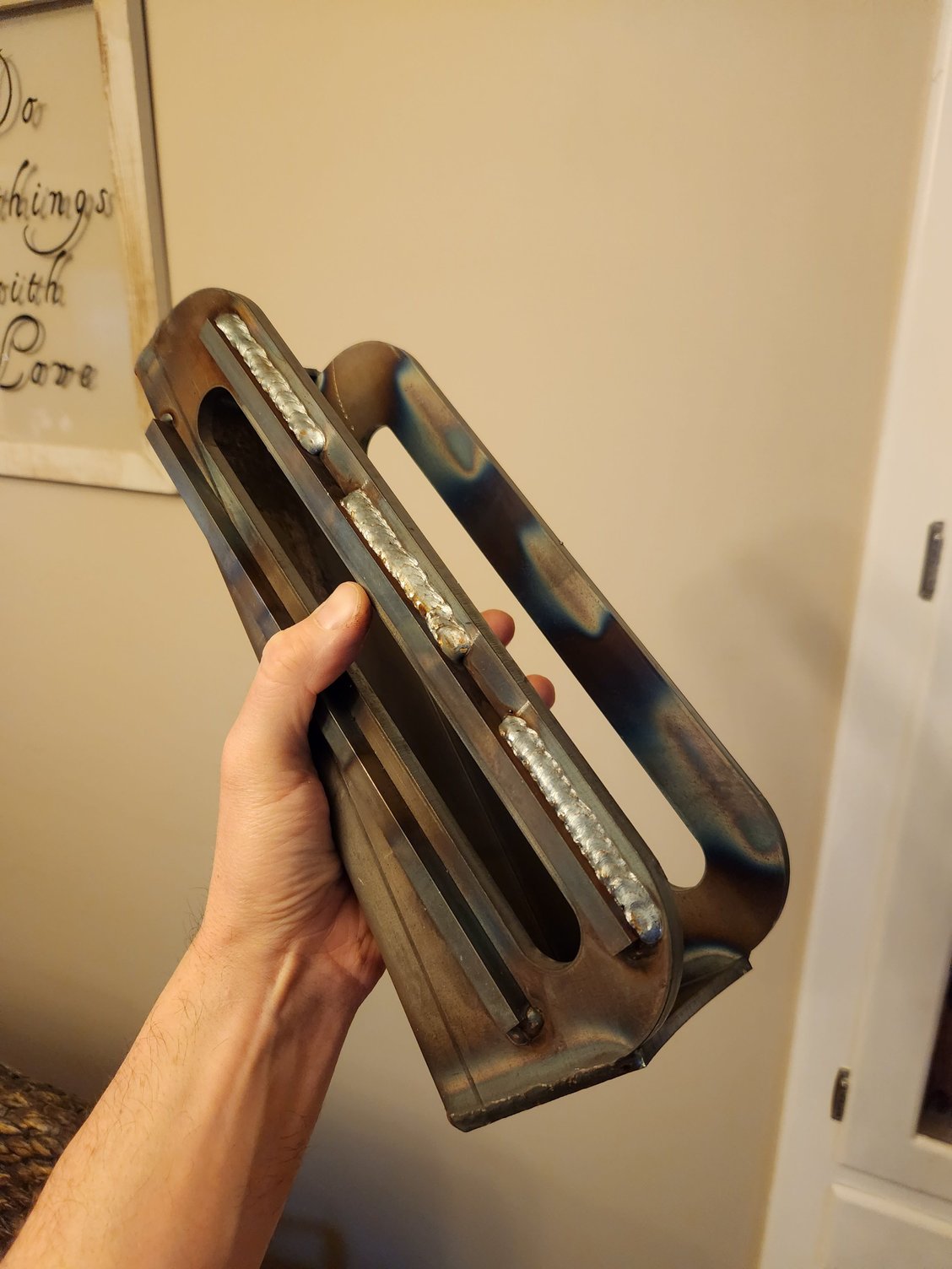

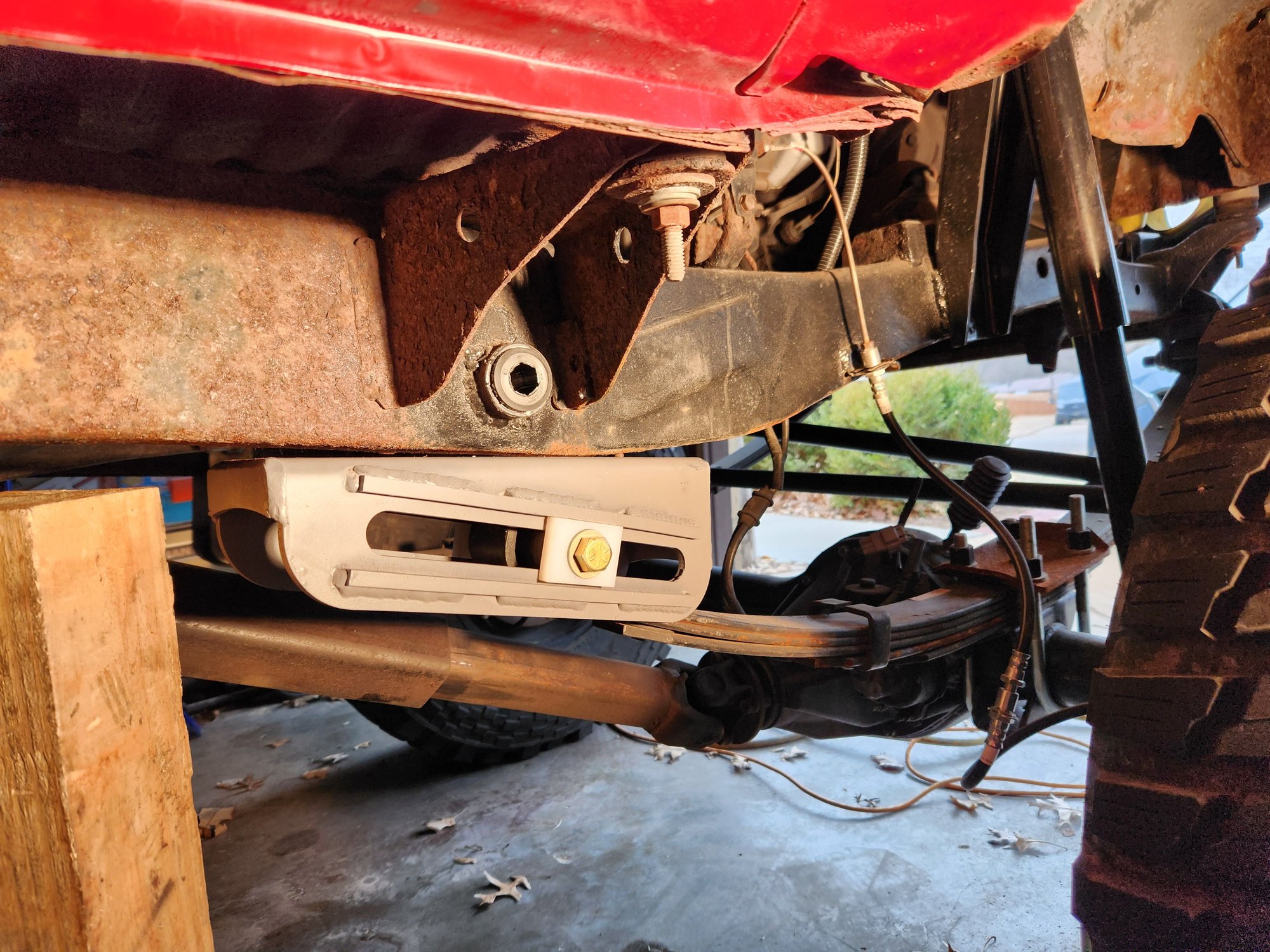

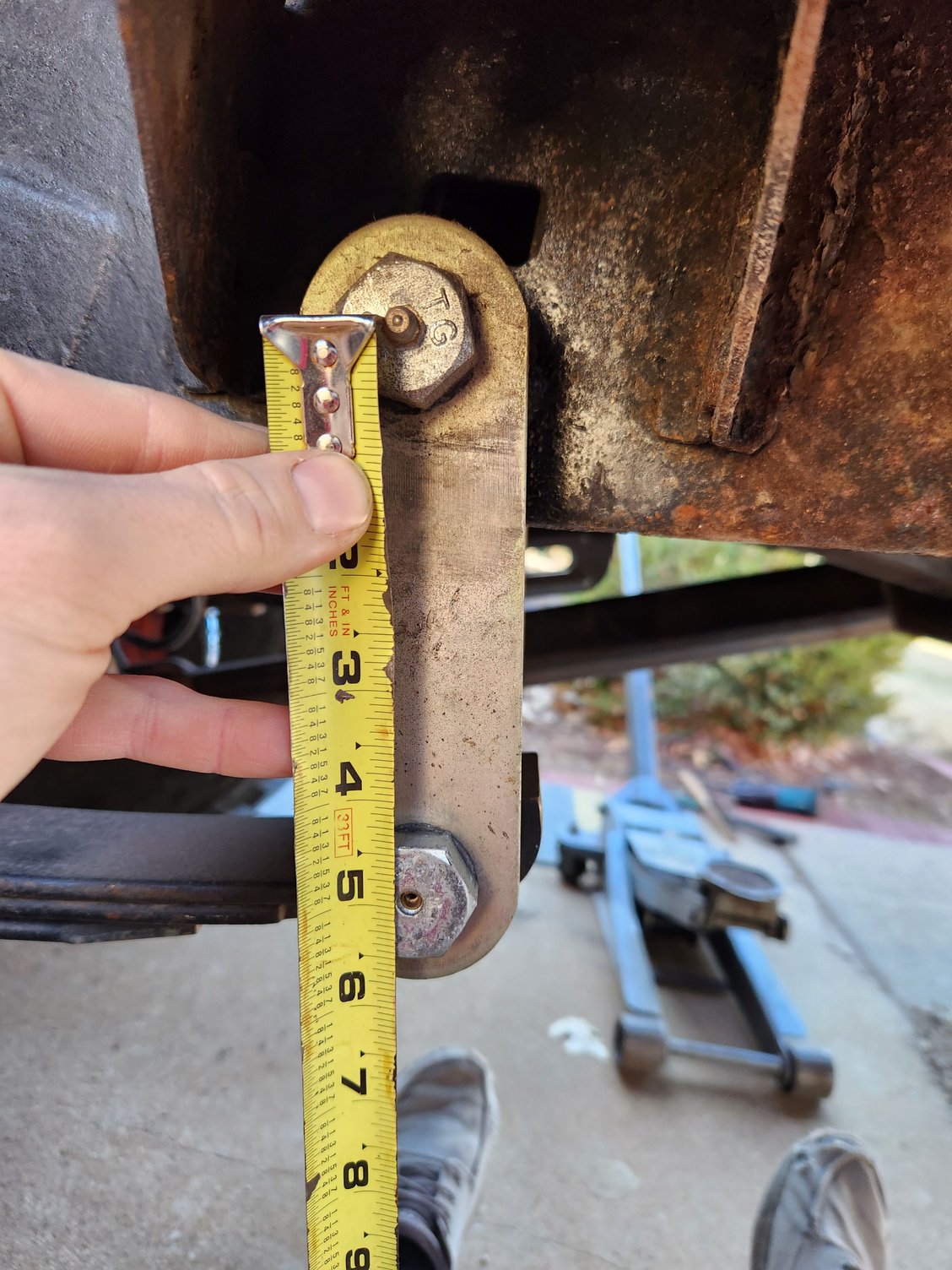

Leaf spring slider boxes
Look what I bought.
In an effort to soften this ride and also why not be different than your everyday sas'd toyota, I am trying out these slider boxes. I slapped some paint on em and started working on the install.
That's where I got stuck. The bolts that came with these are 9/16" and the bushings in the springs take a 3/4" bolt I believe. That's what trailgear uses right? My caliper said it was .715" not .75" soooo...? I went to 2 hardware stores looking for a metal sleeve bushing with no luck. So I bought some online. Waiting on those now. I hope these are exactly what I needed!

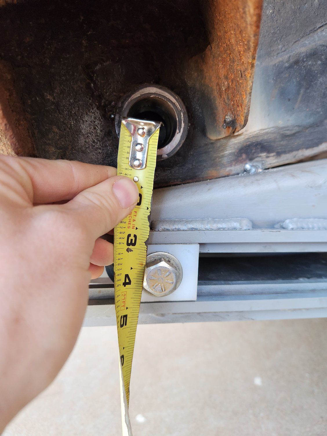

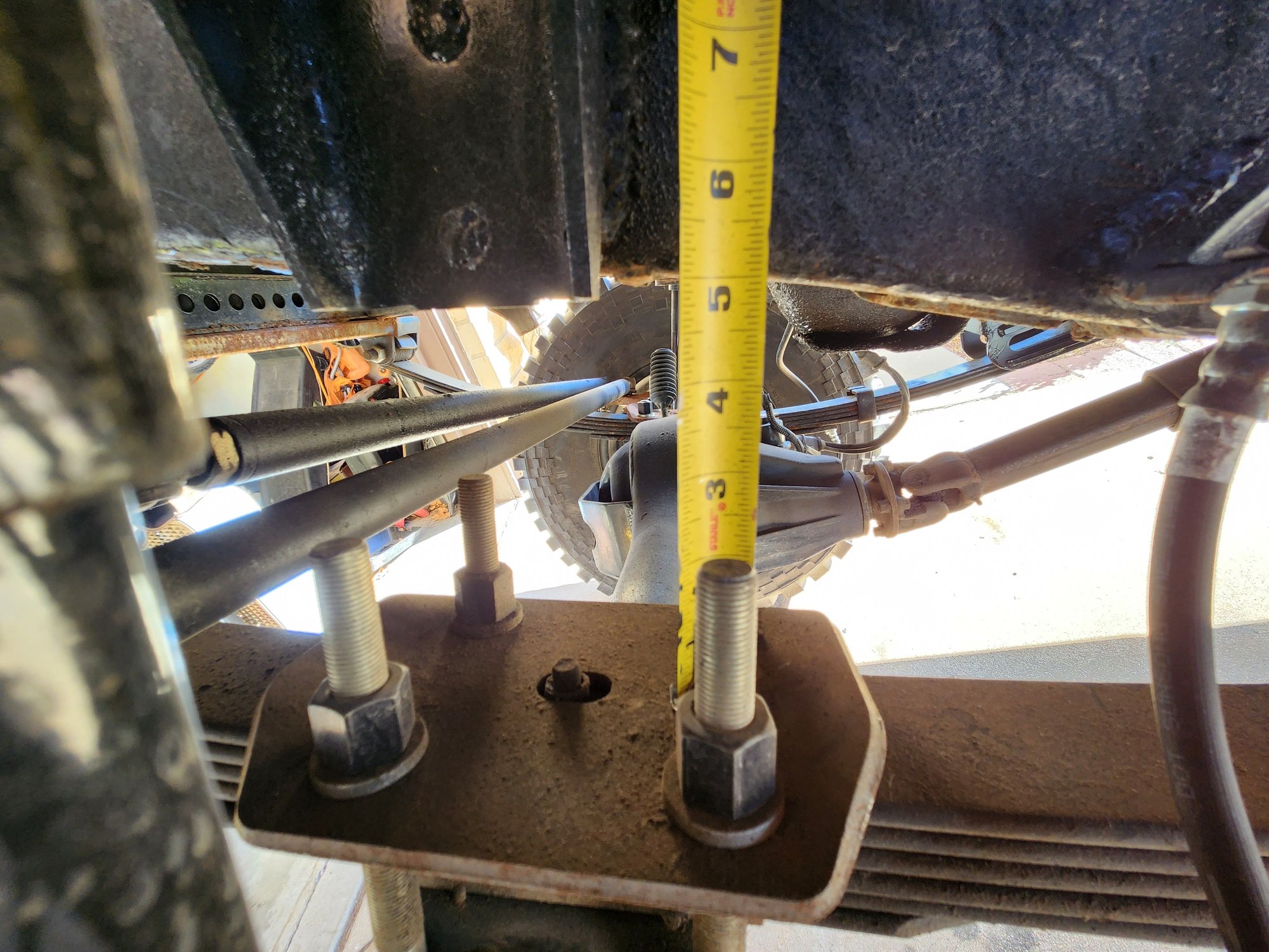

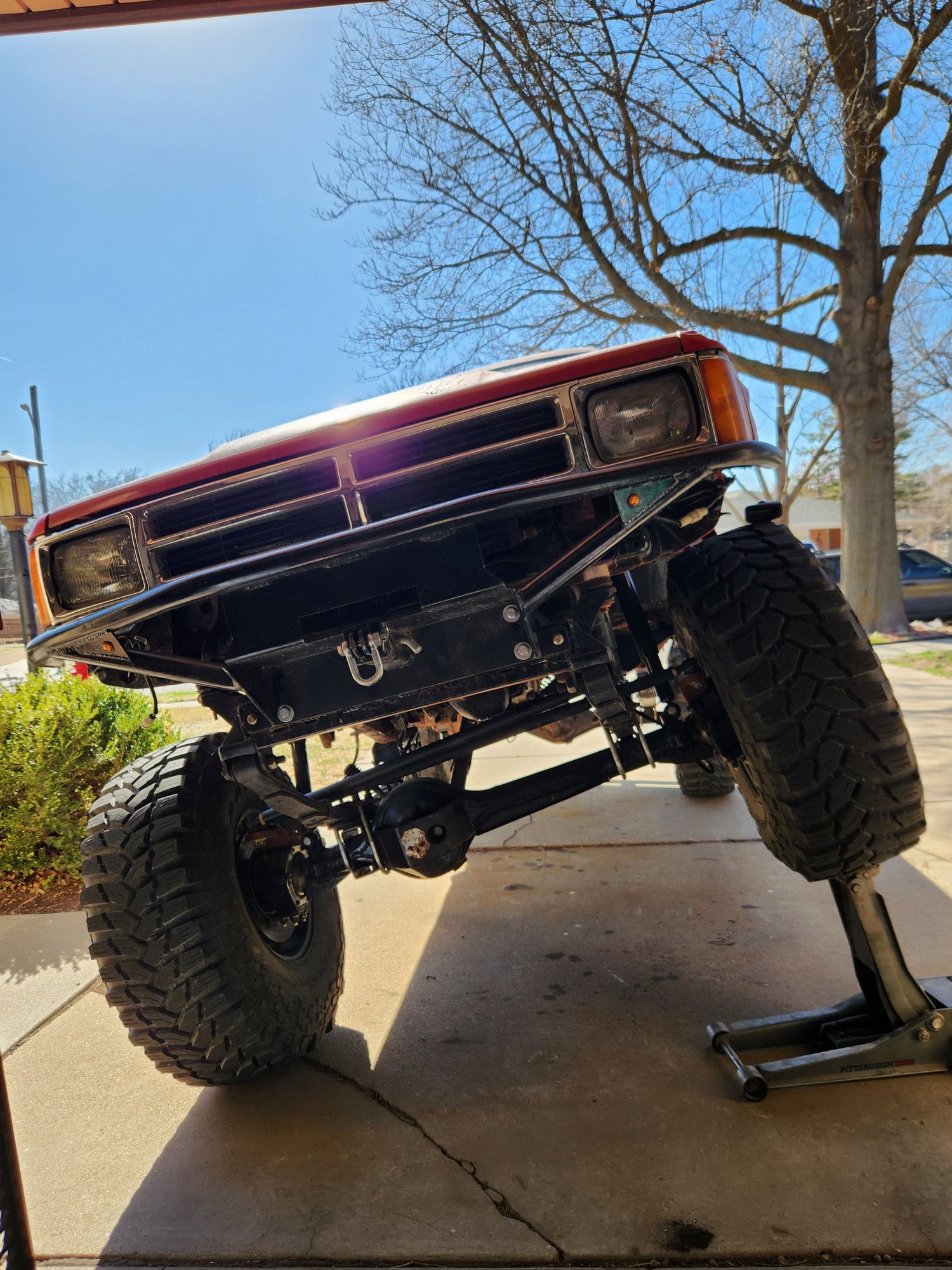

Finishing one slider box
I worked on this all day Saturday. Here is full droop.
Adding in some gussets.
Here's the difference in height.
I wanted it to lower a bit so this is perfect. I have some videos of it driving on YouTube I will link. Only one side done and i can tell a difference in ride quality.

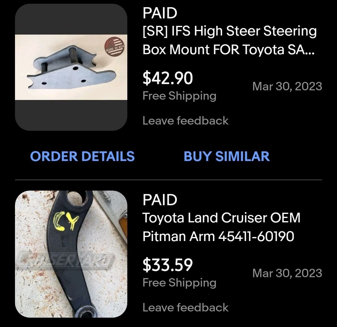

Here is the video of the test run:
This looks like its gonna be a problem.
So last night I ordered some parts. Trail gears kit is $75 but an ebay seller has em for $43.
Trail gears flat pitman is $130!
This pitman arm is from an FJ80 landcruiser. It's not flat, but I believe its an inch or more less drop than what I have so I will be able to turn the steering box more vertical thus allowing it to go forward more. Let's get this baby dialed!

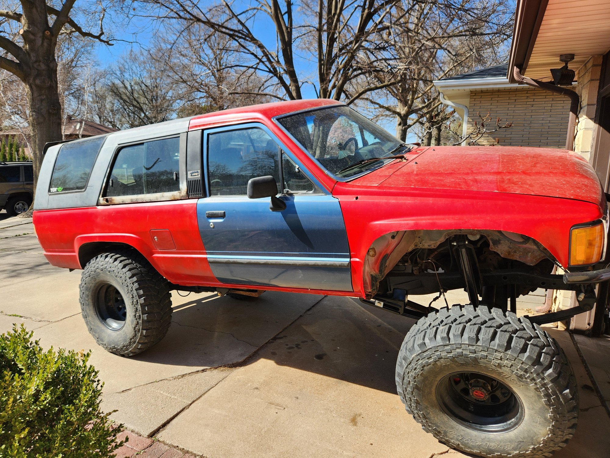

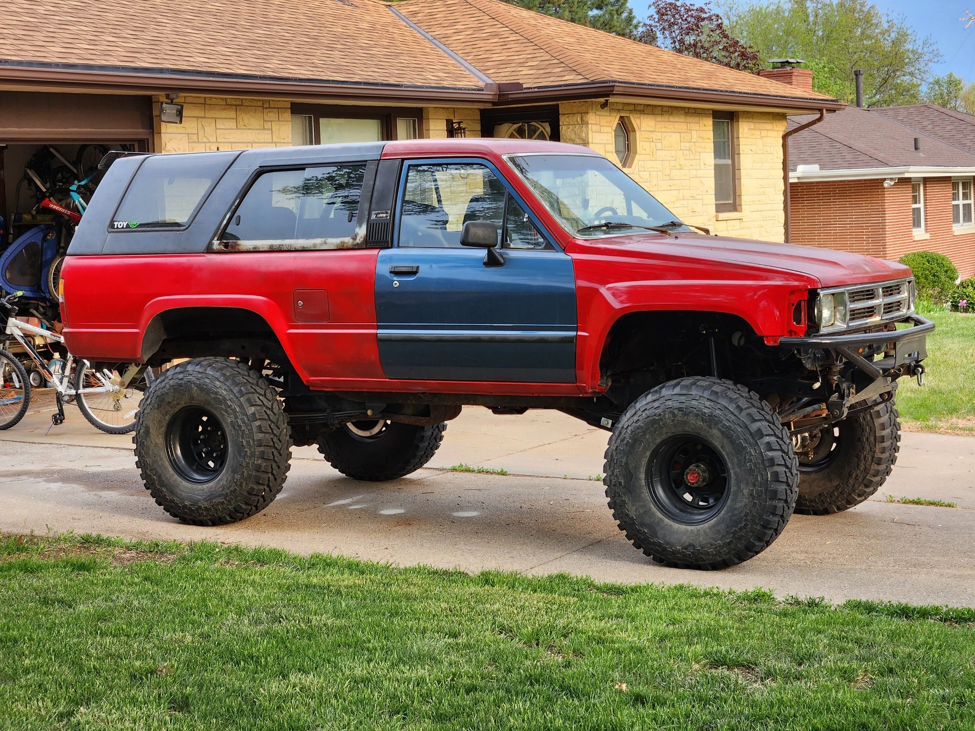

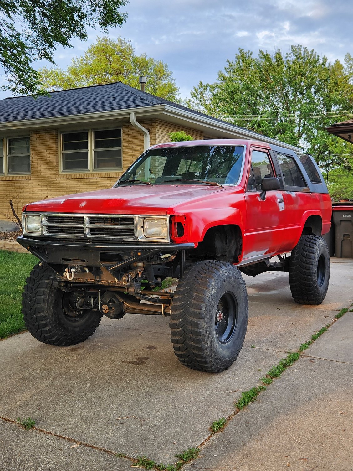

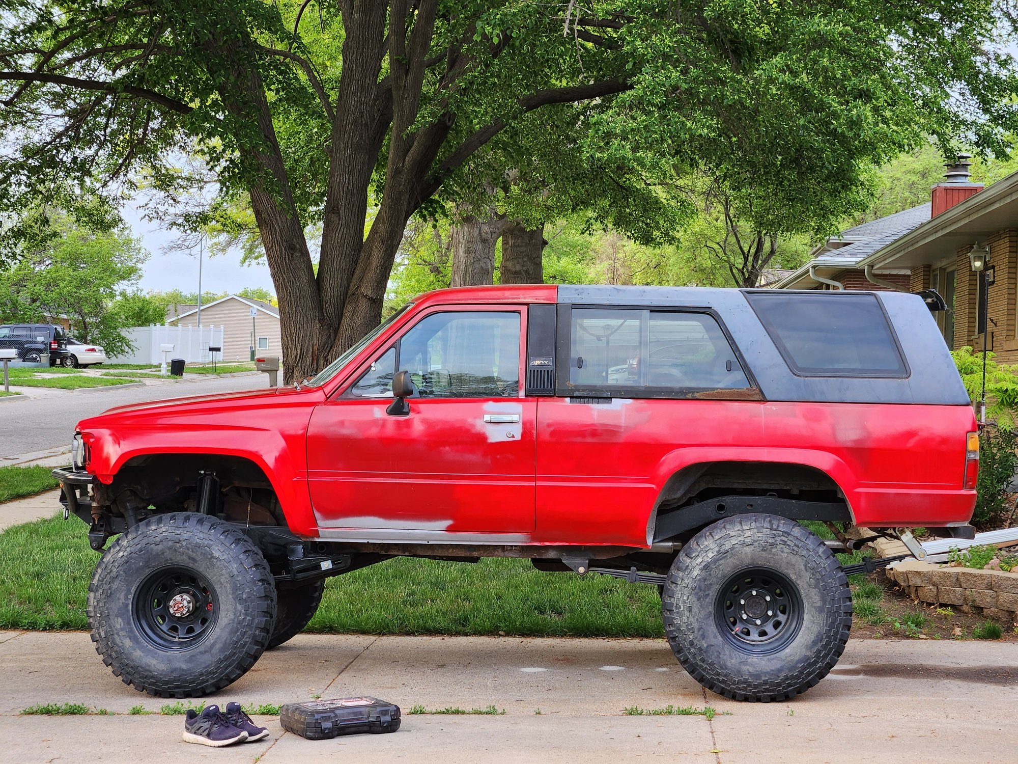

I got most of the drivers side box welded on and went for a drive.
The next photo I edited it as if I had the new fenders on and it almost makes it look like it sits level.
So I bet if I put the overload leaf on the back packs it will look great. I can't wait to paint it! Just gotta fix some more sheet metal first!

Yesterday we took the top off and the whole family went out for a cruise. Somehow that was the first time we've ever done that.

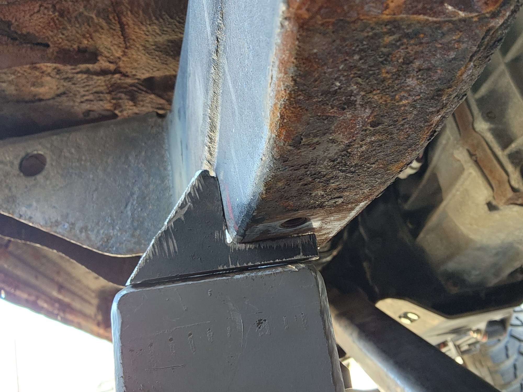

I discovered the drivers side leaf was contacting the slider box just driving around town. I cut about 1/4" off the front bracing and it still hits. You can see the scuffed paint in the photo.
So I guess I gotta keep trimming and driving until the paint stays on. Happy Easter everyone!

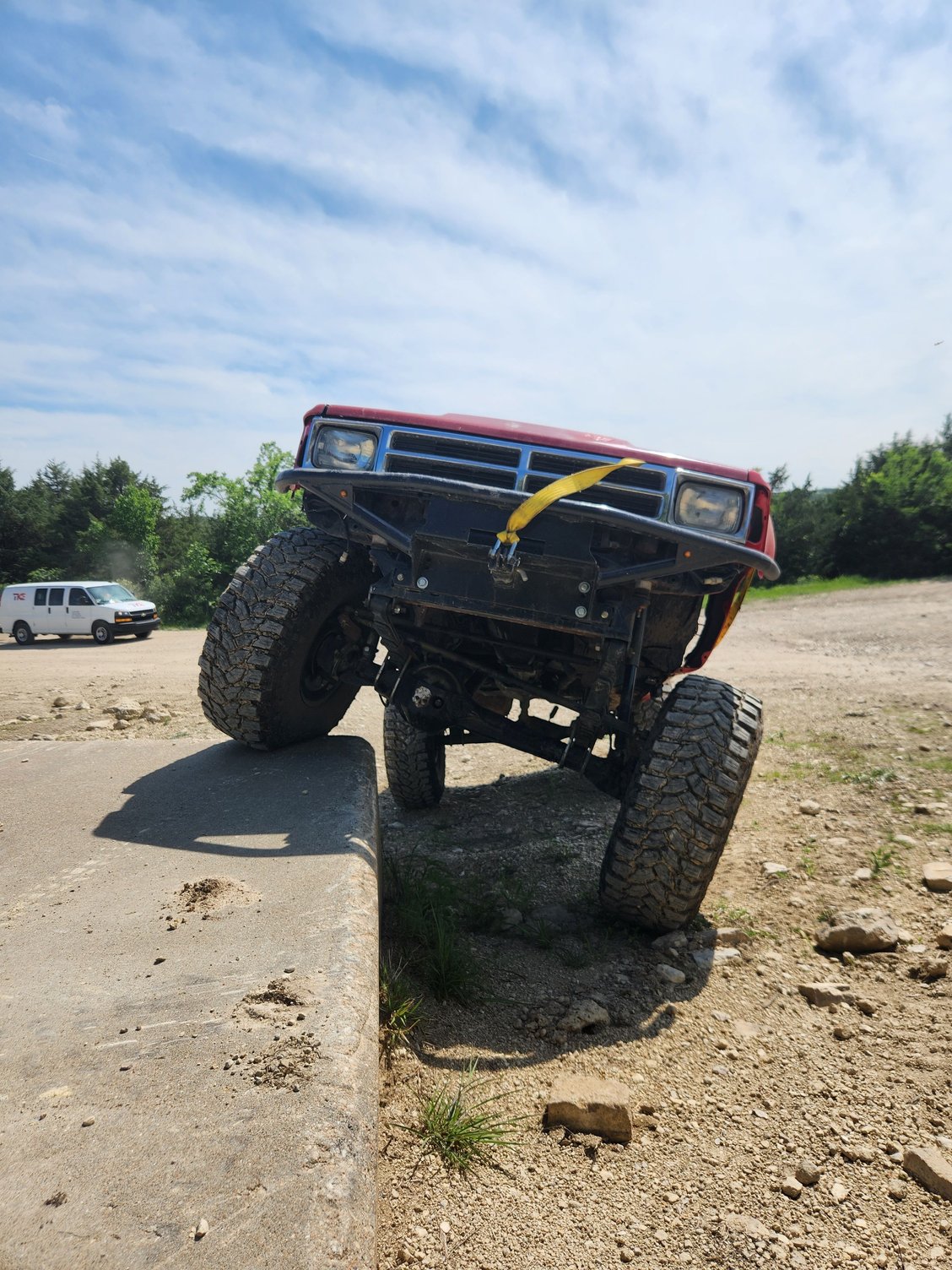

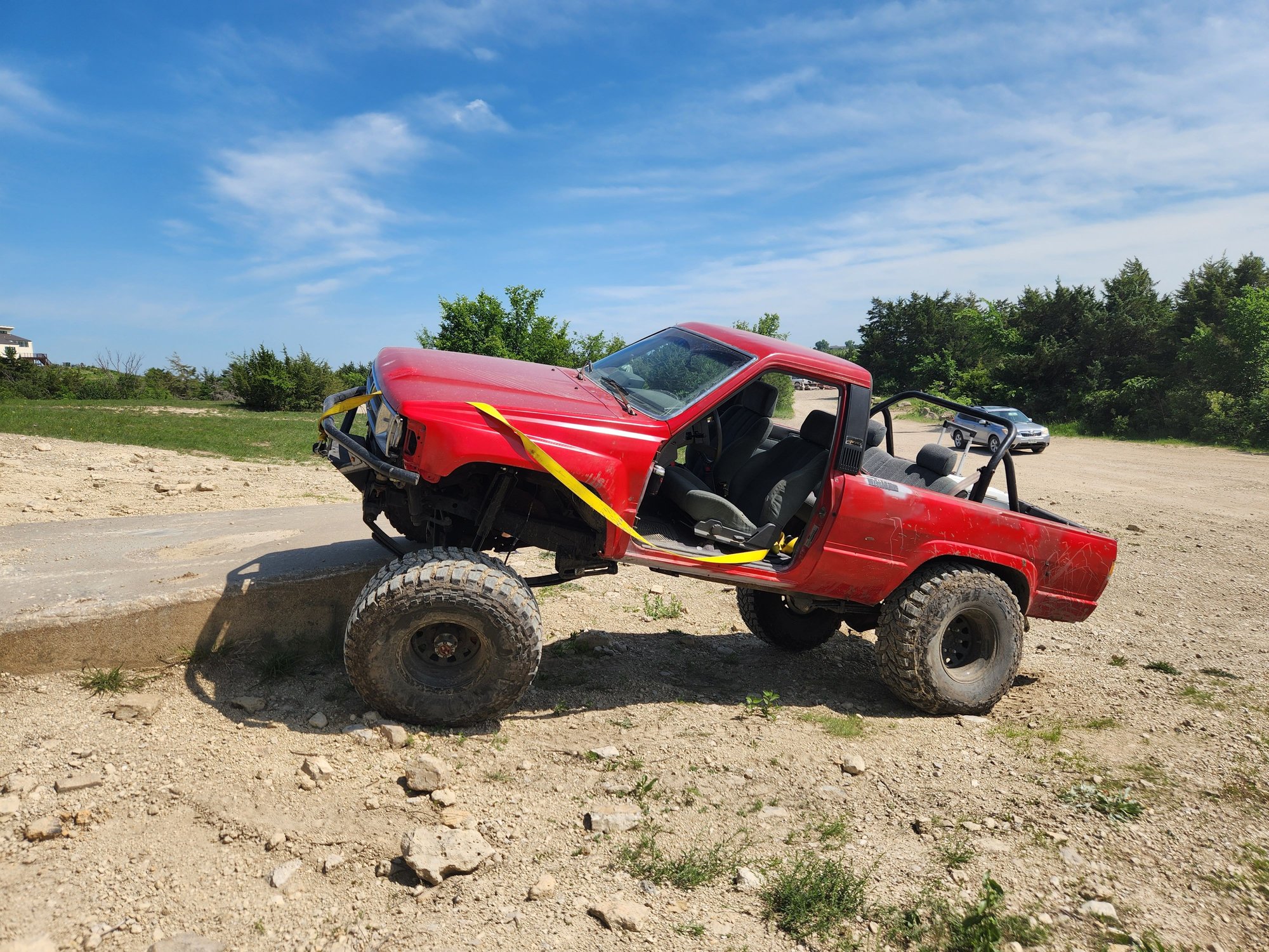

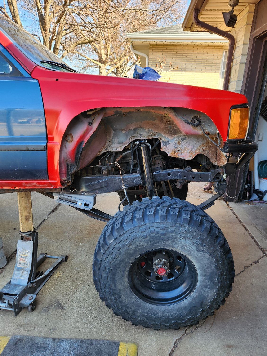

I finished clearancing the slider boxes. Test drove it. Then decided to flex it a bit. Had the jack maxed out and had more to go.
I might put in a 4" bumpstop so it can go up one more inch. But she's sexy and flexy. Can't wait to wheel it again.

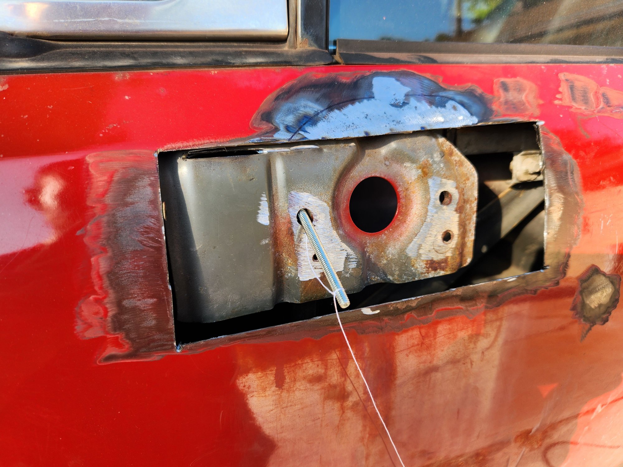

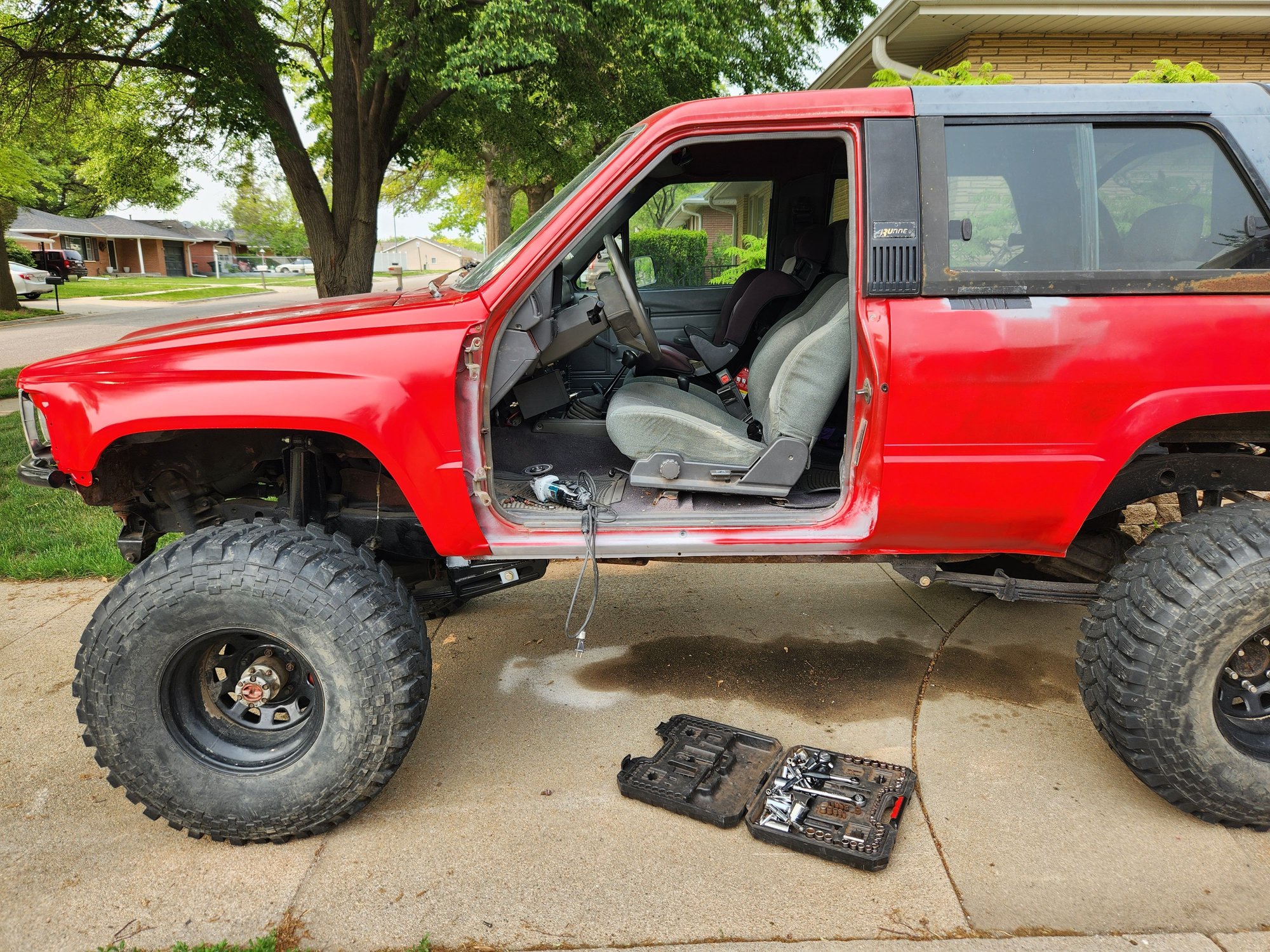

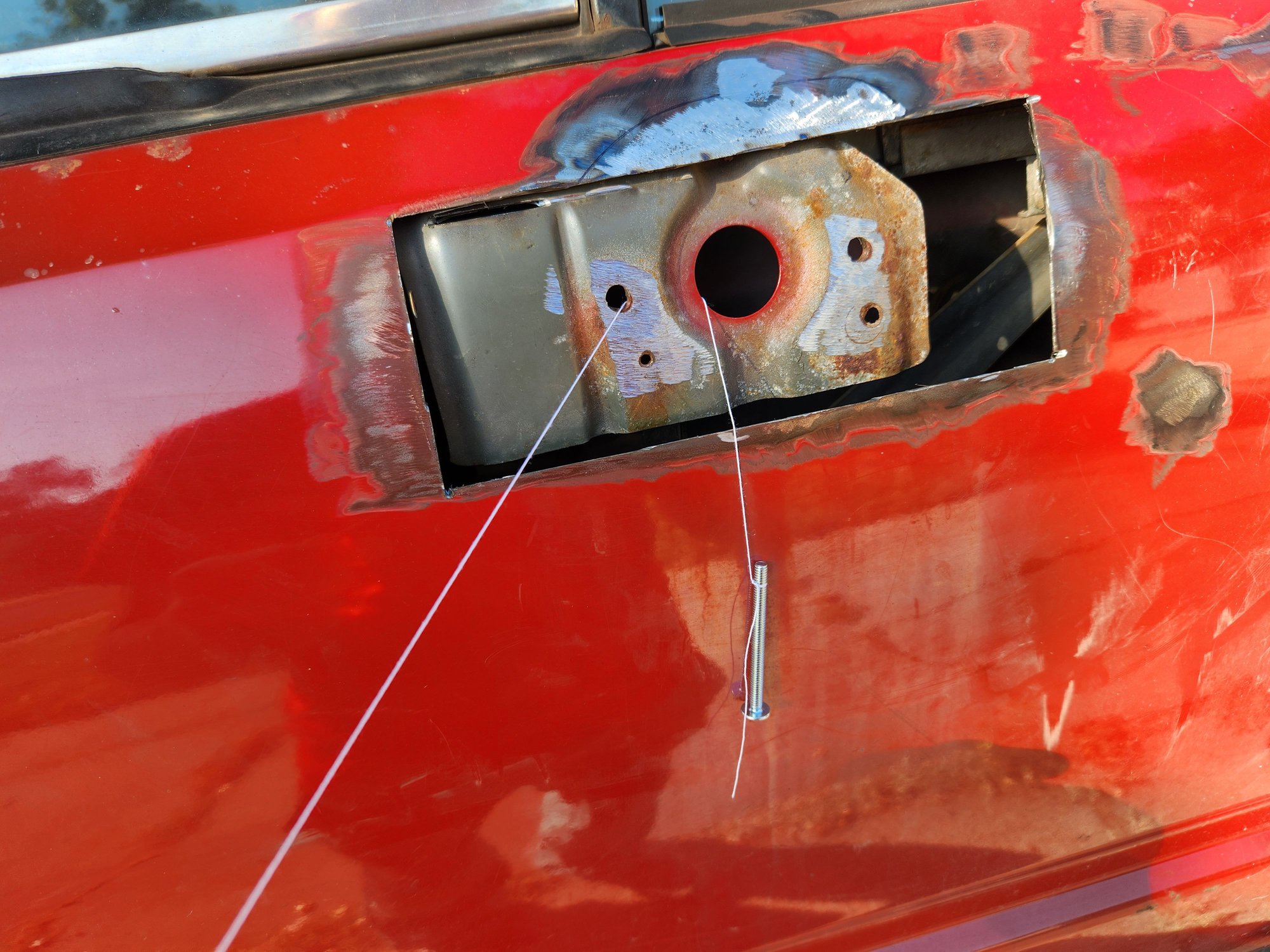

Quick disconnect door mod
Finally doing the ol quick disconnect door mod. I did this 8 years ago to my 88 pickup and it's about time the 4runner had em!
All that oil is from my jeep not the 4runner. 😅
Only other thing I want to get done before the offroad trip in a week is troubleshoot that front elocker. Reeaally hoping I can figure that out. 🤞

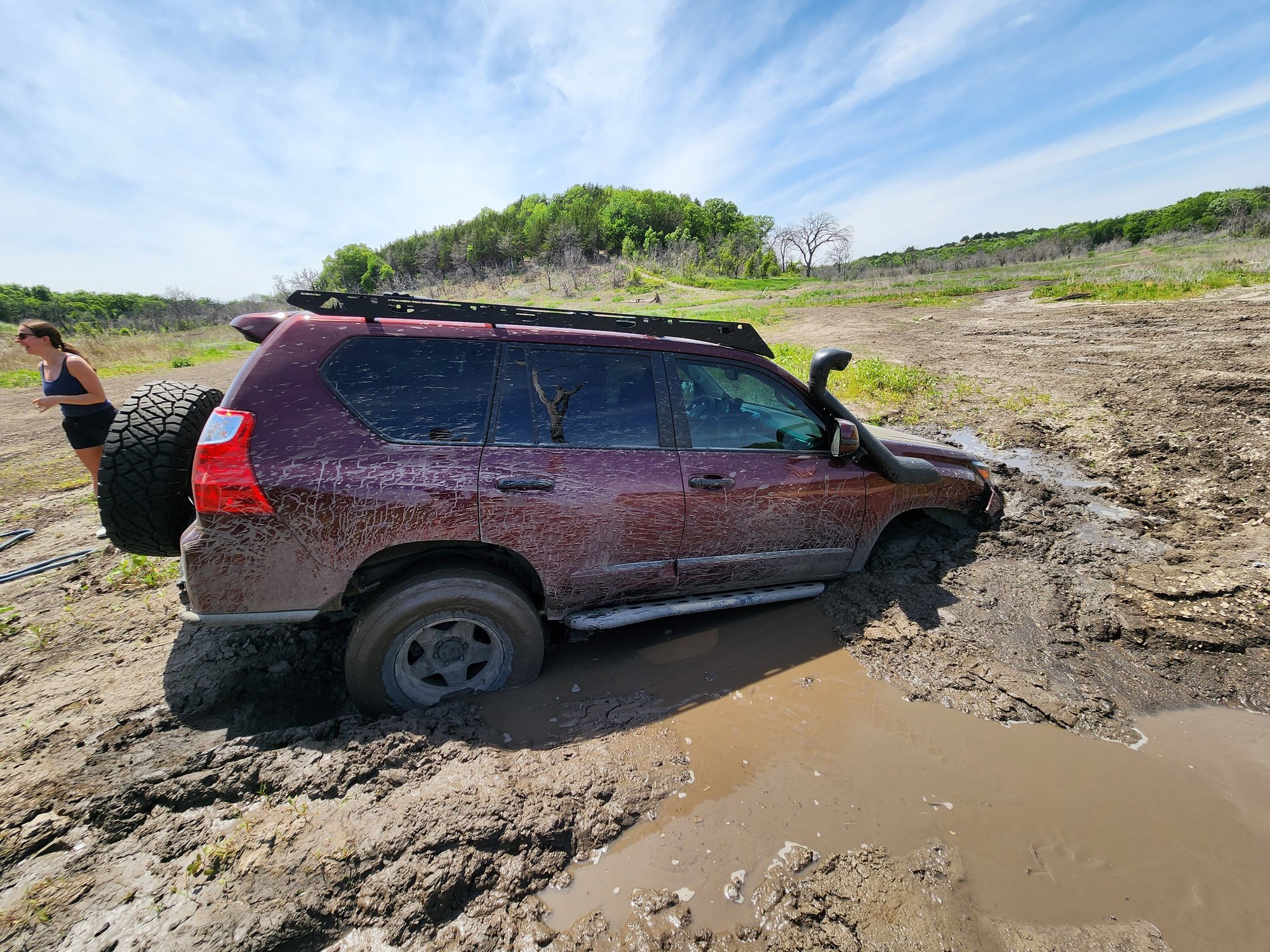

Leaf slider test run

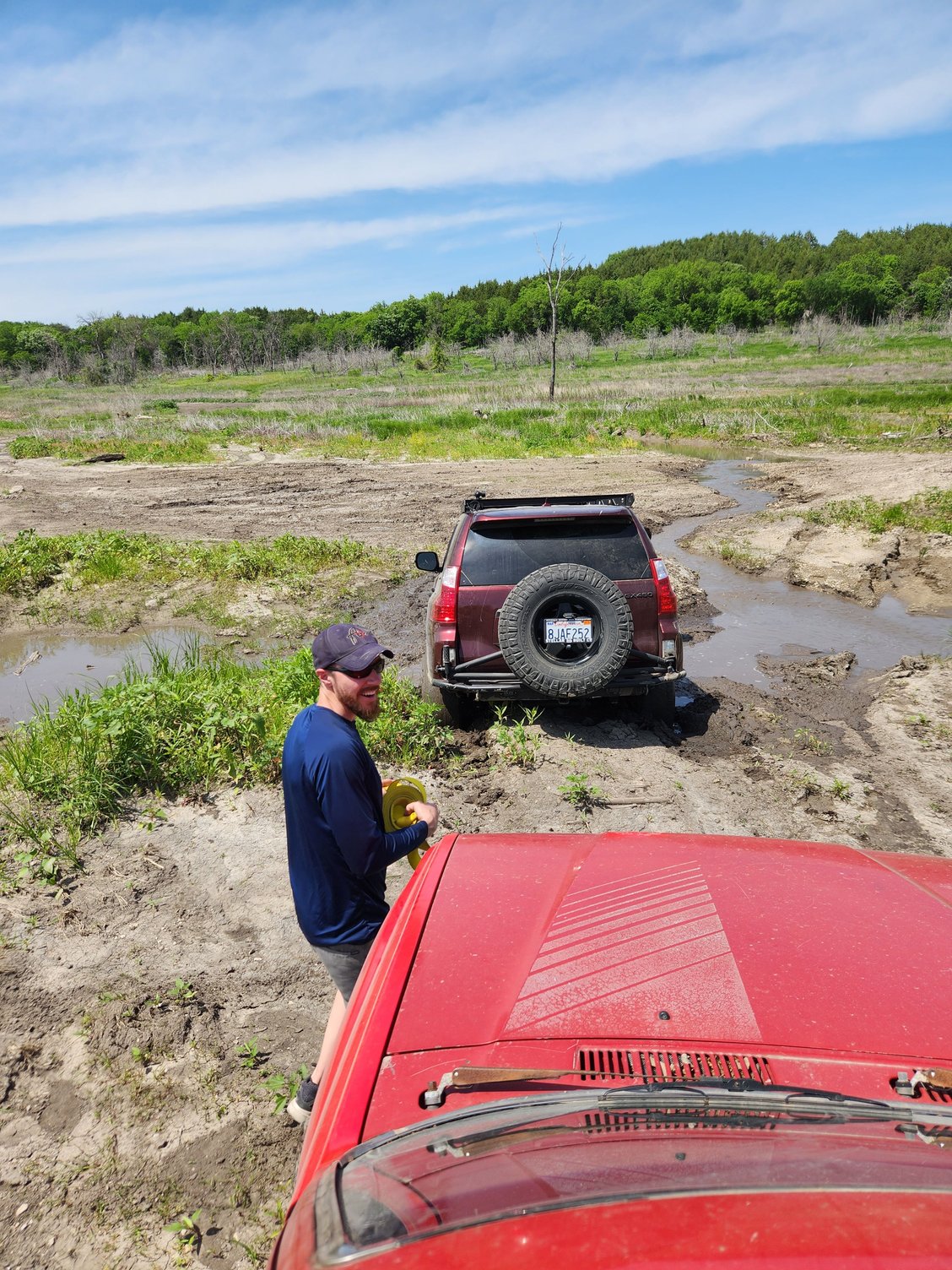

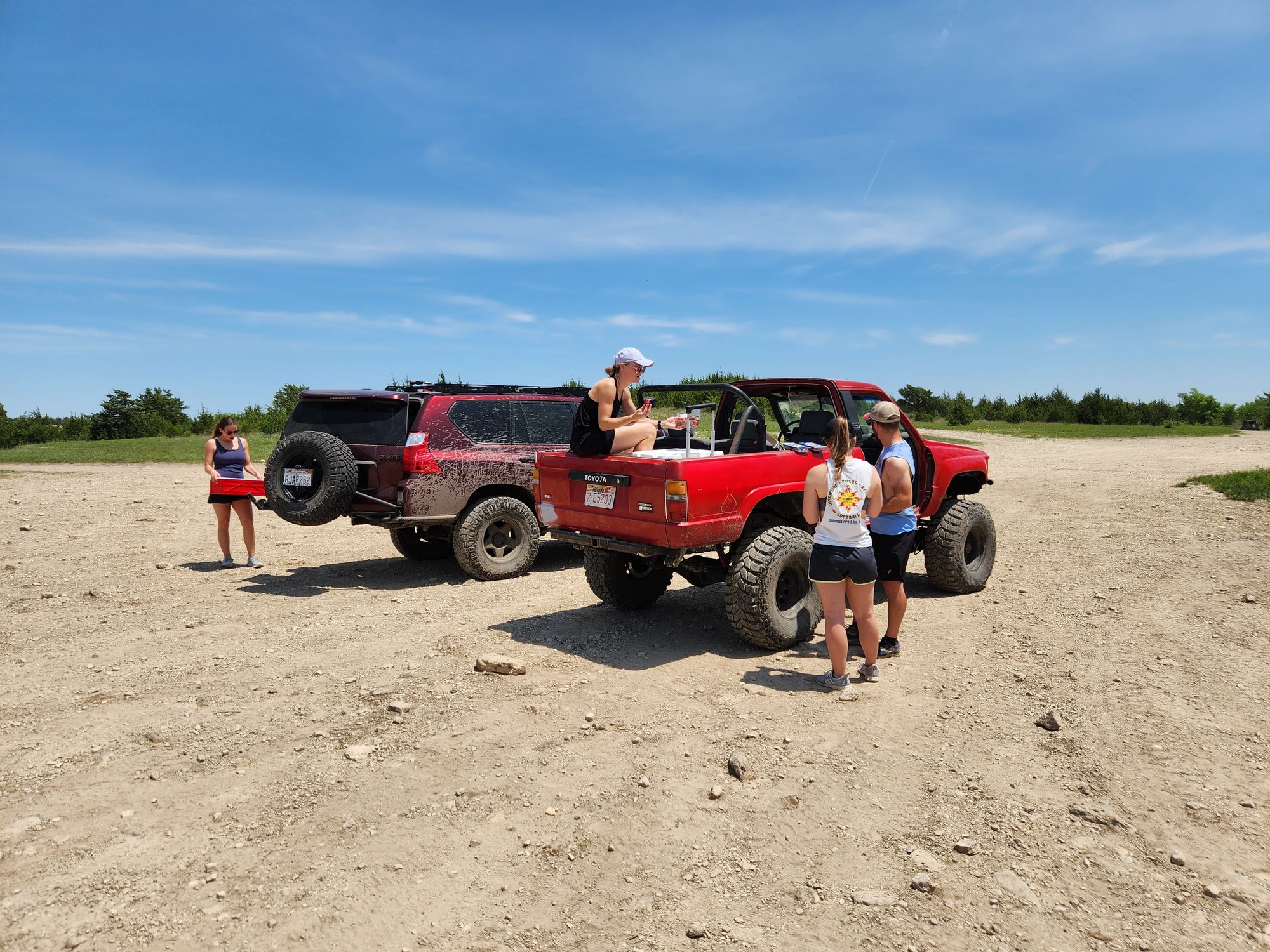

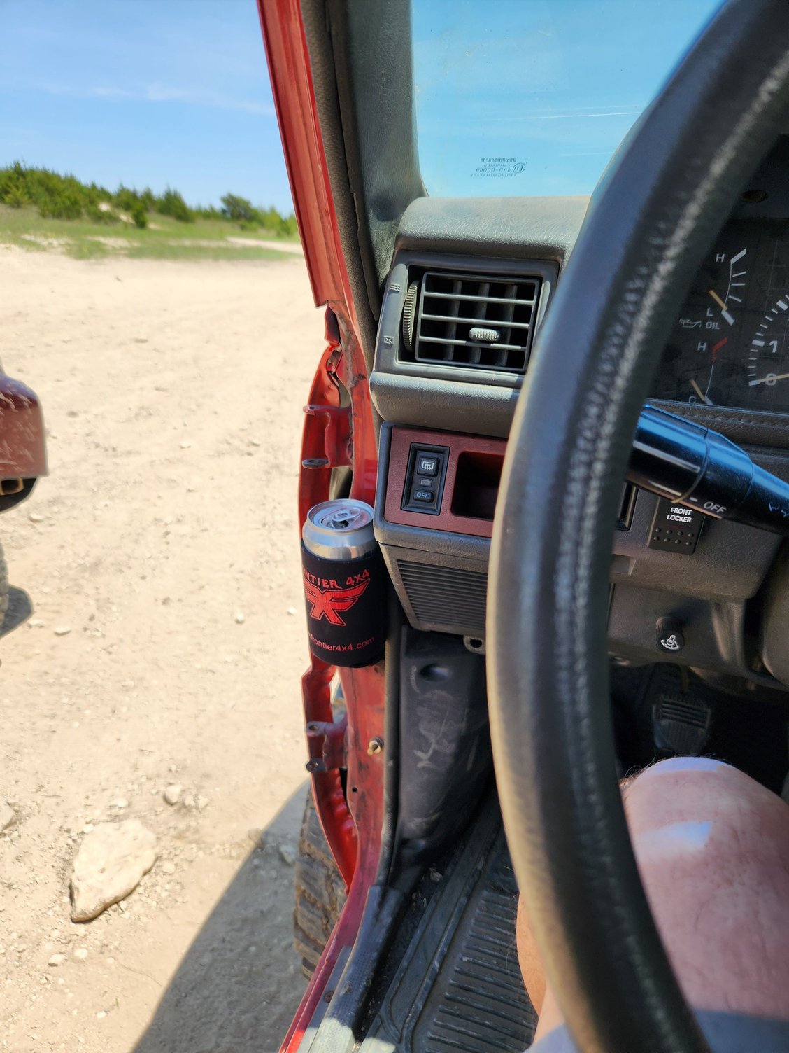

Went to the good ol tuttle creek for a wheelin campin trip to test these slider boxes out.
It was a perfect day and having the top and doors off was a blast. We were puttin around all day with a lexus on 35's and a rear locker. Open front and it did really well. I was impressed. Everything went well until he sank into a mud pit he didn't realize was that deep.
It took a while and I was worried my truck might even break something trying to pull him out but eventually we got him unstuck. 😅
The front e-locker worked flawlessly. It was so nice to have it at the push of a button and functioning properly!
Next item on the 4runner is paint!!
P.s. these magnetic koozies are a must have!!
