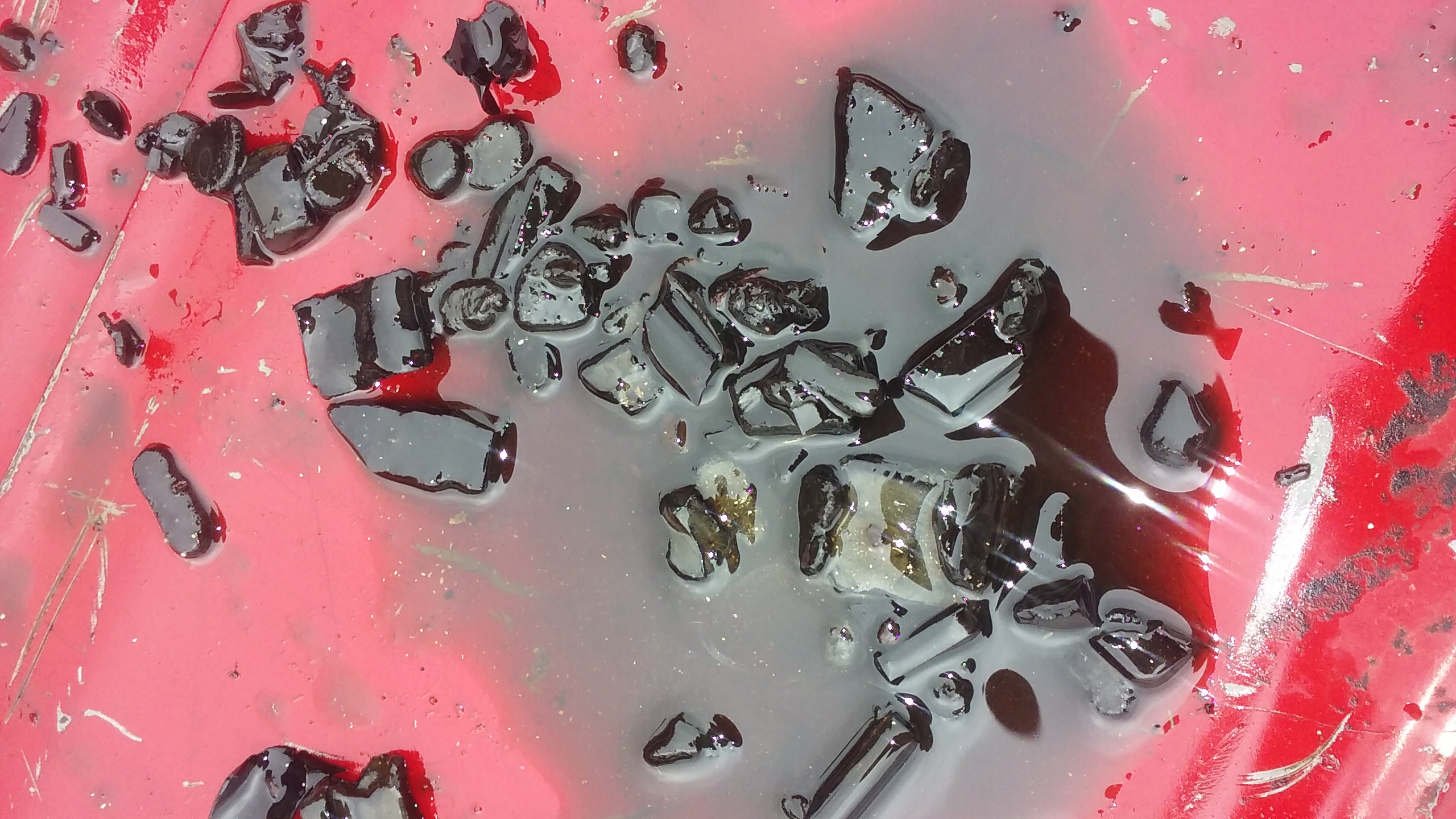

My truck is a '94 2wd 22re 5spd. The PO took decent care of it and I picked it up for $1500 at 195k. Now it's at 210k and my timing chain tensioner and guide came apart and my oil was filled with both grey and brass metal shavings and plastic pieces. It's been really good to me so I'm planning to go through the motor completely and breathe some new life into it. I tore into it today to find the problem, and I hope to have the motor out next week and assess the damage and order parts. I'm thinking of boring it over but it will all depend on if it meets specs when I check everything. I can't find my service manuals at the moment so I've just been doing the obvious things, but I should be in full force when I find them. I'll post pics to show what I've done so far and get some feed back, I know there are a lot of knowledgeable people on here. I'm no stranger to engines nor Toyotas, but this is my first Toyota rebuild so any guidance would be great. Thanks guys!

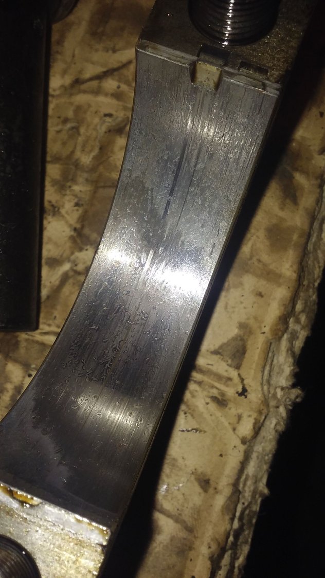

This is the head where the cam journals ride. I think it could look a little better, but I checked it with Plastigauge and it was within specs.
Crankshaft and cam were both borderline within specs on journal diameter, but the clearance was good and should be even better with new bearings so I'm not going to worry about it.
I don't have any pics of the block, but It's a little too out of round and too tapered, so I'm having it bored .020 over by the O'rielly's machine shop.
My main bearings are pretty rough. I'll post more soon of my semi-cleaned engine parts and my clean engine bay. I'm waiting for pistons to get here before dropping the block off, that way they can bore it to exact measurement. Thanks for looking!
