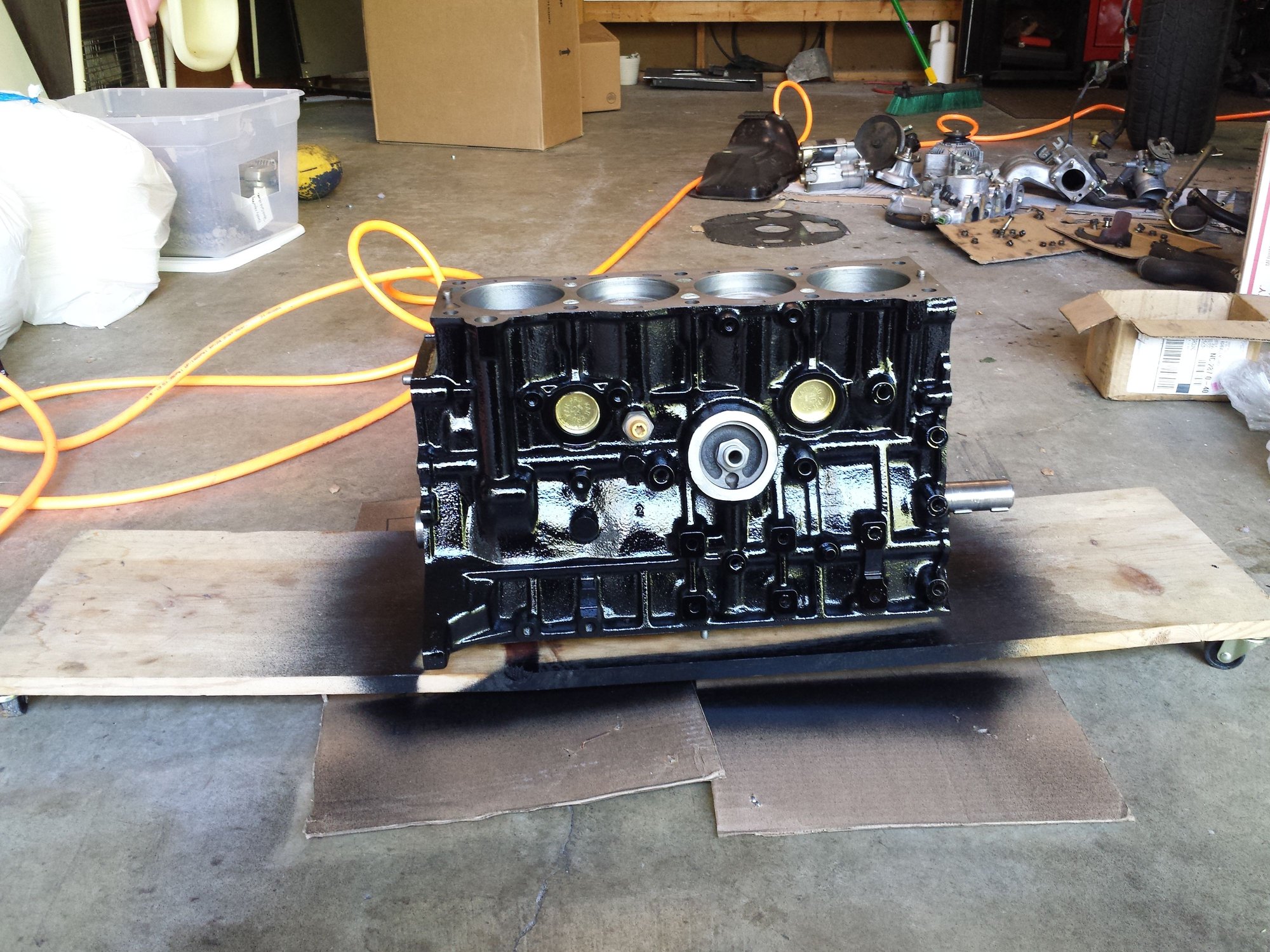

Old Apr 16, 2016 | 05:39 PM
  #96
92ehatch's Avatar
Joined: Jan 2015
Posts: 652
From: Hendersonville NC
Better late than never, been busy with the new job working a 10 to 8 schedule. Then i had a bad septic issue at the new house. But here are the pictures as promised
Picked this up today. I plan to start painting the engine block and valve cover. Then I'll paint the engine bay where i did the body work.
Resemble the engine and install.
I'll do the main body work after it is drivable.

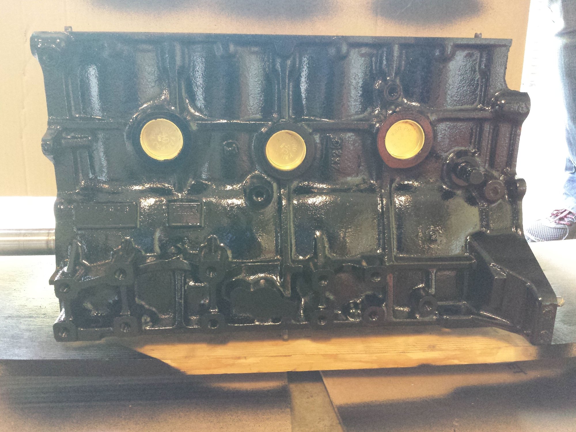

And the block is painted!
I also purchased some fiber reinforced filler that I'm sure I'll need.

Omg. I left my old timing cover at the machine shop because i didn't need it.
I did need the alignment dowels that were in it. I hope he didn't toss the cover.
I also realized that i didn't paint all the areas of the block once i turned it over.
I will be sure to hit those areas when i do the oil pan.
