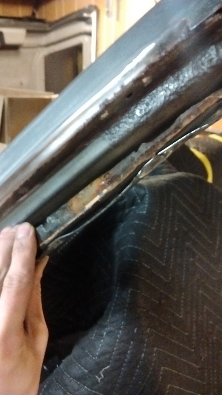

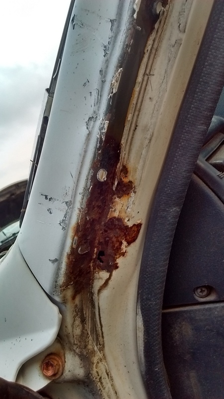

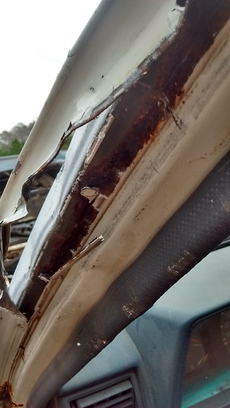

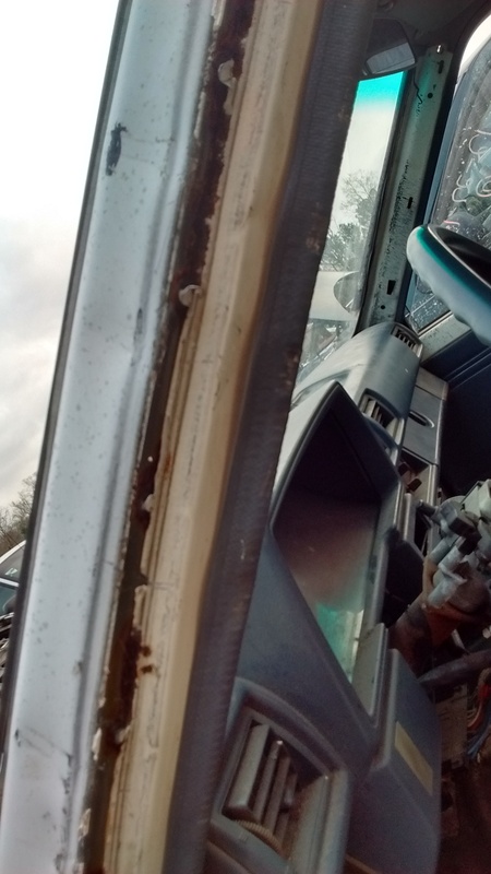

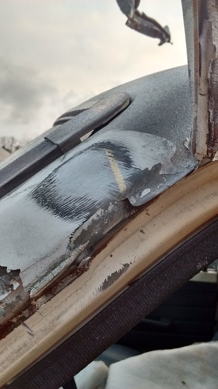

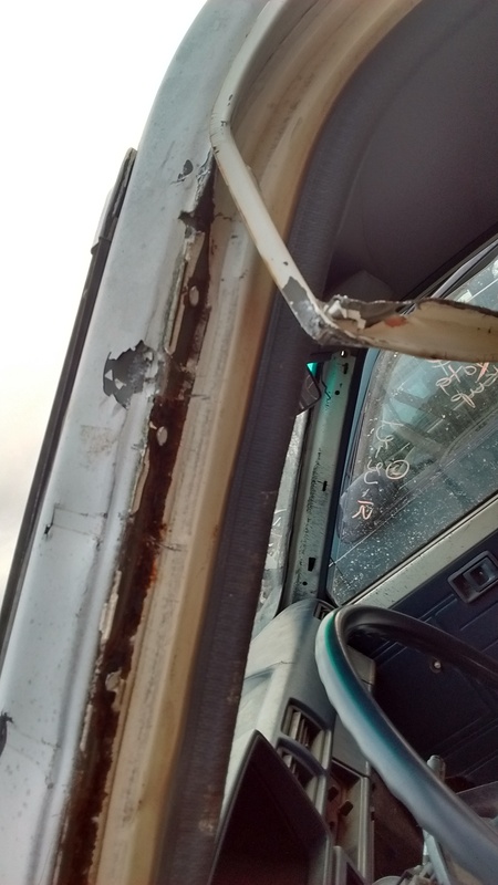

Just FYI, the cracked seam sealer that holds the rain gutter to the A-pillar will not let water into the truck. Well, not exactly. The rain gutter is spot welded to the outside of the A-pillar so the seam sealer just keeps water from getting between the rain gutter and the A-pillar. What happens is that when the seam sealer cracks water gets between the rain gutter and A-pillar and can cause rust which eventually leads to holes in the A-pillar. Slacker once suggested removing the rain gutter to resolve this problem. Here's some pictures I took while experimenting on a truck in the junkyard.

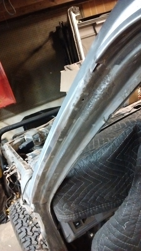

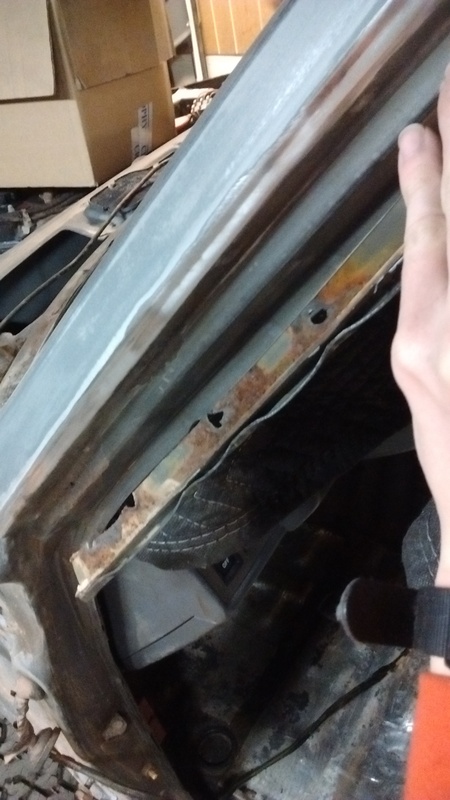

Here's my truck with the rain gutter removed and spot welds smoothed. You can see a couple little pinholes which have appeared. The nice thing is that this is a rare case where rust starts from the outside and works in. Typically it starts where you can't see it and works its way out. By the time you see it, it's already really bad.

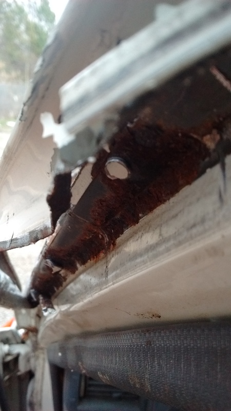

I considered removing the gutter.
That picture i took doesn't show well but there are two holes. One in the gutter and one opposite that where the old windshield trim was. I believe they are both part of my leak.
I will remove the windshield and fix both
Did you also remove the gutter from the fiberglass top? It will look funny i think if you didn't

I only removed the rain gutter on the A-pillar. I left it in place along the roofline. I plan to run my Can-Back soft top since the 4Runner is my nice weather vehicle so I have no plans to do much work on the hardtop.
