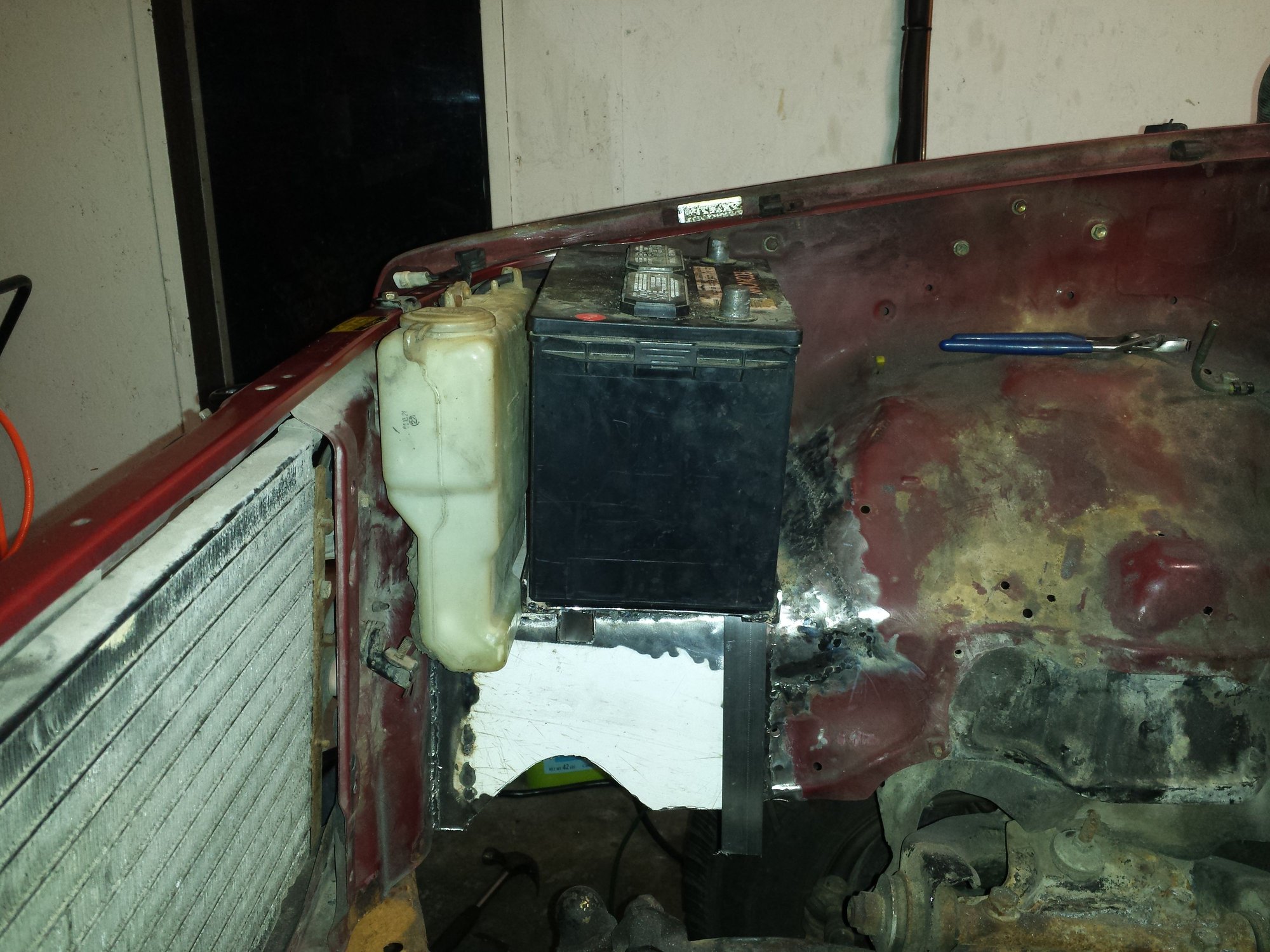

Finally got some progress on the battery carrier.
I just need to tweak some things.
I plan to bolt it in so it is removable, this way i can paint all the area without worrying about rust, and even remove it to fix any rust that may appear in the future.
