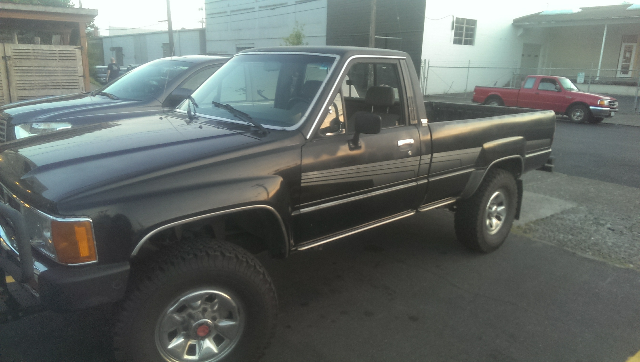

Here is some pictures of it now and I will post some old pics of it from when I first got it

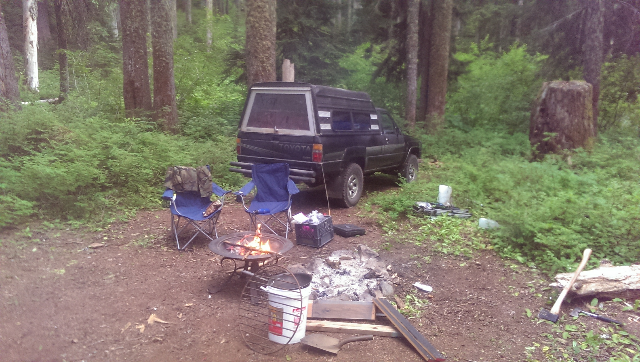

The family does not fit which isnt always a bad thing haha. But I orginally wanted a first gen runner looked for a long time couldn't find a stock one in good enough condition for the right price. I didn't want to buy a trail ready rig I wanted to build it my self to learn. I'm enrolled in a auto technician program at a local community college and have found my calling in life here's a pic of the day I got it you can kind of notice the paint coming off the door right below the window
Attachment 98962
It had smaller tires on it and it came with a swamp thing of a canopy that is to big
Attachment 98963
I cleaned the canopy up and used it for camping with some milk crates and 2 pallets I was able to fit a queen size air mattress on top

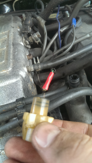

Thanks. The truck is in great shape for its age the engine has 193k on it and I dunno if there has been any work done to it. There's no skid plate I dunno if this year came with one my old runner had one.
The guy I bought it from was selling it for his neighbor and he said he thinks that there had been something done to the fueling system. There's a aftermarket temp gauge installed the stock one just sits at cold and jumps every now n then. I accidently broke off the clip that plugs on to the coolant intake next to the throttle body. I hope that's not the one that goes to the ecu here's a pic
The engine seems dirty it sat for 2 years I soaked it in the Orange stuff and simple green took it to the bath and got most the gunk off the I really think the timing cover needs new silicone or I'm not sure if they use a gasket on it
It's been having a problem lately I think it's the TPS only happens every now n then I could get it started real rough at first then would even out and as soon as I would hit the throttle it would want to die.
I've read about the zuk mod looks good and easy and seems to give it a decent lift.
Thanks for everything I knew I needed to just start a build thread !

That sensor wire does break easily. On the newer trucks (87 an up) they dont have it. If there is enough wire to splice to it again, I just solder it. Usually it breaks close to the plug and you will need to find another one off of an 85 or 86 to splice it in. Really not sure what that sensor does as I have seen several broken and never cause any issues.
TPS issues are a pain in the rear but overall they cause very few issues. Usually it is vacuum lines that are not routed correctly or leaking. Vacuum leaks, dirty EGR, dirty plenum from the EGR, needing a good tune up, cleaning all of the sensors can make a big difference. Here is some info that may help>>> https://www.yotatech.com/forums/f198...l#post52044719

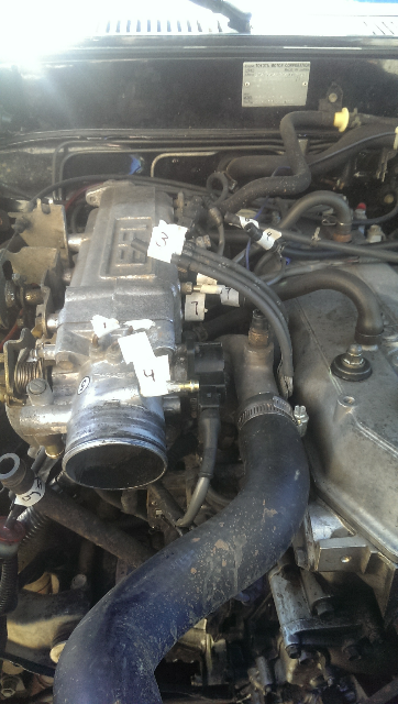

So today I took my throttle body off to take the tps off and check it clean the throttle body and flush coolant

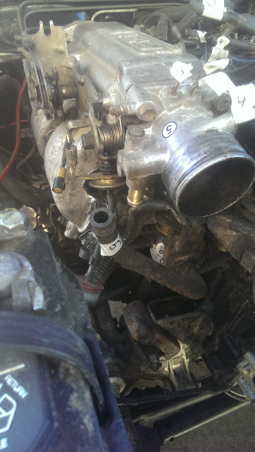

And TB off
So I got the tps off and it doesn't seem to be slow or sticky at all. The butterfly valve is sticky so that's getting cleaned but could that cause my tps to throw a code? So I went to purchase my first multimeter and i will test it a little later. I also have to splice a new wire and cap onto my coolant intake

Which code is it throwing? 7 and 11 have to do with the TPS.
