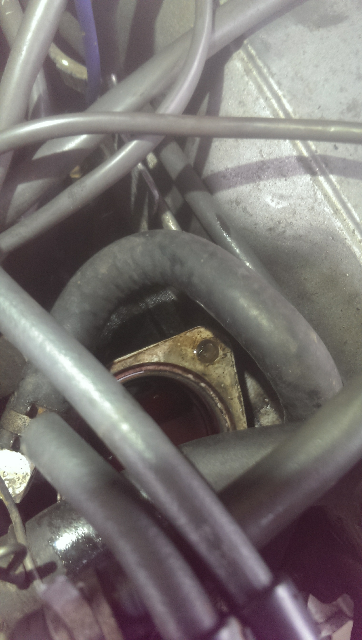

K well something super lame just happened I was trying to tighten the pipe down onto the thermostat housing and one of the bolts snapped !!!!! Inside the housing!!!! What do i do!!
What sucks the most is I thought I had solved my problems and just needed to set the tps and now I have this happen here's what it's looking like
Does anyone have any ideas?

Have to drill it out and extract it,or....get another lower intake.if I were you I'd take my chances and run jb weld and the other bolt.

So your saying to connect the broken bolt together with Jb and then use the other bolt still ?

Has any one used a easy out drill bit before on something like this?

Get the square type easy out. The spiral one is brittle and I have broken them into a stud and that makes the situation worse. The spiral easy outs should be outlawed in my opinion.

Success my dad helped me we got the bolt out with a square easy out I got the pipe back on with new bolt new thermostat and new o ring drove it atoubd the neighborhood for a little bit run in good the engine with randomly kinda have a rough shake with no change in in the idle. For now it will be my dd again there are a lot of seals to replace and the clutch should be done most likely so trying to get these things taken care of before winter gets here
