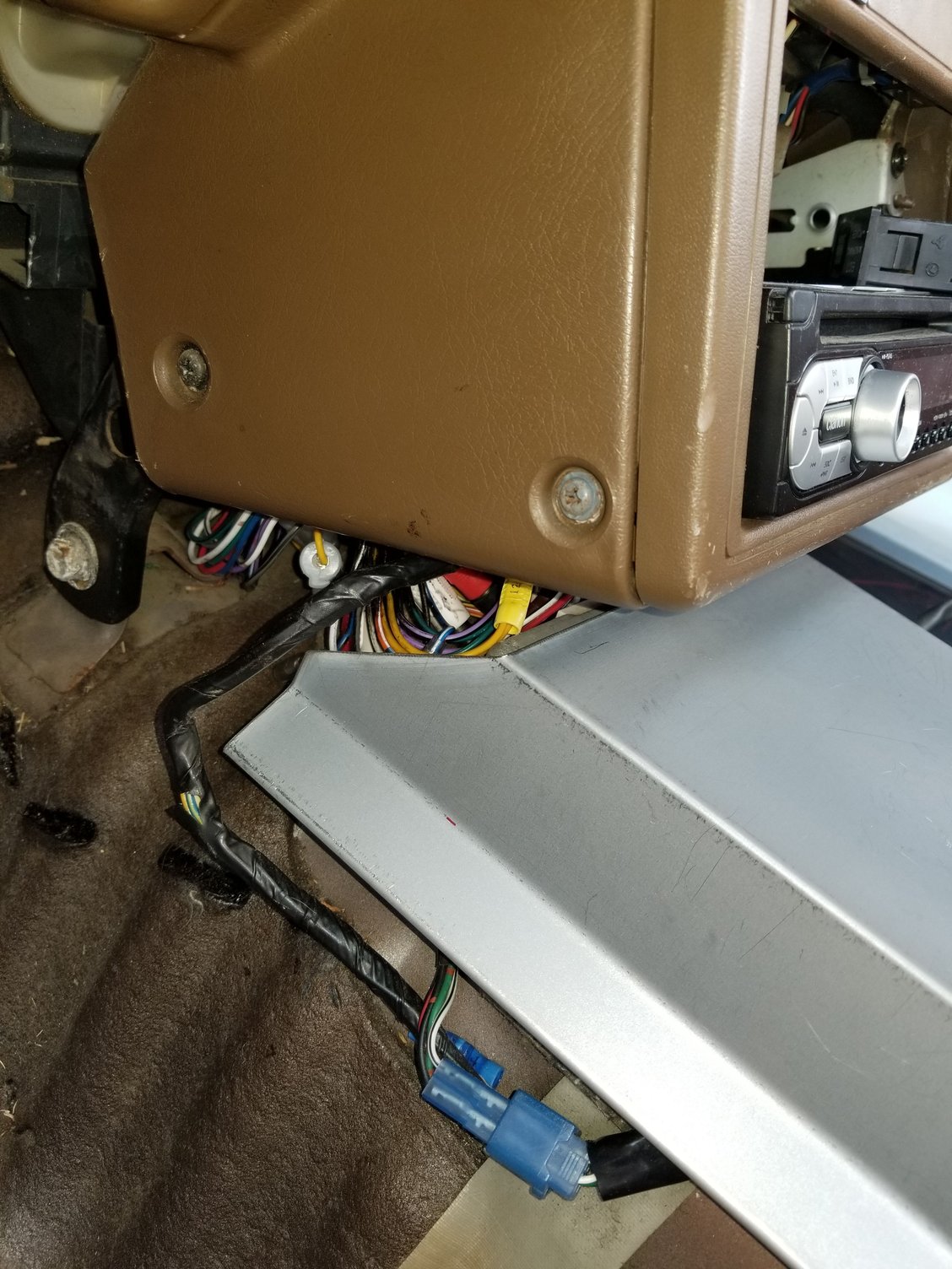

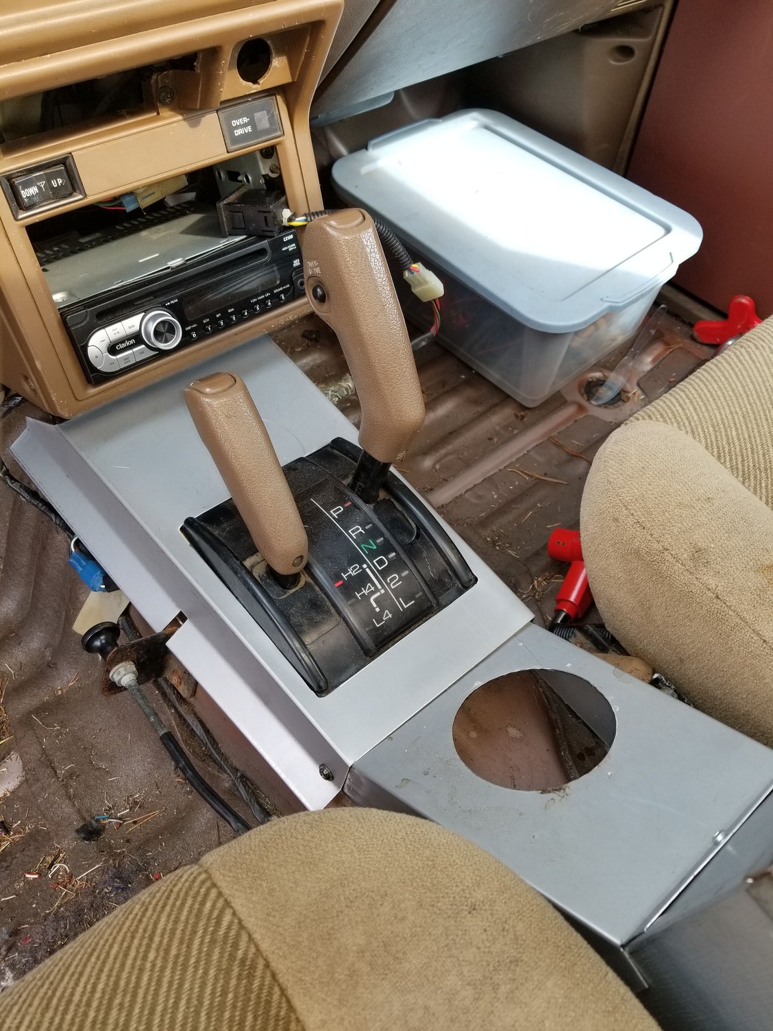

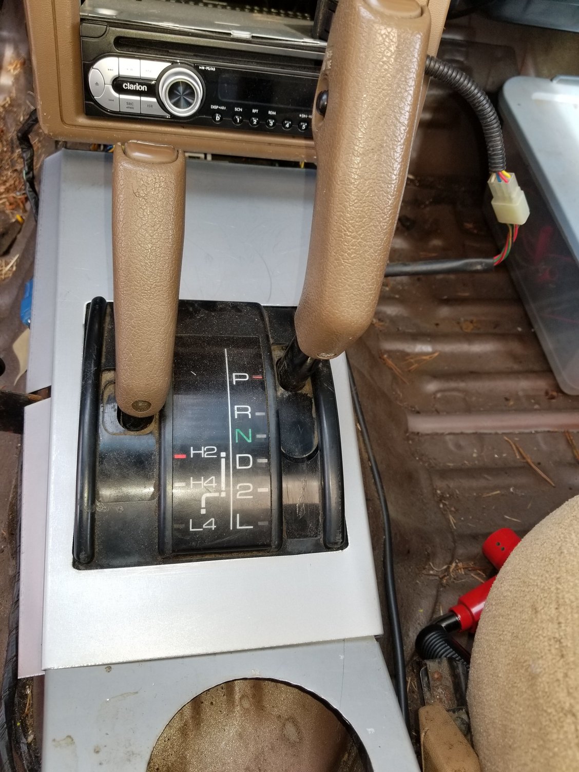

Slow day at work today, so jumped into one of my many, many half done projects.
Made the last piece for my center console, the piece around the shifters. Need to drill the rest of the mounting holes and then remove all three pieces, wipe them down with laquer thinnner, then paint. I've decided to stop using the Red Oxide colour I used on the door panels, and try to match the tan interior colour better.
I may remove my power antenna switch and put my ECT switch there, but I was also thinking about making a block off plate above the stereo with multiple spots to mount switches.
Once the rest of the mounting screws are in, it should suck the metal seam down tight on the right side there. Will likely run a small bead of silicone or something between where that laps, just incase my drink sweats or spills and tries to run under there. I'll figure that out in my final mounting phase.
Will also put a bottom of some sort into my cup holder, it just sits down on the trans tunnel for now, which is fine for hot drinks!
I might make a little collar or shroud to tuck up under the radio and sit on top of my newest piece, to hide all the wiring, haven't decided yet. Will tidy up and tuck all the wiring at the bottom of the pic under the lip of my console piece during final install.
One of these days I need to decide if I'm going to put new carpet in or not.

instead of a bead of silicone, you might look at Butyl tape.

Good call Warrpath, I actually use butyl tape at work to seal certain duct systems we install. Don't know why I never thought of it for this type of application, thanks.
