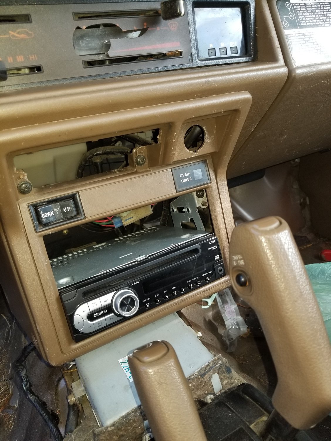

Stock tape deck wouldn't stop auto reversing the tape every second or so, couldn't find any reliable repair info online, so threw in a CD player I had sitting around. Will make a top storage box to sit on top of it. Removed the old rusty cig lighter as well, will order and install a new 12v one, and possibly a twin USB where my power antenna button is. Also need to source a heater control cover, that broken one drives me nuts!

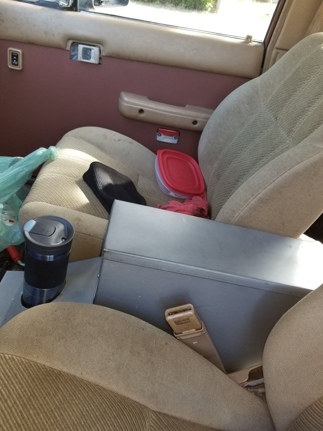

Quick shot of the center console I made last year when I removed the rear heater. Didn't paint it or anything as I'm planning to swap a manual trans in at some point, and it may change the way my cup holder is situated.

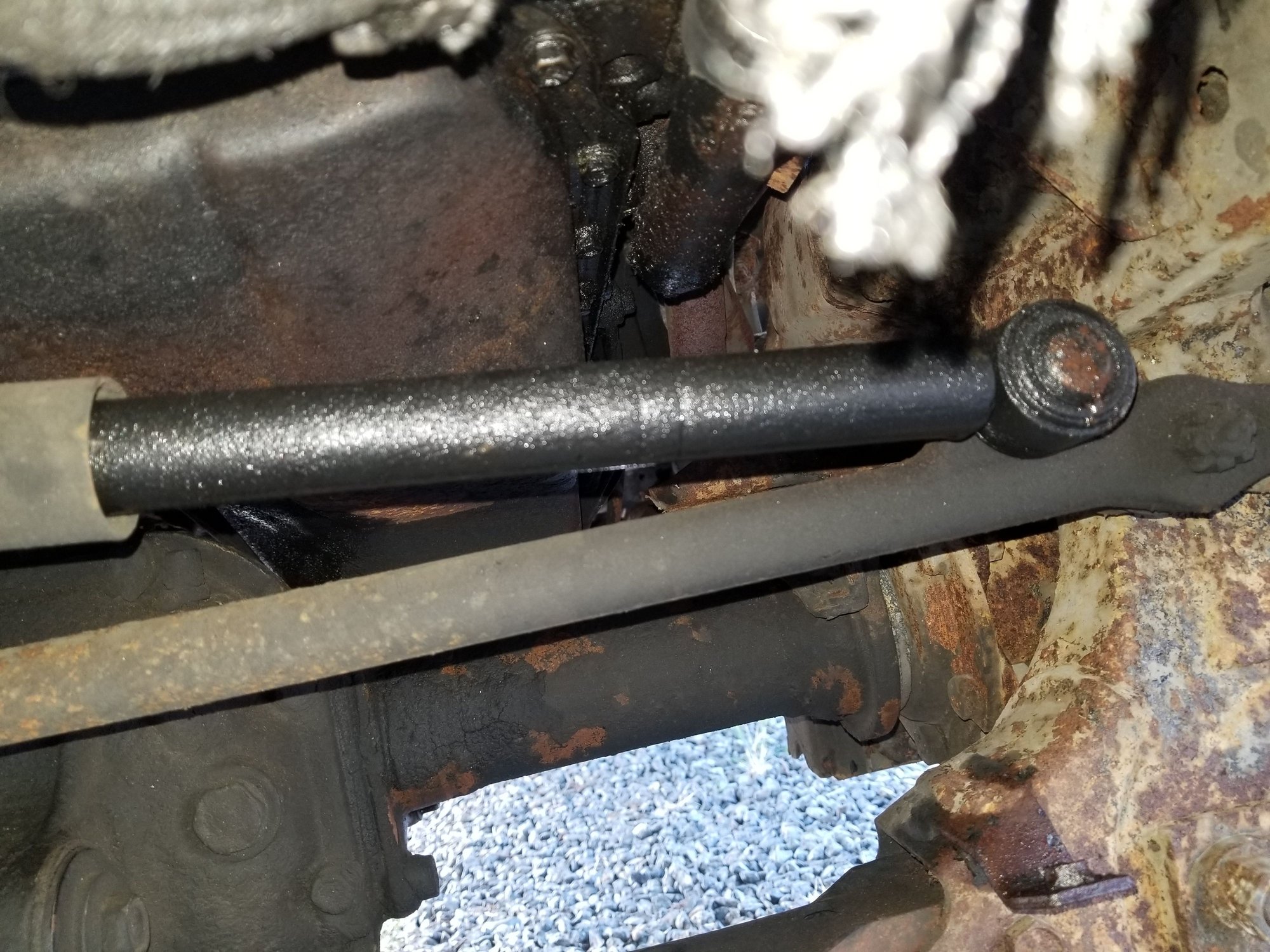

I'm getting some fluid dripping off the lower part of my steering stabilizer and onto the skid plate mounting bracket at the bottom right of the pic. Could be power steering pump starting to leak, will be doing some degreasing and cleaning this weeked to try and track down the leak. Also getting a drip of oil about every 2 days off my front driveshaft where it bolts to the 3rd member, will try to track that down this weekend as well. My oil pan gasket also desperately needs to be done, it's on the list!

Your CD player looks much better than the job my PO did! hacking up the plastic :p

Sorry to hear your stereo got hacked in :/ not cool at all.
