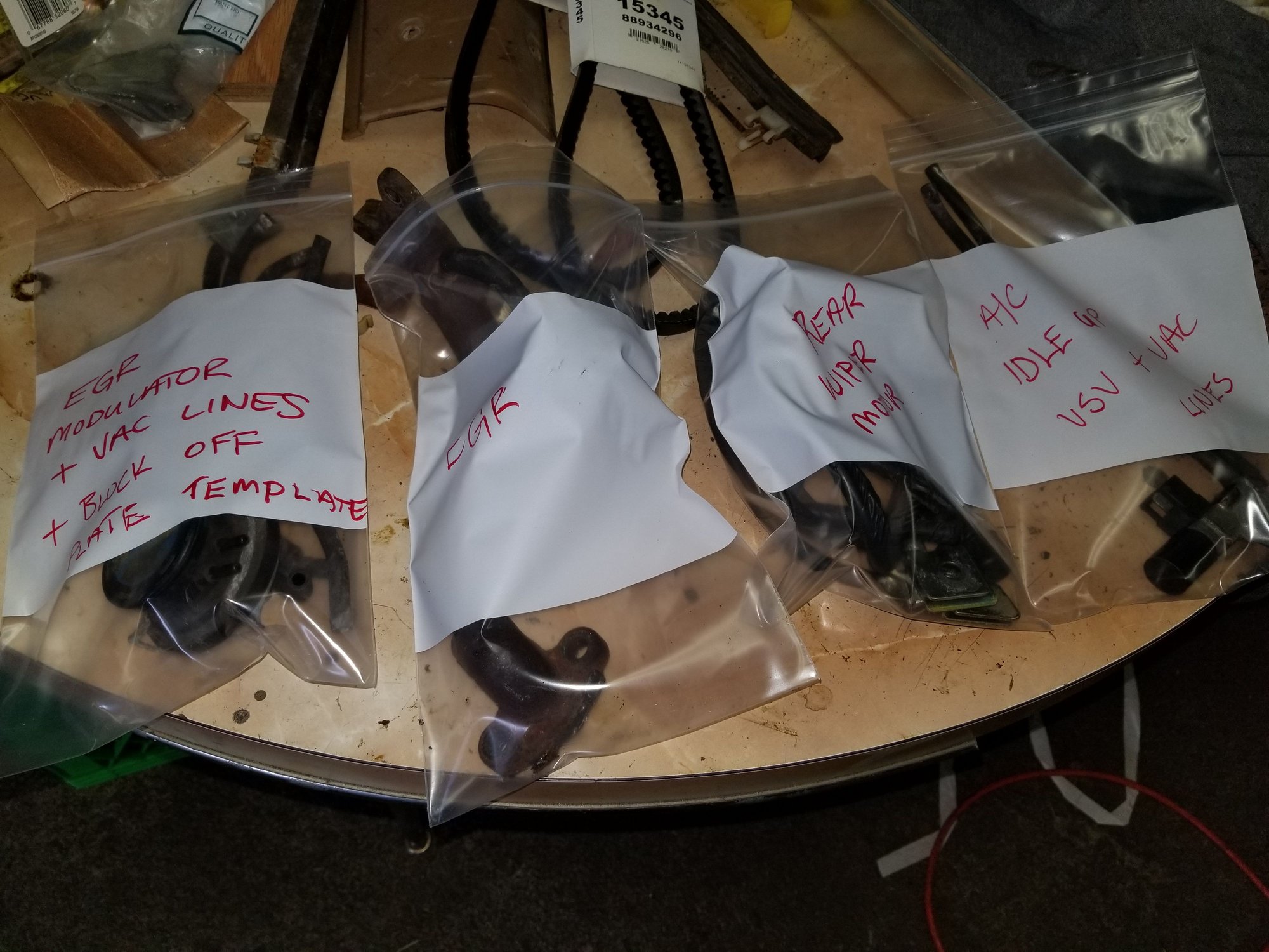

Other than that spent some time cleaning and organizing my shop.
Started bagging and tagging all the parts I've removed so far, just for organization purposes. I hate having things scattered all over, and if someone I know can ever use something it'll that much easier to find.

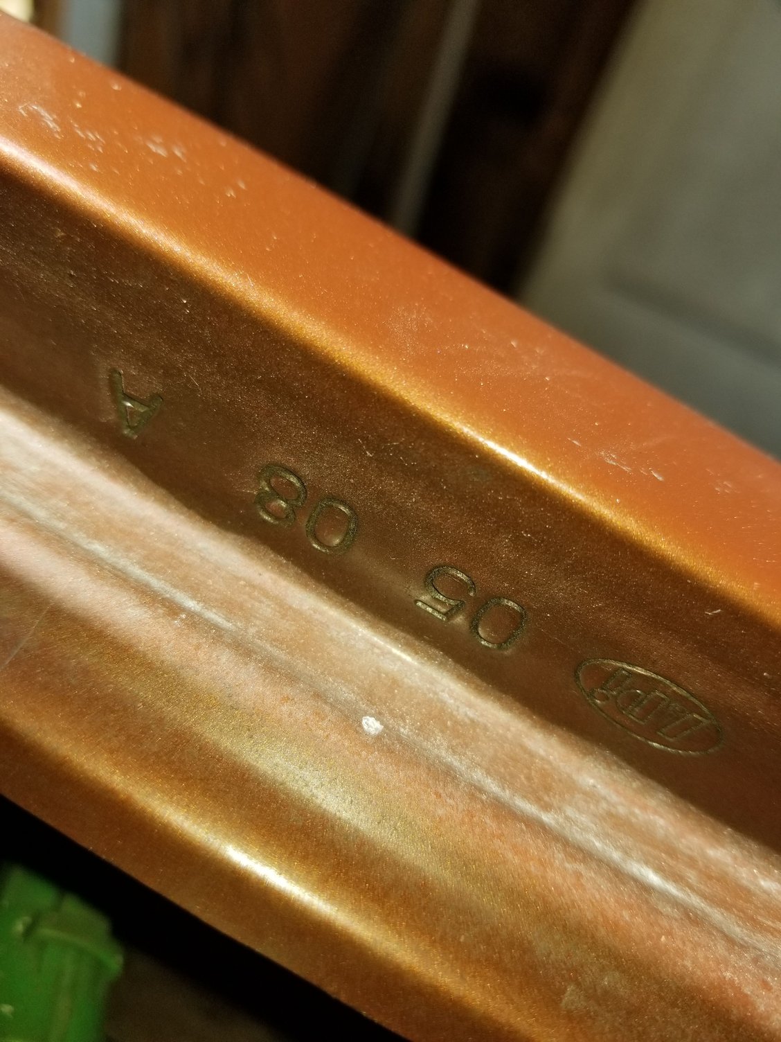

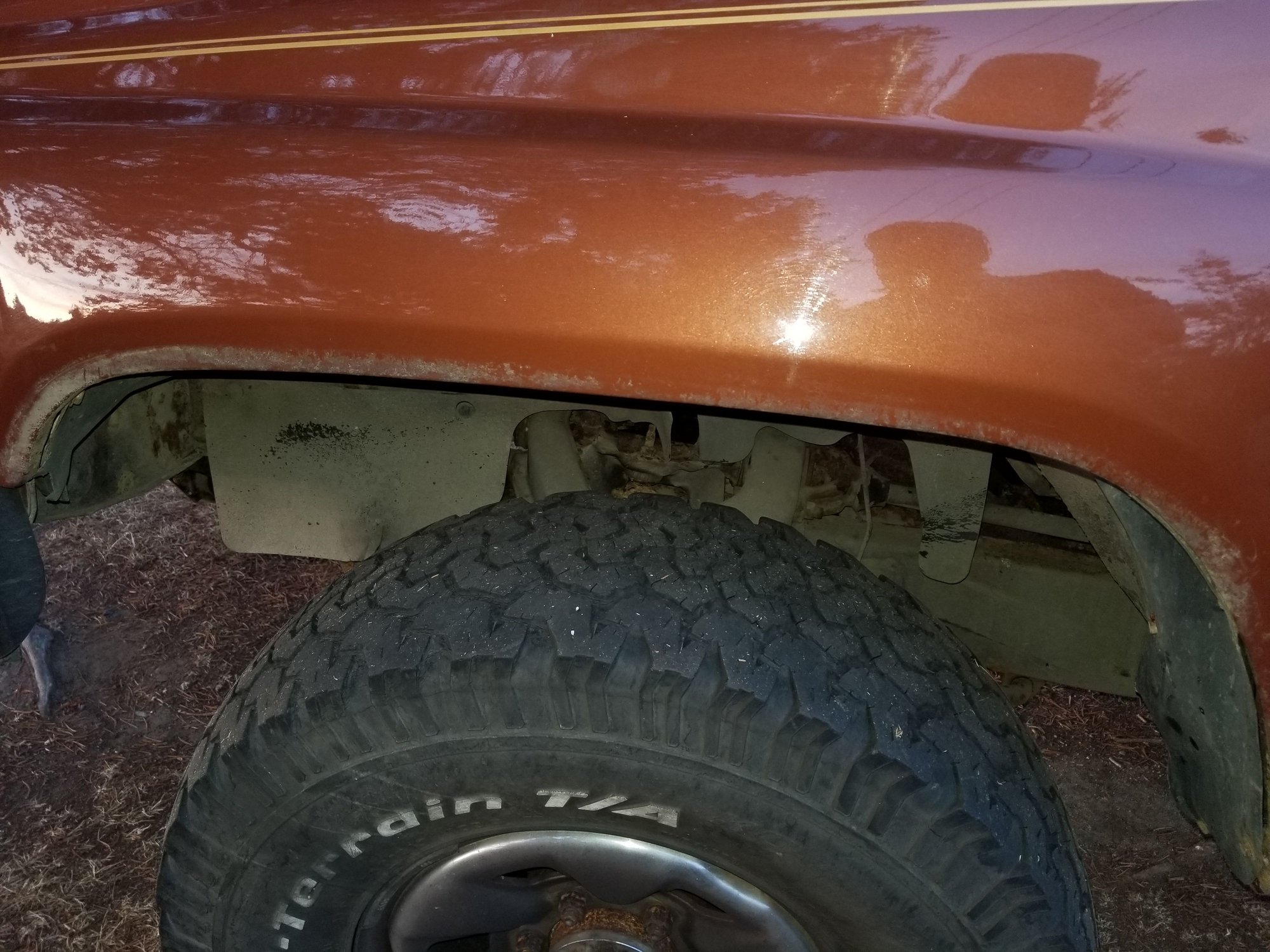

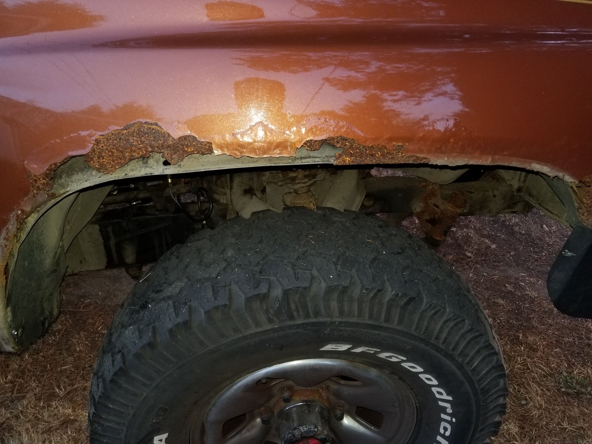

Started removing my chrome fender trim to assess rust damage and come up with a game plan. Originally planned to cut rust out from passenger fender and then cut the drivers to match it, but there is no way in hell I'm cutting up that perfect looking driver side fender! Will be looking at replacing the passenger fender instead, then colour matching.
Rockauto has fenders for around $70.00, anyone have experience using them?
I've been trying to track down where this driver side fender was ordered from, but it was done by a shop as an insurance claim, and the PO doesn't remember which shop it was.
Driver side
Passenger

Are there any marks on the top of the fender on the lip where the hood bumpers attach too?
There is a company name on the replacement fender on my brother's 1990 Toyota Corolla in that spot. Just a guess...

Good call, thanks old87! I'll see what I can track down with this.
