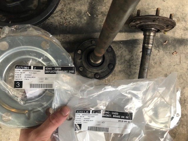

As far as I know, there is no gasket on the face of that axle flange where it meets the brake drum...but if there was one there, I really don't see how it has anything to do with gear oil.

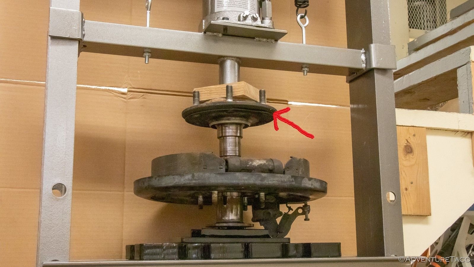

Hey Cory, thanks for the reply. It's not where it meets the brake drum, but between the lug plate and the axle plate. A picture below for reference. Not my truck.
Between those two plates?
It's extremely possible that the gear oil is from something else, or I somehow left a dab on there before assembling.. I would just hate to start driving it and saturate a brand new set of shoes. I may be over thinking things! I blame it on never having done axle work before!

I think you're right cory, I don't think gear oil could get anywhere near that gasket... not sure what I was thinking earlier.

Interesting that gasket is called a brake oil deflector gasket, and the plate is I guess the brake oil deflector....so it what, deflects gear oil from the brakes...and that oil has to leak out of the axle tube. I changed my rear axle bearings several years ago and I did not think twice about this. Obviously the inner axle seal is the real gate keeping gear oil inside the axle tube and away from your brakes, I'm not sure I would worry too much about this oil deflector gasket if I were you, if gear oil is oozing past your axle seal then it isn't because you didn't change this gasket.

Thanks cory. I agree, I'm not going to worry too much about it. I'm going to drive it and keep an eye on it. No gear oil oozing past the axle seal so far, so hopefully I did everything right when I replaced everything. Time will tell!
