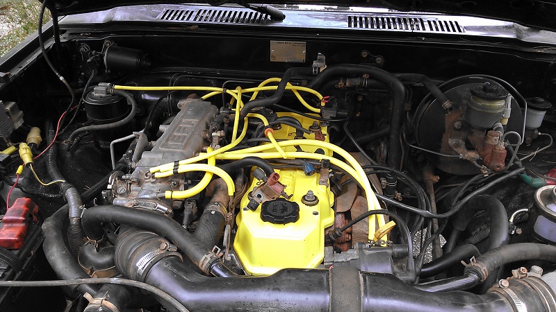

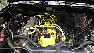

Currentish view of the engine compartment (with a busted vacuum switch that I since ditched):

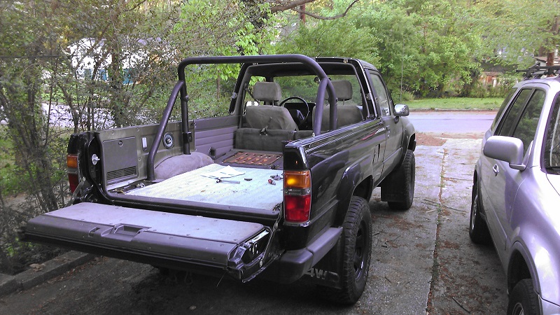

Topless (NSFW):

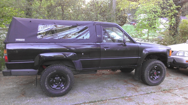

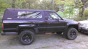

Top on (SFW):
Any tips for how to get the top to hang better? Those creases in the vinyl have me a little nervous for the long run, though they don't seem to be "setting in" at all so far.

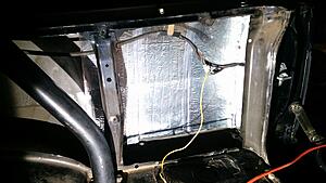

Sound deadening!

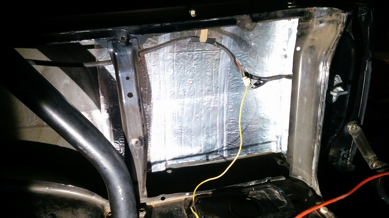

After reading through RAD4Runner's thread about his sound deadening and insulation project, I knew I'd want to do the same. It's loud as ˟˟˟˟˟ on the highway and this baby is going to see a LOT of highway miles driving up to TN and AL on expeditions. I started ripping out the interior a few days ago. It was actually a nice break after all the under the hood work. I could sit down, sip on a beer and just focus on not losing all the little fasteners!
All gone!

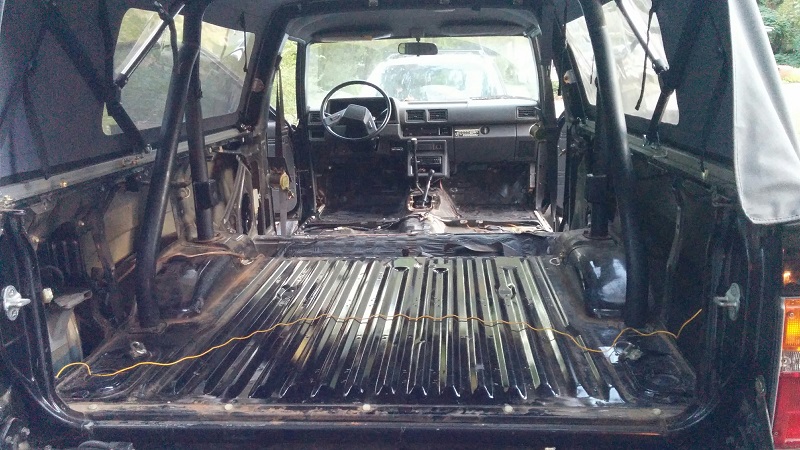

I went with U-Seal from Home Depot. I bought 6 rolls for a total of 75sqft. That plus a couple cans of Great Stuff, 3 rolls of aluminum tape and a $35 LED work light ran me $167. Not too shabby.
This little section must have taken me 30 minutes. I have GOT to get quicker at this, haha.
I figure the floor will go quickly and once I get a hang of it the sides should go quicker.

Wait...what are you using the Great Stuff for? I frequent a boating forum and restored an old Boston Whaler. Great Stuff will eventually break down and absorb and hold water from what others have said. You do not want to put that next to metal. Good job sound proofing otherwise. I just did it with Protecto Wrap (Peel n' Seal) in the doors and Frost King in the body sides. Be sure and leave drains open so water vapor can escape.
Dang, I didn't know that about Great Stuff, thanks for the tip. I figured I could use it to fill some gaps where I couldn't get the U-Seal. I worked on it some last night and didn't see any drains in the sides - they're somewhere on the bottom of the side "compartments" I guess?

Anywhere there is a pinch weld it seems to be left open in some places. I can confirm this because a while back I sprayed rust proofer inside and it leaked right out most of the bottom areas.
Some car restoration book I had a long time ago (Mustang) told you to take a wire coat hanger and open the weep holes at the bottom of the doors and body walls. Where my 4Runner rusted there was mud caked so people have to be very careful to clean the chassis after they get it muddy.

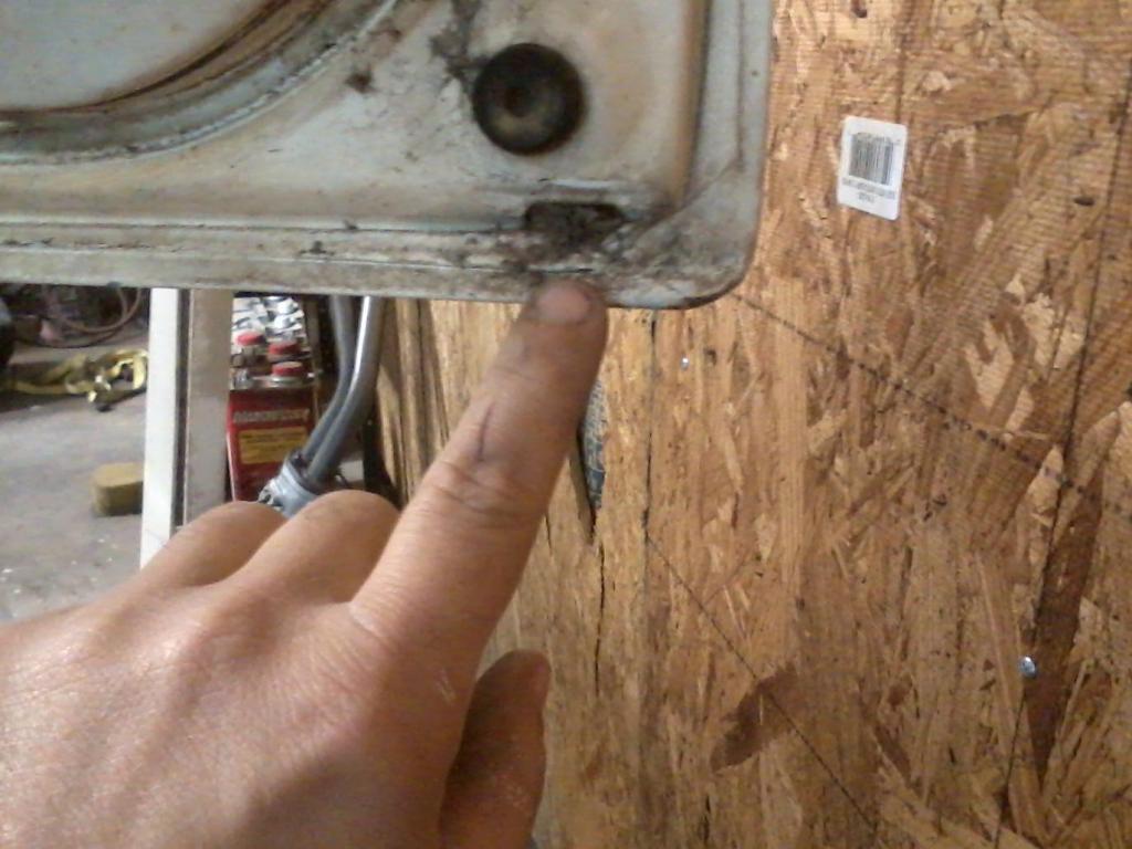

The drain hole behind the rear tire is kind of hard to find. In front of the rear tire they are easy to see. You can take the door seal off and looking thru the oval cut outs in the rocker panels, and looking at an angle you can see if they are clear. Probably going to find a lot of debris in the rocker panels. This is a view from the bottom side and on the inside of the rocker panel.
In the doors, you have 4 drain holes. I take the door panels off and use an air hose to get them cleaned out.
