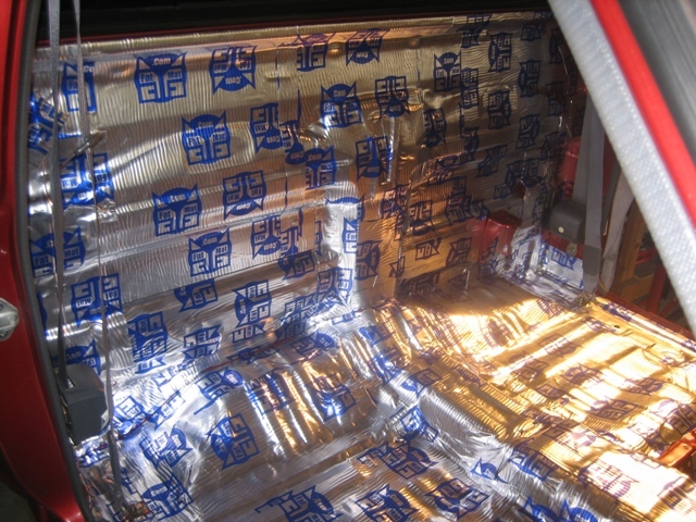

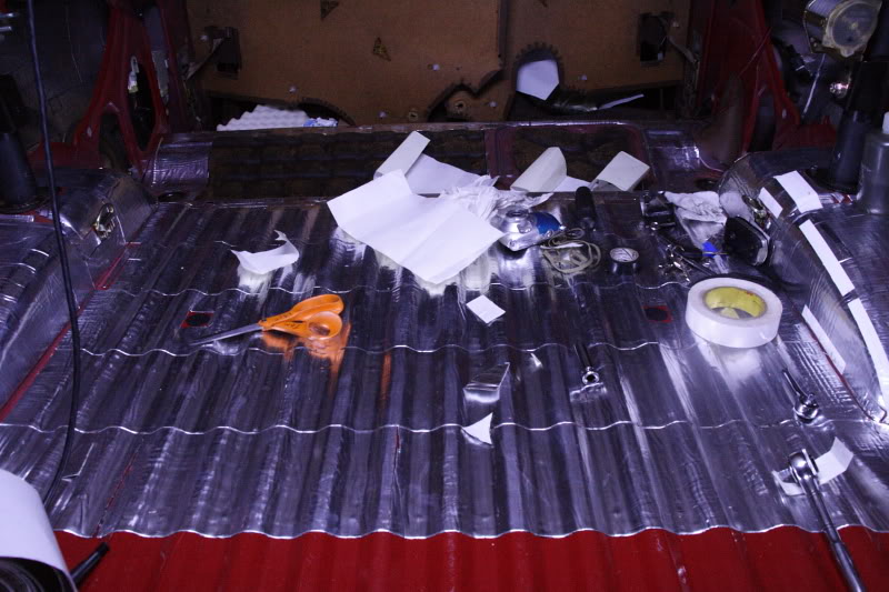

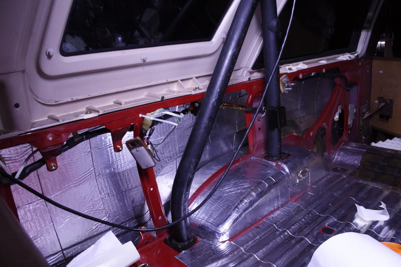

I'm in the middle of my sound-dampening/proofing project and have peeled off carpet and padding. Now, I'm left with some padding fiber stuck on stock tar sound-deadening on front deck.

Updates:
Steel Brush wheel on power drill worked well to remove fuzz fast.
For thermal insulation from engine and transmission hump heat, I used Thermo Shield thermal insulation padding from Pep Boys. Thanks, Chef, for the lead! It has fibrous padding and aluminum foil on one side.

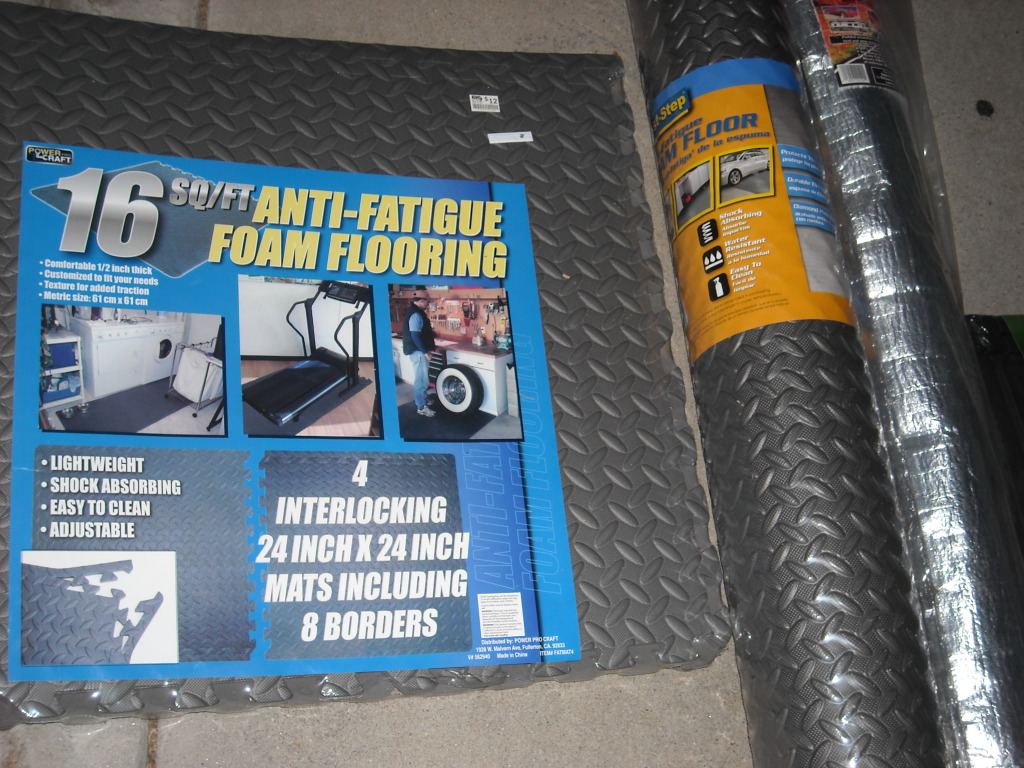

4' x 6' roll is enough to cover:
On left side, firewall, to rear passenger floor, and up the vertical wall juts short of where passenger seat bottom hinges mount. This will insulate from engine and exhaust pipe heat.
On right side, firewall to frame cross - member under front passenger's seat. The floor on back, right-side does not need thermal insulation
Transmission hump, from firewall under dash all the way to where floor rises to back seat bottoms.
For Rear Deck: Used Best Step closed-cell anti-fatigue mat from Sears. Trimmed to fit.

The above "after" pics accentuate how much space there is to potentially install a "Stealth" speaker and/or sub-woofer system. I'm brainstorming how to do it...
Use good quality 2-way speaker and possibly add a powered sub later.
Also build-in a sub woofer enclosure into that space.
Build-in a real enclosure? Advantages are:
Significant improvement over simply mounting even good speakers on flimsy stock panels.
Real enclosure is additional barrier between passengers and vibration from side body panels. Add to that the dampening I could add between back of enclosure and body panel.
Possible construction methods are:
Make and pre-assemble enclosure then install in space if it will fit. OR
Design so walls of enclosure will wiggle into opening, then assemble after they are inserted into space. If not,
Fabricate fiber-glass enclosure to fit space. Could be messy, and I have no experience doing that.
Also considering replacing rattly plastic rear side panel with plywood with sound absorbing foam backing.
