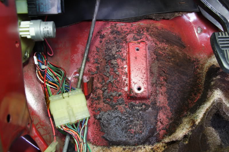

P&S on bare Metal or Painted Metal?
On Terry's thread...
WOW, ... you ARE Crazy after all!
Yes, crazy indeed with lots of patience!
Terry & guys, got a quick question for you bodywork experts.
Brake fluid from clutch master cylinder stripped paint so corner below clutch, next to kick panel had some rust.
I wheel brushed it and only have tiny pits (dimples) with little rust left. I plan to use
Permatex rust treatment Permatex rust treatment
. After treatment, I need to apply Peel & Seal for sound deadening.
Tar is also rust preventive (oily & seals air out). Do you think I should prime and paint that corner or shall I simply clean thoroughly and put P&S directly on bare metal?
TIA,
Ray

Wish I had more to add on this........ I personally peeled my brake fluid eaten floor panel down to metal, Rustoleum Primered and then Rustoleum Ford Red Painted the floor. You literally CAN NOT TELL it's been done. I'll take pics when I do the fuse block work. (THANKS ON THAT, BTW, RAD, ... YOU ROCK in the E-E STATUS DEPT.! HAHAHA. HOOAH! )
