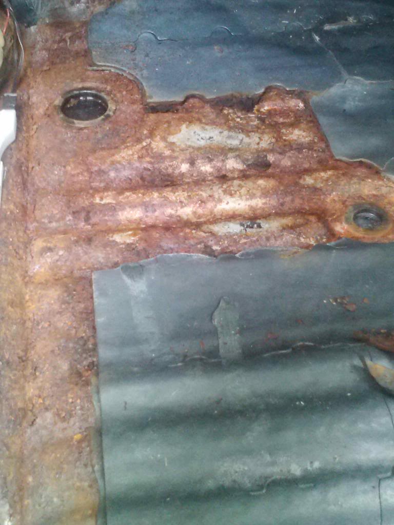

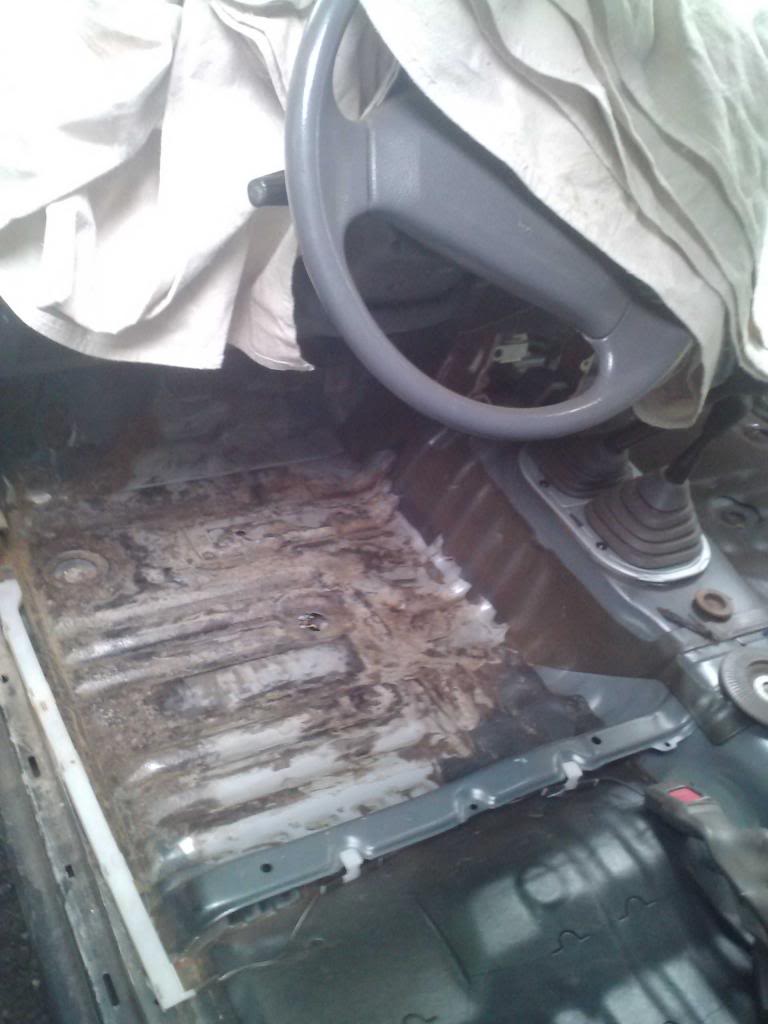

This what I started with.
Previous owner had allowed carpets to stay wet/damp. Luckily only surface rust.
Had to chip away all drivers side soundproofing to ensure all rust treated.

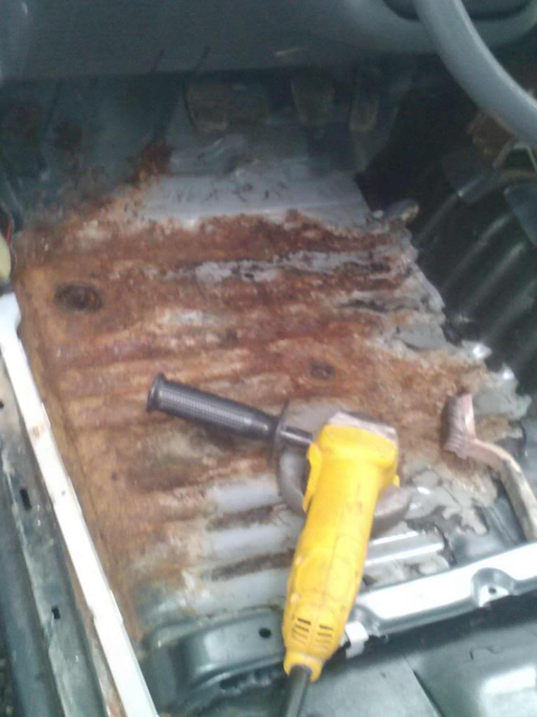

After grinding/wire brushing all the rust I applied two coats of Eastwood rust converter.

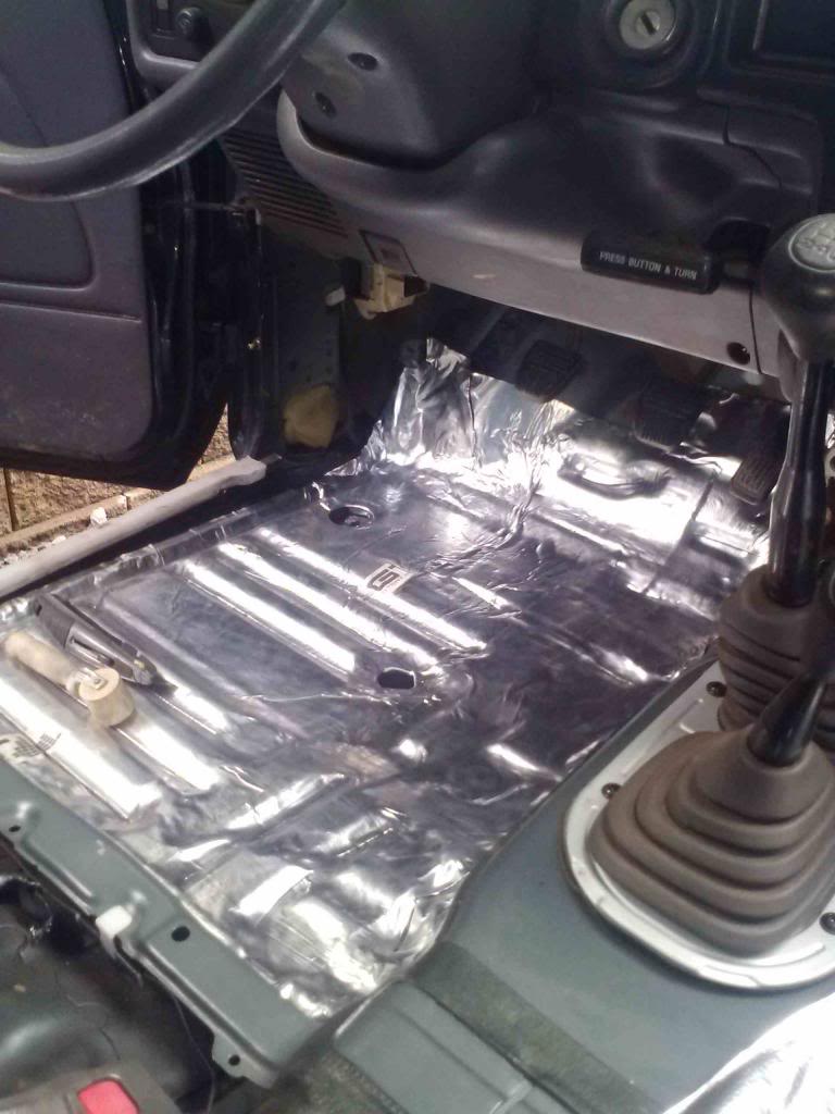

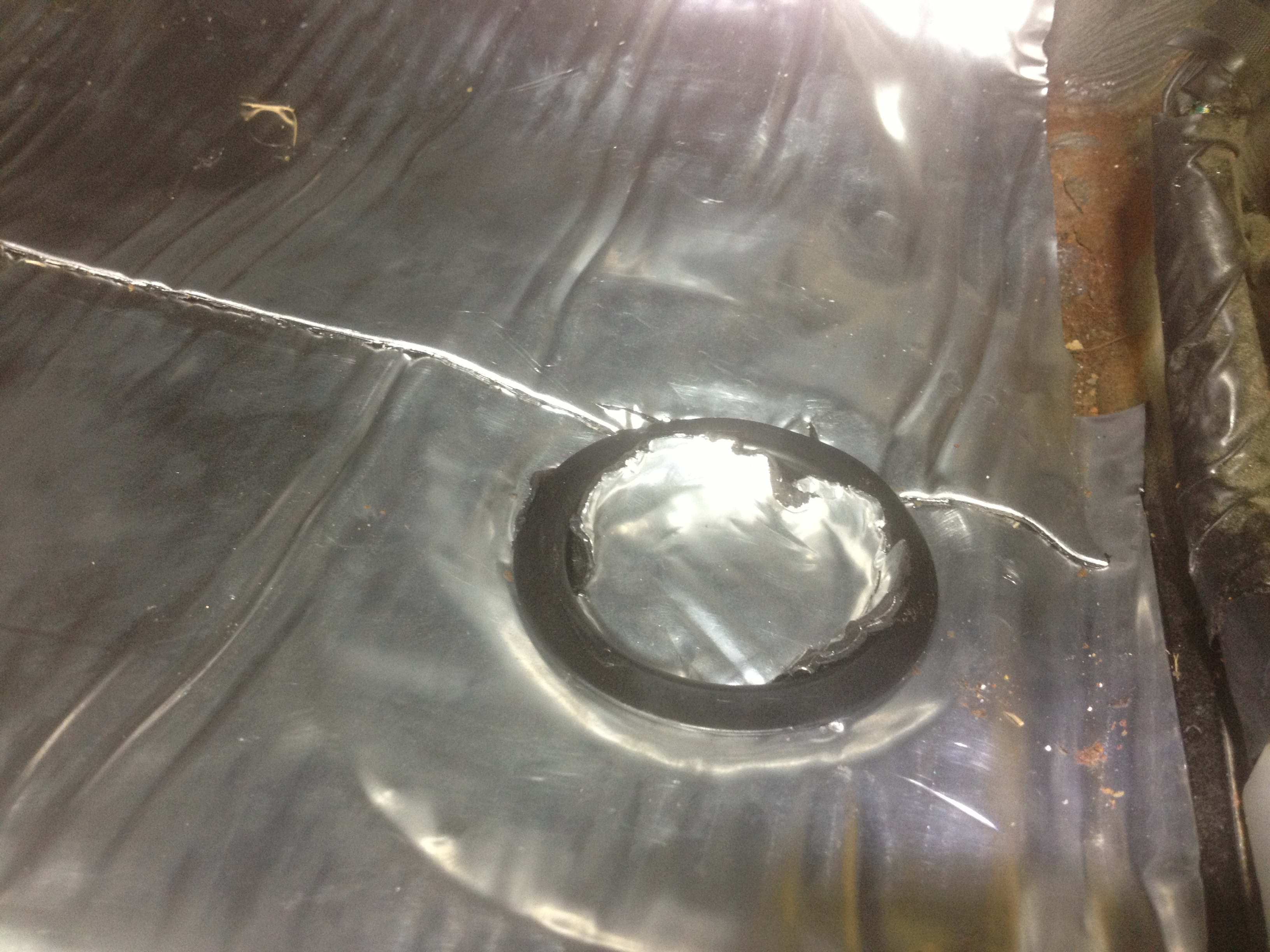

Then applied GT Mat 50
It's a tough job getting the mat to fit all the contours of the floor pan. If I was to do this again I would rather use a soundproofing paint if possible. Or look for a product that will mould more easily to the contours. I'll be keeping an eye on it after each winter.
Fearful of water getting under that product and just sit there chewing away at my metal.
I ordered 100sq ft of this stuff and 50 was plenty to do the driver floor pan, under the seats and the back panel [Reg Cab 1994 Pickup]. Cabin has a plusher quieter feel to it.
Although without a decibel meter hard to quantify the improvement.
