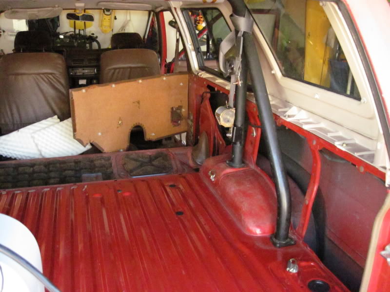

Turns out the first-gen 4Runners have absolutely no sound-dampening treatment inside the side body panels. Therefore, even a little bit of the lowly P&S will have significant benefit.
The above "after" pics accentuate how much space there is to potentially install a "Stealth" speaker and/or sub-woofer system. I'm brainstorming how to do it...
Use good quality 2-way speaker and possibly add a powered sub later.
Also build-in a sub woofer enclosure into that space.
Build-in a real enclosure? Advantages are:
Significant improvement over simply mounting even good speakers on flimsy stock panels.
Real enclosure is additional barrier between passengers and vibration from side body panels. Add to that the dampening I could add between back of enclosure and body panel.
Possible construction methods are:
Make and pre-assemble enclosure then install in space if it will fit. OR
Design so walls of enclosure will wiggle into opening, then assemble after they are inserted into space. If not,
Fabricate fiber-glass enclosure to fit space. Could be messy, and I have no experience doing that.
Also considering replacing rattly plastic rear side panel with plywood with sound absorbing foam backing.
Man! All these ideas are distracting me from my much needed Zuk prep! LOL!
if you are confident you could build a fiberglass enclosure that would definitely be your best option if you wanted to go with the stealth/minimalistic approach... there are tons of tutorials out there that can easily be found via google.
p.s. if other than mat and padding, sometimes you just need to fill an open void or ten... I would HIGHLY recommend "great stuff door & window", it comes in a yellow/ red can and stays soft(ish) after it expands. Unlike the original "great stuff" which can break things

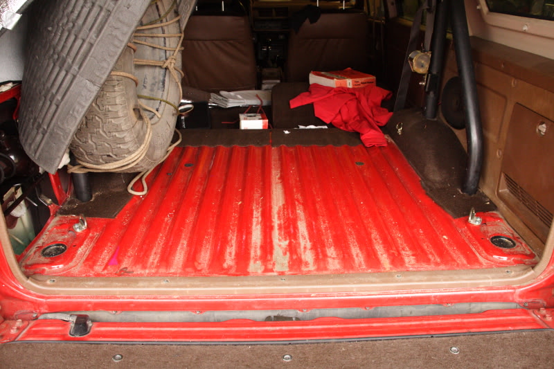

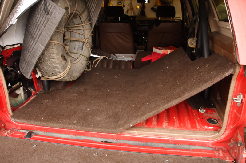

Thanks for the input, guys! Steel brush wheel surely worked. Best on hard cold tar otherwise fuzz sticks to soft tar.
For isolation/echo absorption, I think I'm gonna go with a layer of Ensolite on top of old (but washed) padding, then put carpet back on top of it. My reasoning- air and jute under the Ensolite will trap more noise.

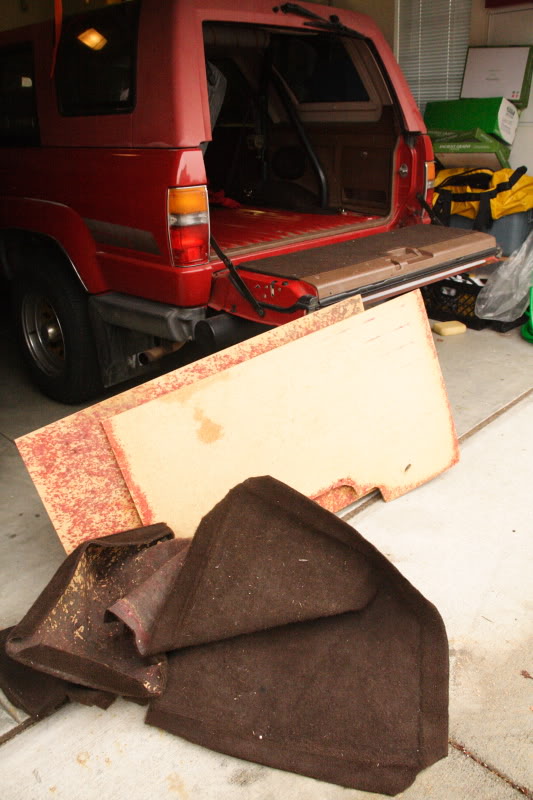

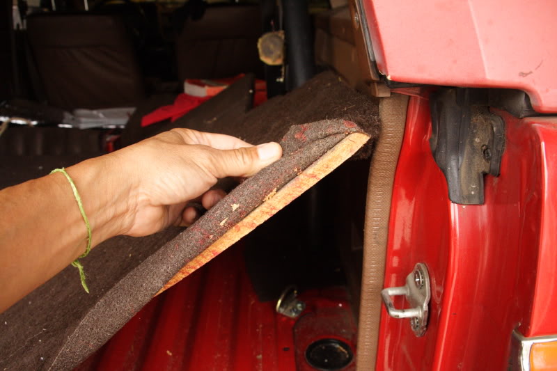

I just had my side panels off like that (mine's an '88 SR5) and what I found was a thin layer of spray on sound deadener from the factory--I wonder if it's an SR5 thing? I don't see it in yours Rad4Runner, but it is very little and almost hard to see in mine. Yeah, these early SUVs were pretty sparse on the sound deadening for sure.

Oh, and I saw someone post earlier about how sound deadening needs to be stuck right to the metal to work. Now maybe I read that wrong, but that statement is only partly true.
As long as your factory tar deadening is in good shape and seriously stuck to your truck, there is absolutely no need to remove it. If it is dry, cracking and popping off--you should remove what you can.
As long as all the layers are stuck together and stuck to the metal, you are good.
You can then add more mass sound deadening over it for even more sound deadening. More mass=greater sound deadening.

My deck happens to have this liner of 3/8-inch thick particle board wrapped in carpet (looks stock).
It weighs 20 pounds, and I don't plan on loading a dryer or washer in there so out it goes.
Virgin Deck (except from sand from carpet liner):
