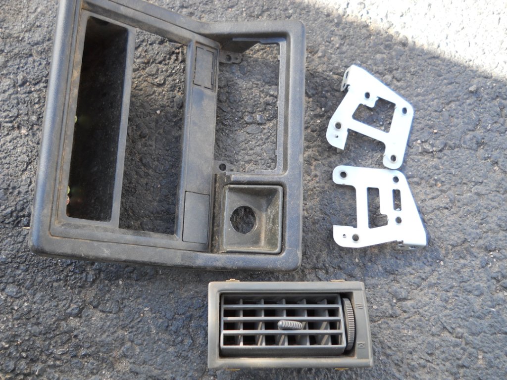

picked up some goodies at the local salvage yard
i found the only unmolested radio bezel in the yard!

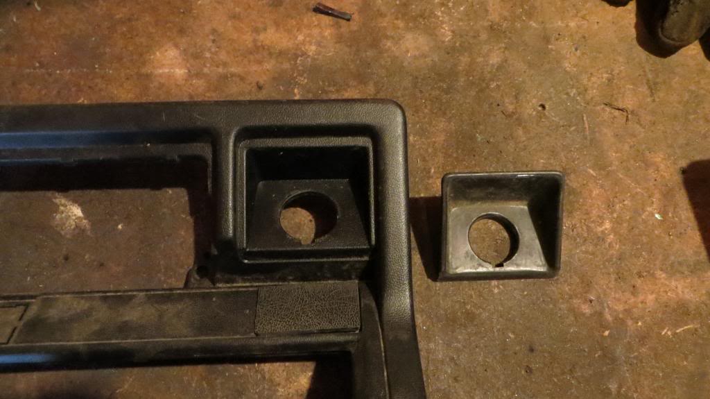

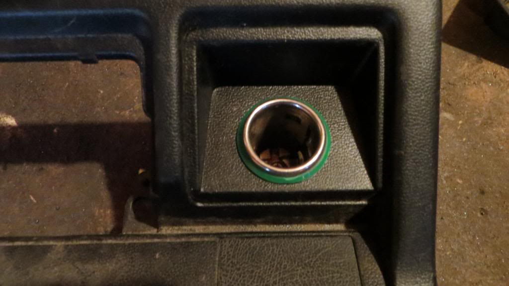

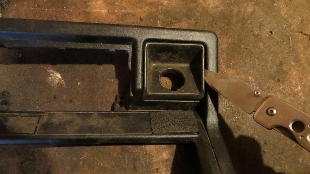

I picked up a lighted cigarete lighter with the new radio bezel, unfortunately it didn't come with a lighted one originally and the hole is too small. after filing on it for a few minutes, i discovered that there is a steel plate that is pressed into the hole to make the non-lighted plug fit. makes sense from a production standpoint, that way they only have to make 1 radio bezel for both sr5 and base models. so all you need to do the retrofit is a pocket knife and some wire connectors
more pics to come

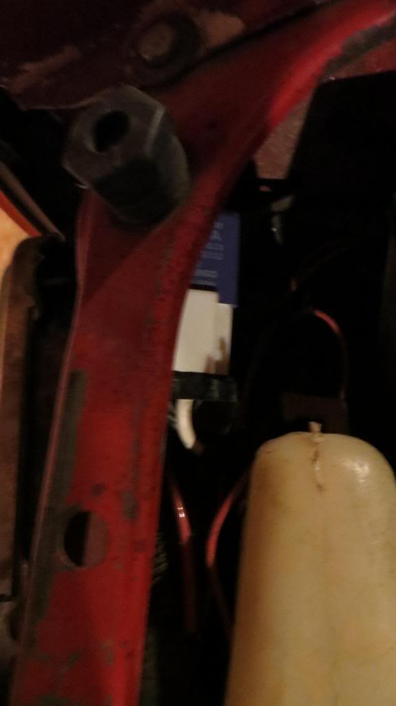

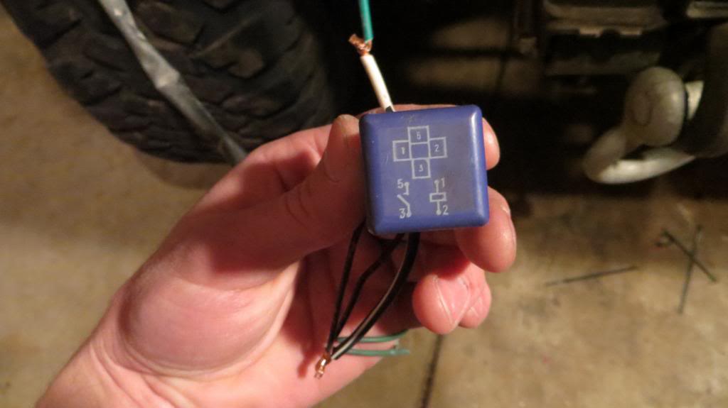

i also decided to do a horn upgrade. i've always hated toyota horns, so i swiped the horn from a suburban my brother was parting. it was a fairly simple upgrade, i just used a factory toyota relay out of an old wiring harness

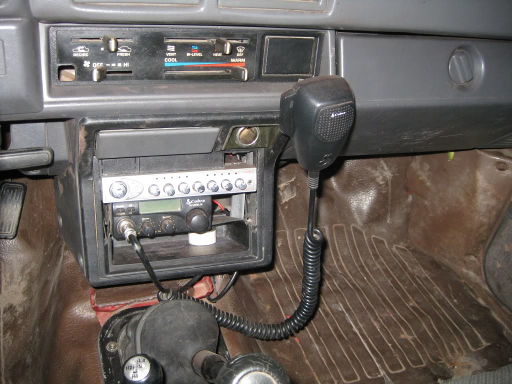

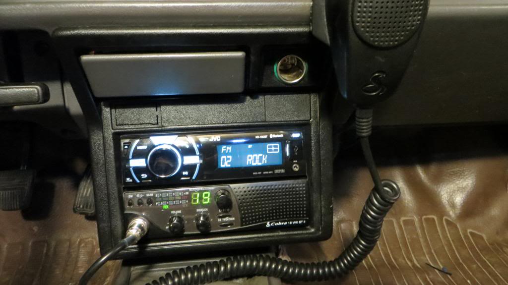

finished up the radio and cb install. i'm pretty happy with how it turned out, looks a lot cleaner
BEFORE:
AFTER:

Wow that looks clean!!! You've just convinced me to attempt an install like that!
thanks, now that my interior is starting to come together i'm anxious to get new carpet in there too
Old Mar 1, 2013 | 02:59 PM
  #128
Orion22rte's Avatar
Joined: Feb 2013
Posts: 149
From: eastern nc
Did you paint the dash plastic? What did you use cuz in the pic it looks like fresh from the factory looking plastic. My entire interior is blue... I'd much prefer a black or at least dark grey interior.

do you mean the radio bezel or the grey dash trim? the only thing i've painted is the dash pad but its not shown in the pic. i just clean everything with armorall

That would explain why it looks factory! Lol , yeah, I think the lighting is different too and with the armorall it looks really fresh and clean. Looks really good black tho, I might try to paint my blue dash if I could have it come out pretty decent

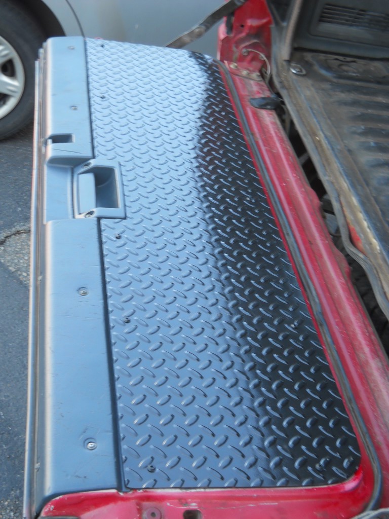

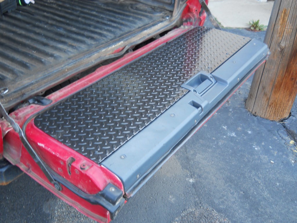

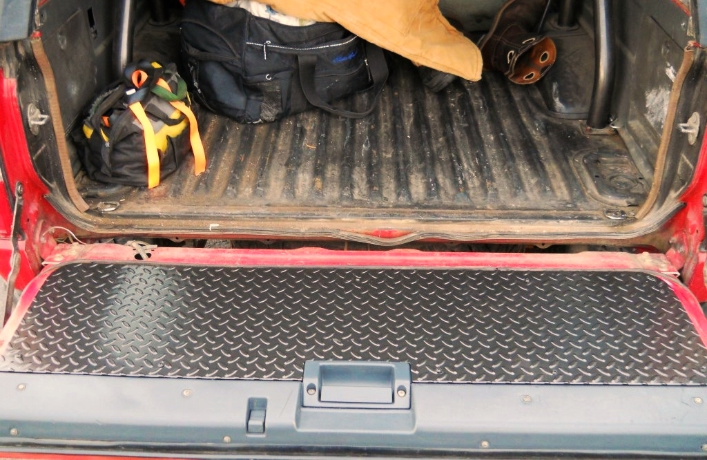

I also made a tailgate cover plate. I didn't take a before picture, but the old one was a nasty piece of what was once carpet, and the plastic trim was brown. I used SEM graphite paint on the plastic...not sure why it looks blue in these pictures but its actually dark grey
Its made from 11 guage steel. I wanted to go with aluminum since its a lot lighter but i wasn't willing to pay the extra money for it. in the end, i'm glad i went with steel cuz i had to weld and re-drill a couple of the holes haha.
I was afraid of getting some road noise after removing the carpet cover so lined the back of it with this:
Its supposed to be a budget friendly sound deadener, we'll see how well it works

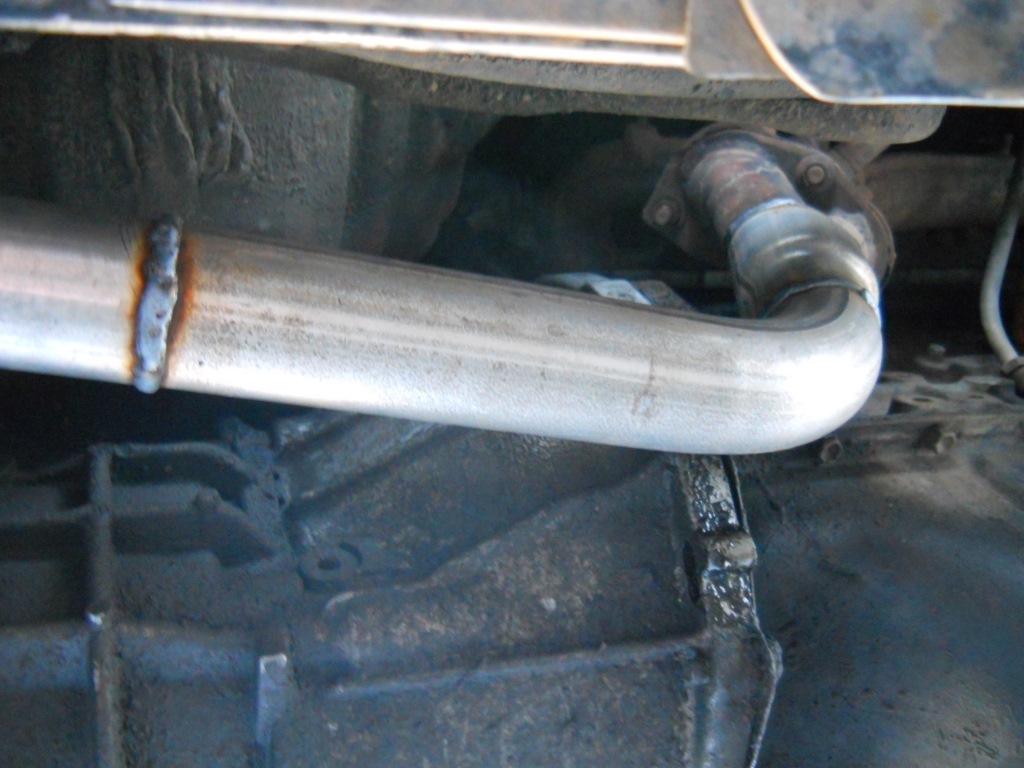

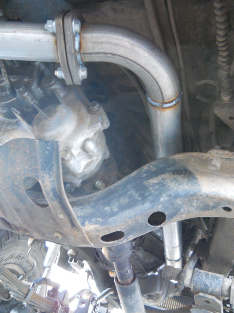

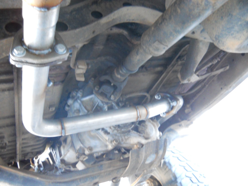

got my truck back this morning from getting some exhaust work done. 2" mandrel from the manifold back. still need to do the muffler (didn't want to pay them to do it) but so far i'm liking it a lot
x-over- had them put a flange on each side so i can pull the trans
