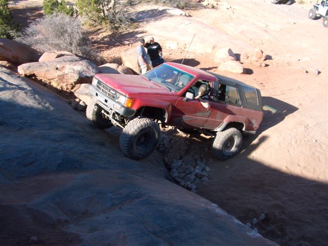

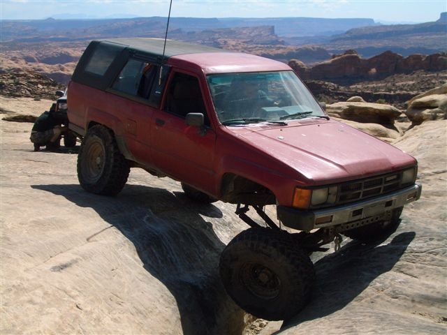

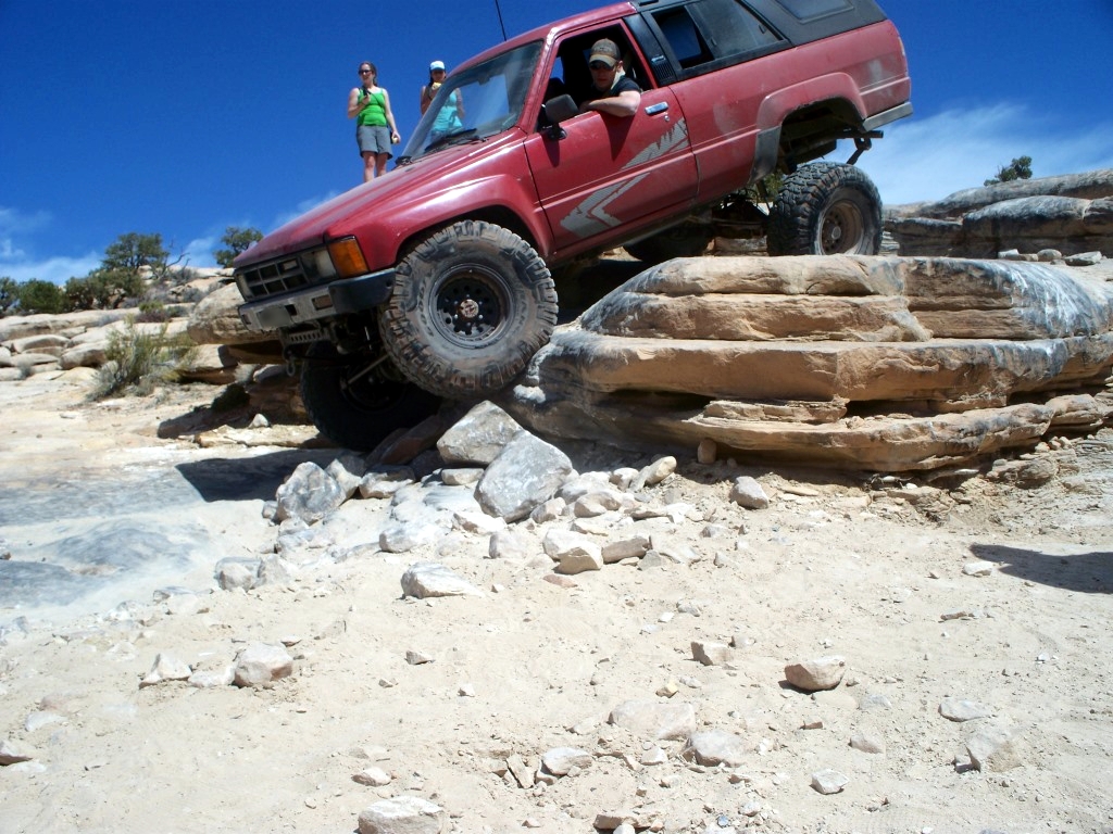

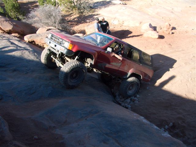

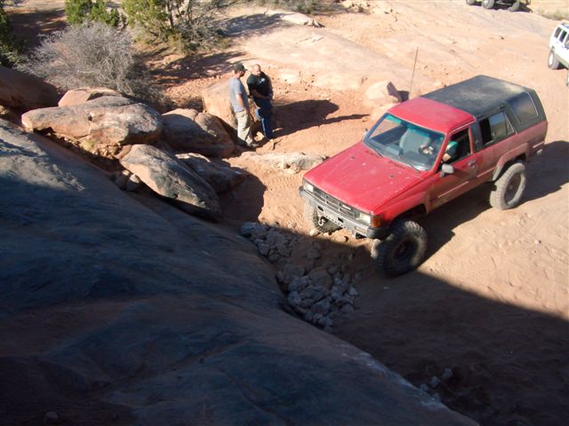

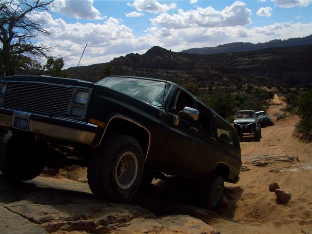

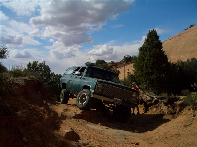

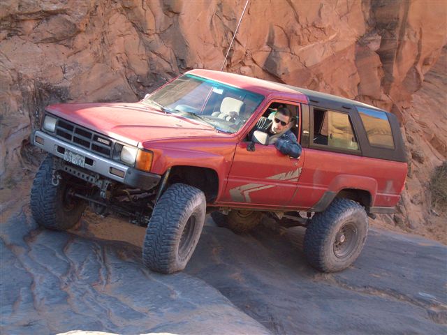

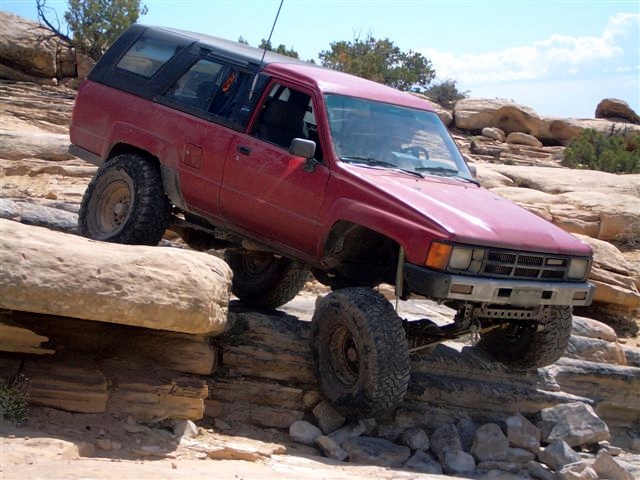

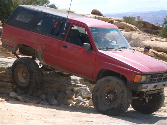

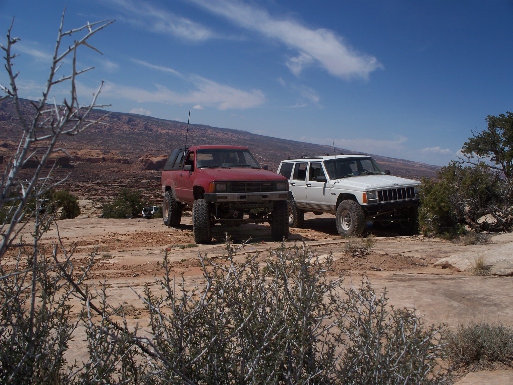

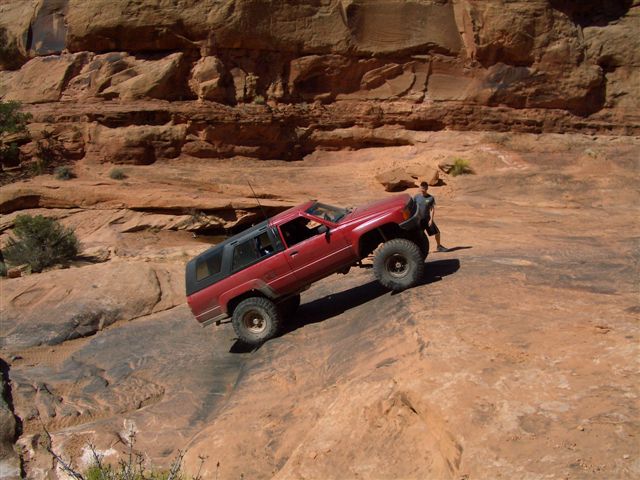

Trip was awesome. haven't got all the pictures uploaded, but here's a preview:

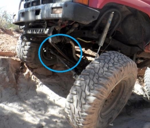

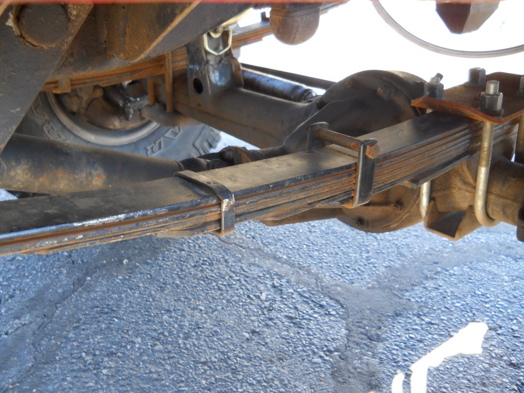

I noticed that there was a lot of wheel hop in the front end on steep climbs. I believe its occuring because of this:
anytime the front end unloads, the leaves separate and "fan" out. then, when torque is applied, the axle wraps since the spring pack has nearly zero resistance at full droop. so i'm in the process of adding spring clamps.

Moab looks like a nice trip. How cold were the nights, the days looked perfect. I've been wanting to make it to Moab for many years; I will make it eventually. I look forward to more pictures.
I agree with your leaf separation theory, looks like you need to cllamp that section up.

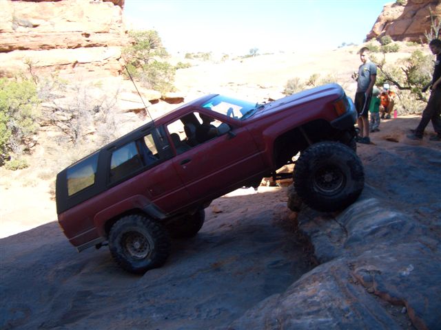

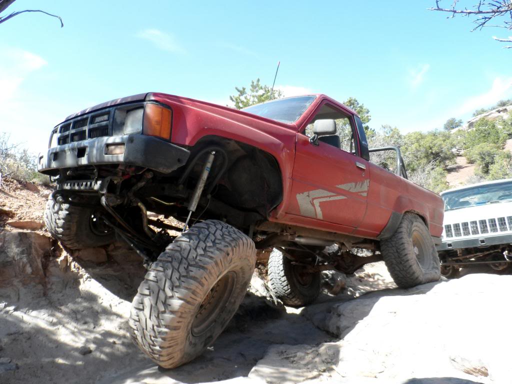

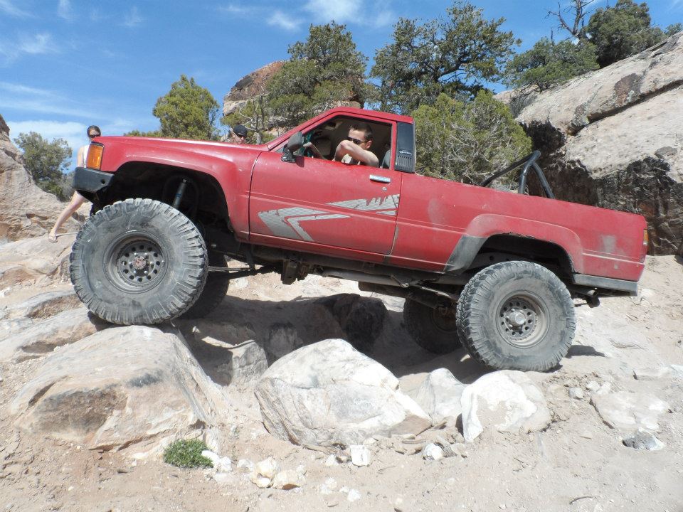

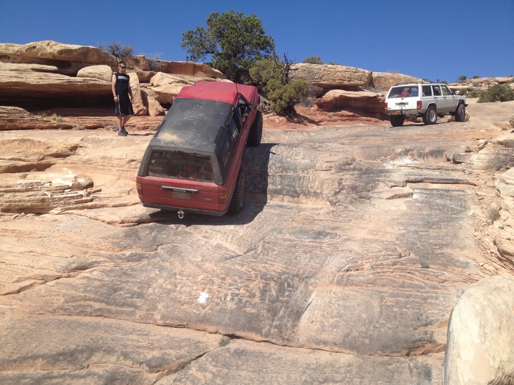

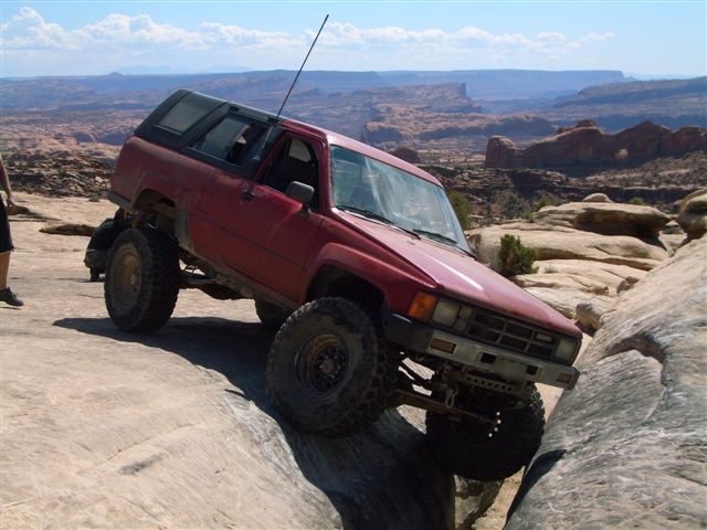

heres more pictures:

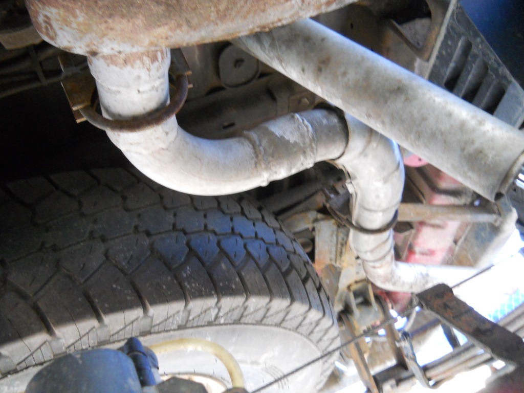

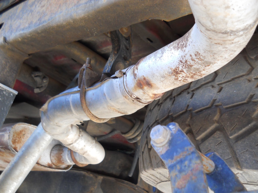

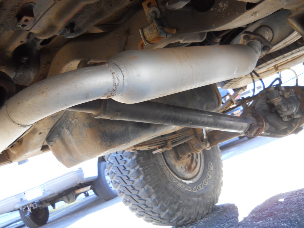

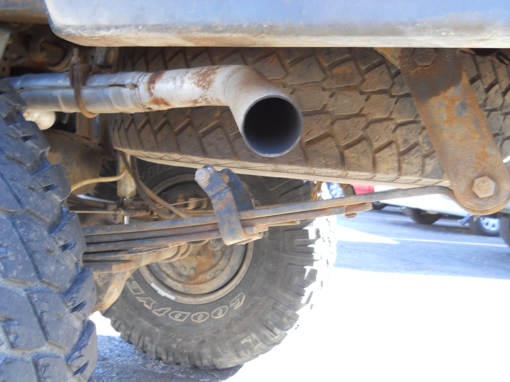

Grabbed some pictures of the finished exhaust, its already starting to rust after only being on there a month and a half. i think next time i get exhaust work done, i'm going stainless!
built this out of used scrap 2" exhaust pieces i rounded up. I learned its VERY hard to weld old exhaust tube.
Magnaflow glasspack into a summit racing chambered muffler (equivalent to the thrush)
I routed it around my rear shock using half of a "Y" pipe from a 1uz lexus that my friend was throwing away.

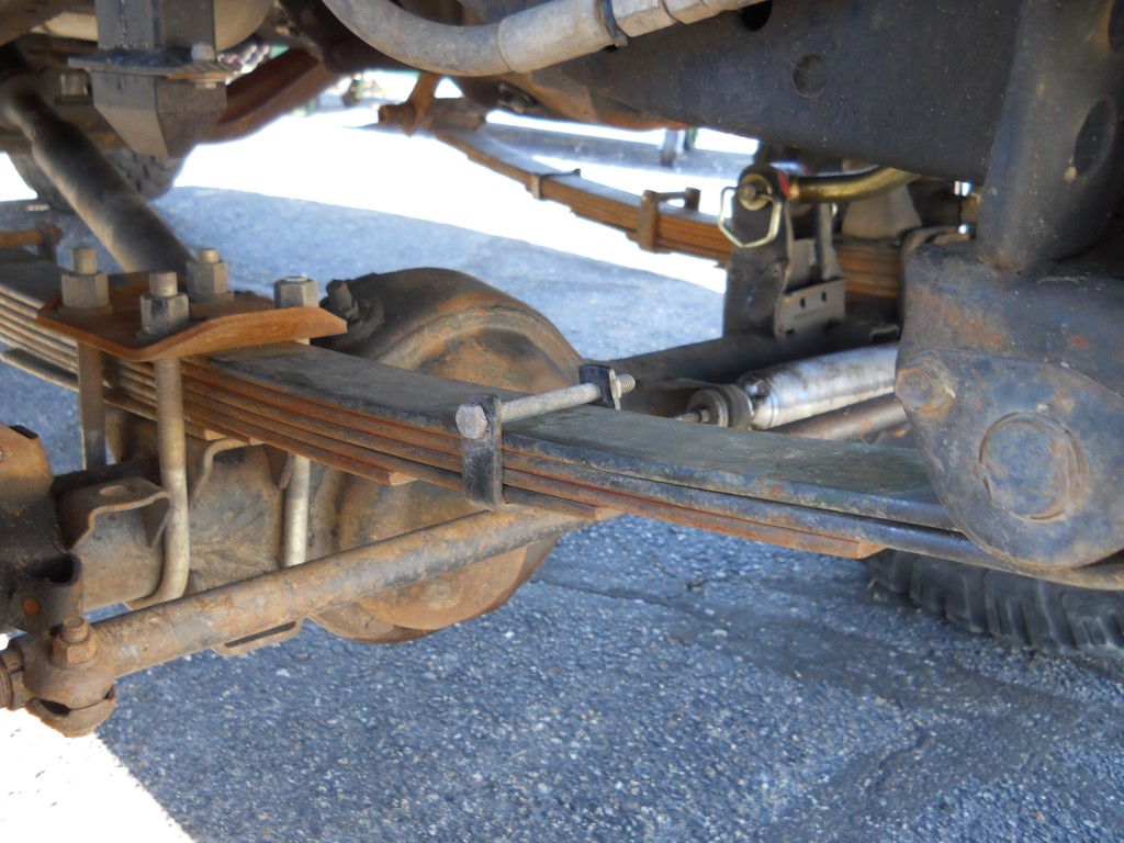

Here's the spring clamps i fabbed up. added one to the front and a second one to the rear of the front spring packs. this should eliminate the wheel hop i was getting

Nice work on the exhaust, it turned out really good! You can come down and do mine, I still haven't finished running it out the back, lol!
I like how you did your leaf spring straps, I still need to do that with my front leaf packs.
