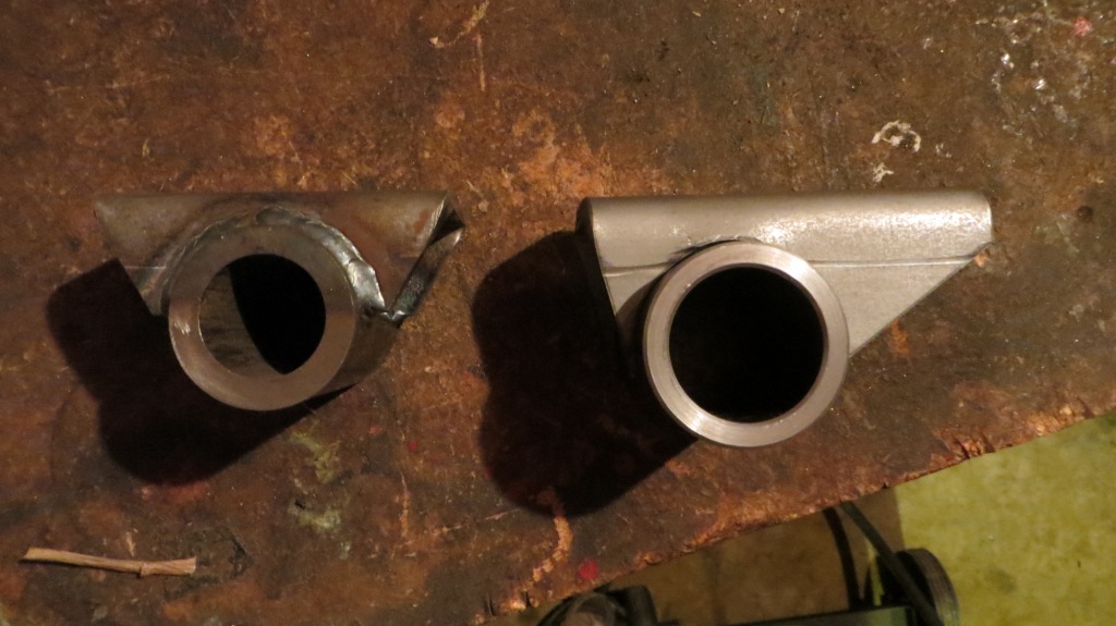

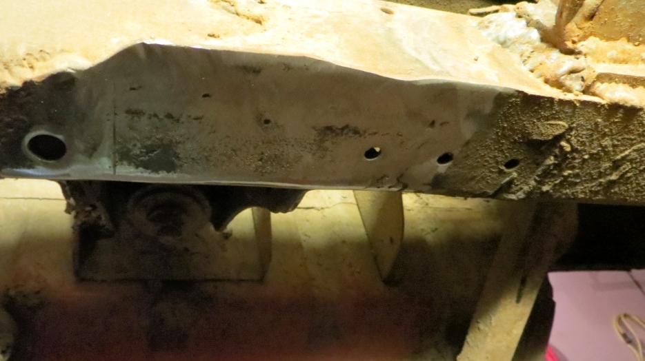

Truck has been down for a while now, while i searched for the correct rear leaf springs. the 3/4 ton chevy springs i bought would require some trimming and i kinda want to keep the plastic spring pads as stupid as that may sound... i don't like squeaks! every 4 leaf chevy spring pack i've found is 60" long instead of 64" which doesn't make any sense to me... so either chevy made 2 different lengths of leaf springs for their trucks, or all these salvage yards are full of crap and they're trying to sell me suburban springs. frankly, i could believe either. regardless, i've decided to rethink the problem. my shackle angle has always been a little to shallow, which makes the springs a lot softer. so my new strategy is to move the shackle hangers back a couple inches. i need to replace them anyways with standard ones. A little background, when i did my chevy spring swap 3 years ago, i used revolving shackle mounts thinking it would get me some extra flex.... terrible idea! the revolving shackles made handling a nightmare on the road, the rearend would "walk" on me! these things actually made the list on JP magazines worst 4x4 products!
I decided to replace the bushings while i had the springs out. had to use a cutoff wheel on the spring bolts, its amazing that they have only been in there for 3 years!
cut off the old
The new hangers are from ruff-stuff-specialties; part of their chevy spring swap kit. they are offset to allow for a better shackle angle.

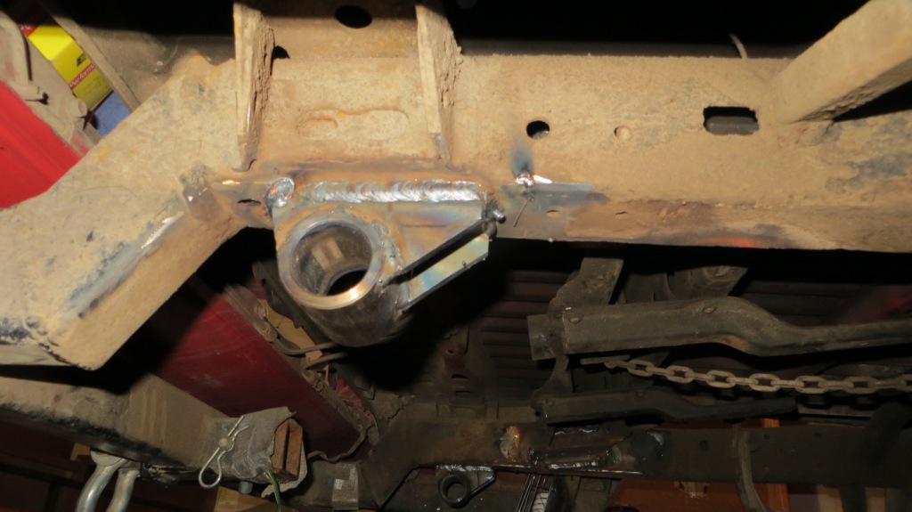

welded on:
The off-set hangers ended up moving the mounting location 1.25" back from where it was, which should give me some added stability and load capacity.

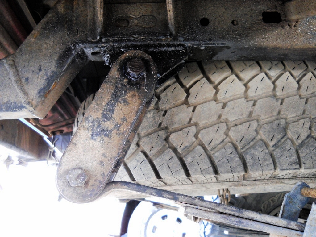

Got the springs back on last night. Drove it to work today, i'm really impressed with the handling. the back end feels a LOT more stable with the new bushings and the steeper shackle angle.
new shackle angle:

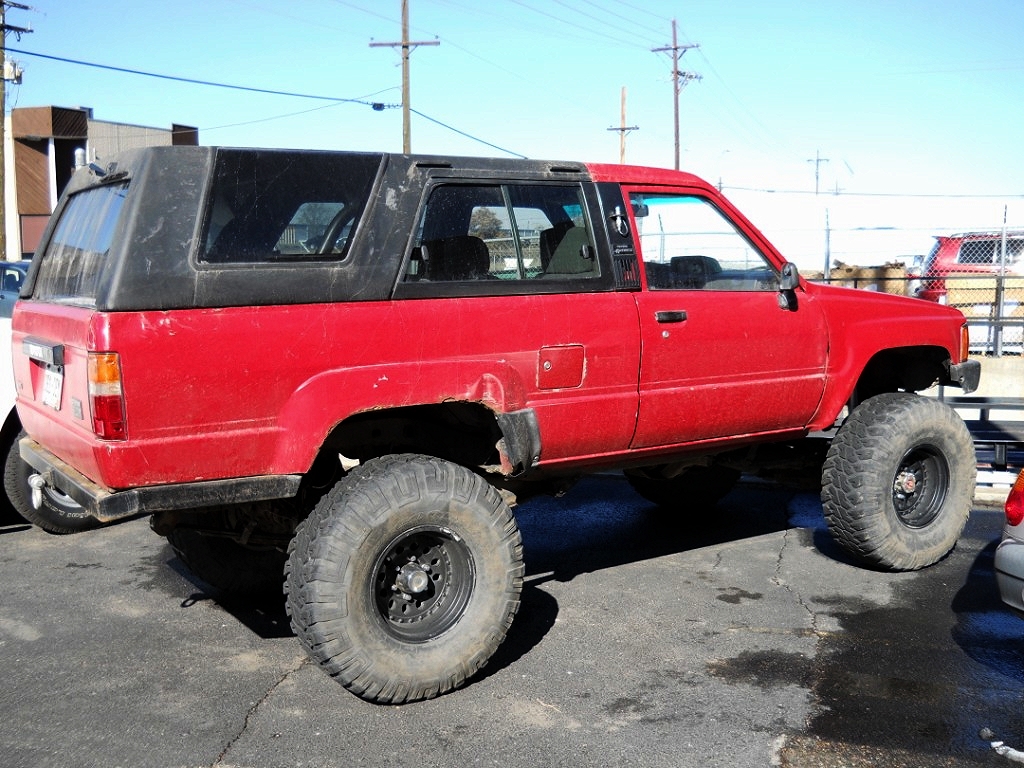

ride height:
I think i gained about 1/2" in the rear
