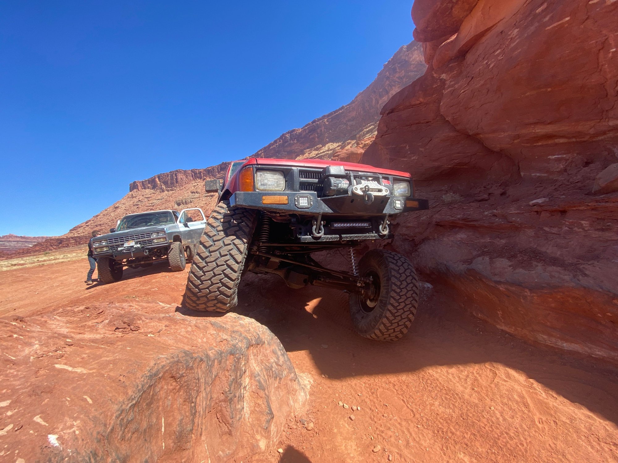

Worried about that front driveshaft angle at full droop at all?

that pic has the axle sitting on the ground, i just did that for dramatic effect, it won't have that much droop. i'm running 14" coils with 5" of uptravel, so 9" of droop.
To your point though, DS angle is partly why I'm not a fan of how long the lower links are with the TG kit.

Moab went well for the most part. the shocks are not tuned quite right, so i'll be pulling them apart to add shims with help from some of my local friends. i'm also going to be swapping the primary coils for lighter ones to get the ride height down a little, but overall i'm happy with the setup. the nice thing about coils is everything is adjustable!
