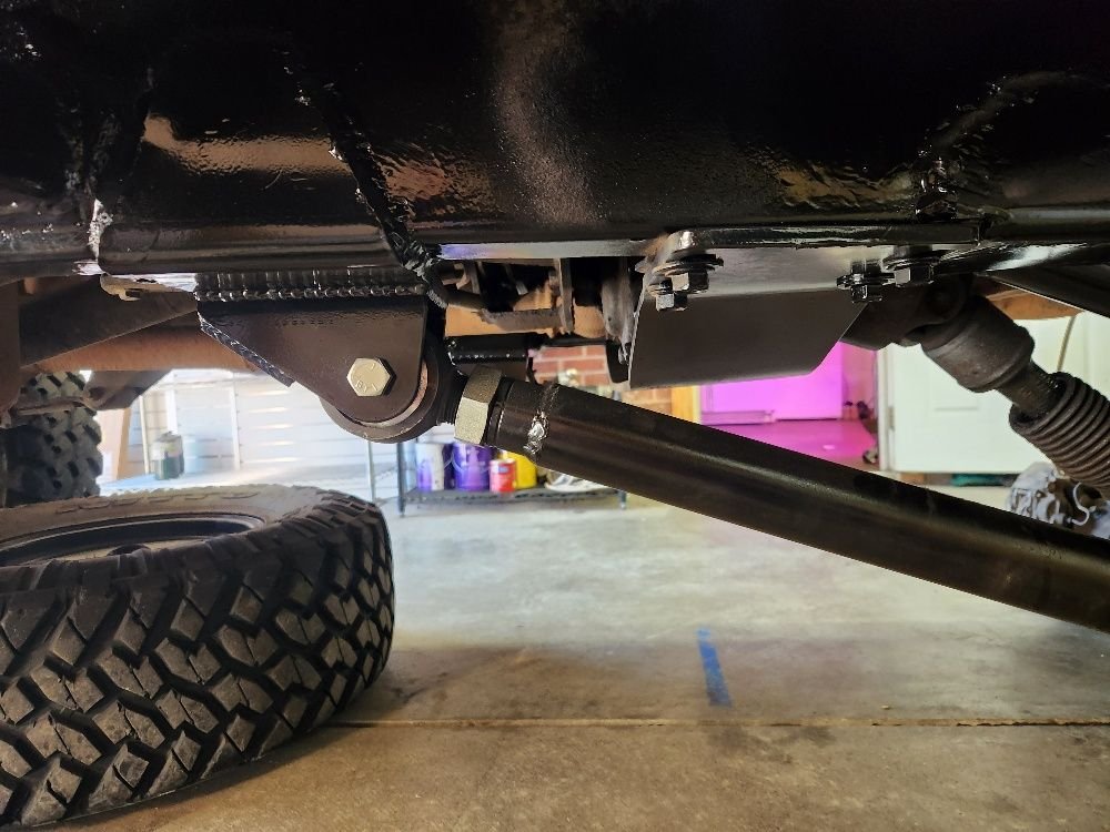

for anyone thinking about a 3 link, here's what i've learned so far:
all the steering arms on the market are made for leaf springs, which puts the tie rod way too close to the oil pan for any decent amount of up travel with a 3-link. i had to reverse tap the arms to put the tie rod underneath. wish someone would come up with a "mid-steer" kit

i bought the trail gear 3-link kit. i'll do a full overview on my thoughts later, but so far i think they did a pretty decent job with this kit. the lowers ended up being much longer than they should be, so the geometry won't be ideal but it'l work for now. i may end up making my own frameside lower mounts later.

got the frame-side mounts burned in and painted

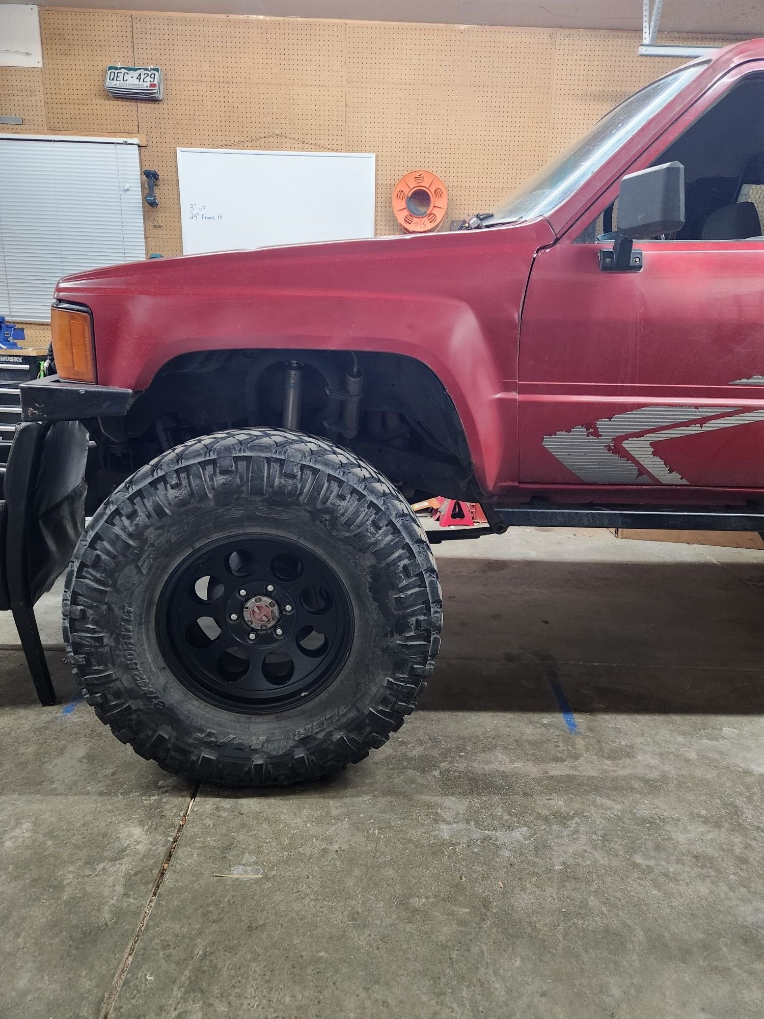

next up is the shock towers. these frames weren't made for coilovers, so I welded in some 1x2 on the bottom side of the frame, that should help with the twisting force it'll see. then plated over everything with 1/4"

to keep my current ride height, i needed a 14" tall shock tower. i'm surprised how few companies offer something this tall, most are around 12" (from the top of the frame) i guess most guys doing coil-overs run hoops? i wanted towers so i could minimize cutting the inner fenders.
got the drivers side mocked up. clears the brake master by about 1/4"
