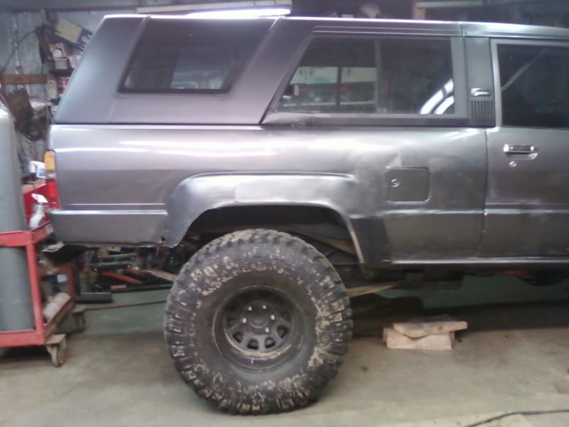

still workin on the rear suspension. here's a teaser of what it'l look like stretched. what do ya'll think?

Why isn't the wheel centered in the fender well on that silver runner pic??just curious...
the axle is moved back 3" that's why i posted it, cuz i'm moving mine back 2" so it'l look similar when its all done. I know it looks a little goofy but having a longer wheelbase will be worth it to me

I thought that picture would generate a little more feedback oh well...
Makes sense now.

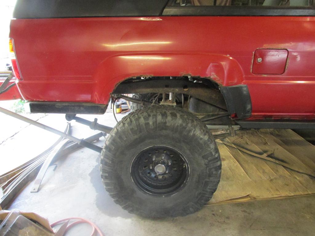

Old Sep 23, 2014 | 02:23 PM
  #353
liveoffroad's Avatar
Joined: Mar 2008
Posts: 705
Likes: 19
From: Colorado
got her back on her feet last night, i'll post pictures soon. bit off a little more than i wanted with that job, it took quite a while to cut off the spring pads and hangers. glad its done, i'll post up some pics tomorrow

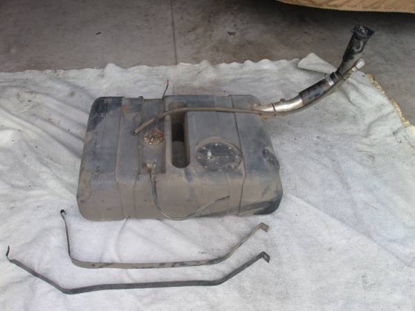

I also picked up this:
15 gal. aux tank perfect fit for where the spare was. still gotta figure out how to mount it and run the lines, but i'm looking forward to having a longer range

Is it a Supra fuel tank?
not sure, got it on c-list. looks like a universal tank tho

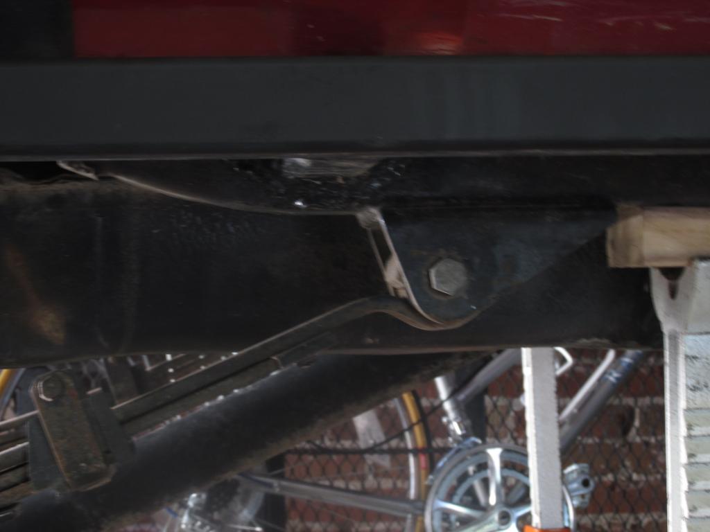

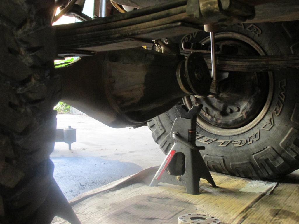

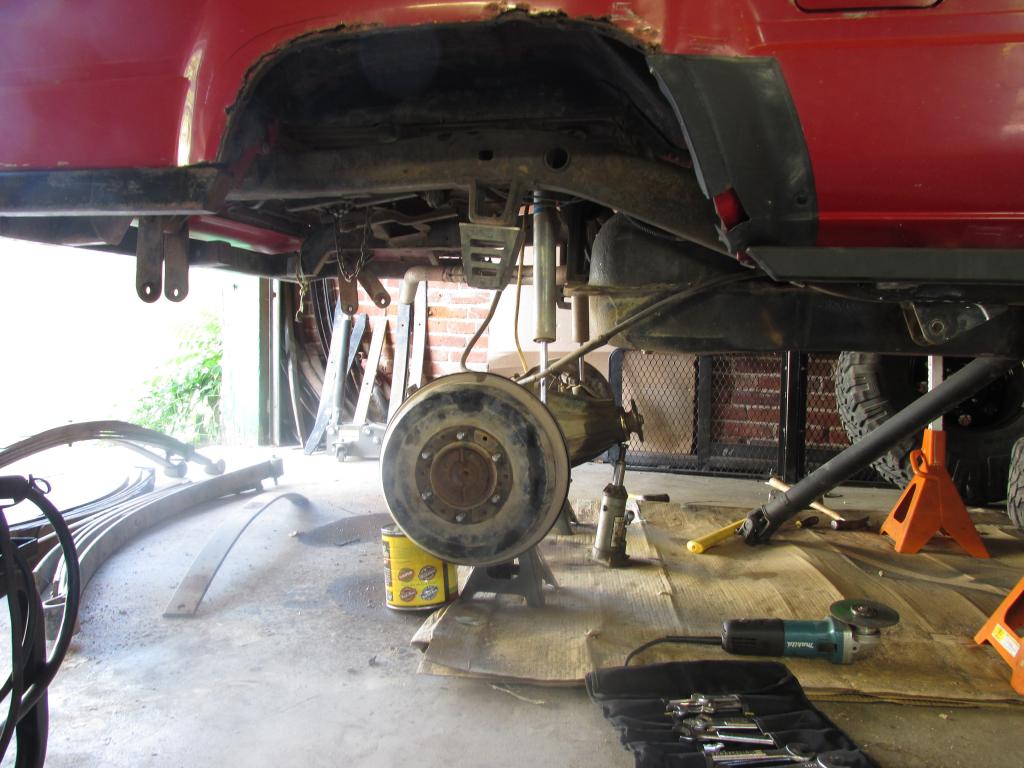

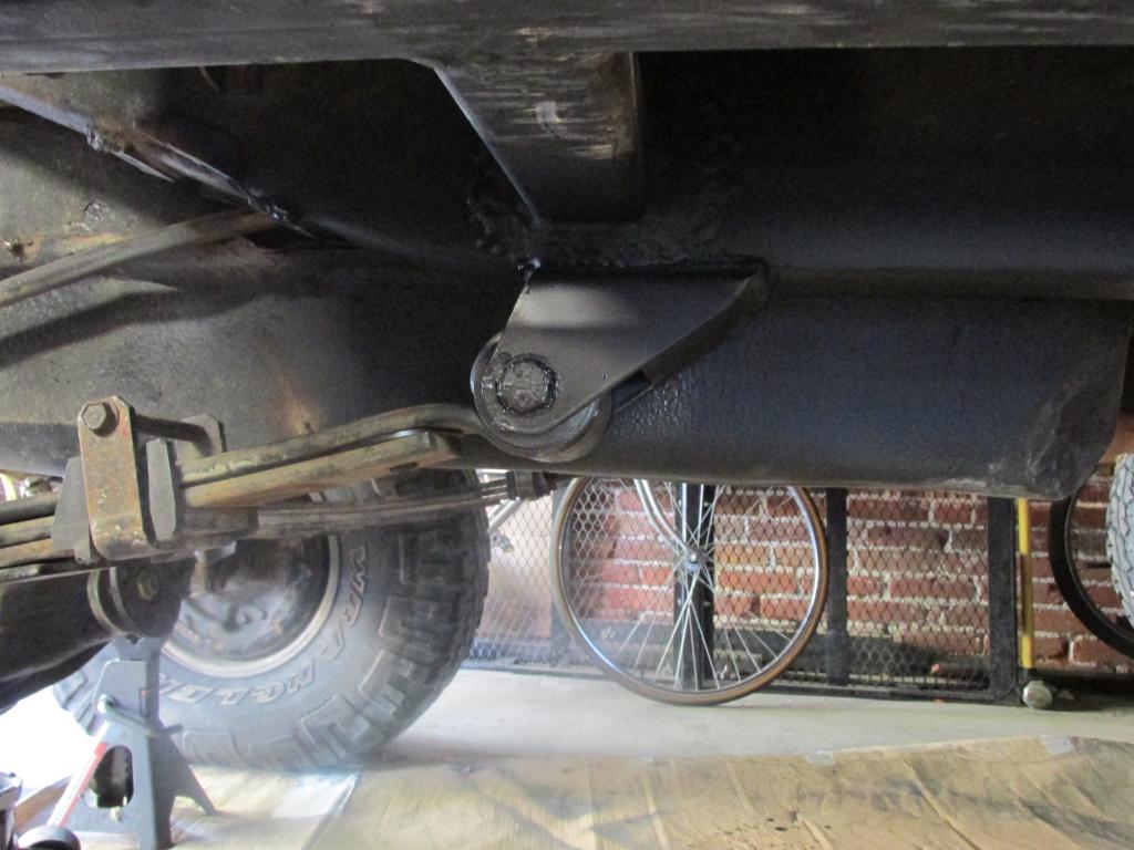

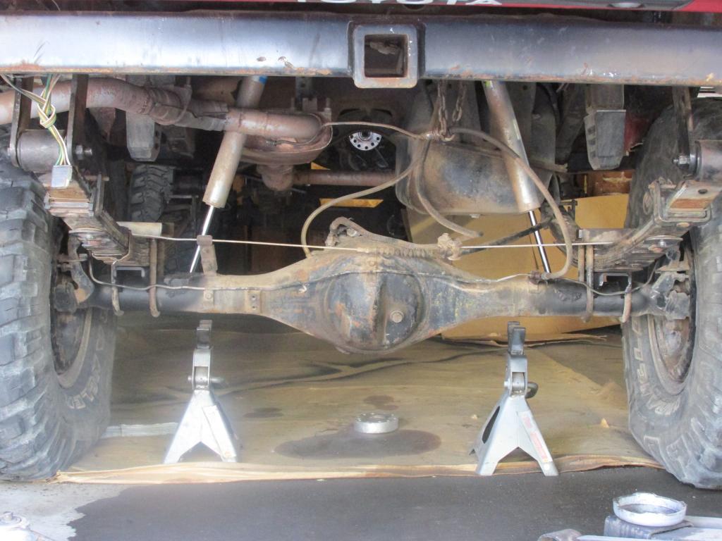

Pic time.
Before:
removed everything

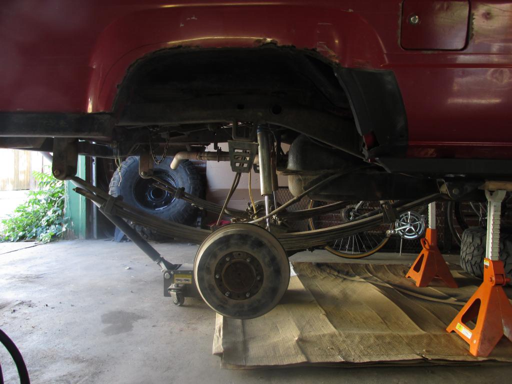

After:
I had the top 2 leaves on the "new" springs re-arched at a local springshop for 30$ and they have a lot more droop than the old ones...i'll be using the same 4 leaves on the bottom as before so hopefully the ride hight won't change much. i'm pretty happy with how it all turned out. I've got the driveshaft in the shop at the moment, but it should be done by the end of the week and ready to roll for this weekend

Nice work, looks great! Can't wait to see how your new longer wheel base helps you out on the trails!

Nice job on the springs.

thanks, we'll see how they perform this weekend. So far they've added another 2" of lift to the rear, which is not what i was goin for....hopefully they'll settle
