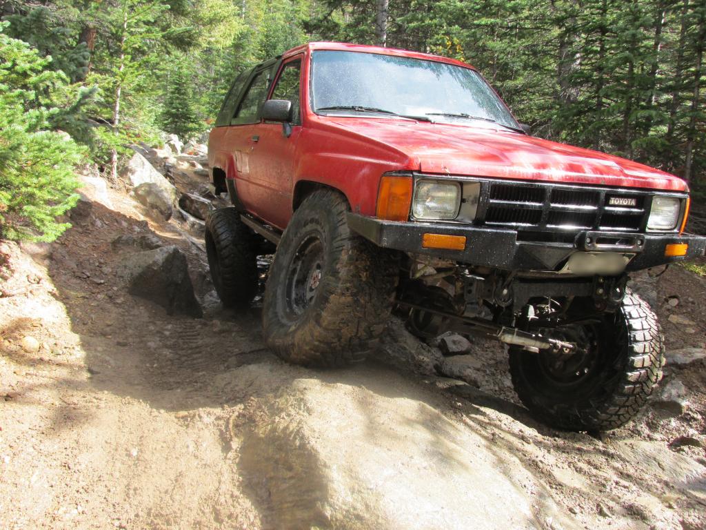

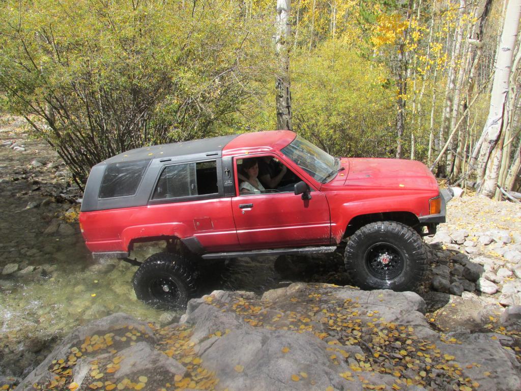

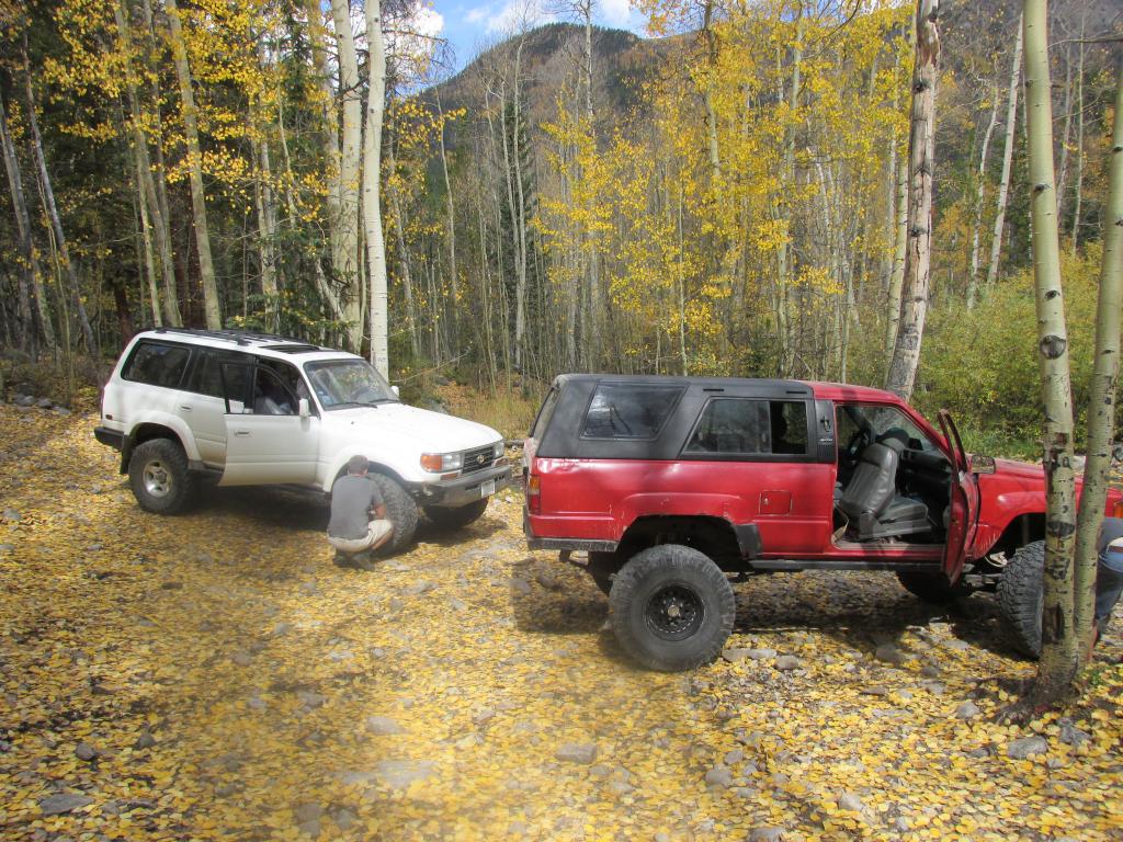

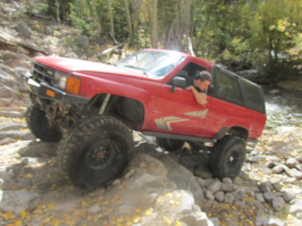

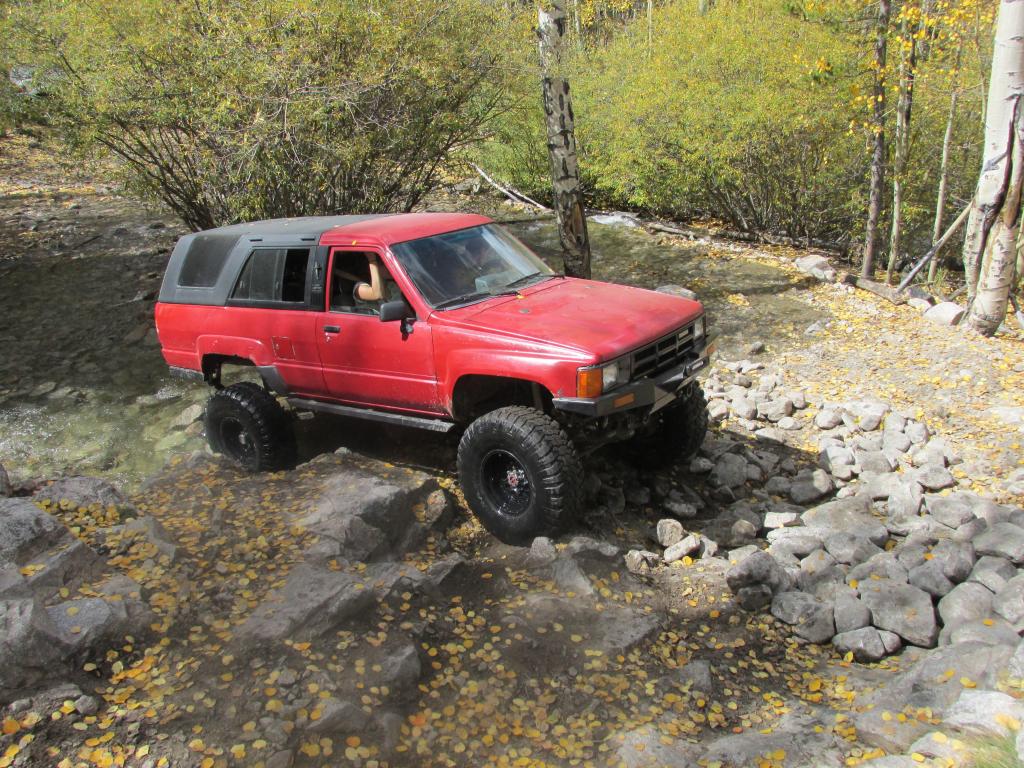

Went wheelin over the weekend with my bro, had a blast and the fall colors were awesome! The new springs are a lot stiffer than my old ones...which is nice for a change but i think i may pull a leaf out. other than that, truck did great
