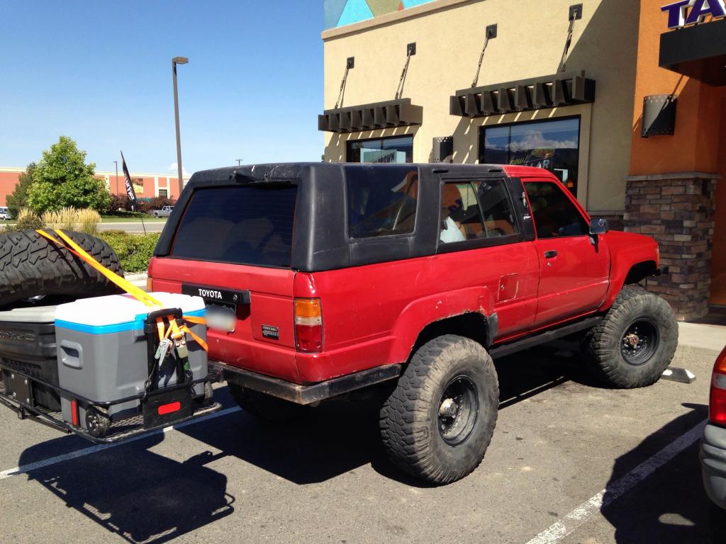

got back from moab yesterday. had an Awesome trip! it was hot, 90's during the day but we camped by the river and it cooled off nicely after sundown, so it was tolerable. Pics coming soon.

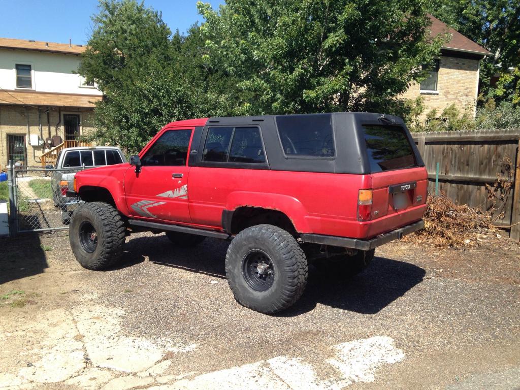

I had the windows tinted before we left, it actually helped a lot with the heat

Your window tint looks awesome! What % did you go with?
Your sliders look sweet! Did you get any rock rash on?

Tint looks great!

Thanks guys. no i didn't scrape my sliders...we didn't do as much wheeling as i'd hoped cuz the group wanted to do some hiking and then we left early monday to beat the traffic.... still had a lot of fun though
ed i did 15% on the back and 20% on the front 2, the topper is factory tinting (i may go back and add some to it at some point)

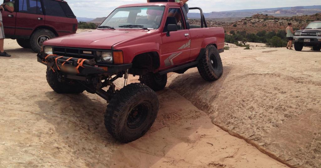

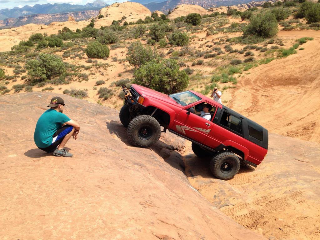

moab pics
here we go:
Stopped for some food on the way down. even fully loaded, these springs only sag a couple inches...worlds better than before

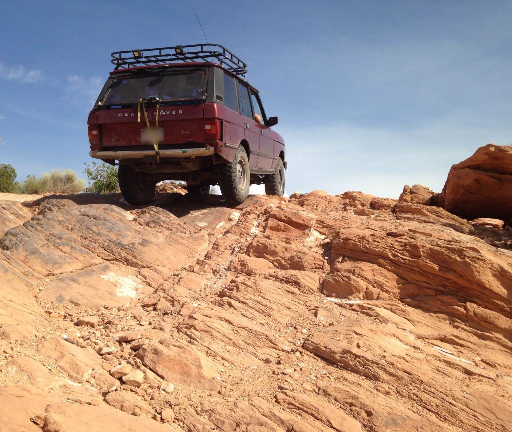

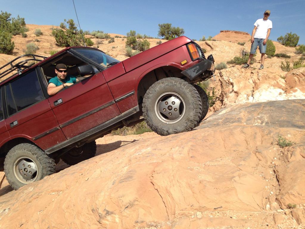

Got to camp around 12:30 and unloaded, then the land rover and i ran FINs N' THINGS:

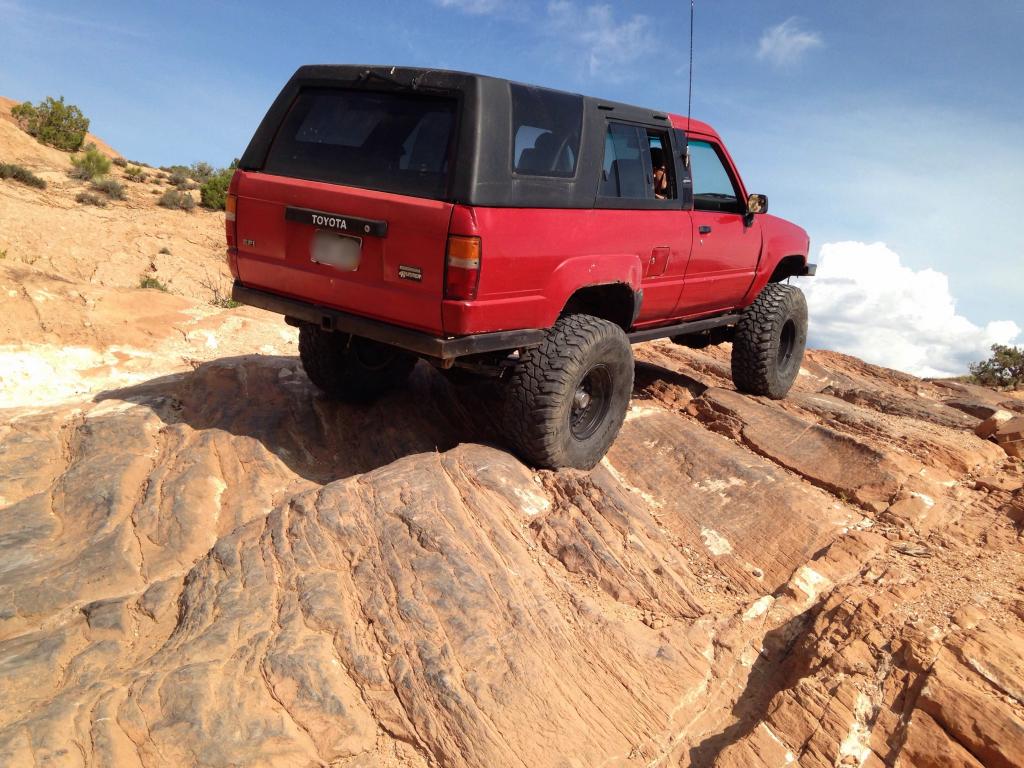

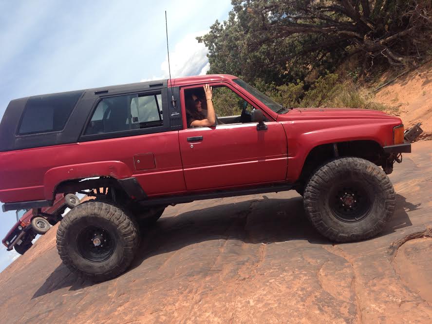

On to more pics: the 2nd day we wheeled klondike bluffs. got some good poser shots
the top:
sunday we hiked to corona arch
and we headed back monday early to beat the traffic. had a blast and all the rigs ran great.

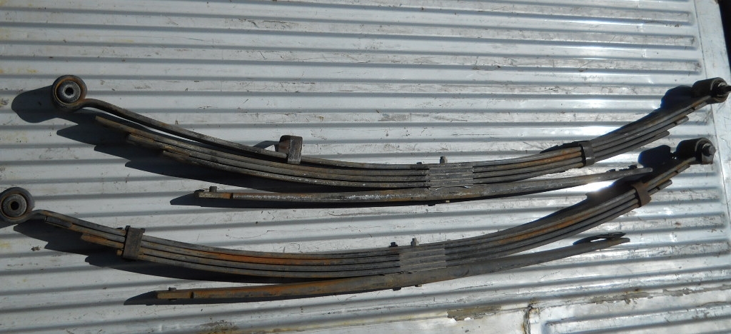

after this trip i've bumped a few things to the top of my project list. Im going to clock my rear pinon angle so my driveshaft isn't so exposed. While i have the rear end off, i'm going to stretch the rear 2" as well. I recall from my previous chevy spring adventures, 91+ suburban springs are 4" shorter than the truck springs (60"). so by moving the spring hangers back 4", the rear axle will move back 2 and i don't have to touch the shackle hangers. i need to relocate the spring hangers anyway cuz the drivers side is off about 1/8" which has caused my rig to "dog track" all these years.
so i took a trip to the local salvage yard:
suburban springs are 60" while truck springs are 64". still much longer than any other stock springs so should provide a decent ride.

Man I know I say it a lot, but im totally jealous of the scenery and trails you guys have!
That's good info to know about the suburban leaf springs being shorter, I would have guessed they would all be the same length. Are you planning to trim the rear fenderwells when you move the axel back 2"?

Great info on the springs
