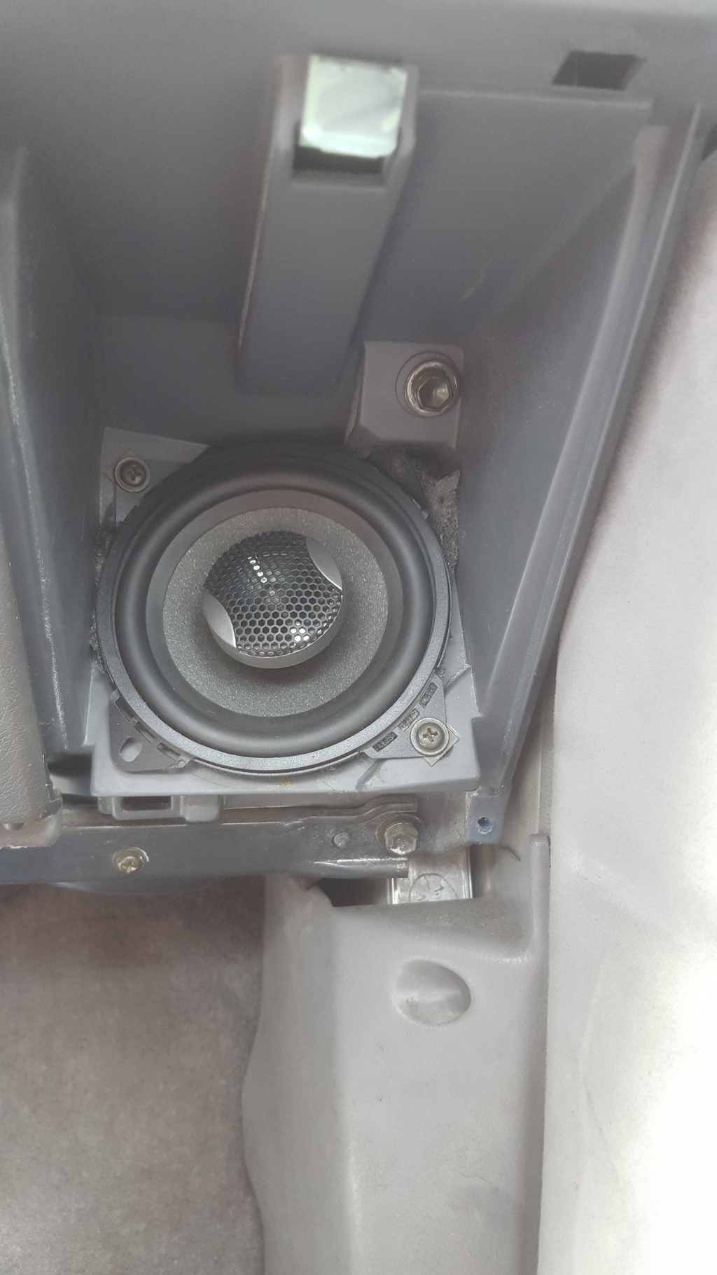

well i've been back and forth on this. The problem is, i'm well aware that components are superior in every way, but i also really like the fact that i have no wires going to my doors at all (manual windows) so i can pull my doors off really easily. also, if i did mount the speakers in the door, i'd be worried about them getting stolen back at camp, especially if they were expensive, not to mention that i'd lose most of my sound system with the doors off. so i'm back to wondering what i can do with the stock speaker location. After running at least 3 major brands of 4" speakers, i've given up on the idea that a 4" speaker can produce a decent sound, especially amplified. however, making the small jump to a 5.25 opens up a whole new realm of possibilities. i snapped this picture of the passenger side speaker area to play with, and i really think with some modification i can get a 5.25" speaker in there..... what do you guys think? has anyone done it?

I've wrestled with this one, too and wound up settling on the smaller, easy to mount lesser quality speakers. Hope your come up with another great idea I can use!

Seems like I saw a thread somewhere that they upgraded from the 4" speaker to a bigger speaker, but I can't remember where I saw it...
The main thing I struggle with is not wanting to cut holes in the doors and door panels to mount the speaker. I wonder if anyone makes a universal speaker pod that can be mounted to the door? I was thinking of mounting some 5-1/2 or 6-1/2" speakers in the side cubbys in the side panels on each side of the rear bench seat.

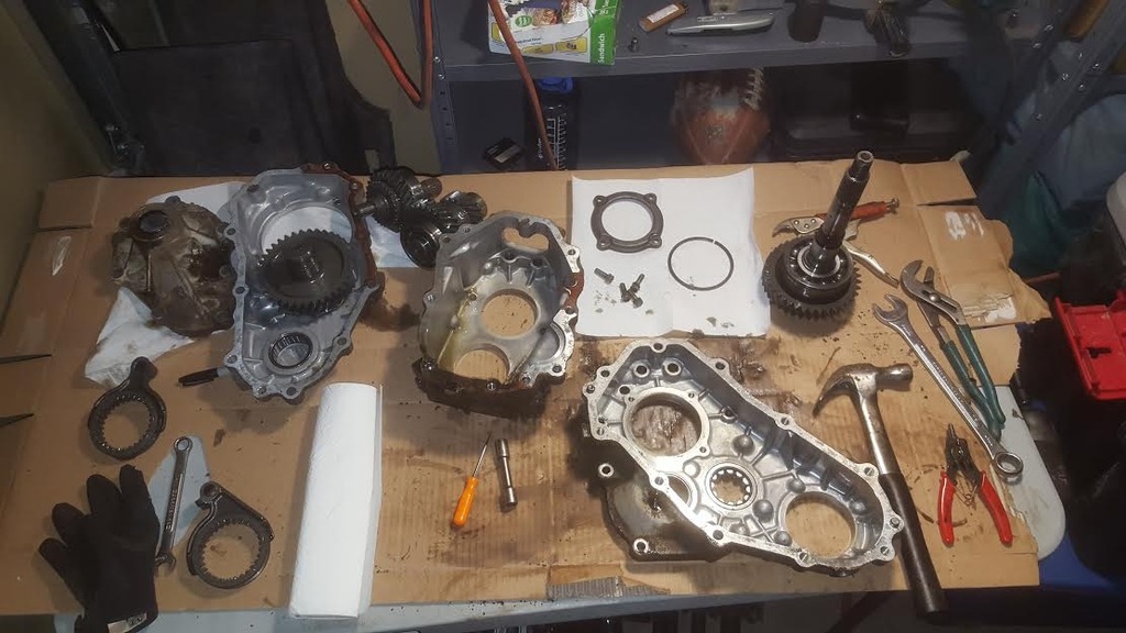

I blew up my transmission on the way to moab in april. And when i say "blew up", thats the truth. the input gear is missing about 1/3 of the teeth! (Side note, if you notice i said it happened on the way to moab, so you can imagine how that trip went for me) so after a whole lot of drama installing a used w-56 and discovering that it had bearing noise (jerk on FB sold me a lemon) and trying decently hard to sell the truck for about a month, i've decided to start building a totaly new driveline.
I've had 2 g-52's and a w56 in the truck now, and none have impressed me on reliability, though i know most guys say they run forever that has not been my experience. thanks to fellow yotatech'er "egesledder" (https://www.yotatech.com/forums/f161...e-swap-255991/) for doing all the leg-work on how to get an R150 behind the 7m, i decided to go for an R150. This also gives me the added benefit of an easy 3.4 swap down the road if i ever decide i'm through with the 7mge. Due to the drama i went through with the used w56, i ruled out another used transmission so i began looking at rebuild options. I found a local shop that would source me an R150 core and rebuild it for a very reasonable cost so i pulled the trigger.
This also meant that i needed a 23-spline input shaft and a top-shift conversion for my t-case, so i decided to just sell my current 4.7 t-case and build a new one. luckily, i had a buddy with a top-shift case ready to go. and so it begins.

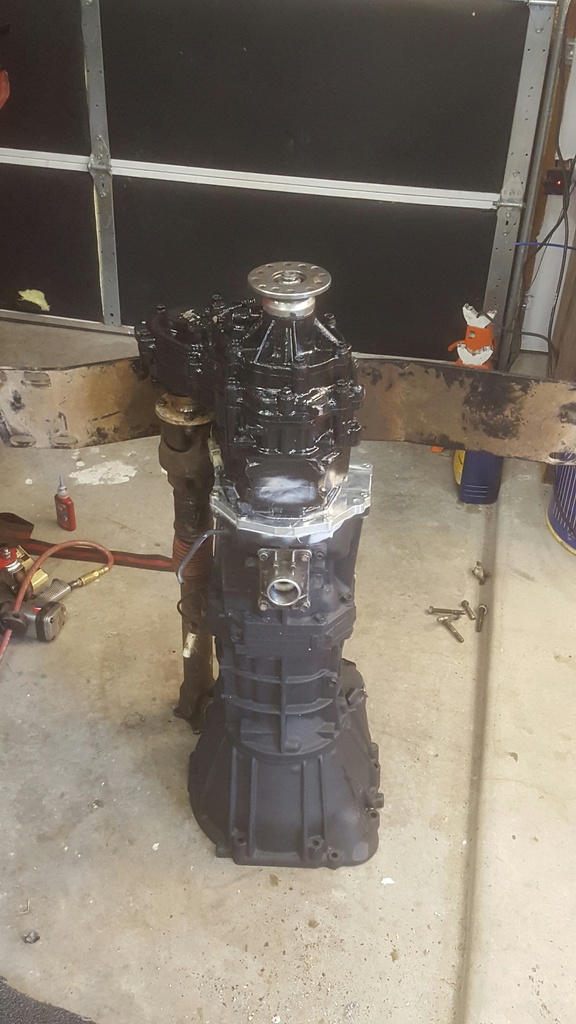

That's too bad about the transmission blowing up on the way to Moab. That sucks. I'm surprised to hear the W56 didn't hold up that well behind the 7M. You'll be happy with the R150. You running a single 4.7 case? Jambo this year! Aug 11-14th!!

got the t-case back together, got the r150 back from the shop and everything painted and bolted together.
R150 with R154 bellhousing and top-shift 4.7 t-case ready to drop in:

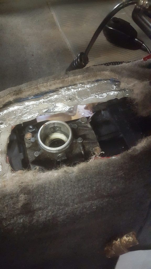

transmission shifter lines up about where the t-case shifter was before, i'll have to cut a hole about 6" back for the t-case shifter
