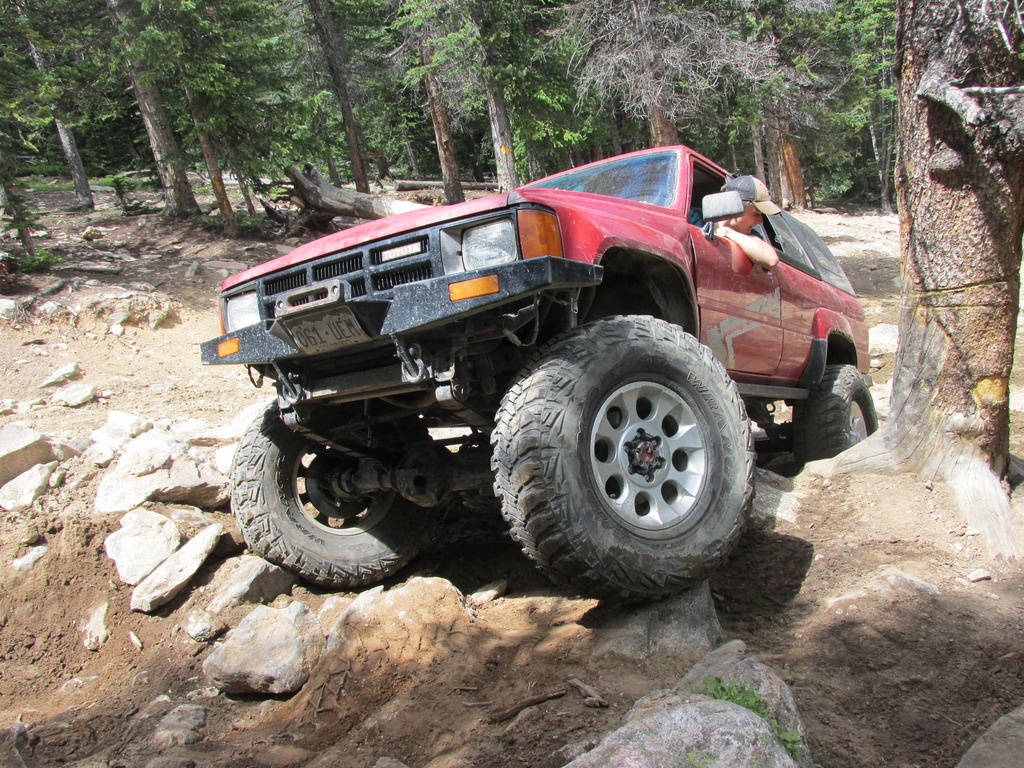

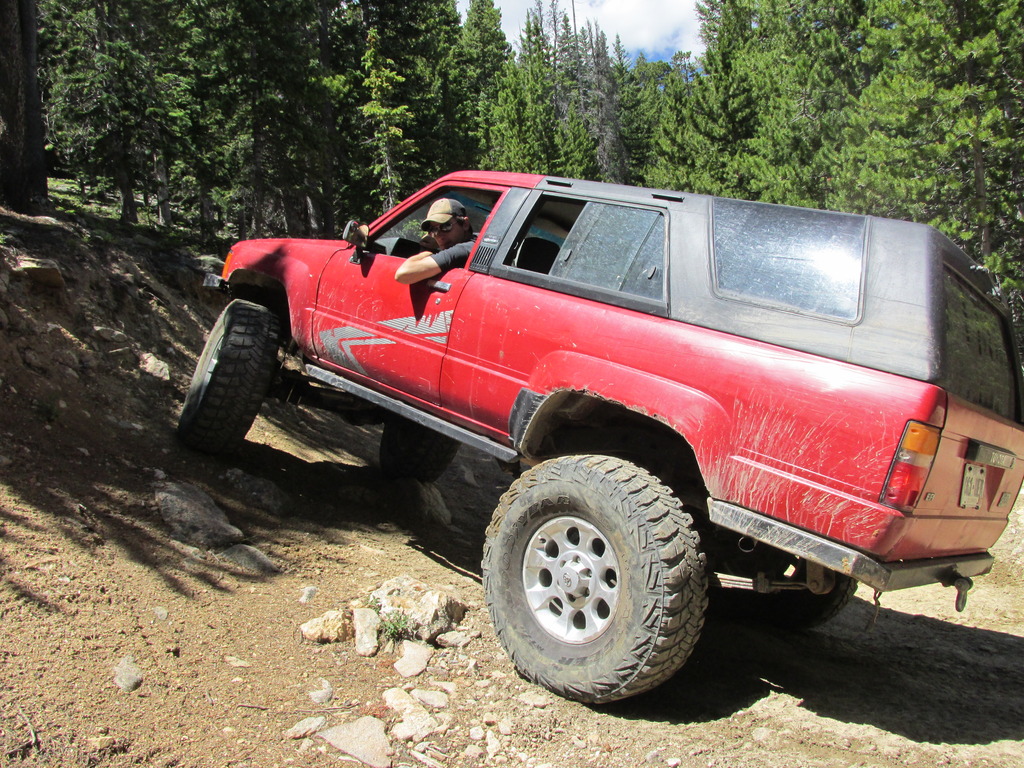

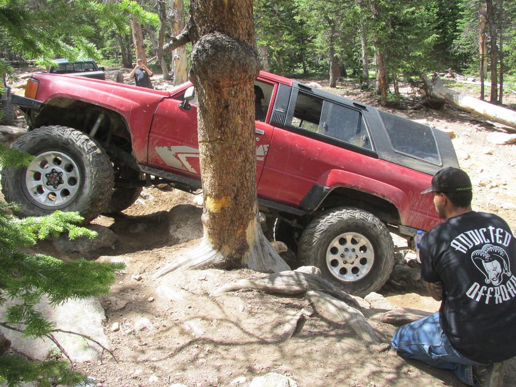

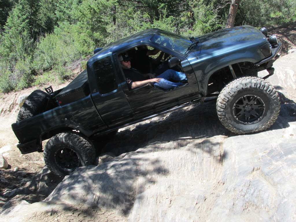

Ran spring creek last weekend. it was my 3rd attempt (got lost and/or ran out of time the first 2 times)

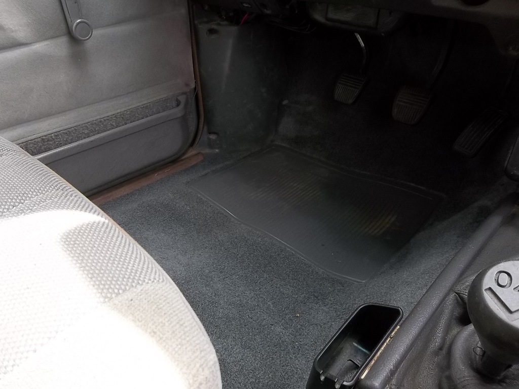

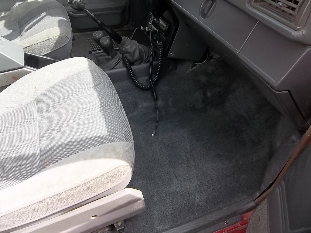

My current project is insulating/sound proofing the floor. I've been pouring over forums about this and it seems to be the common consensus that dynamat is better than the cheaper budget solutions for sound proofing. however, it doesn't have an "r" value for insulating. My priority at this point is to keep the heat out of the cab since i don't have ac, and priority 2 is to make it quieter. This, as well as my budget, led me to settle on using Frost king duct insulation. has a closed-cell foam insulation and an aluminum foil top coat, which means it won't degrade or mold if water happens to get into the cab (i take the roof off occasionally). I also read plenty of accounts that said it greatly reduced road noise. So yesterday i went to HD and bought 3 rolls of this:
http://www.homedepot.com/p/Frost-Kin...V516/100028603
Took me about an hour to clean up the cab and then another hour to apply the stuff. it actually sticks pretty well if you take the time to clean the floorboards well (i use 50/50 water and isopropyl alcohol). then i installed my new carpet that i bought a while back from www.Auto-Interior.com. I must admit i was greatly disappointed when i finally opened the box to look at the carpet. it was molded well, but there were no holes for the shifter or the seat bolts pre-cut in it. After reviewing their website, it says you have to cut the holes yourself so admittedly this is my fault for not doing the research. I can't believe i paid that much money for carpet and still had to spend several hours cutting all the holes and trimming it to fit. Would have been much better off going to HD and spending a fraction of the cost. lesson learned i guess. it will be nice when its done. Got most of the front area done last night, still need to trim up the edges. i'll try to get some pictures tonight

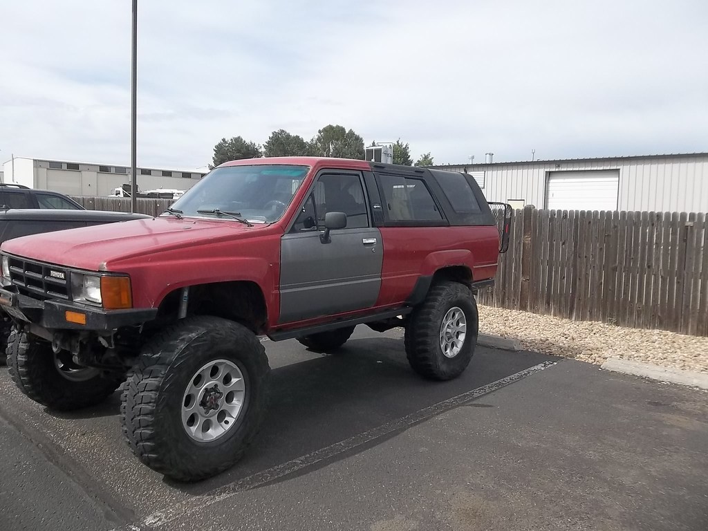

she's ready to go for the weekend:
Ain't pretty but having a wing-window is a must w/o AC
here's a few shots of the new carpet"

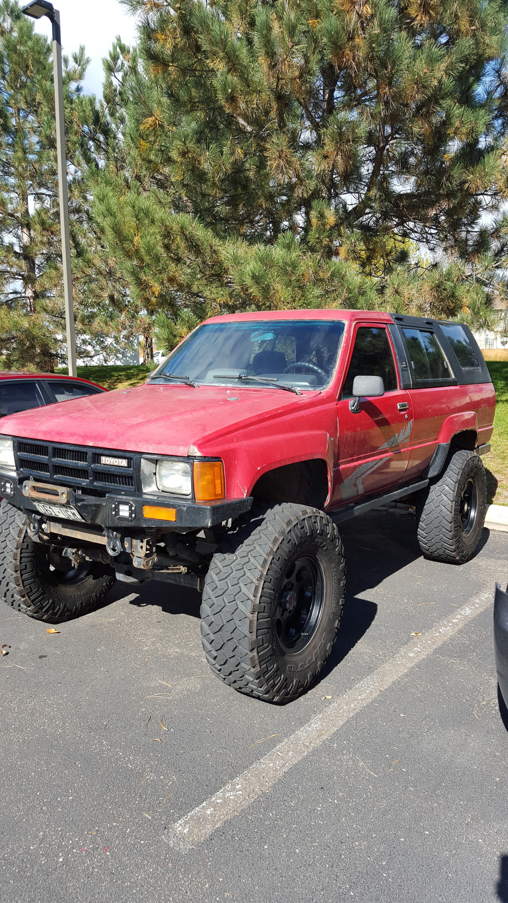

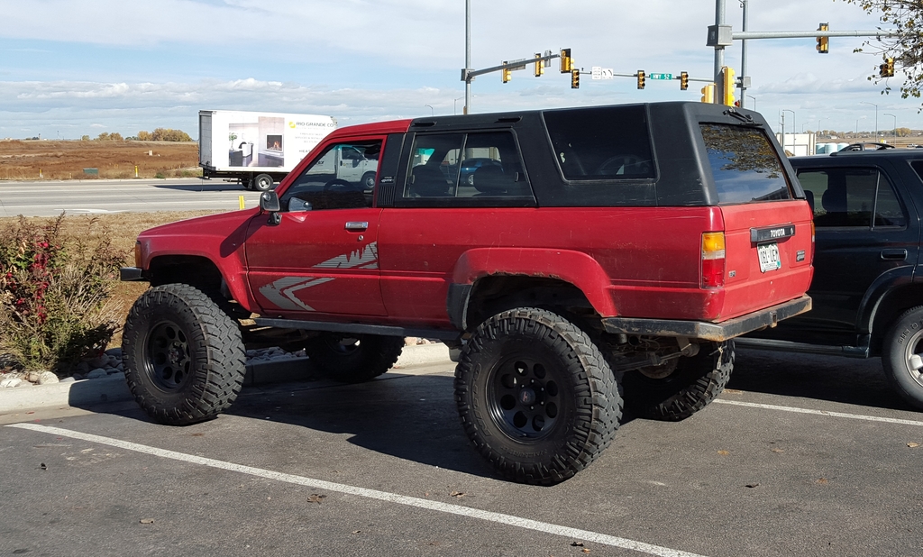

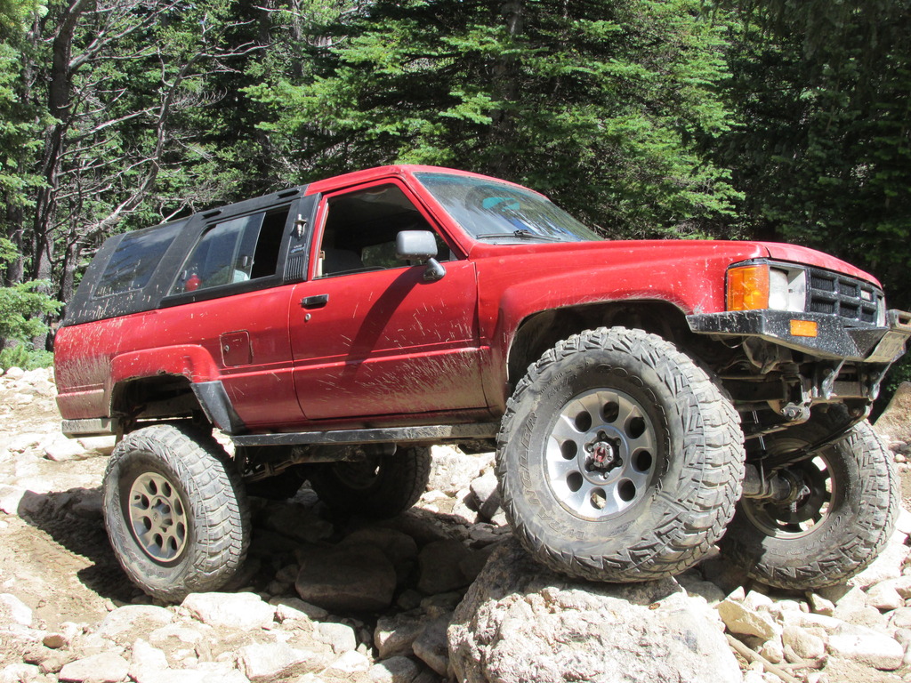

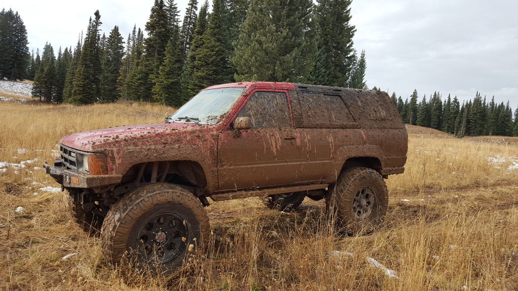

Update, i got a deal on some new-to-me shoes. Nitto trailgrappler MT's. have a fair amount more tread than my MTR's and they ride soooo much more smooth, i couldn't ever get the MTr's to balance quite right. Took the opportunity to go back to black wheels, i never could get used to the "bling" the other ones had. these are cheapies from discount, level 8 tracker 17x8.5 with 4.5" B.S. pushed the tires out another 3/4" or so on each side, i like the more aggressive look!
Tried them out in some mud during hunting season, these tires did awesome! i'm very happy with them

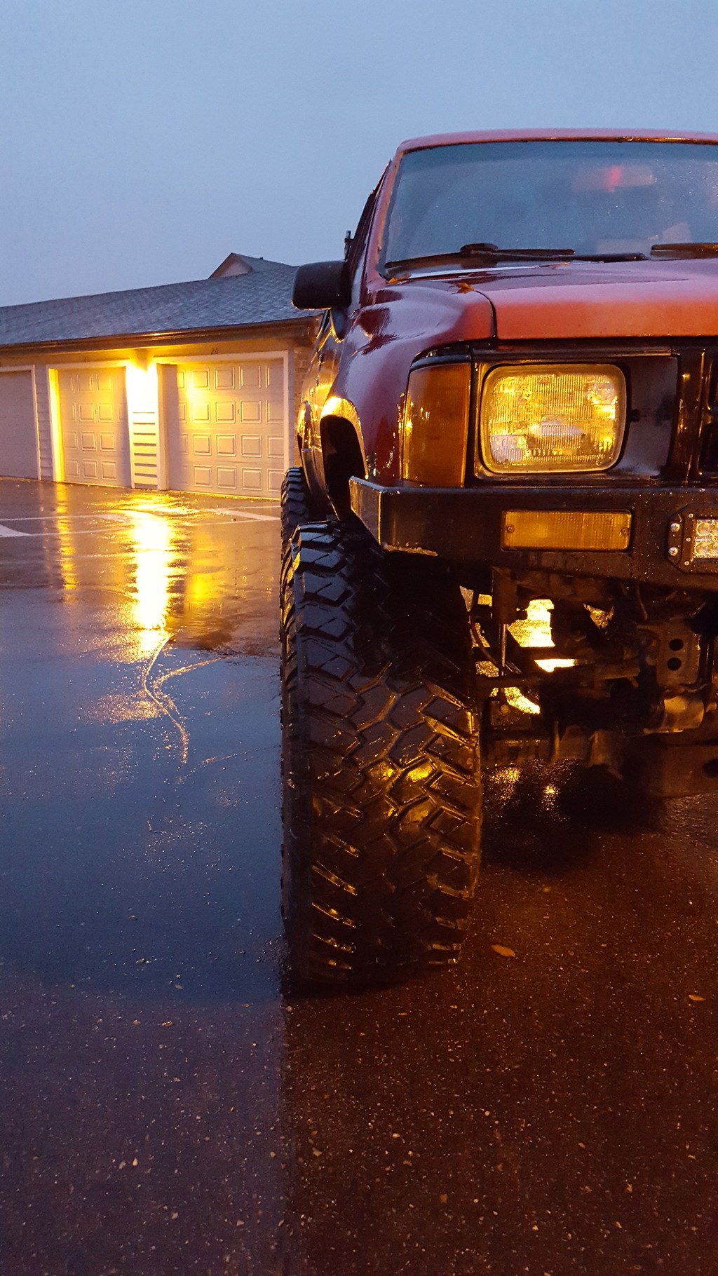

Nice tires. Your truck is easily one of my favorites, probably because it looks like an older brother to mine.
Hey I just noticed those lights you recessed in the front bumper, is there a post on those? That's slick.

thanks cory, nice catch on the lights- no i did't do a write up on them, i got them from a buddy and installed them a couple months ago. they're neat but don't really ad a whole lot over just the headlights. If your going for noticeably more light i'd recommend going with a full lightbar- they're just to "bro" for my liking haha

I like the new shoes, and the black wheels look sick, I thought the other ones looked good too, but I always liked the black'd out look, it looks so tough on 37's!!!
