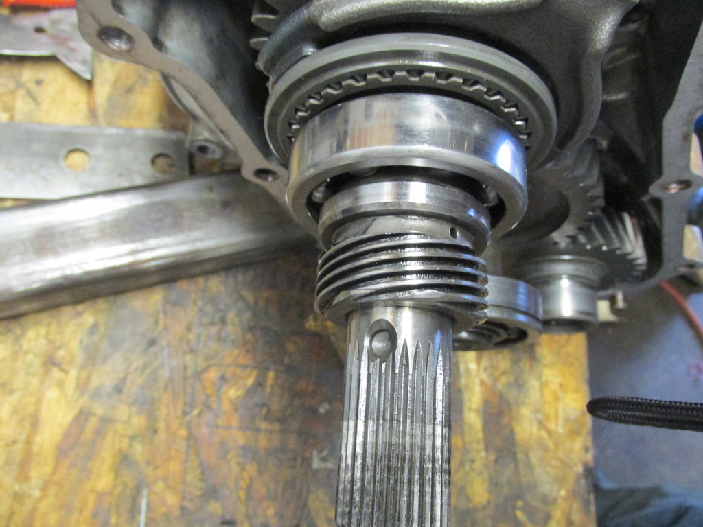

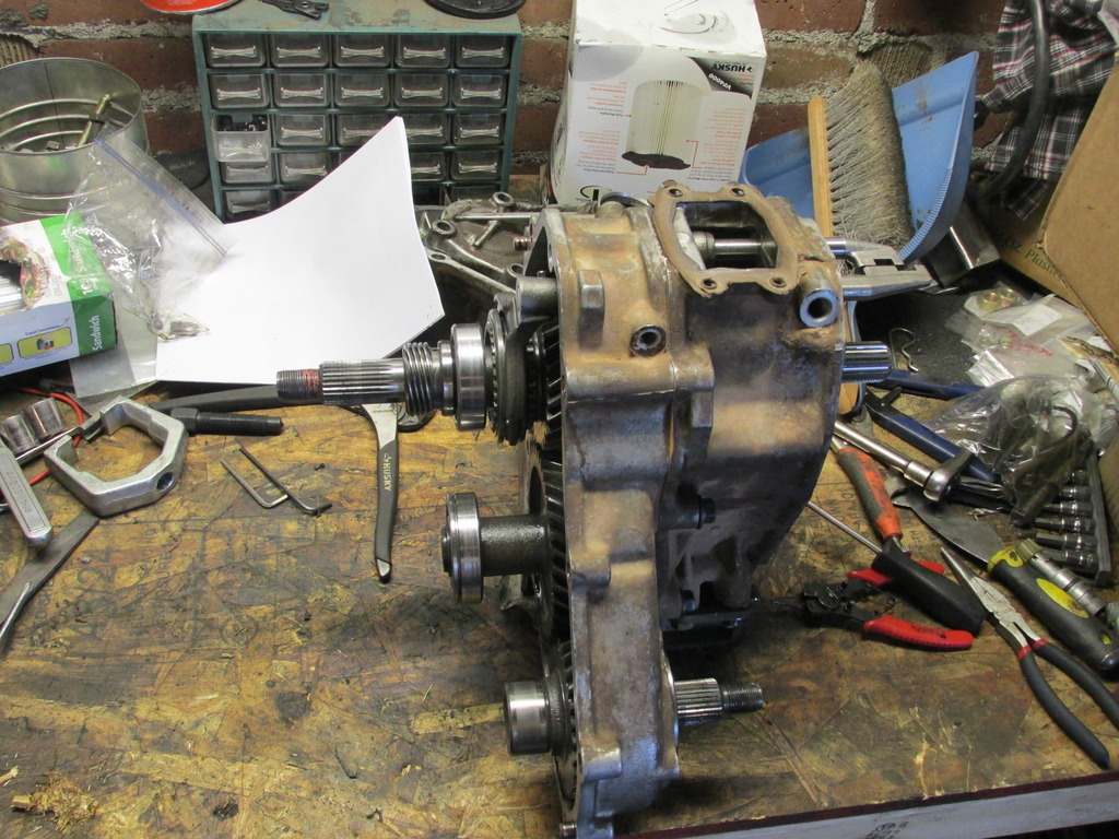

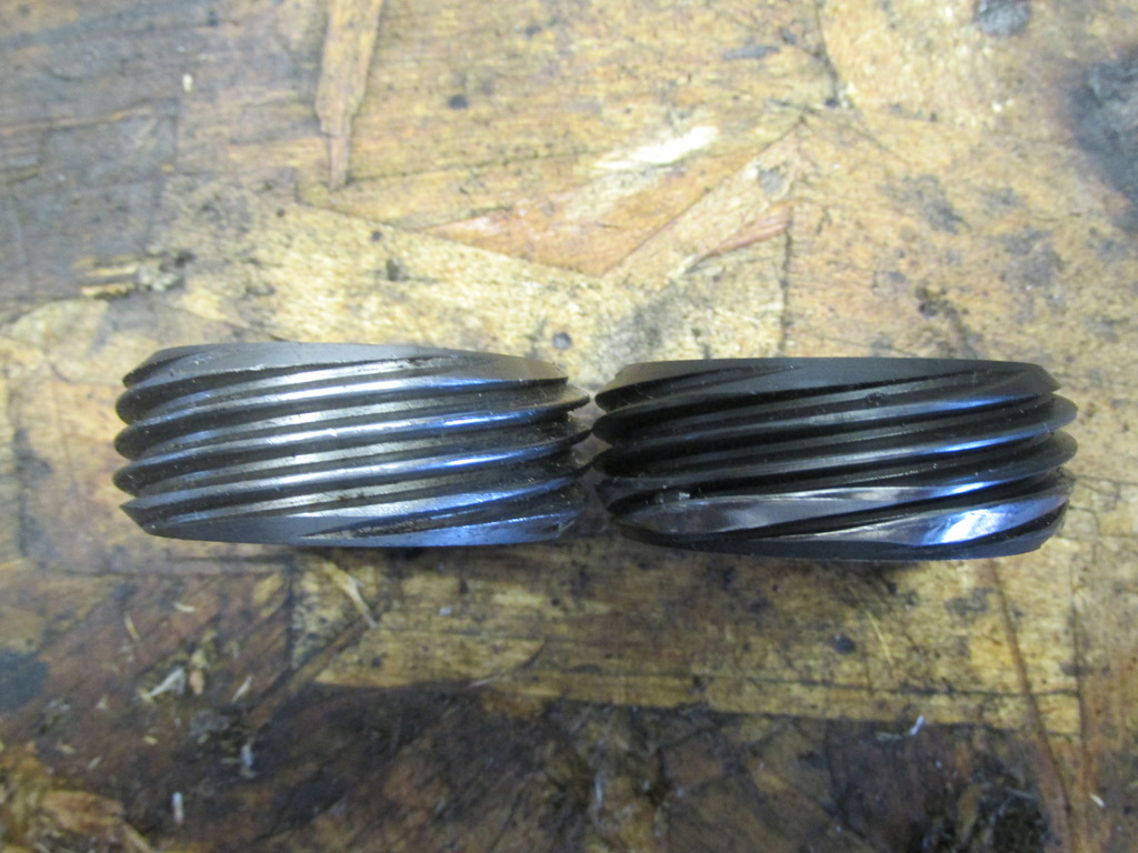

1. I've known my transmission was on its last leg for a while now, so i've had a spare waiting to go in. I couldn’t tell if all of the noise was coming from the tranny, or if the t-case was making noise too. Plus the front output had more play than I was comfortable with, so I decided to go ahead and tear it down while I had it out. I was reluctant to do so after seeing pictures of how many small parts are in these things, but I’m glad I did. I followed marlin’s instructions and it was very easy and straight forward. Turns out, everything looked great inside, except for the spedo gear. This thing has been eating speed sensors since I’ve owned it and now I know why:
Old on right, new on left

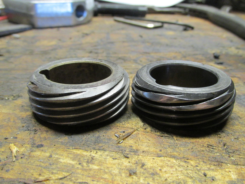

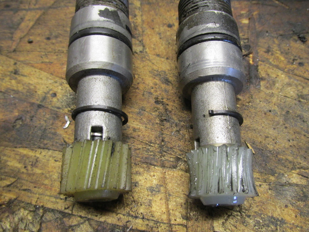

You can see what its been doing to the speed sensor (old on right, new on left)

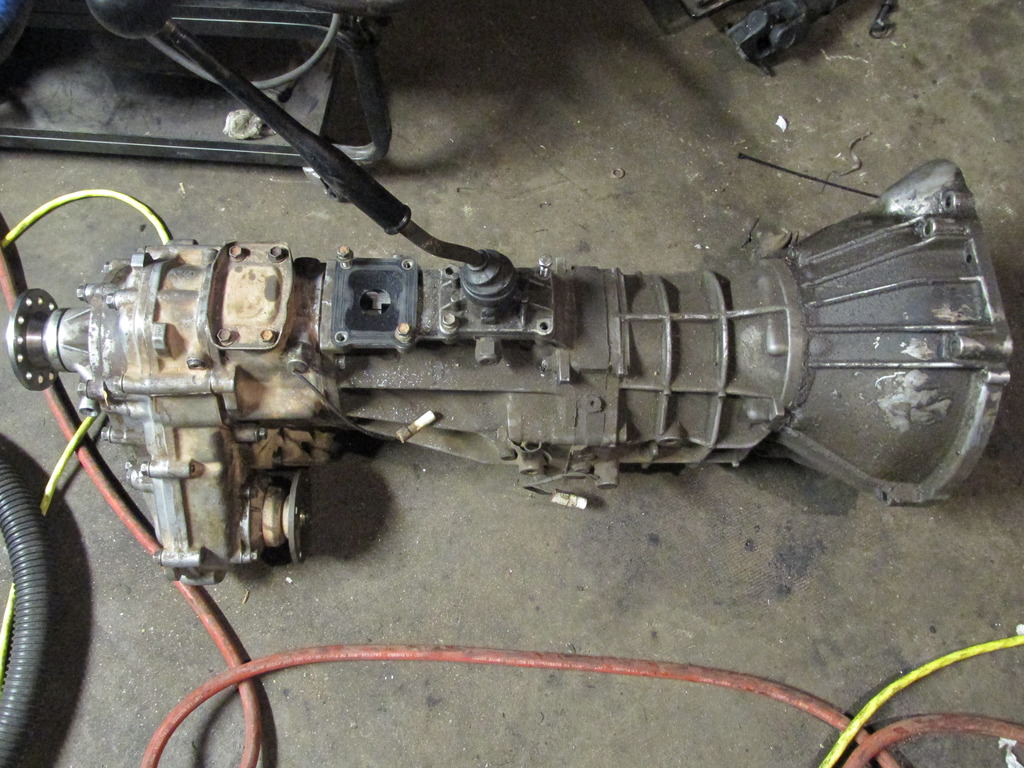

After a short call to marlin crawler, they had one lying around so i had a replacement on its way for a grand charge of 5$. Those guys are the best around for customer service! I also had them send me the front output bearing, and their ecoseal kit so I could freshen up the output seals.
Got that all buttoned up last night. While I was in there, I pulled the interlock pin so I can finally run the twin-stick I’ve had sitting around for 2 years now. Here it is all ready to go back in. Hopefully this “new” tranny is in better shape than my old one

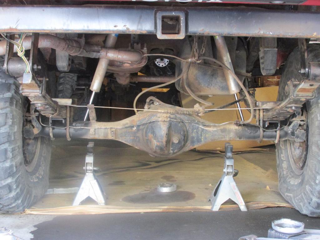

2. When it comes to steering, I was really starting to get frustrated. After installing a new high-steer setup and completely rebuilding the axle I still had wandering and bumpsteer that made the truck dangerous to drive. I decided, as a sort of final attempt to fix this issue, to replace the shackle bushings… and I may have had a breakthrough. The shackle bolts were tight, but I found that the shackles had been rotating on the bolt, not on the bushing like they’re supposed to. This caused the holes in the shackles to wear, resulting in a TON of play. With the spring unloaded, I could grab the back of the leaf and move it about 6”!! So that meant I needed new shackles, but my truck budget has been exhausted for this year so I improvised. I added some weld to the bold and ground it down until the bolt fit snug in the shackle hole again. Then, some new bushings and hopefully this issue is resolved. (this is a short-term fix, new shackles are on the wish-list)
3. My rear shocks have always been a little under-damped, but for some reason this problem perpetuated after I did the high-steer. I’m thinking it has to do with the fact that I’m not running the “torque” rod on the front axle anymore, which made the front suspension much softer now. With the front softer, the rear is moving a lot more on the road. It was very bad on my last trip, felt like i didn't even have rear shocks! I looked at relocating the shocks more vertical, which would increase dampening, but I only had a couple inches to work with, I'd have to buy shorter shocks, and it would be a lot of work so I ruled that out.
So I looked into getting a heavier valved shock. Bilstein doesn’t have a ton of valving options for the 5125, so I’d have to go with the 7100 series and they come with a nice price tag! So I opted for the rancho 9000. I am a tried-and-true bilstein guy, but 7100 bilsteins are almost twice the price of rancho 9000s so I didn’t have a lot of choice here. I’ve ran rancho 9000’s before and I liked them just fine. In addition, I like the adjustability, especially for a rear shock since my load ranges from empty and topless, to loaded down with several hundred pounds of camping gear.

That speedometer drive gear looks nuts. That's such a crazy wear pattern. I wonder how that happened and if that's what wear in that thing always looks like.
That's awesome that Marlin sells transmission internals so reasonably.

I'm thinking the wear was caused by a loose flange nut on the rear output. 2 years ago, due to an unbalanced driveshaft, my rear flange nut worked loose, it was only hanging on by a thread or two when i found it. the output flange is all that holds the spedo gear from sliding out, so i'm thinking it made contact with the housing when that happened. glad it was an easy fix.
btw, it was on the t-case, not the transmission

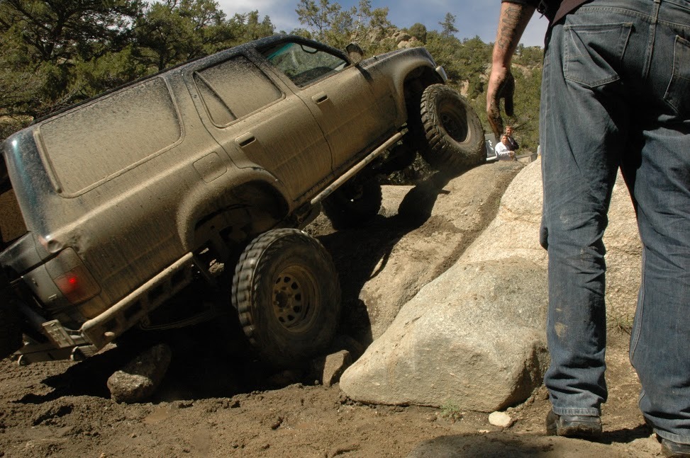

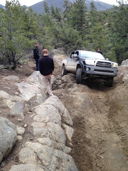

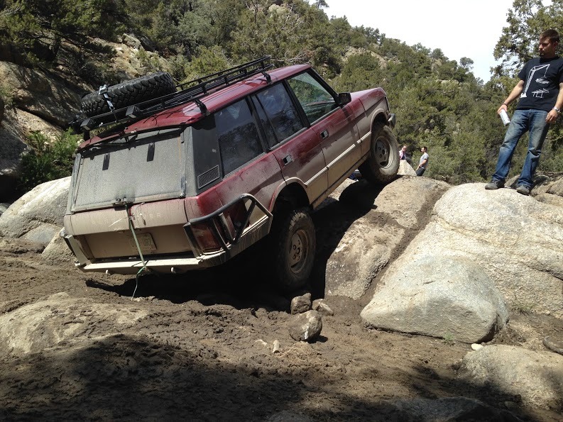

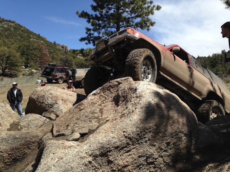

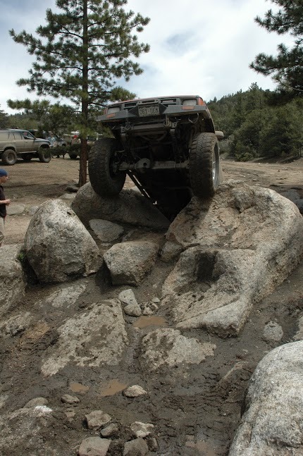

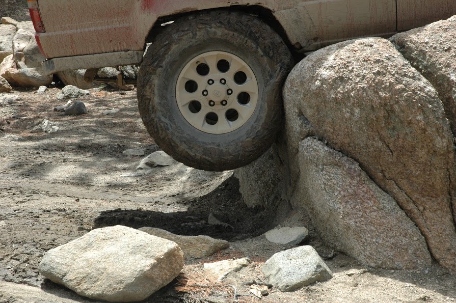

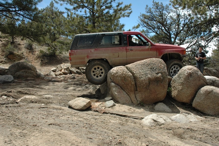

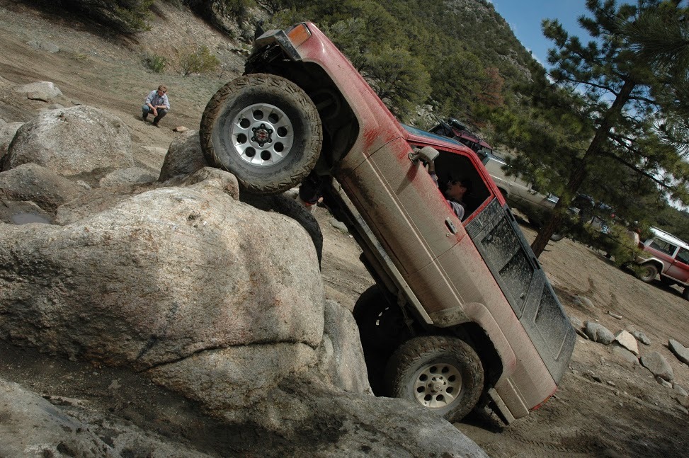

ran chinaman over memorial day. Truck ran awesome, definitely diggin' the 37's

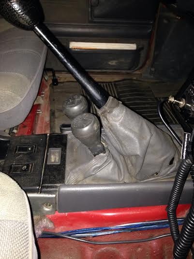

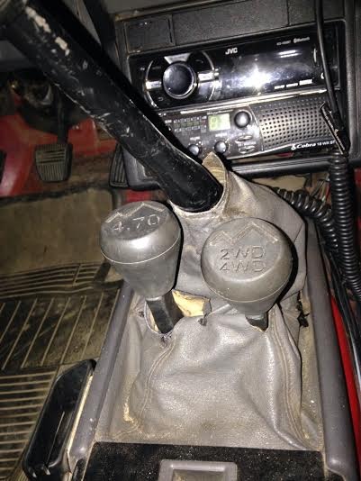

Got the twin sticks installed before the last trip. Had to cut the shifters down 2" to clear the trans shifter, i wasn't too happy about that since TG assured me it would fit with my tranny.... I Guess it shouldn't surprise me anymore with them. turned out well though

Short throw twin sticks! Lol. What tranny setup do you have in that? My FROR twins don't exactly work with my setup either. The range stick can't have a knob on it because the trans shifter hits it
Old Jun 10, 2015 | 01:06 PM
  #498
liveoffroad's Avatar
Joined: Mar 2008
Posts: 705
Likes: 19
From: Colorado
Yea sounds about how mine were before i modified them. I'm still running a G54

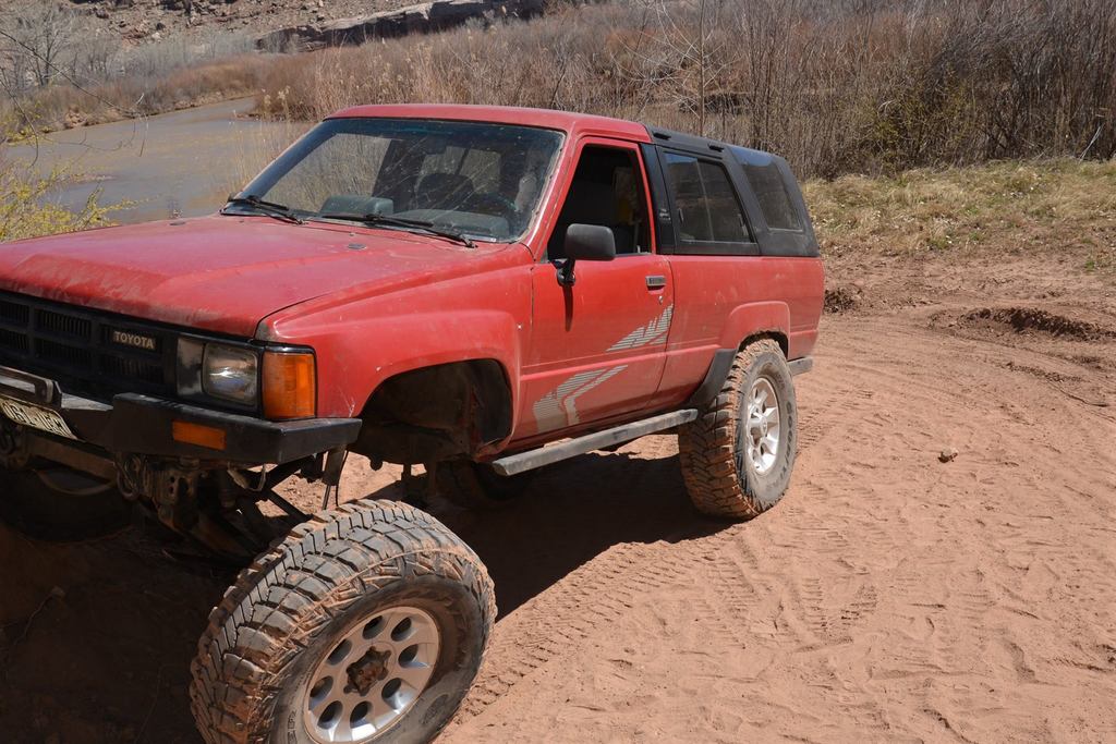

Dude what was the trick to getting the 37s to fit without trimming fender? Truck is looking great by the way.
Old Jun 19, 2015 | 06:01 AM
  #500
Joined: Mar 2008
Posts: 705
Likes: 19
From: Colorado
thanks man! the rear is trimmed about 2" back, and the front hits a bit at full lock, i haven't got around to fixing that yet
