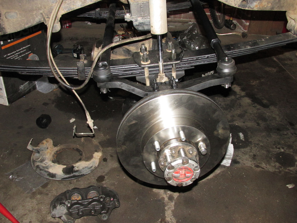

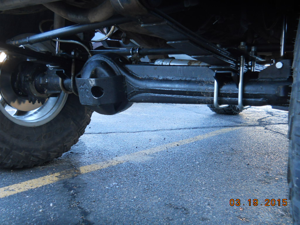

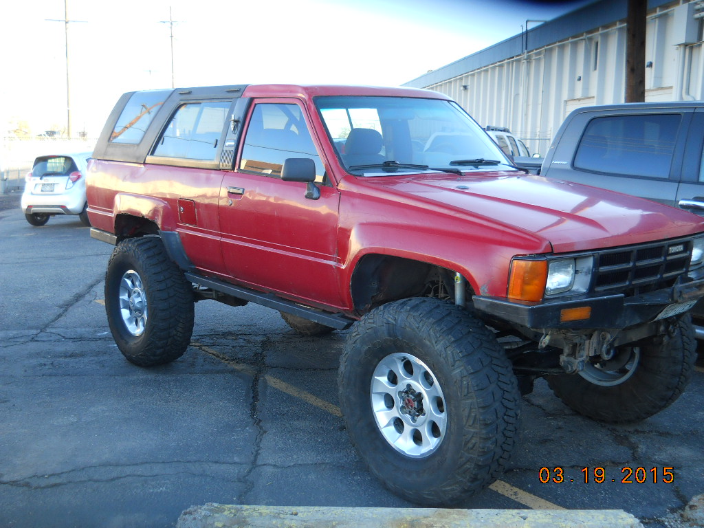

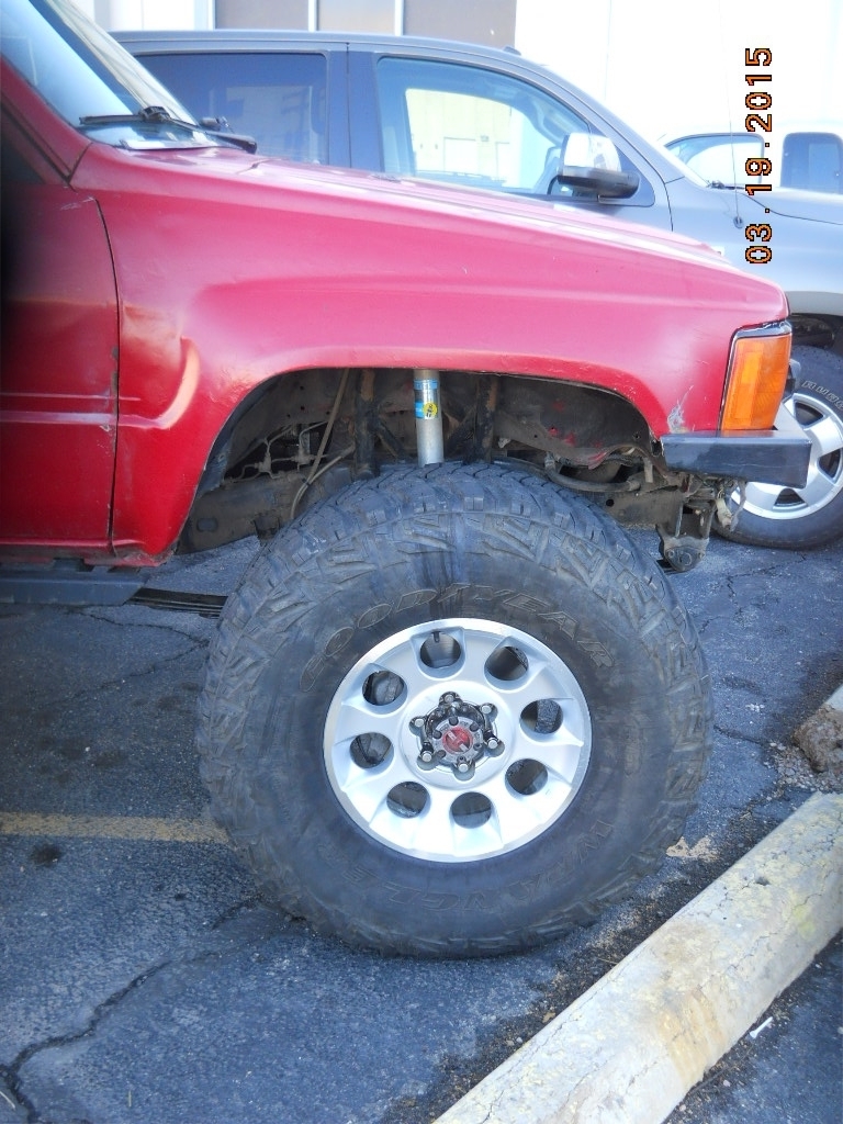

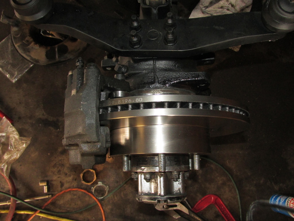

almost done: new hub studs & wheel bearings. got the steering all dialed in. just need to finish a few odds and ends.

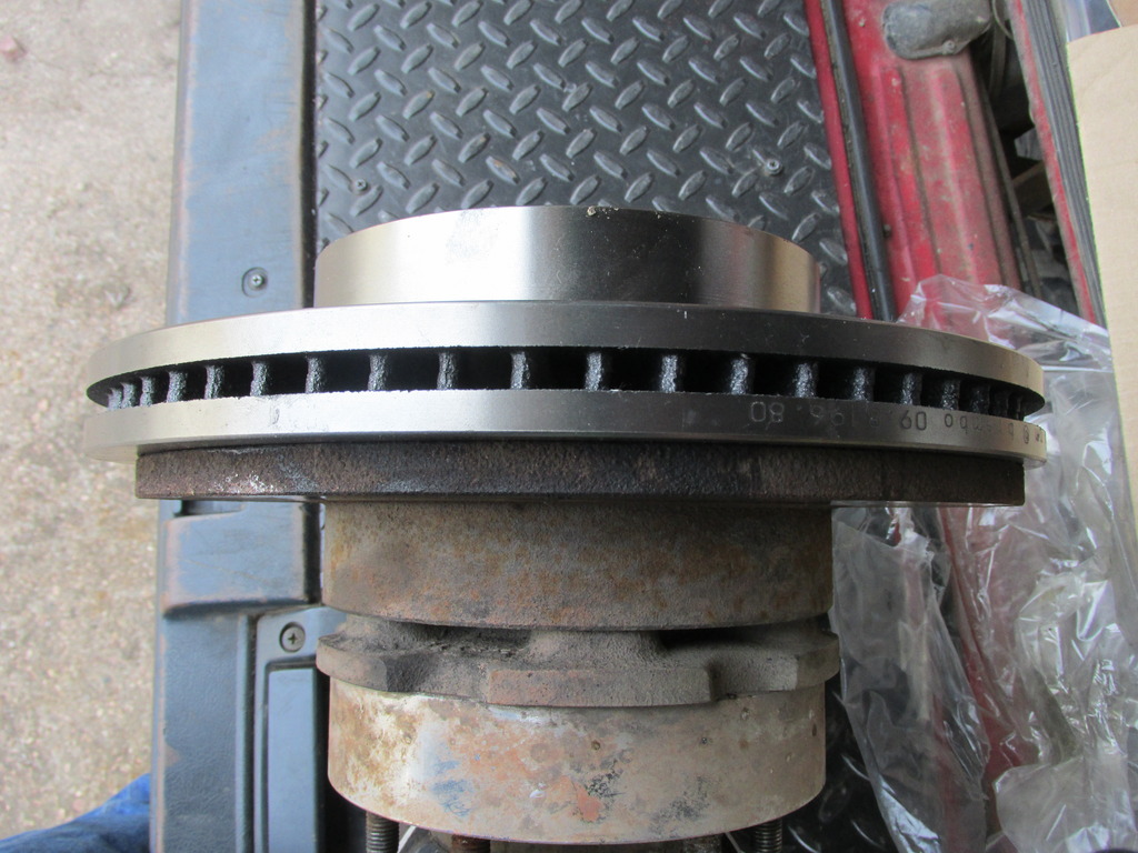

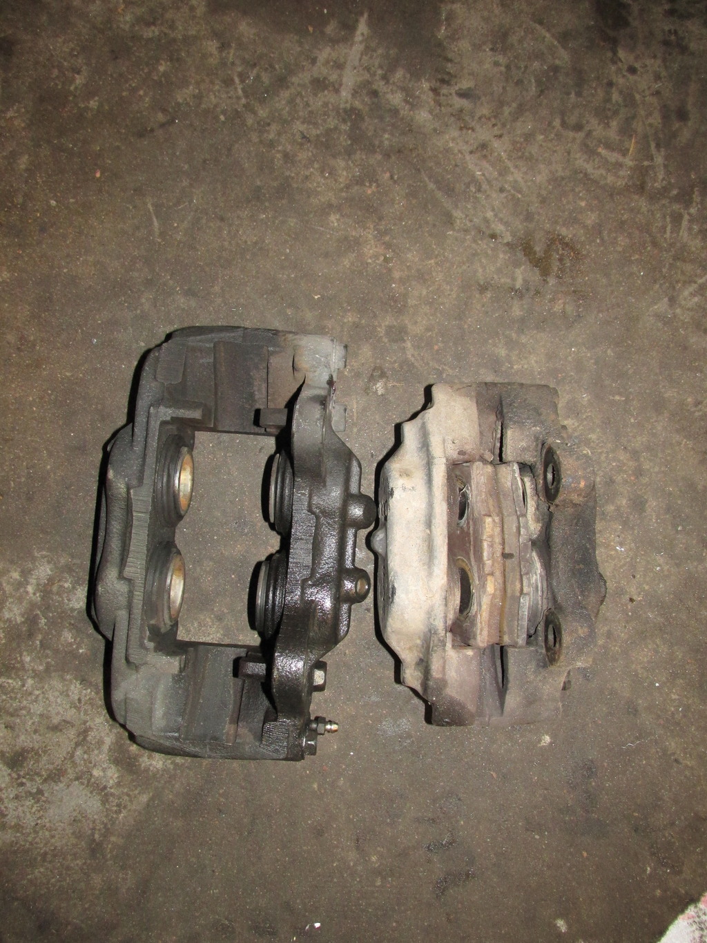

as peviusly posted, i did the FROR Taco brake conversion, and i'm running the larger style tundra brakes. here's a comparison of stock SA rotors and calipers vs. tundra:
I'm not too hard on brakes since i have the 5 speed but I figured since i hadn't dumped any money into my brake system yet, i might as well go for the best option out there. i've heard of people warping the taco rotors, so went straight to tundra. I'll be upgrading to a 1" bore master cylinder as well. hopping to test drive this thing tonight!

How much did you have to mill down the hub to do this?
I'm not sure, i ended up just buying some from FROR. he sells IFS hubs already turned down and i'm pressed for time on this project so i thought it was worth it.

So are you running Tundra calipers only? Or Tundra calipers and rotors?
Old Mar 19, 2015 | 10:20 AM
  #469
liveoffroad's Avatar
Joined: Mar 2008
Posts: 705
Likes: 19
From: Colorado
You've gotta run both for it to work. your getting ahead of me haha. i'll post up more pictures when i get it assembled tonight

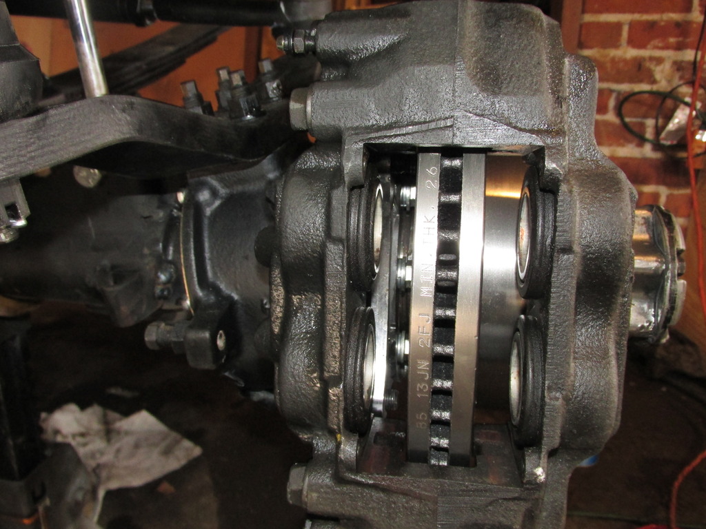

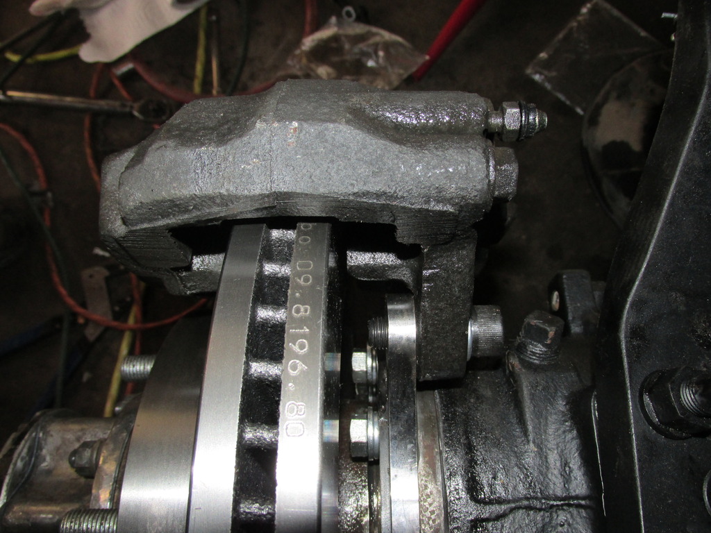

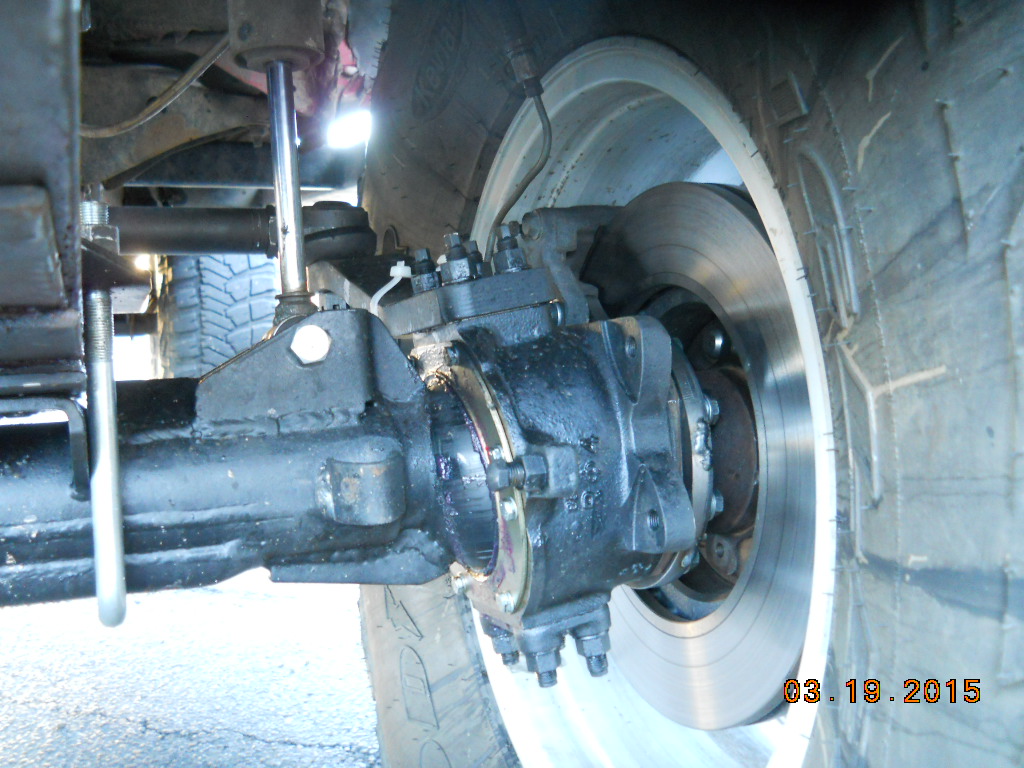

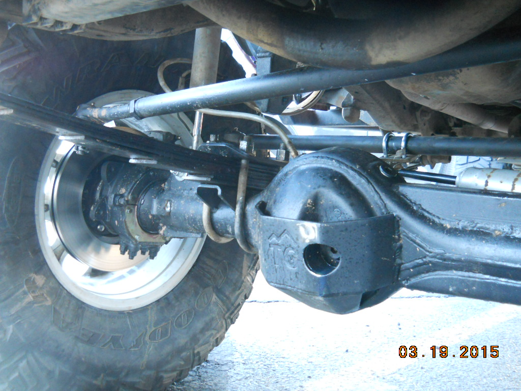

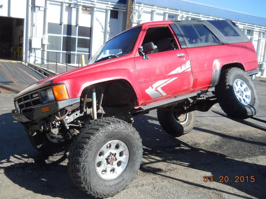

Finally finished late last night.
Tundra caliper install:

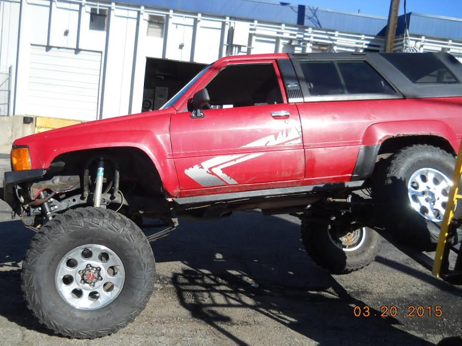

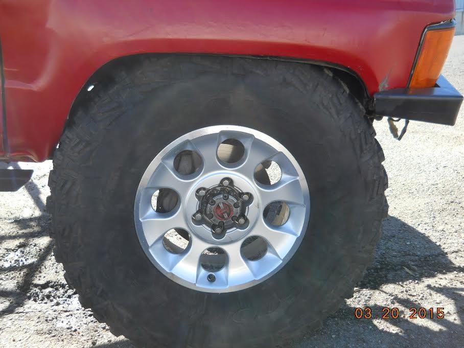

DONE! I think the "bling" on these wheels might be too much for me, but we'll see if it grows on me. What do you guys think?

So what brand of caliper and rotor did you go with? Did you choose the "turned for tacoma rotors" when ordering the hubs from FROR? I was under the impression that the calipers had to be on the forward side of the knuckle and that the knuckles had to be swapped left and right?
Old Mar 20, 2015 | 08:01 AM
  #472
Joined: Mar 2008
Posts: 705
Likes: 19
From: Colorado
So what brand of caliper and rotor did you go with? I was under the impression that the calipers had to be on the forward side of the knuckle and that the knuckles had to be swapped left and right?
Yea you have to swap the knuckles left to right so the ears don't interfere with the FROR taco brake kit. calipers are stock from ebay, rotors are brembo off amazon.
Did you choose the "turned for tacoma rotors" when ordering the hubs from FROR??
yep
The brakes feel awesome, pedal is very firm. haven't done a skid test yet but it feels like my rears still aren't doing much. I intended to pull the LSPV and put in a portioning valve but i didn't get to it.
What year range of Tundra are we talking?
There's 2 options, I opted for the larger 231mm brakes but the smaller ones clear better if your not running 17's. here's the write-up i used.
http://www.toyota-4runner.org/3rd-ge...rs-rotors.html

WOW, I missed a lot! Nice work, I'm going to have to bookmark this page, I like the Tundra brake upgrade! I like the new tires and wheels, they look great, are those 37"s?
