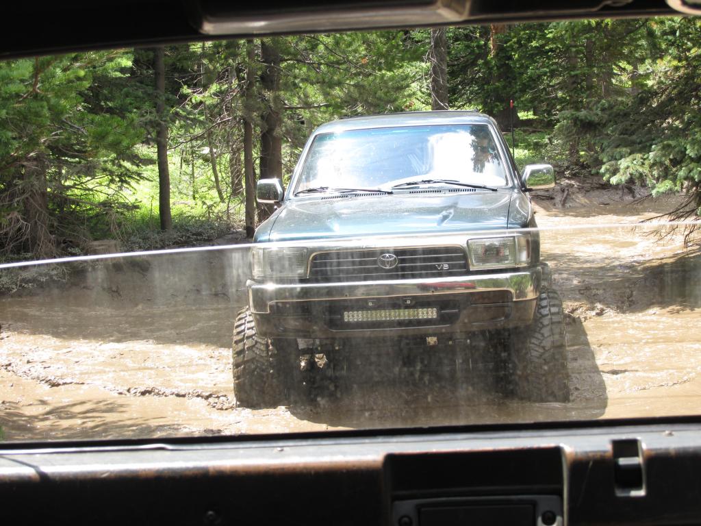

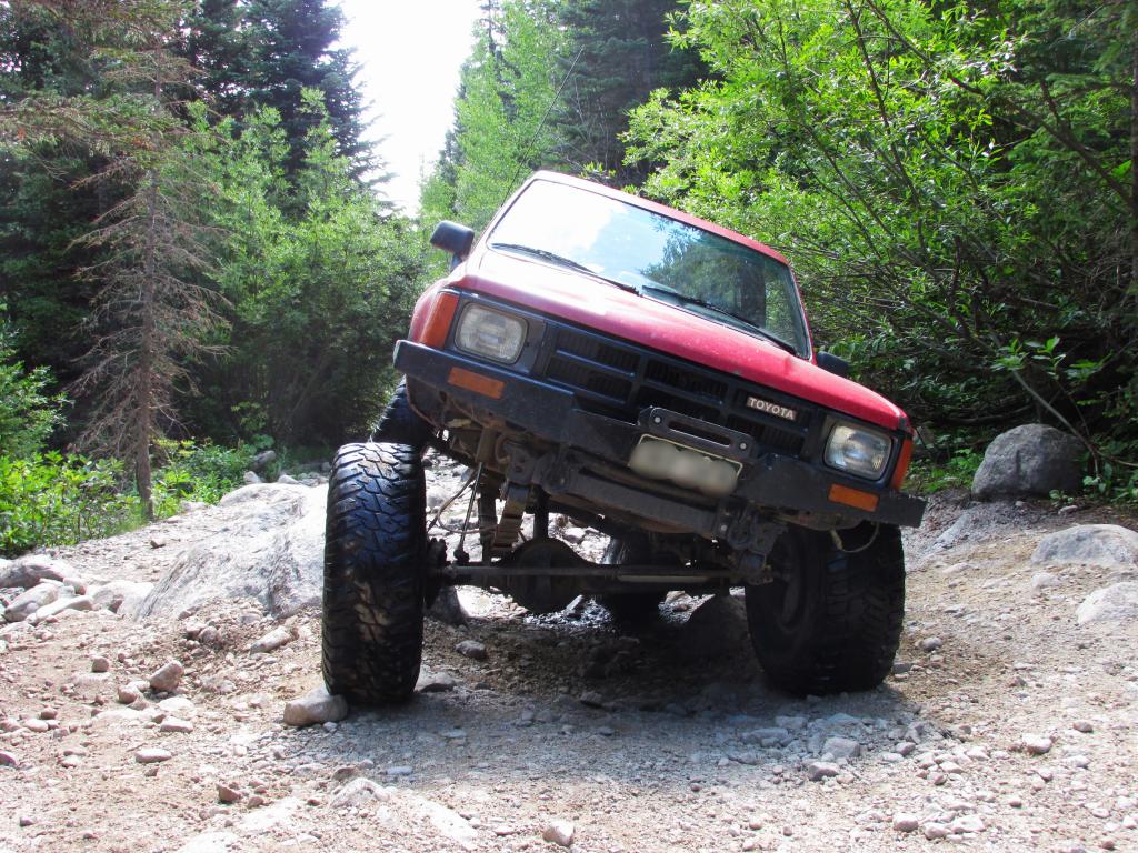

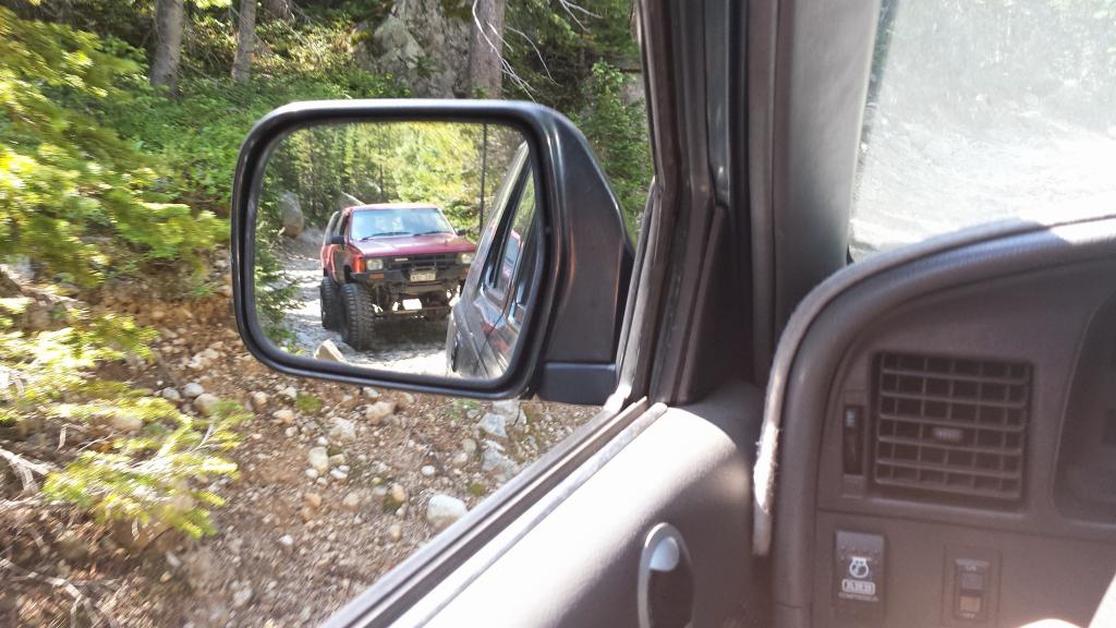

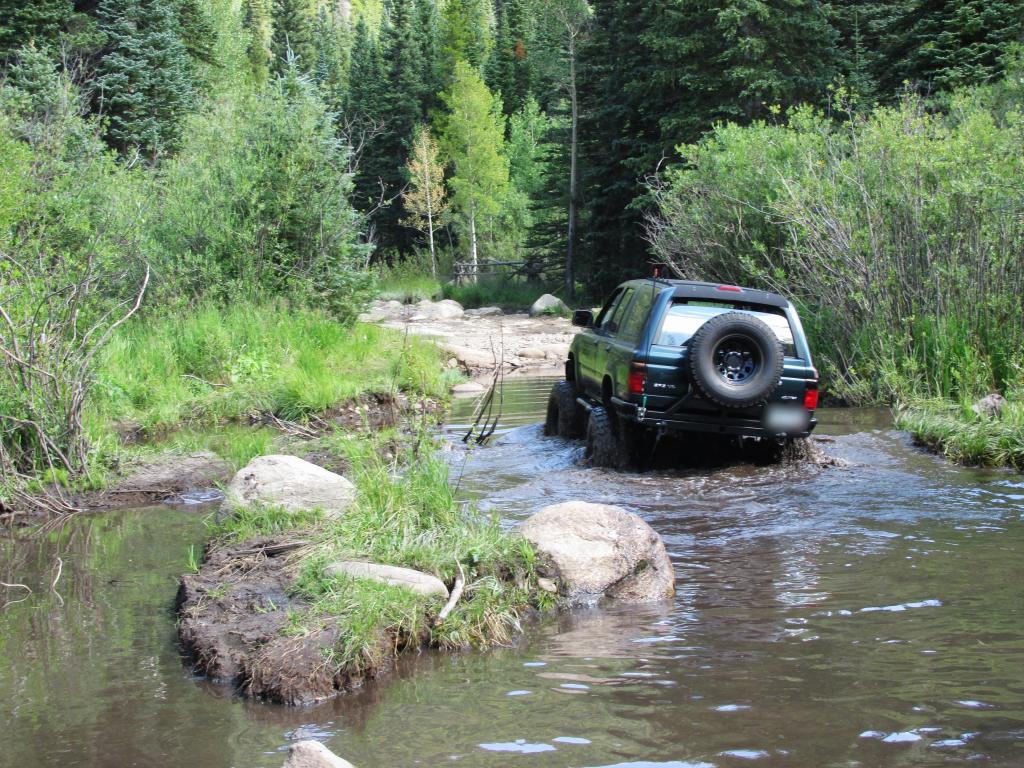

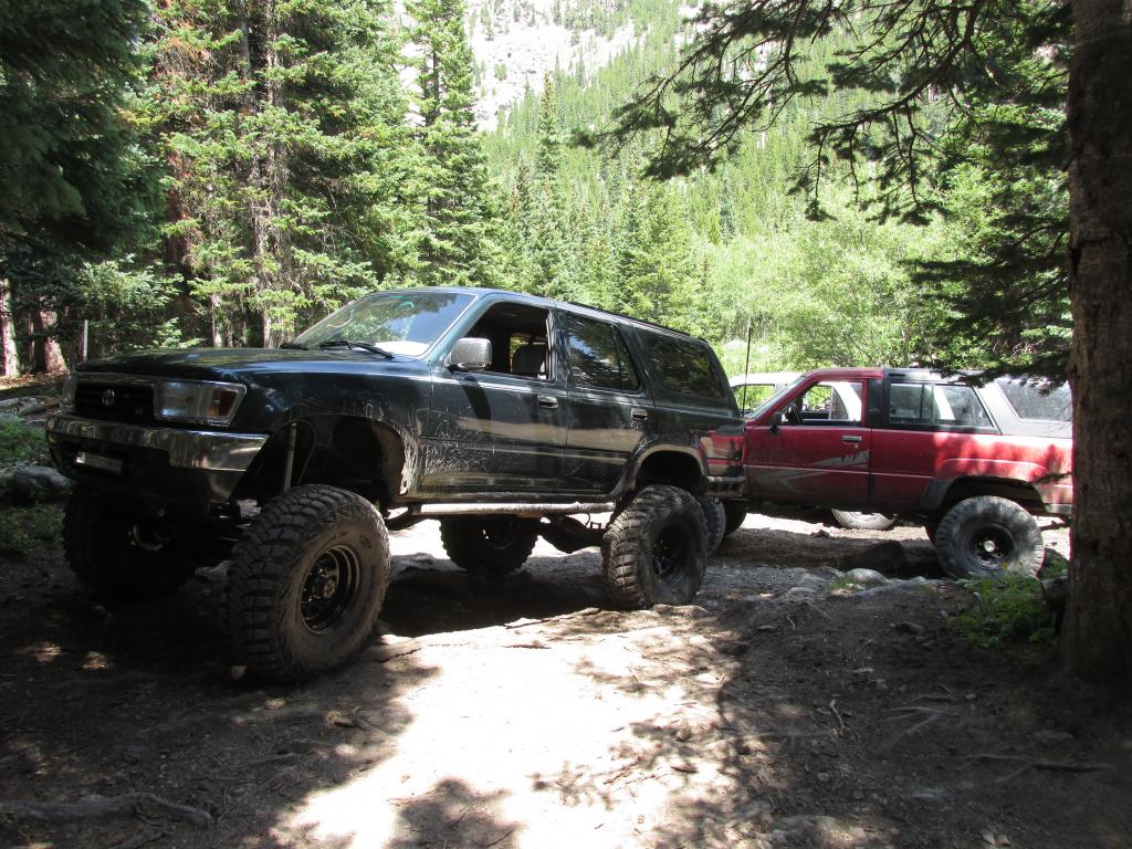

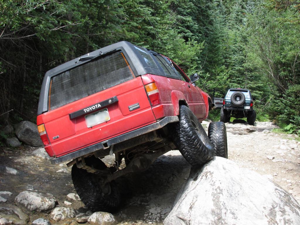

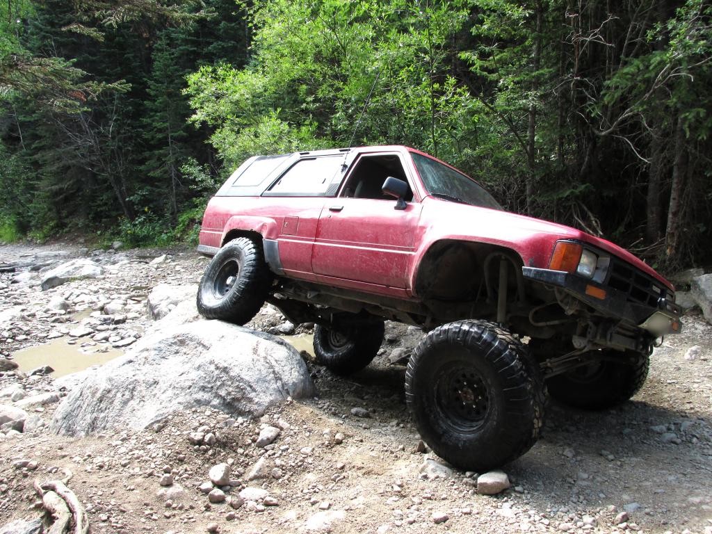

did some local wheelin on saturday with my budy and his freshly SAS'd 2nd gen, probably one of the cleanest around too! it was a nice shake-down run for him and a lot of fun for me to get out of the city for a few hours and play on some rocks
