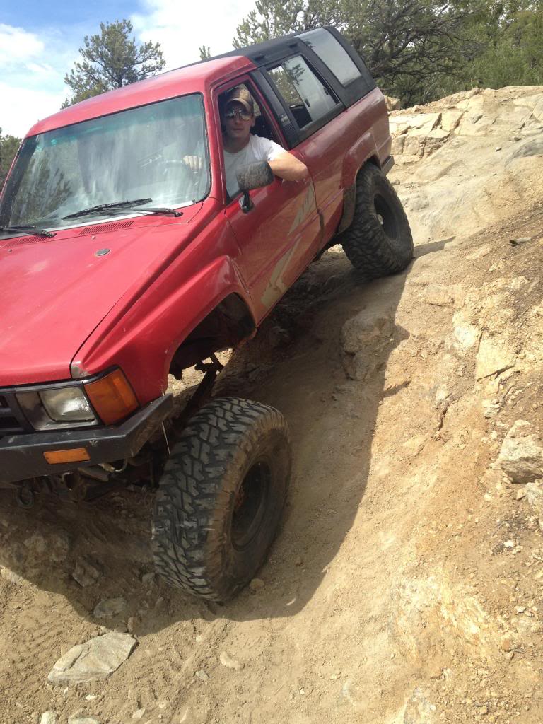

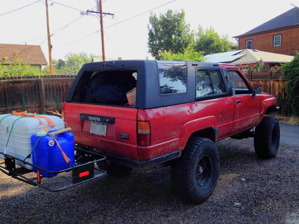

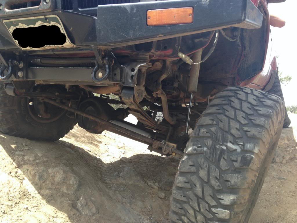

did a little wheeling over the long weekend, but once again didn't get good pictures.

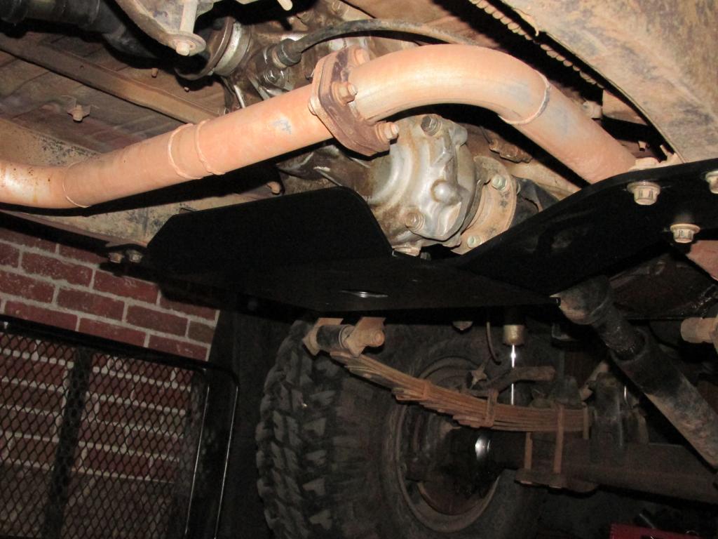

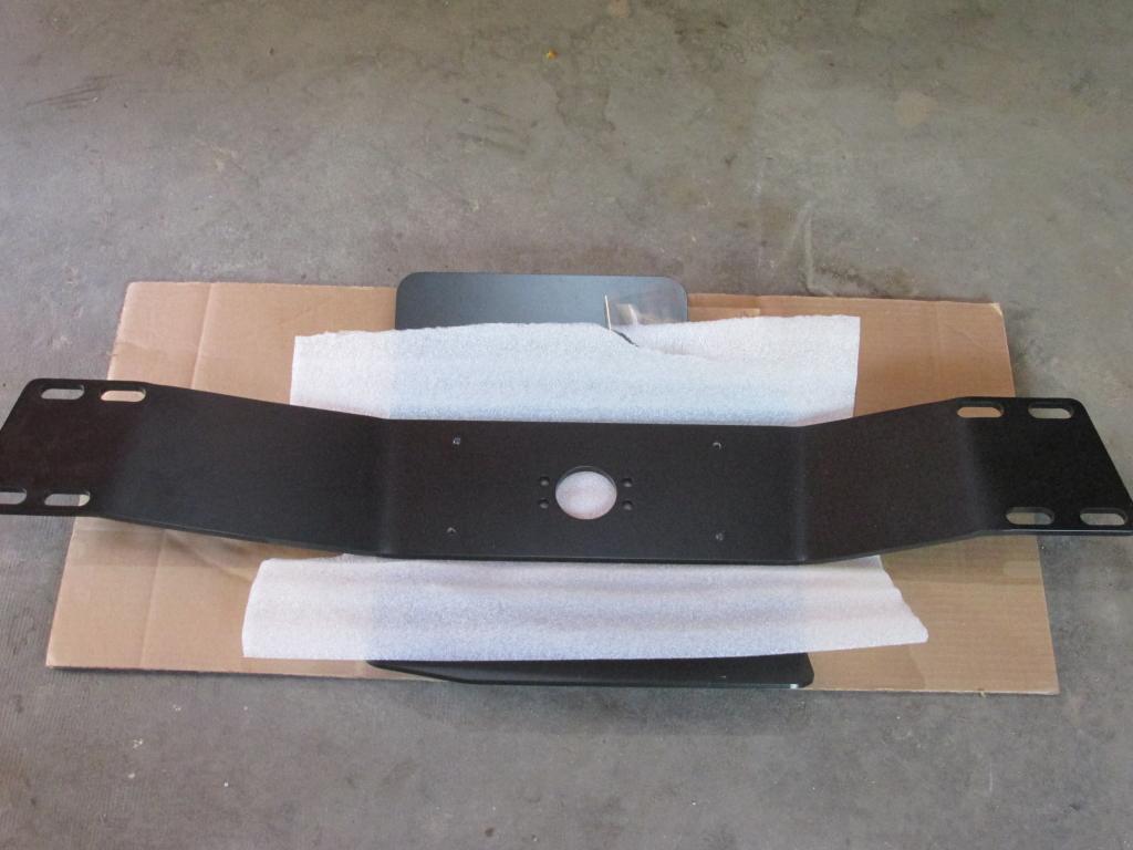

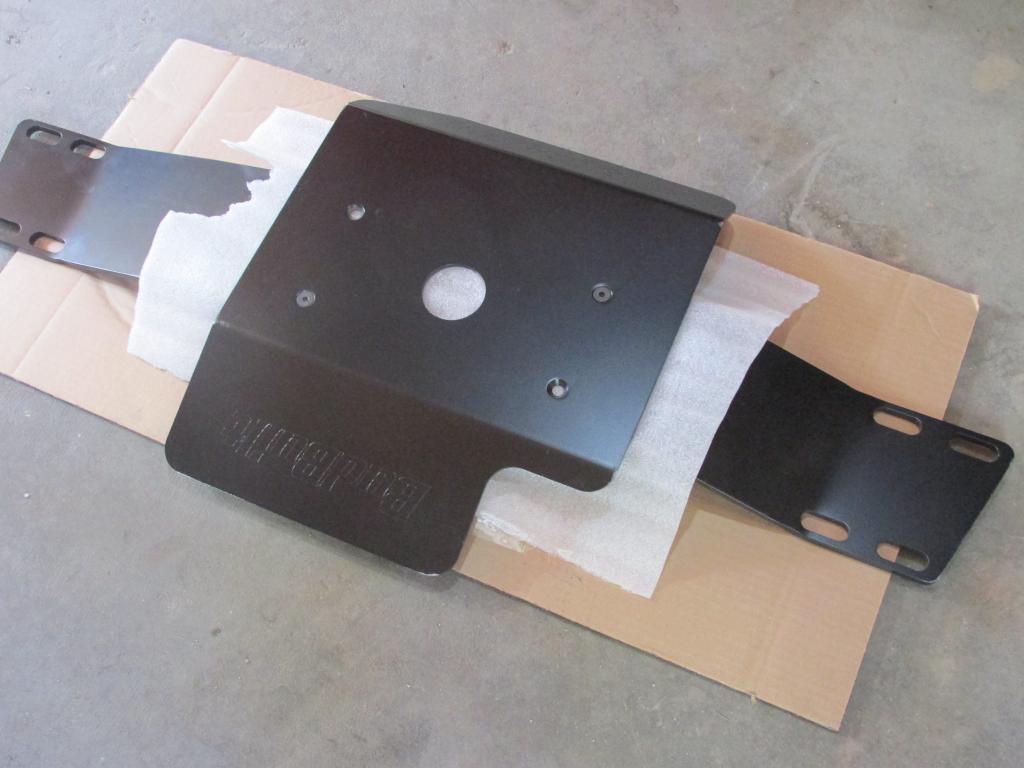

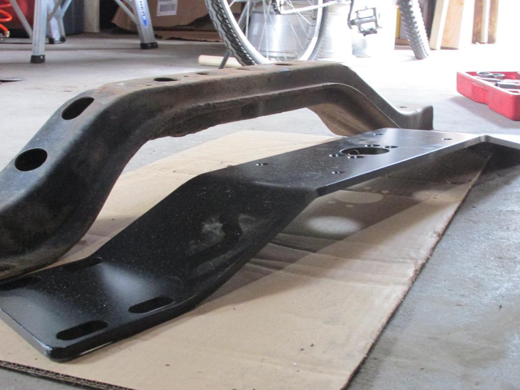

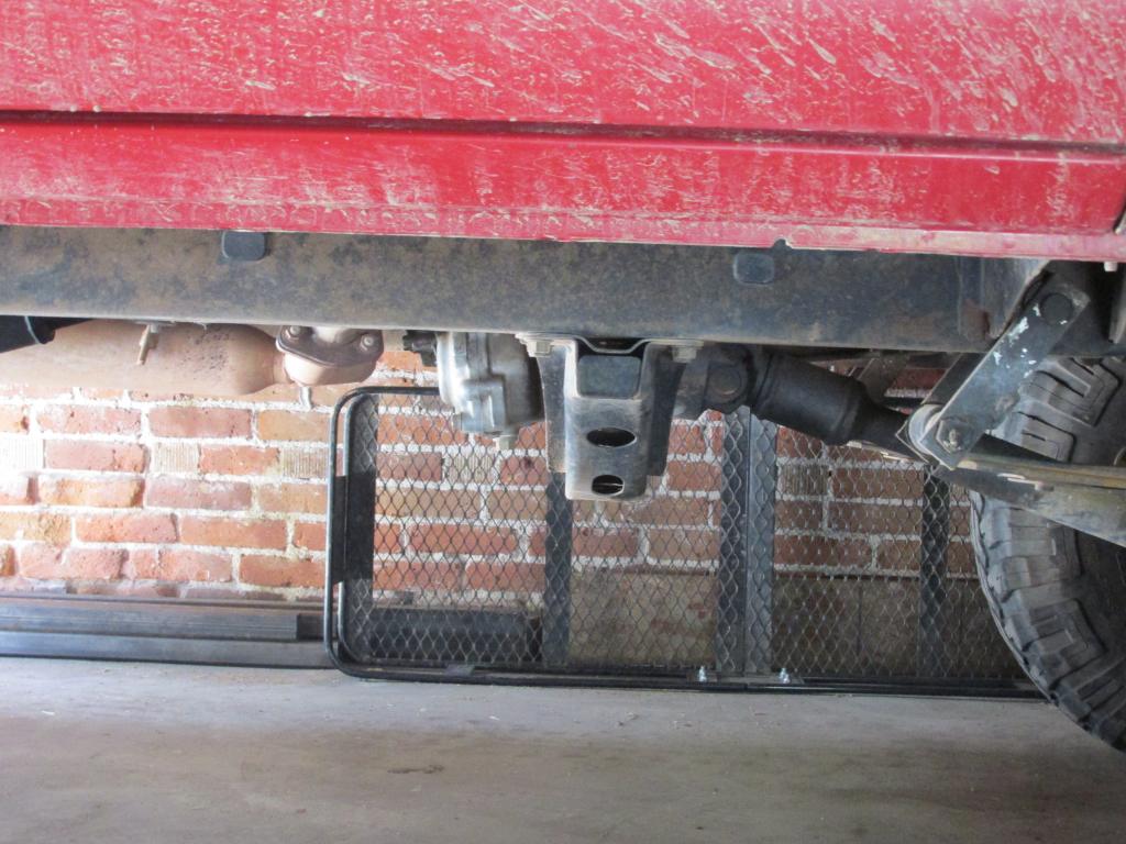

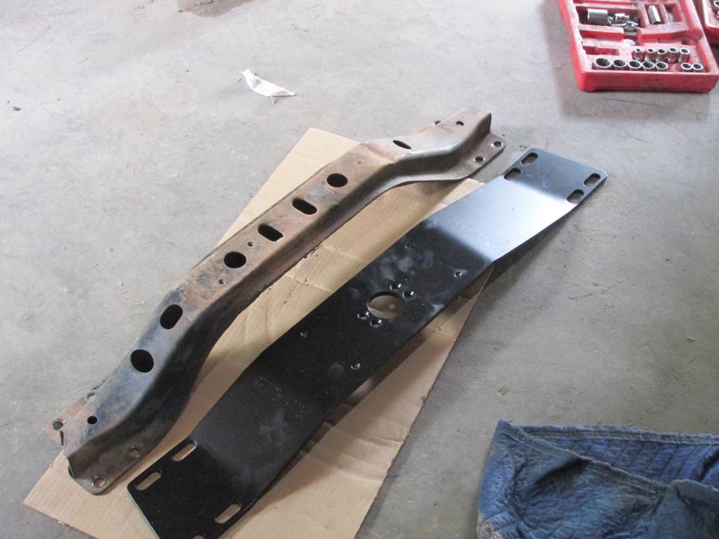

budbuilt install
i've knocked out #'s 1-3 on my "to do" list. here's a few pics of the budbuilt crossmember:
Unpackaged:
Factory one extended about 6.5" from the bottom of the frame:

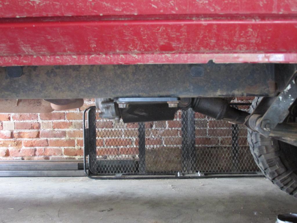

Installed. Budbuilt measured about 3.5" from the bottom of the frame:

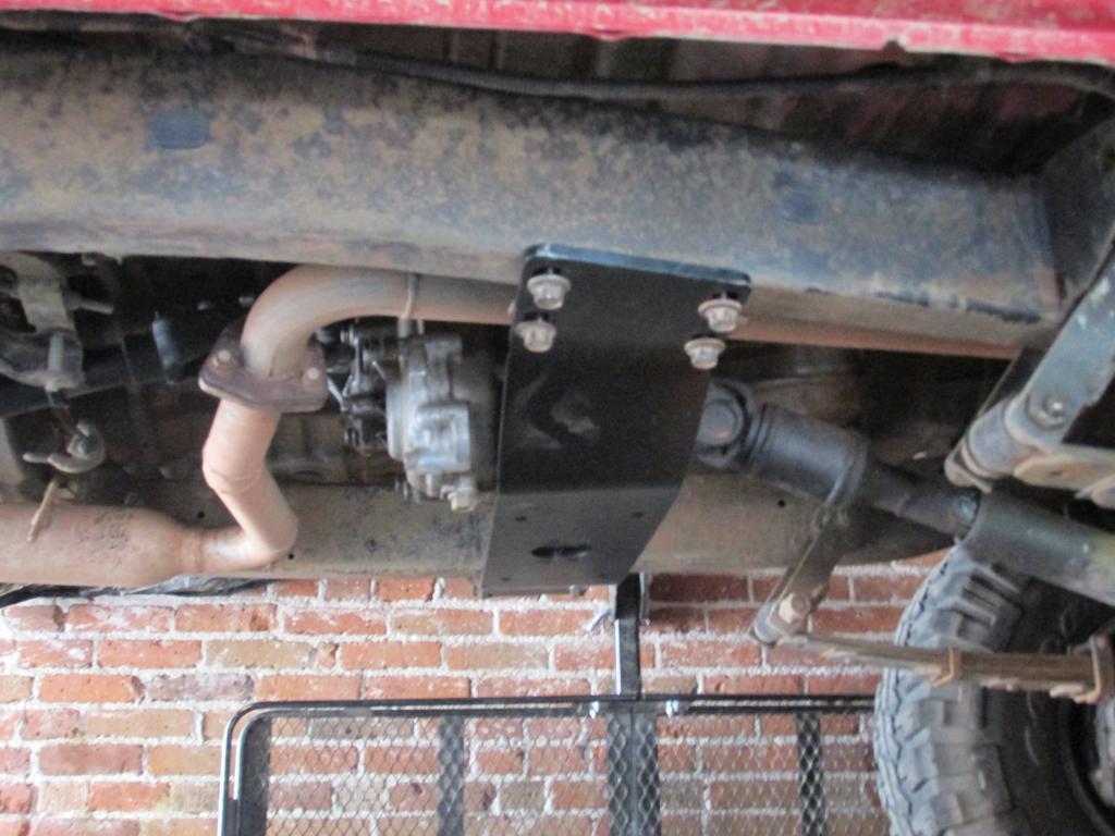

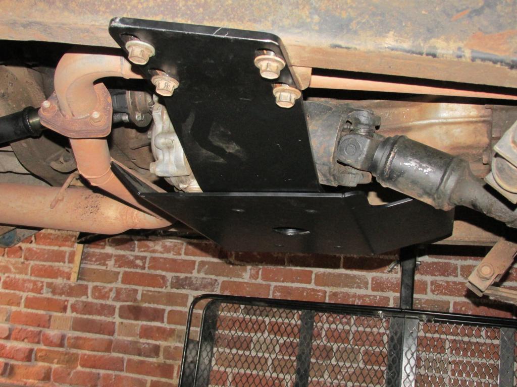

With the skidplate:
Overall i'm very happy with the product budbuilt makes. seems to be well made, fits as intended, and comes with all the required hardware. They are not timely though, so its a good thing i wasn't in a hurry.

Very nice! I did not realize the clearance you gain from those.
Does it retain the stock mount or come with a replacement that's smaller
Old Jun 17, 2014 | 07:35 AM
  #245
liveoffroad's Avatar
Joined: Mar 2008
Posts: 705
Likes: 19
From: Colorado
Yea it gained be about 3" of clearance but it was for a 1" body lift too, so that was part of it. it uses the stock t-case mount

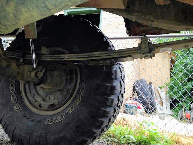

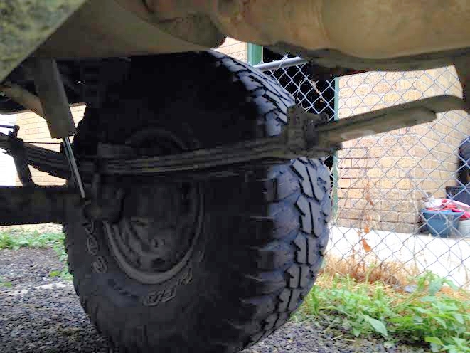

Leaf spring update:
i've been pretty disappointed in the chevy rears, especially this past year. as they've aged they've become softer, to the point that i've been hitting bumpstops these past couple trips when loaded with my camping gear (which isn't all that heavy). after this last trip i was so disgusted that i was ready to hack them off and buy some all-pro springs. however, after looking into the cost of new springs and mounts, i'd be in almost 500$ and that is not in the budget right now. SO i'm back to the drawing board trying to make these springs work for me. I've changed/added a leaf on them several times in the past with no luck, so i've decided its time for some more drastic measures. I pulled 1 of the chevy leaves out, (leaving 3) and added 4 thin toyota leaves underneath, tapering them as i went. i know it sounds like overkill, but i'm going for a fairly firm feel on the highway, rather than the soft boat-like feel that seems typical for these springs. only trial will tell....

More cool pics! That river crossing looks like it got deep in the middle! Cool tunnel too! I hope the new leaf pack works out for you!
