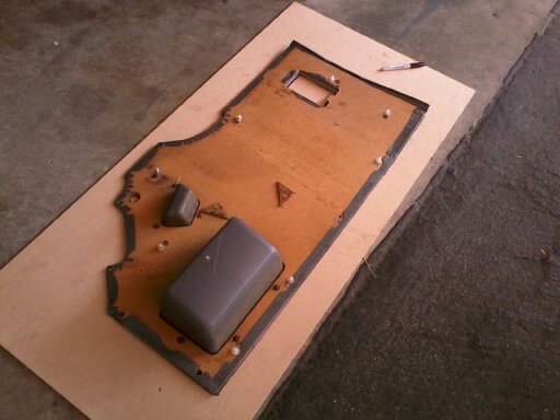

The old thin fiber board wouldn't be strong enough to hang the fairly heavy speakers without LOTS of rattling so I grabbed a few scraps of commercial grade 1/4" underlayment and went to work with a drill and jig saw
Lots of repeated measuring and test fitting ended up with this

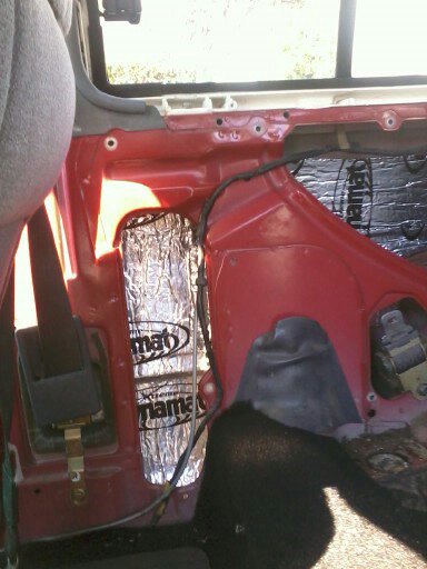

Since you can see it in the shot above we may was well mention spending some time with some Peel and Seal to cut down on road noise and vibration

well i had a little time to start my install this past saturday , i got the dyna mat in and the oem panels off, so i just need to cut the 1/4 mdf boards i picked up at home depot and order that rivet tool and hopefully be done by next sunday.

As for those tabs are concerend i'm gonna stop by a shop that does car interiors and ask them whats the best way to remove them and if they got some more I can use put them back cause the inserts that
Go thru the panels are pretty thin so if I cut the tabs off I will be cutting the inserts of the plastic pieces , but I will find out tomorrow , then I can proceed with cutting the panels out.

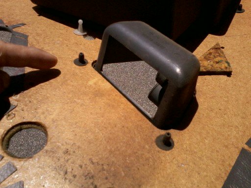

^^dude those clips are just some metal washers type deal ,they just pop off ..when you remove them you will bend them , you can flatten them and re use them

kinda had to take a break when i ran into these , they hold the plastic trim to the door panel and the side pockets on the sr5's
