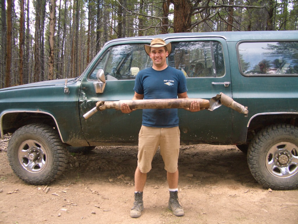

And once again, spent all day saturday fixing the suburban haha

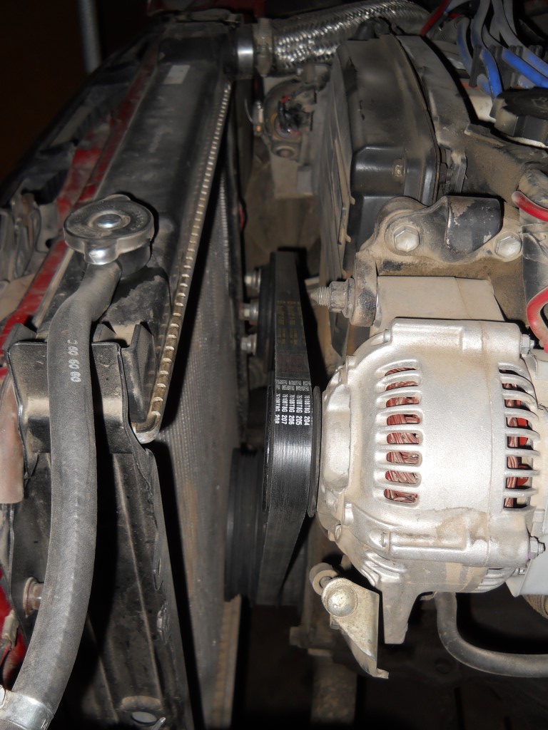

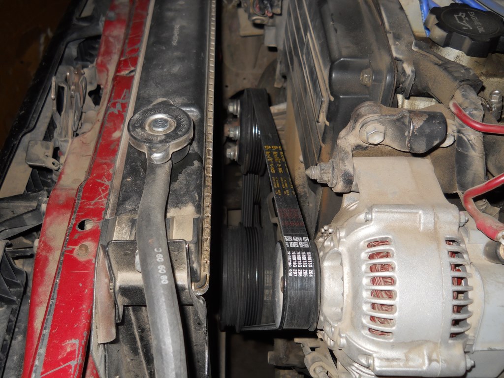

new belts and harmonic balancer. got rid of a lot of engine vibes

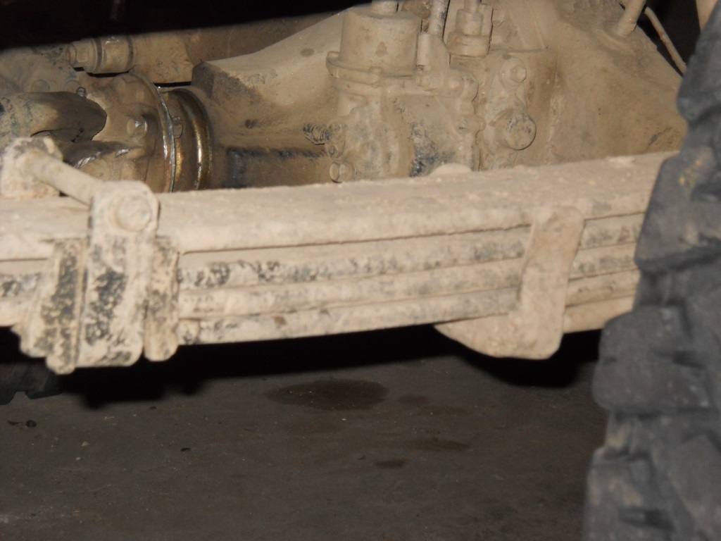

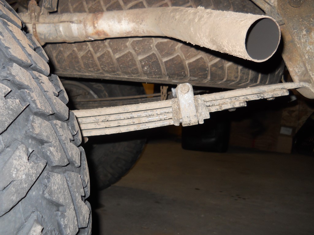

new rear leaf springs, finally found the HD 1/2 ton chevy springs that i've been looking for for over a year. you can see they have 4 leaves + the overload, as opposed to the usual 3

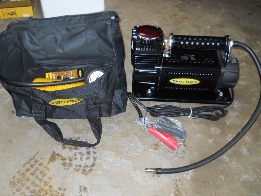

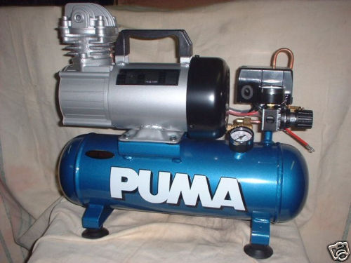

Had a lot of fun at jambo and my rig did pretty well. one thing that bothered me was airing up every evening. My faithful Quick air 2 compressor has treated me well over the years but when i made the jump from 33s to 35's it has struggled to get the job done. it has been taking me about an hour to air up. And so i began the quest of finding a reasonably priced upgrade. I know the new thing is CO2 but i dont like the idea of carrying that big thing around, plus it costs money to refill whereas an air compressor is free to run.
After searching the forums, i found a lot of guys running the superflow mv50's and mv90's which are very reasonably priced for what they are (both put out more cfm than my tired quick air 2). I decided that i wanted a little more though if was going to upgrade so i started looking at the bigger ones. Vlair and ARB both make some good compressors but they are very pricey.
I came acrross this:
3 gal tank, 3 cfm @90 psi, 12v for 230$
i found a few guys are running one of these on the forums and so far they all seem happy with it.
I also found this, which is relatively new to the market:

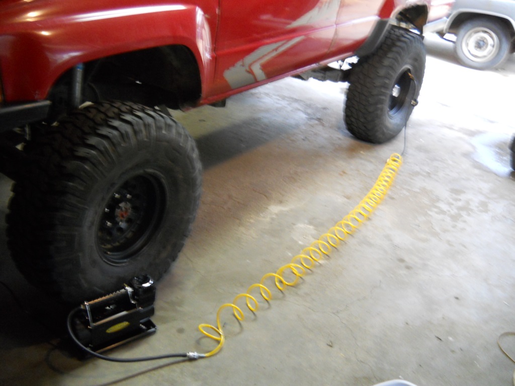

Smittybilt Part 2781 - 5.65 CFM Air Compressor-RH1
I'm a little skeptical of smittybilt because i know all their stuff is made in china now, but the limited number of reviews i found on this compressor praised it. and so i decided to go this route since it was almost half the price and i didn't really need an on-board air tank.
I found one NIB on ebay for 130 shipped, and it arrived a couple days later. I am pleasantly surprised at how well it is built. The body is mostly steel and fairly heavy. it is significantly larger than my old quick air 2
And since i couldn't find a good write up on this thing, i decided to do my own time study.
i aired down my mtr to 10 psi, hooked up the compressor and let it go.
the first thing i noticed is that it is very quiet! much quieter than my old one. the guage they provide is only accurate when the pump is off, which made it more difficult to get an accurate time measurement... but it was roughly 3.5 min to 37 psi! I am very impressed. Only time will tell if it is built for the long-haul, but so far i would definitely recommend this compressor to anyone running larger than 33" tires.
