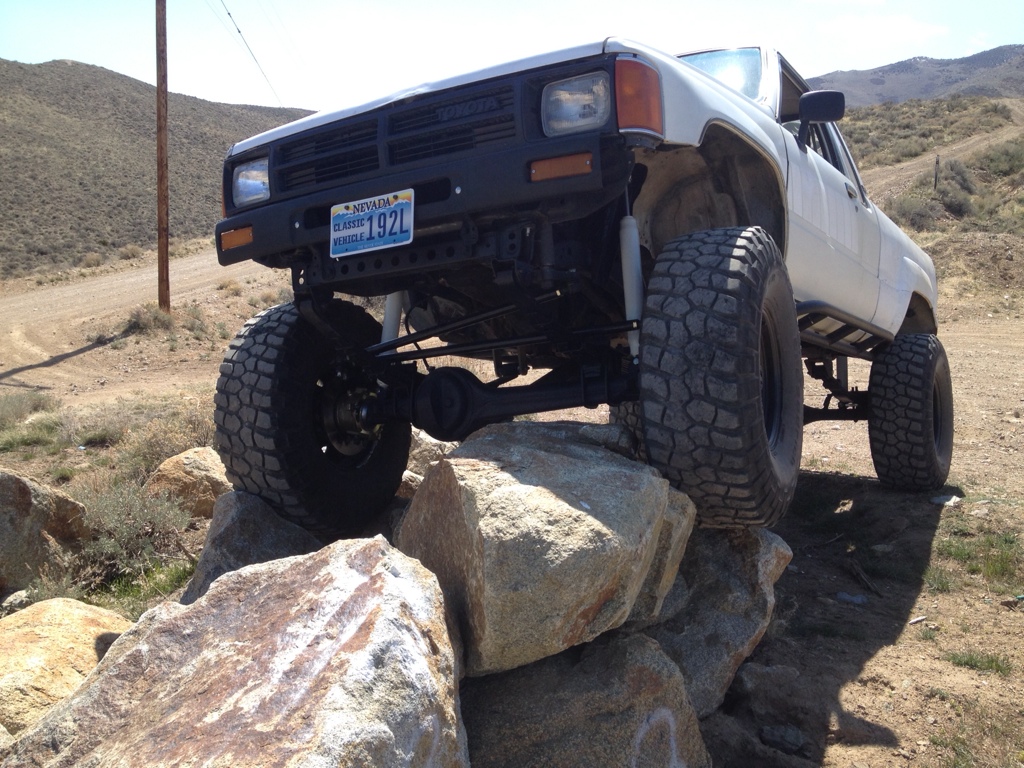

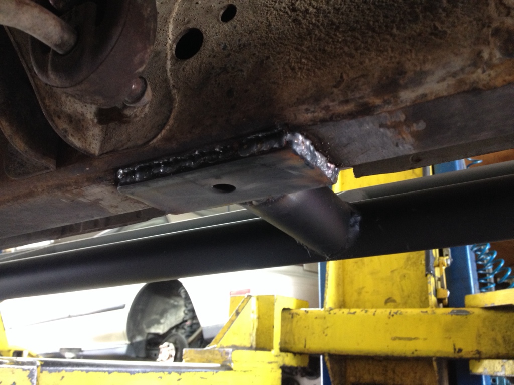

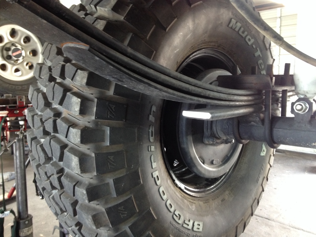

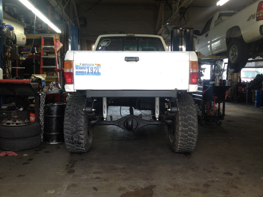

Went to the shop toady for a few.

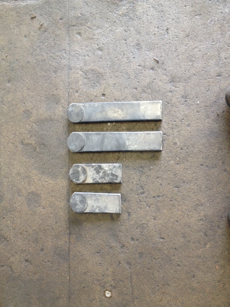

Finished welding bottom slider plates
Cut overloads down
Left about 2" the rear

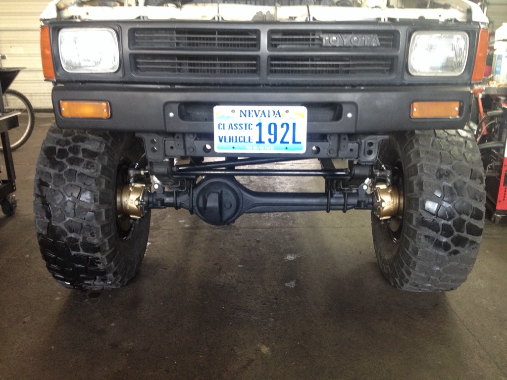

And left 8" in the front for axle wrap

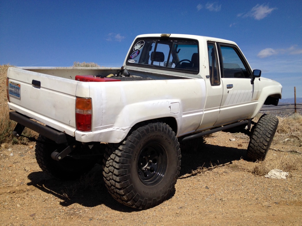

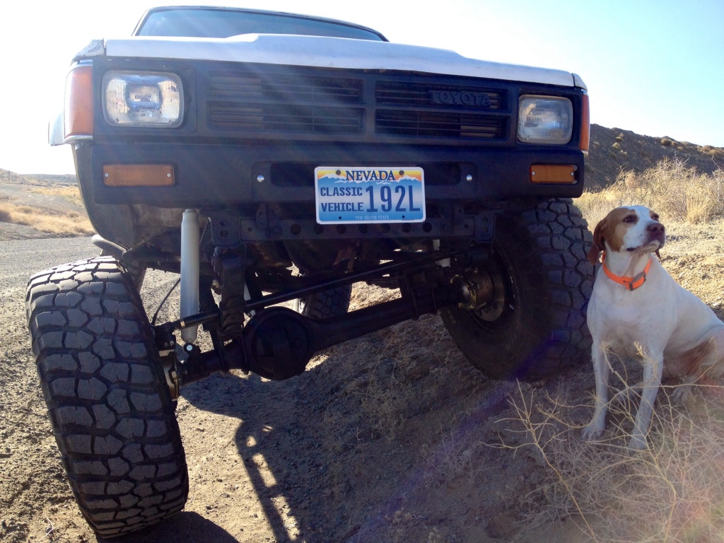

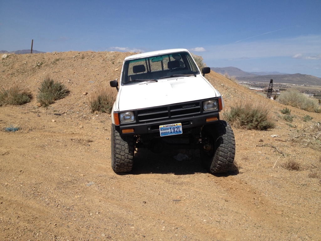

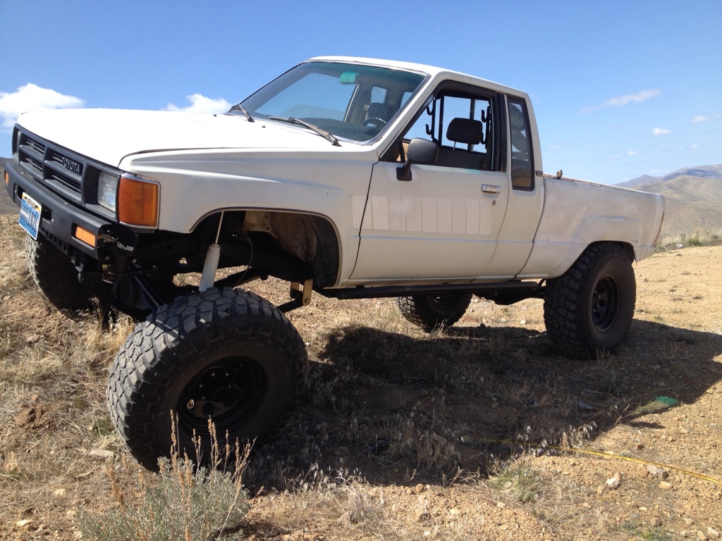

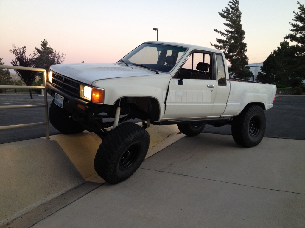

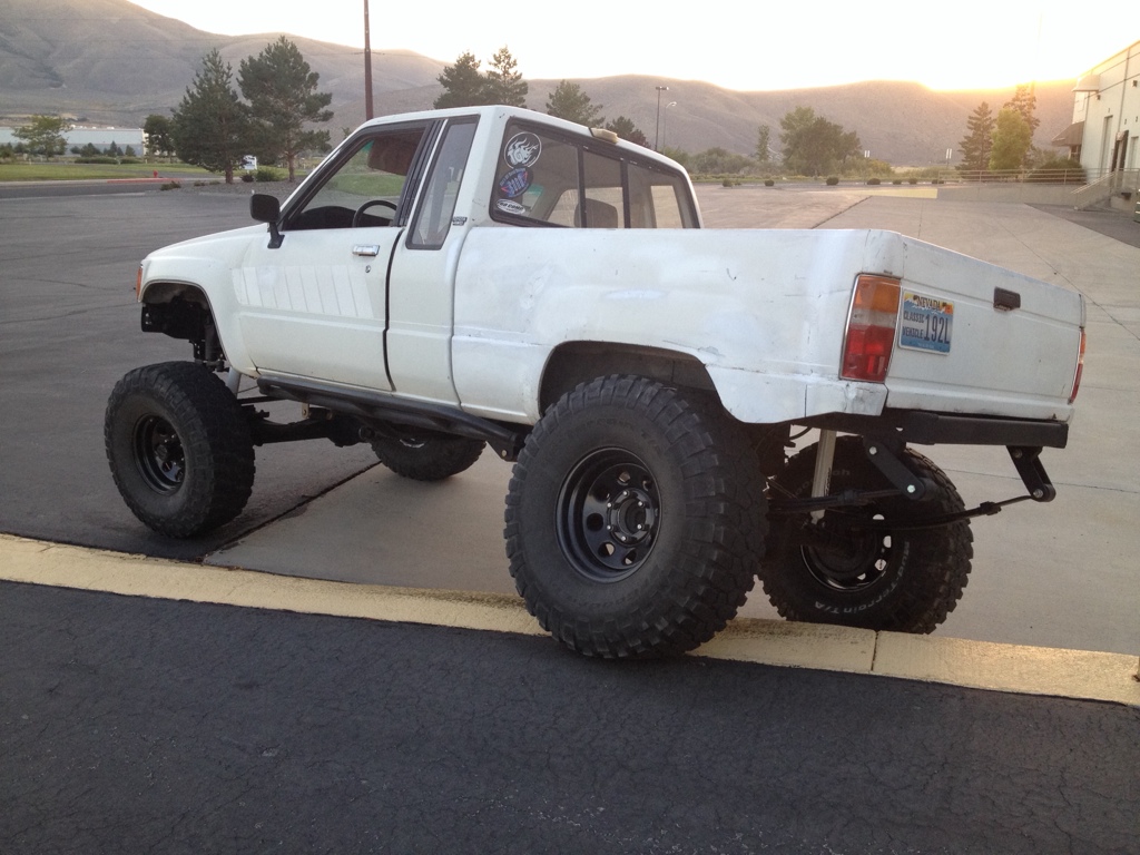

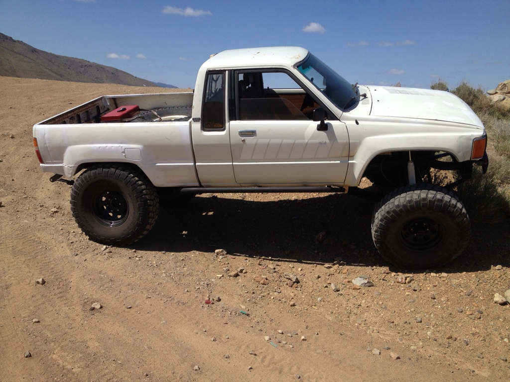

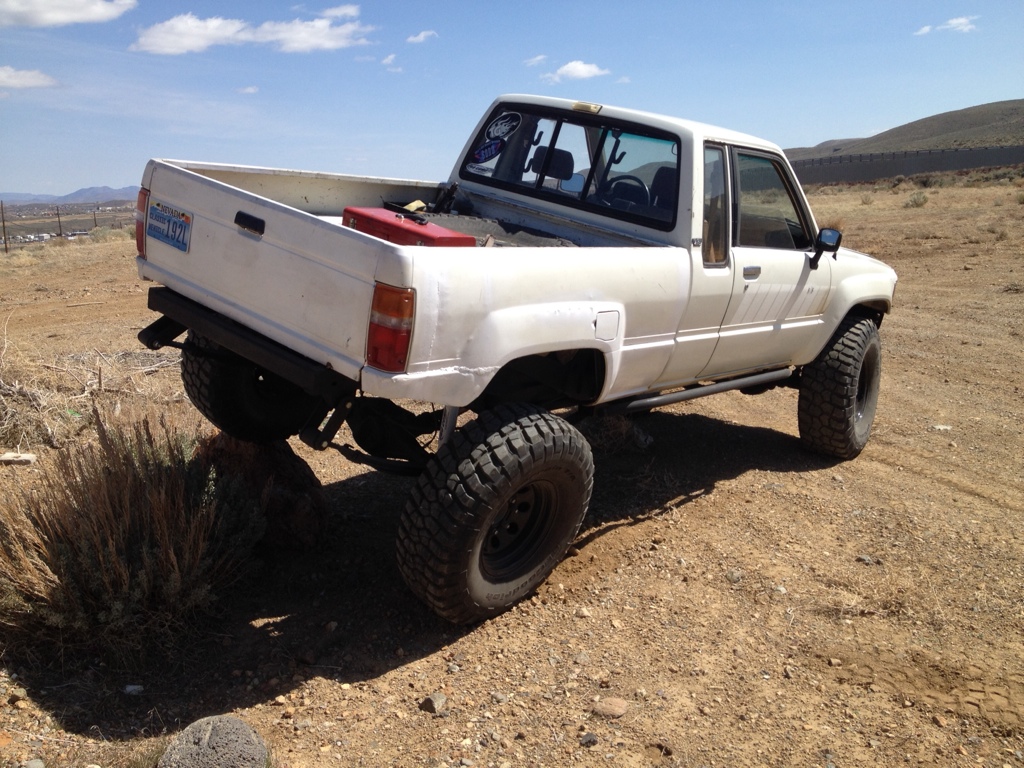

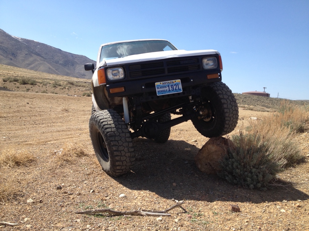

Figured I'd take it to the dirt finally. Nothing much no time for trails today. Just a run up some service roads & a couple of poser shots.
And My favorite
I forgot how gutless these trucks are with 35s & stock gearing. Looks like 5.29s are in the future. I must just be used to newer lifted ifs trucks cause this this rides like ass on washboard roads at speed.

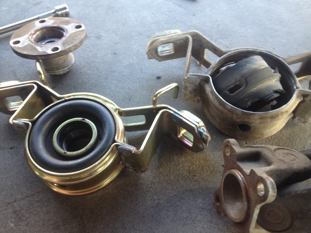

Put quite a few miles on it this week around town. Got really tired hearing the wore out center bearing letting the driveline wobble around . Every time I'd take off or shift it felt like the driveline was hitting the underside of truck. Kicked the idea around of swapping in a 1 piece driveline , but it would hang down quite a bit lower and become easier to damage. Pillow block was another option but decided to just replace it with a new center bearing. Soooo much smoother.

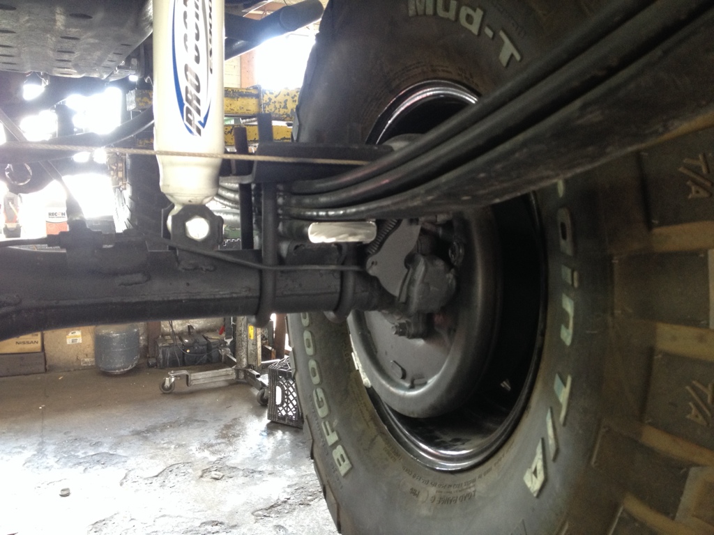

Originally Posted by Stevesk88
Why upsidedown shocks man?
That's correct mounting for those pro comps ( Es9000 ) and most other cheap nitrogen filled shocks. It's Stamped right on them toward the bottom " mount this side down " with an arrow pointing down. Cellular gas / air / and oil shocks can be mounted either way , most nitrogen shocks will develop dead spots if mounted upside down. On a side note these shocks blow and will be upgraded to some fox or Bilstens in the future.

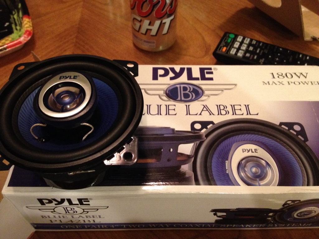

Picked up some Pyle blue label 4" dash speakers on amazon. Had like 800 reviews with a lot of 4&5 stars and the price was right. Quite a few 2nd gen toyota reviews which helped the sale lol. Fit nice & came with enough mounting hardware & new speaker wire for install.

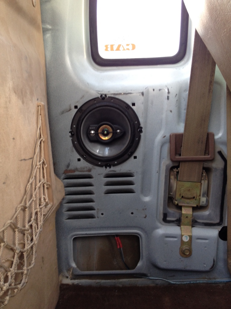

Mounted some 6.5"sony speakers I had ontop of my tool box for awhile. Fits nicely in the factory xcab speaker holes with some new holes drilled. Also ran new wire to the deck. Will look nicer when I get around to making the wood panels .

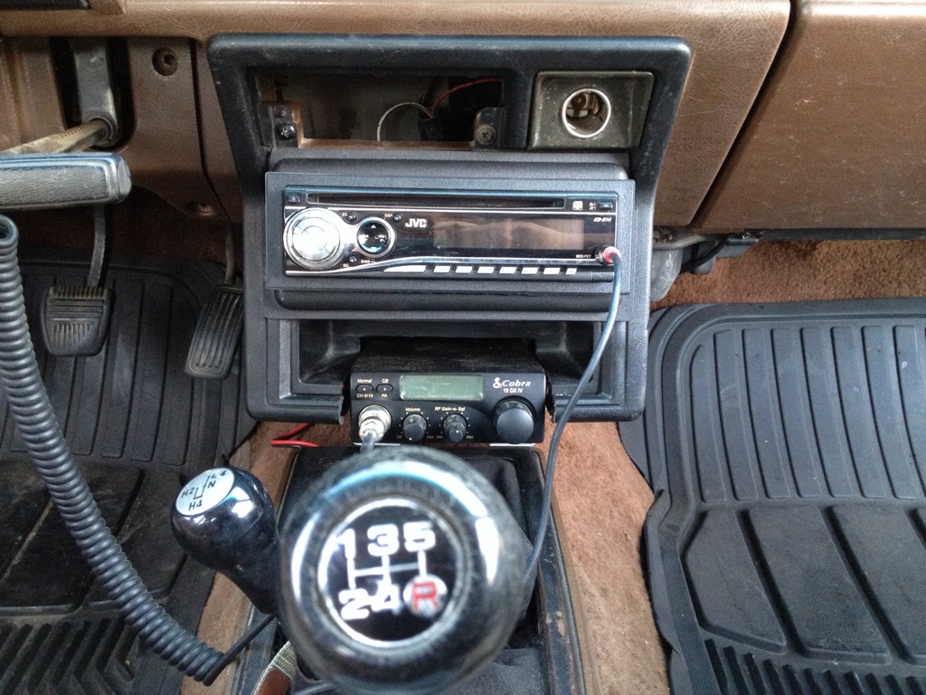

Had a old jvc deck with cd & aux port . Went to a local stereo shop and they let me scavenge through their opened up kits . Was able to find enough trim peices & cage to make it work ( with the help of a dremel )
Overall sounds decent. I wast expecting it to slump or anything but could use a small amp in the future.

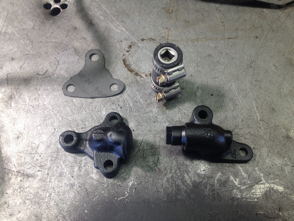

Whats the saying ... Trouble comes in 3s.
Well the other day wheeling some trials by the house all was well for the first hour or so. Then the truck started to run rough. As I got closer to my house it began to run like garbage . Got it home and started to tear into it.

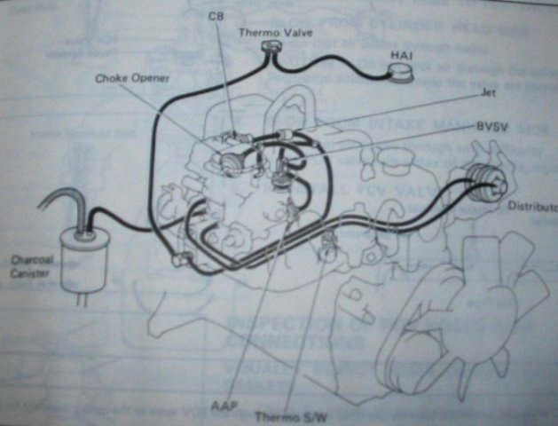

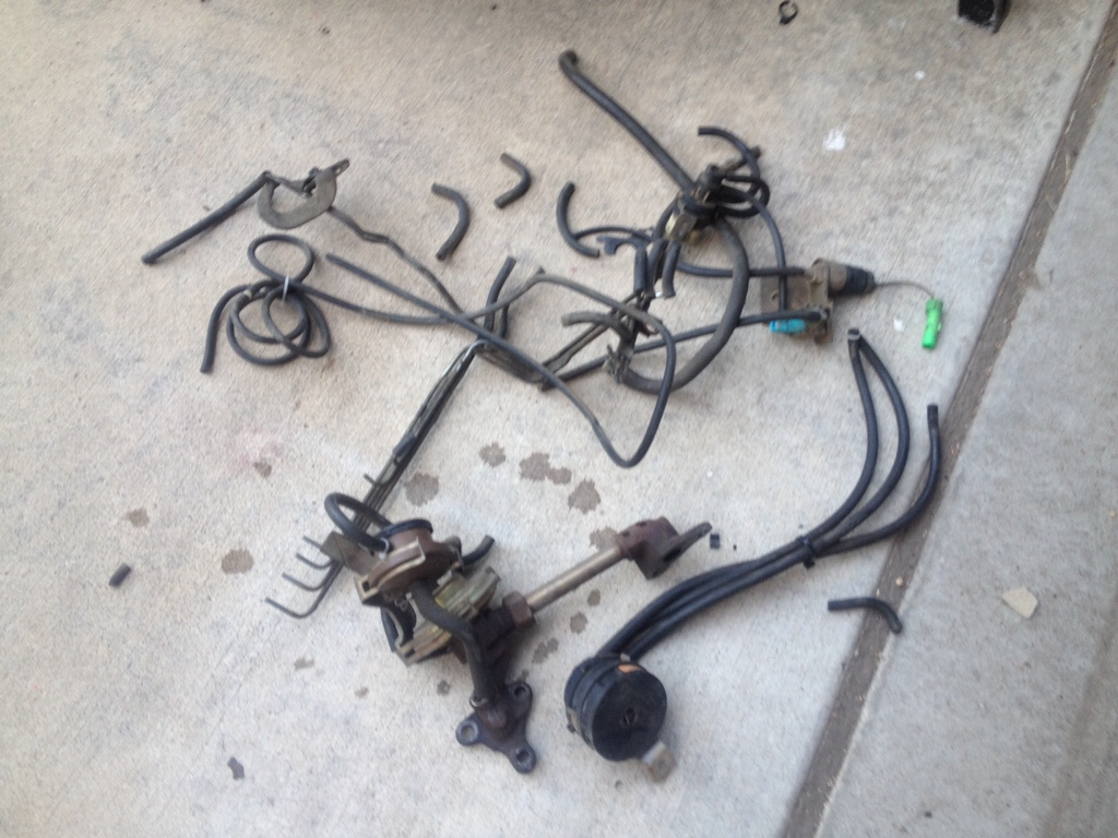

Trouble #1 - Found multiple vac lines unplugged ( when I rebuilt the carb awhile ago I noticed the vac lines were hard & seen better days but never got around to replacing the vac hoses ) .
So instead of replacing all of the vac I decided to delete most of it.
Here's round one...

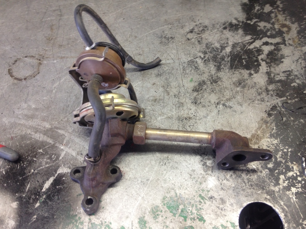

Then took the egr off head & intake and instead of buying or making block off plates I decide to chop up the stock egr and weld shut.
Before
After - Chopped & welded shut. Painted & made a new gasket for head side egr block off plate. Also made a plug for reed valve since I won't be deleting the reed valve / air injection untill I replace stock ex manifold for a header.
Basically I went from cali emissions to Canadian emissions.

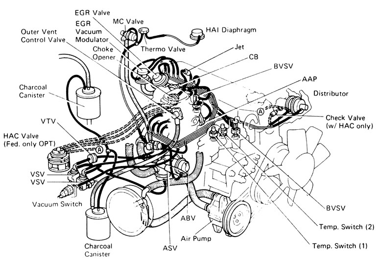

Before ca emission -
This is the Canadian emission chart I followed and am currently running. Replace all lines with new vac line as well. Capped off all unused ports on carb & intake.
Well it runs better , but still runs a lil rough.

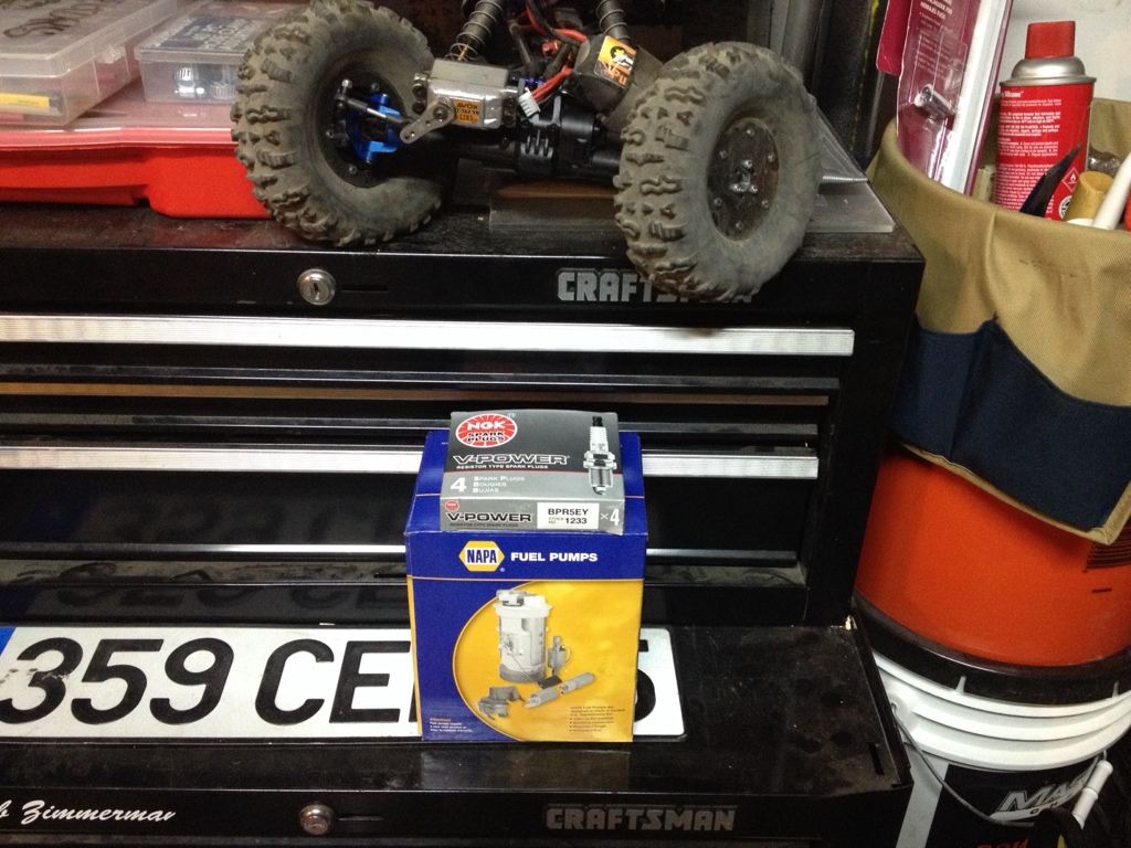

Trouble # 2 - noticed fuel pump was spitting fuel out of the weep hole ( 2 year old pump with less than 500 miles on it ) diaphragm shot .
Bought a new pump ( napa ) and a new set of plugs ( NGk ) for good measure. Also noticed my plastic fuel pump spacer was cracked so I replaced it with a new metal spacer.
Still running rough.

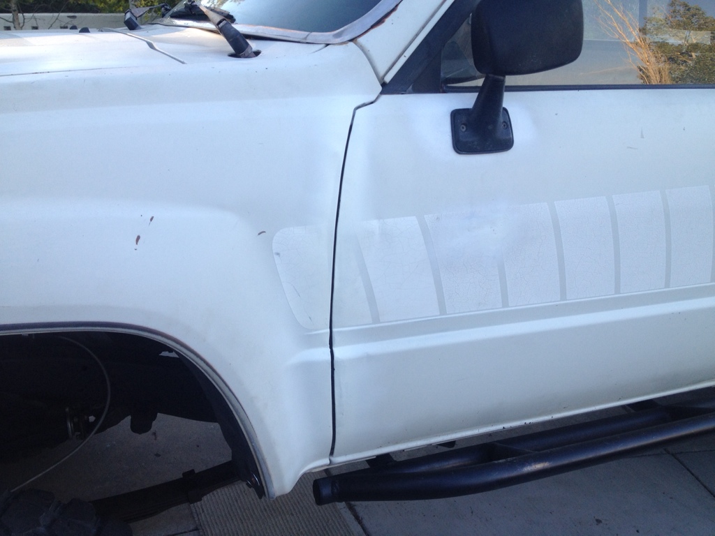

Old Sep 7, 2014 | 10:00 PM
  #260
775Toy's Avatar
Joined: Dec 2011
Posts: 415
From: 775 Reno Nevada
Pulled door & fender today . 2 hours of hammer & dolly , pry bars and beer. I was able to get the gap closed up and door working properly. Lightly sanded the edges where I was hammering and prying and shot the area with some white primer.
