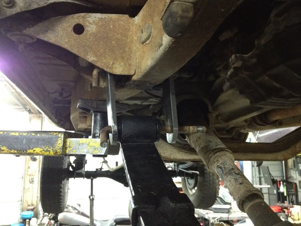

Originally Posted by streetlancer
Nice, very nice! You make quick progress. You'll let us know how those chevies ride won't you? I'll most likely be using those too.
Trail-gear hangers you said? I cant seem to find them in their website.
How did you know where to mount the hangers? Did you use a jig to hold in place or did you just eyeball it? I'm concerned about the placement, for example: how did you manage to get them parallel along the bottom of the frame? If they were off does it eat the tires because off bad alignment?
I bought the hangers from a local guy who bought them from trail gear. I'm pretty sure they are on the website under suspension or something.
I didn't use a jig , the front hangers are wider than the frame so I basically centered them , then went 11" forward from center of bolt hole from the old hanger to the center of new. Then used a big c clamp to hold them down while I placed the rear shackle mount where I wanted ,Keep in mind like the pics show I have all hangers/shackles/leafs ect bolted up and attached to the diff. Made sure I was in line with the front hanger, then figured out my shackle angle , which I set at 35* which was about 3"back center to center from old shackle mounts. Then tacked the rear shackle mounts , double checked my front hanger measurements and tacked those. Then measured from rear of front hanger to the back of frame on both sides to make sure it was all straight and finished the welds.
Here's a quick idea of how I Got 11" center to center on the front. Keep in mind that every build is gonna be a lil different depending on where you want your rear wheels to sit in the wheel well , I wanted them to be almost stock or a lil forward cause I will be stretching my front axel out a few inches and dont want a crazy long wheel base so I did stock or a 1/2 in or so forward on the rear. I will need to trim wheel wells anyways so it won't be an issue. Some like to set the front hangers less than 11" so it puts the rear axel back in the well to stretch base.

Not a real productive day. Walked around the shop looking for tools I just had ! Nothing lined up , ect ect. I did finish my front shackles , and get started on my front suspension. I didn't bother cleaning the frame or differential , gonna rebuild the front diff and add armor and a truss so it will get cleaned up them and brackets cut off I don't need. The frame will get cleaned up when I get my ifs box mounted.

44044s with sky's ubolt flip and homemade shackles mounted up ready to go in.
So I had a brain fart when I got my new grade 8 hardware , did compensate for the Toyotas off set shackles in front. So my bolts weren't long enough and didn't have a spacer for the gap it creates. So to get it on its own weight and get it out of the shop I had to improvise. Old ubolt cut in half lol. Will hold it in place till I get correct bolts and spacers.

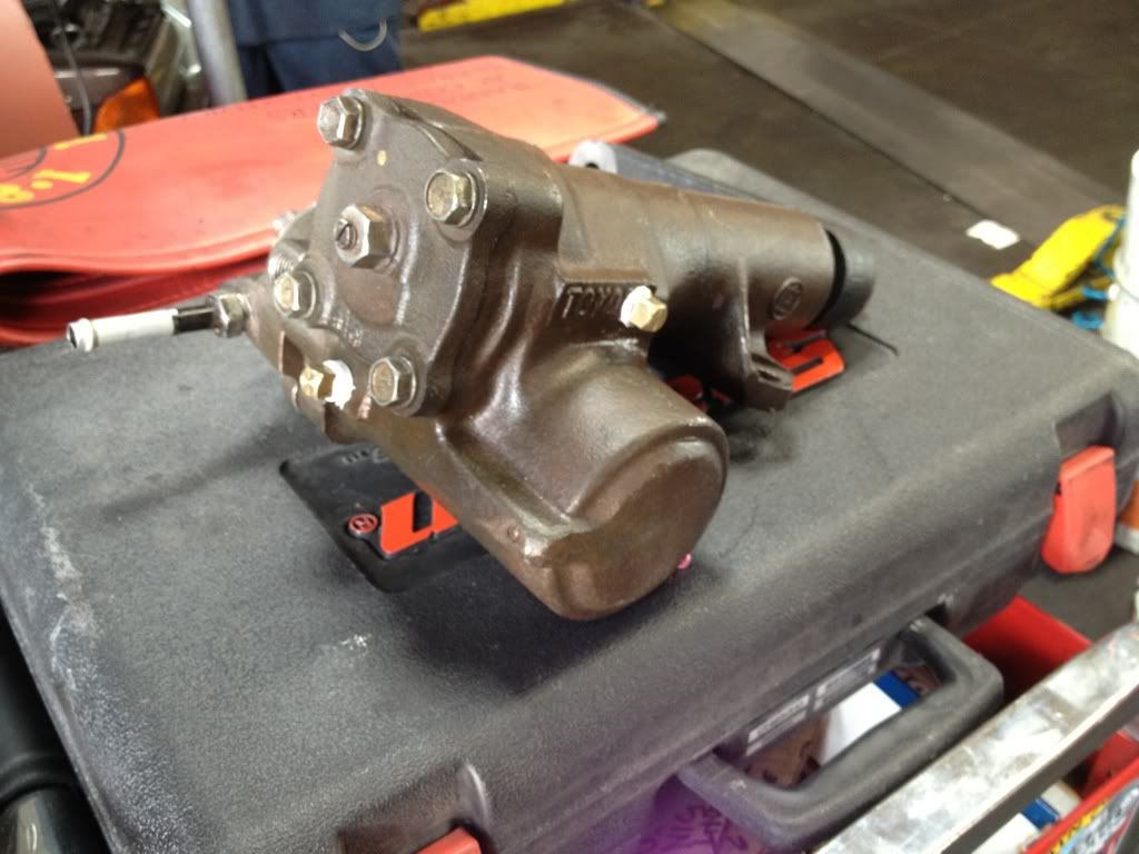

So a week or so ago I got a ifs power steering box thats already tapped for hydro assist to use with my high steer kit, I picked it up for a case of keystone ! I was told it just needs a new o ring on the worm drive cap. So I pulled the worm drive out like a newb and dropped all the little ball bearings in the bott of the piston. So I tore the rest of the pump apart to put the bearings back in. I only counted 43 bearings , but read 43 / 44 and 45 online? So I tried 43 that I had , it would jam up after a turn or 2. So I tried 44 with same results , 45 seemed to work. Got it all back together and made a home depot run to pick up some pipe plugs to plug off the hydro assist holes for now.

Looks good man, I need to replace the worm drive seal on mine. Supposedly when I bought it, it was a marlin rebuild, but the front seal is leaking t the steering shaft. I may go a head and tap it for hydro steering later on.

Might as well tap when it's all apart. Even if you never use them the option is always there.
