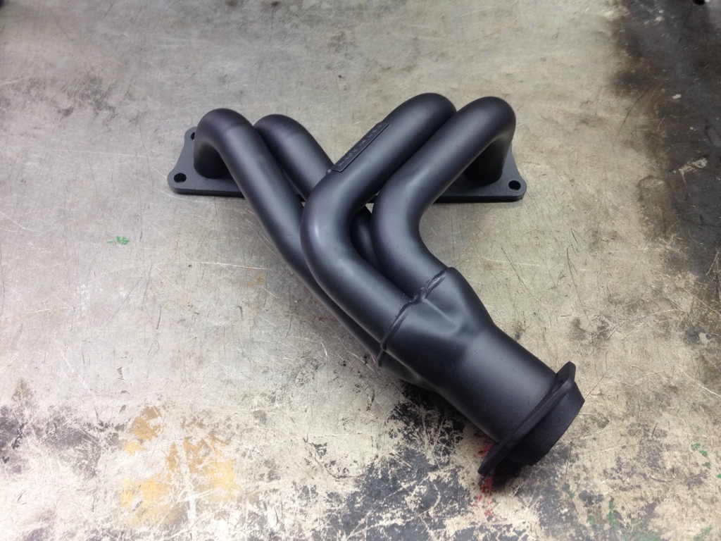

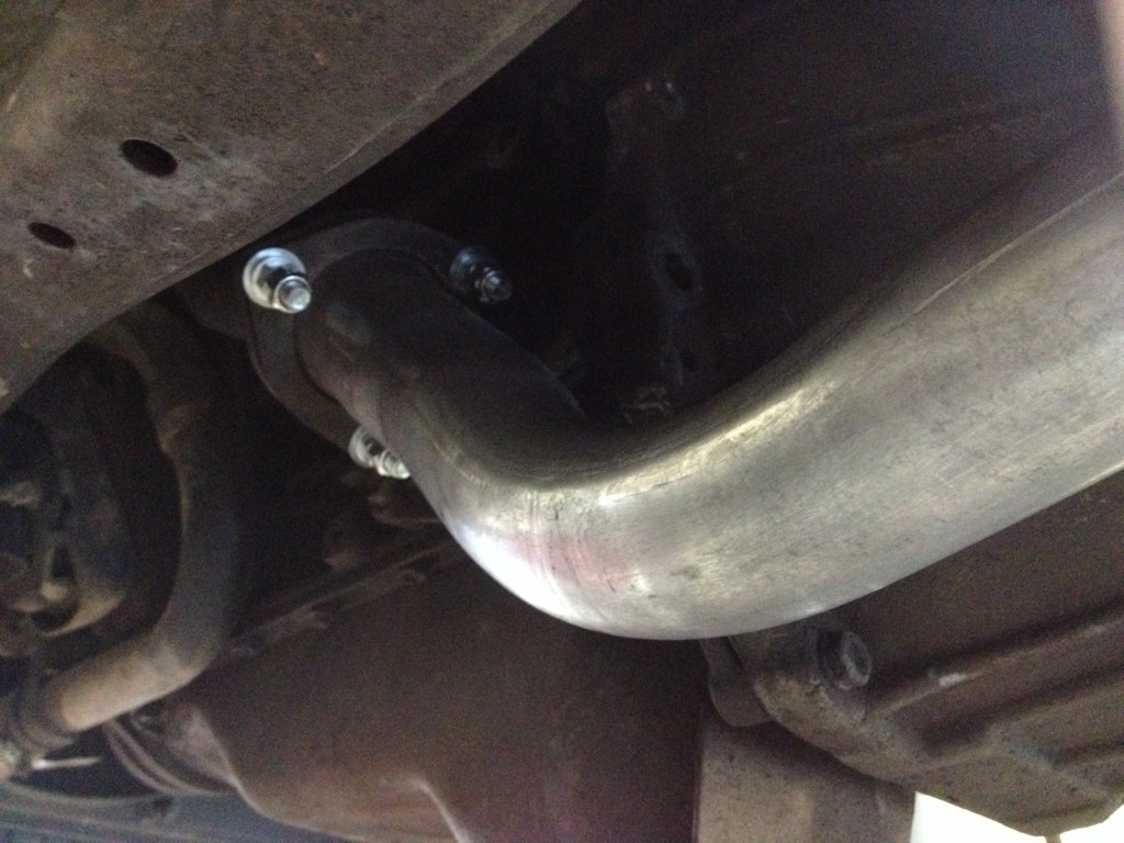

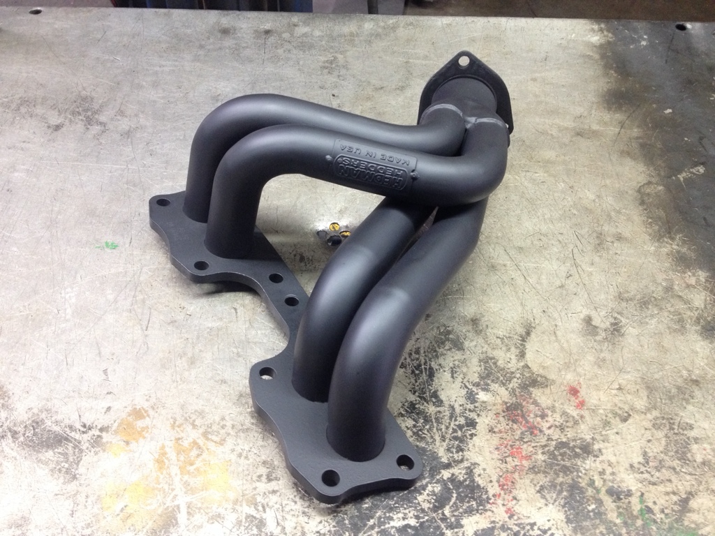

Picked up this hedman header a few months back used for 20$. Coated it with vht hi temp ceramic coating ( already started peeling after 50 miles of use ... So much for there 2000 degree & flame proof claim ) .

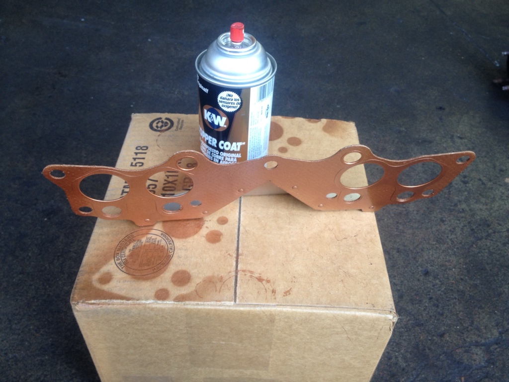

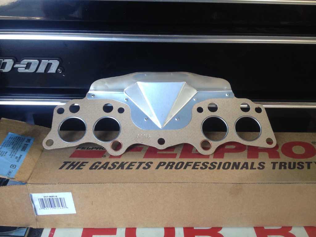

No patience so I bought a cheap fel pro mani gasket , but I did copper coat to try and make it last a tad longer

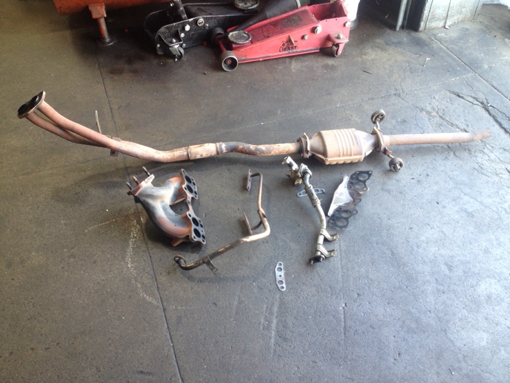

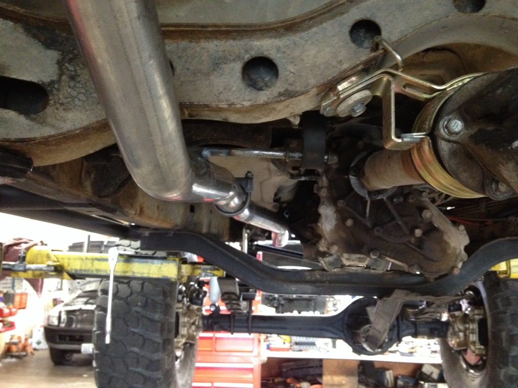

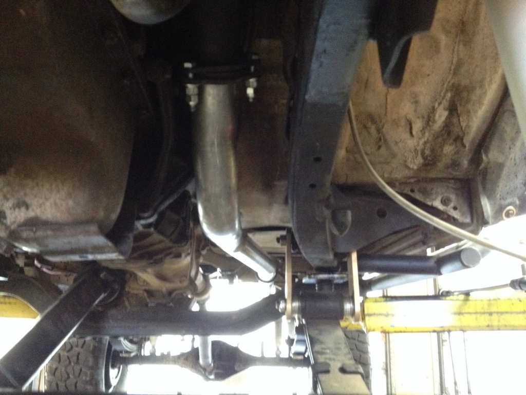

Had pretty much everything I needed laying around to run a new exhaust system . A buddy had 2 sticks of 2.25" pipe leftover from his buggy exhaust , I've had the header , my pops had a used magnaflow and a old banks tip and a assortment of hangers and hardware since my pops does exhaust @ his shop. So last Saturday I spent a few hours at his shop and we bent up a new system.
Ran it nice & high above frame incase I ever flat belly it. Also made the system a 2 peice with it tacked & clamped in the middle for easy removal.

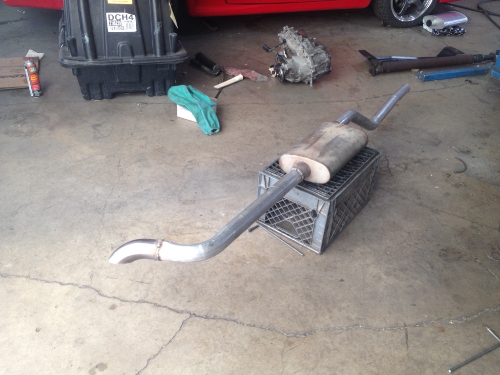

Rear section all bent & welded up

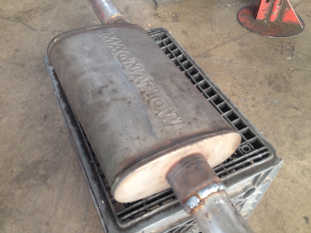

Used magnaflow

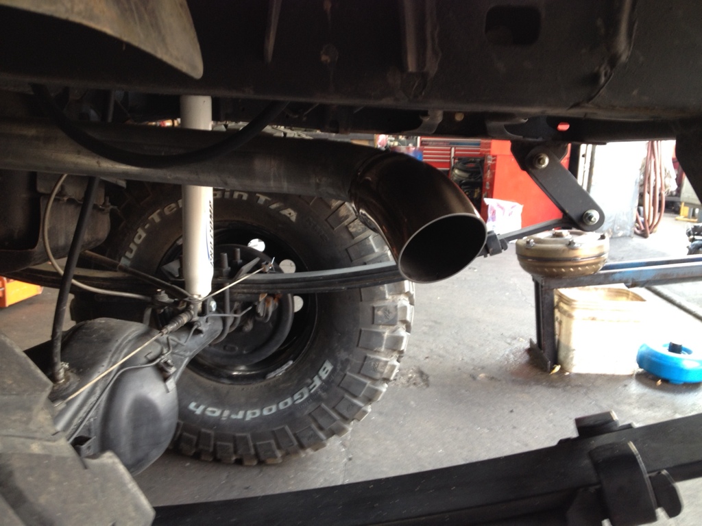

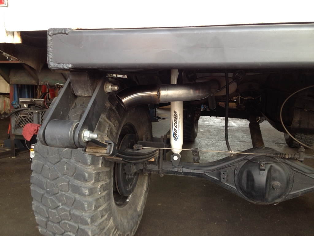

Rear shot all hung up nice & high. Kicked the tip out between frame & leaf spring for protection.

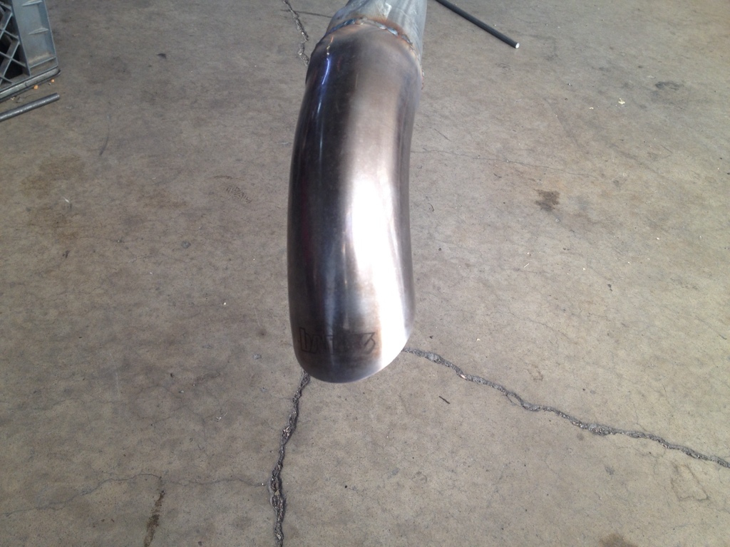

After a day or so I didn't like the turndown tip , so I cut it into more of a slant .

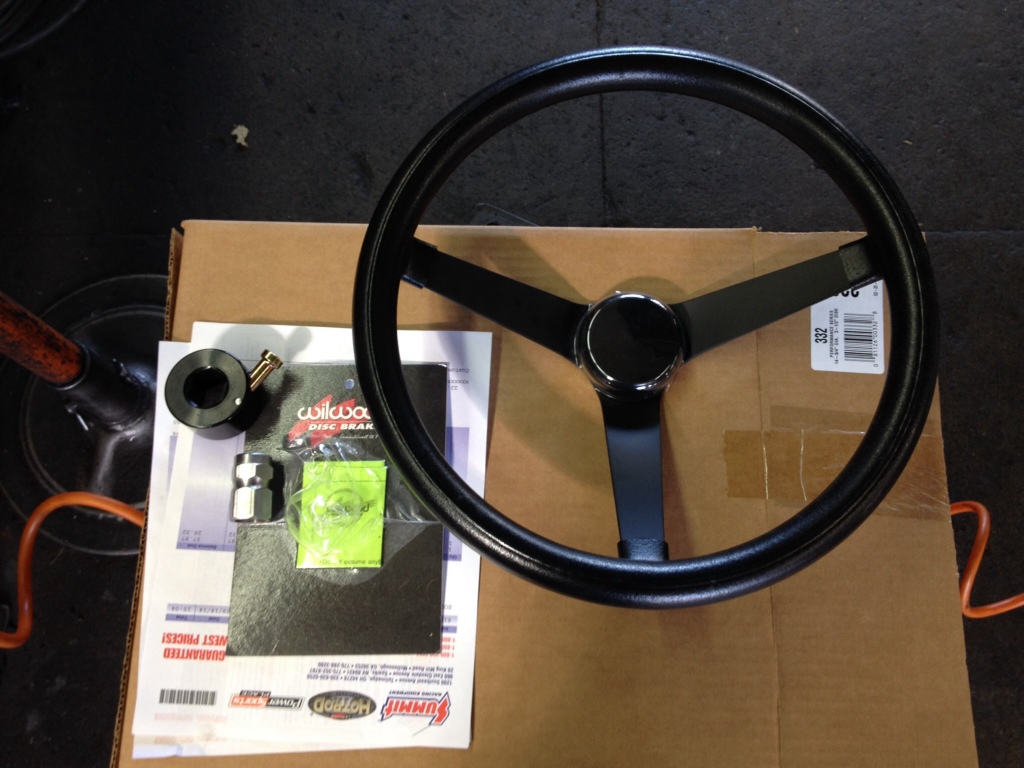

Was at summit racing the other day and had some credit so I randomly bought a wilwood weld on quick release hub & Winston cup style grant steering wheel. Kinda mocked it up real quick on the truck and just didn't really like it. May just return them.

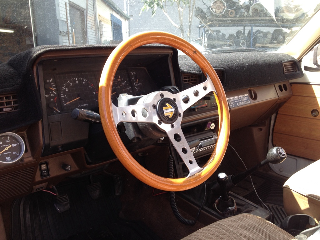

Ended up just putting my old wood grain momo on since I already had it & the hub to fit it. Much better than the giant 15.25" stock wheel. A little more twitchy with the 13" momo though. May add a steering stabilizer down the road.

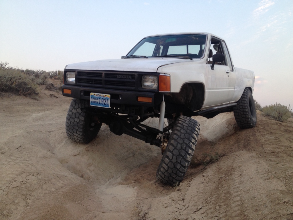

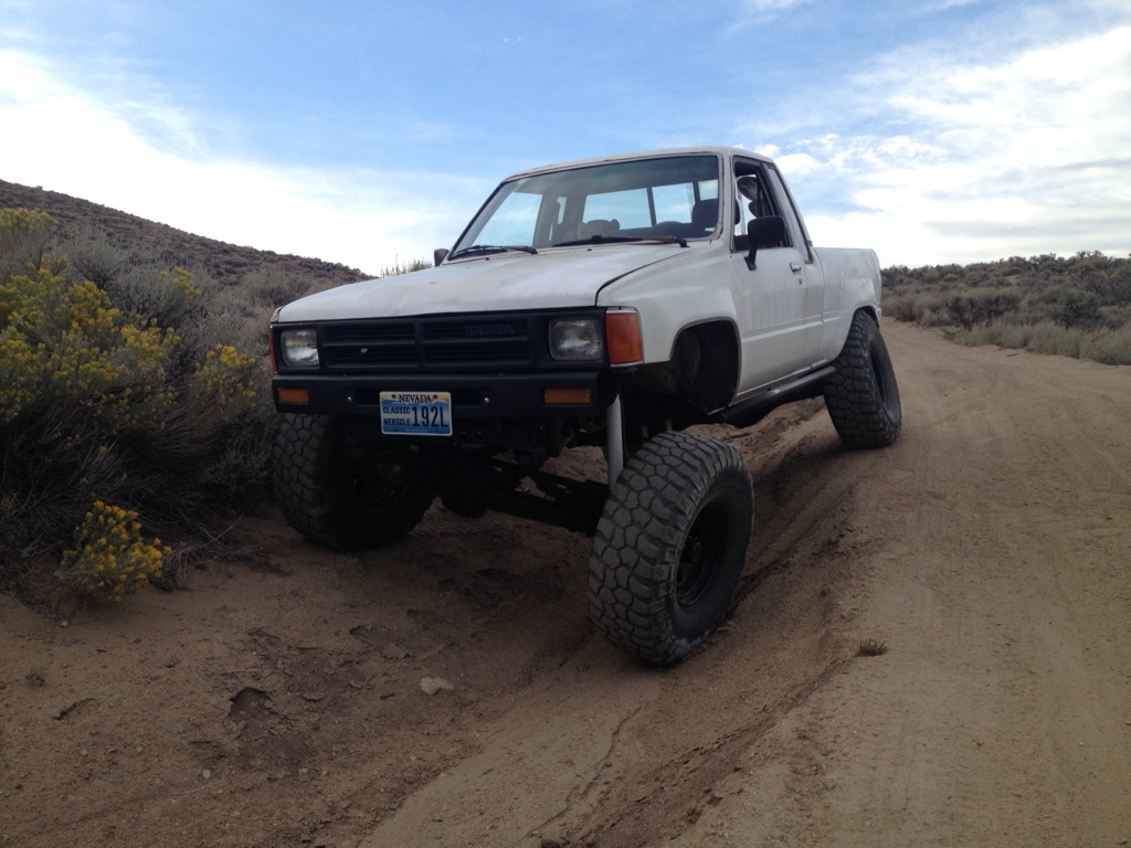

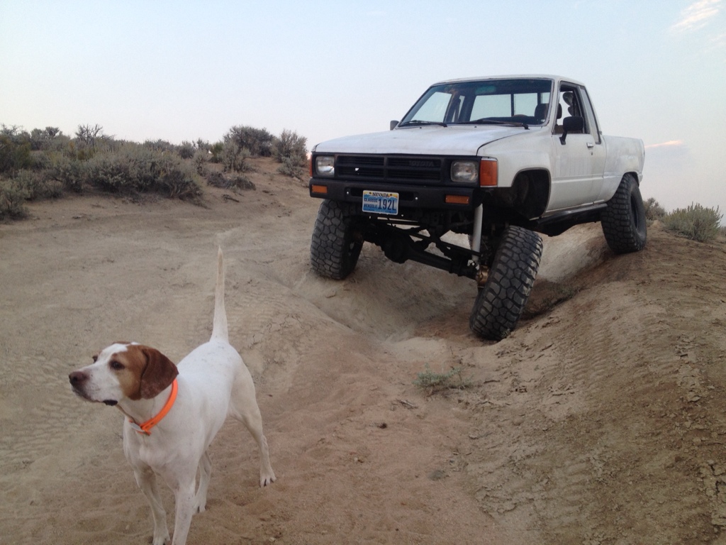

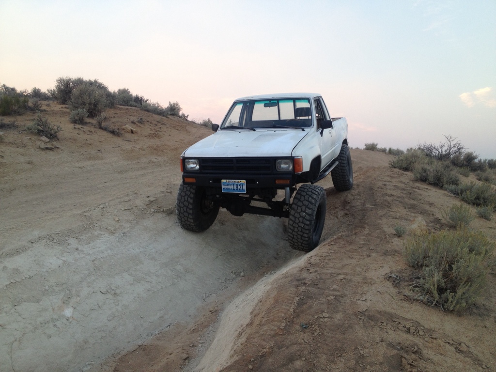

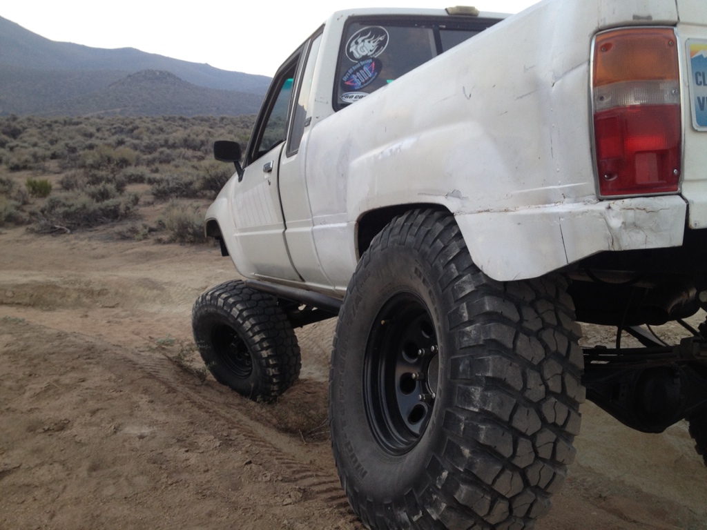

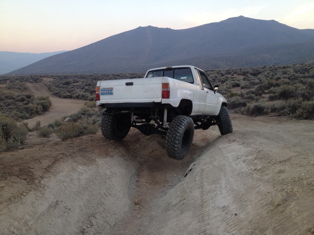

Took my pointer out for a run ( hunting season is around the corner ) played in a little ravine for a minute.

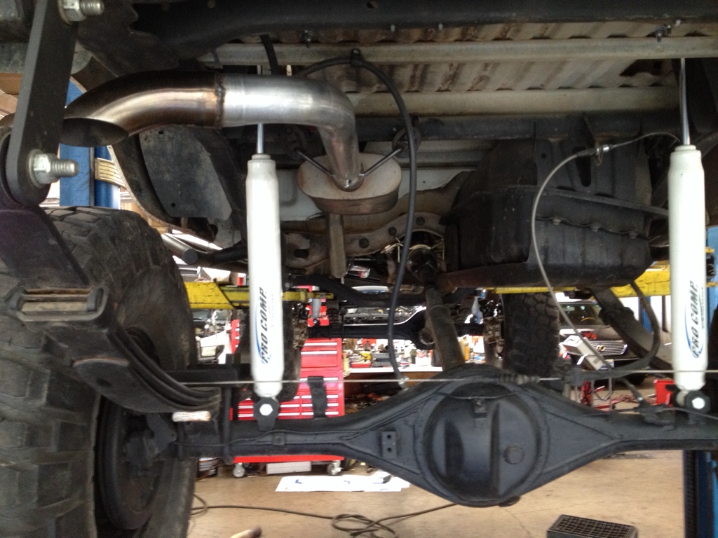

Really like how my rancho 44044s work up front. Still got 1" or more of shock left in the pic and spring would be flat without going negative if I bottomed it.
Bummed about the amount of droop on the rear chevy 63s. They uptravel fine. I still got about 1.5" to go before shock is bottomed in pic and the leaf isn't close to flat , but gotta work on getting some more droop .
Dog was happy

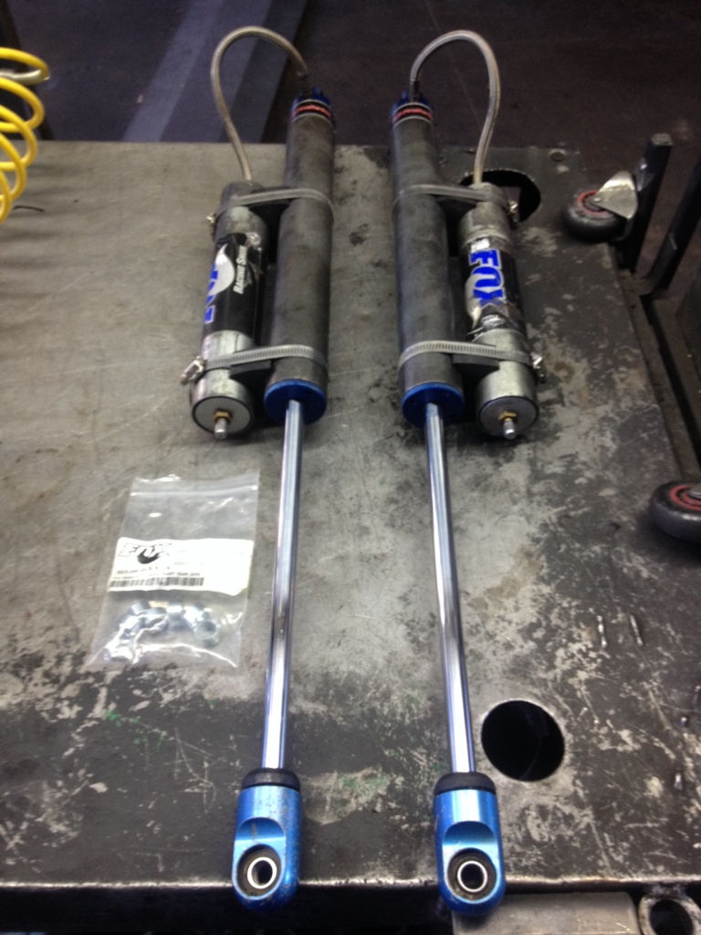

Did a little trading with a local race shop. Came out of the deal with some fox 2.0 pro series emulsion shocks & spacers. Although not shiny & new , the shop fully rebuilt them for me both shock & reservoir . I'm thinking id see the best improvement up front where most of the weight is. Gonna clean them up some and play around with mounting the reservoir hopefully this weekend.

^^^X2, those are sick! Looks like you'll get plenty of travel out of those!
