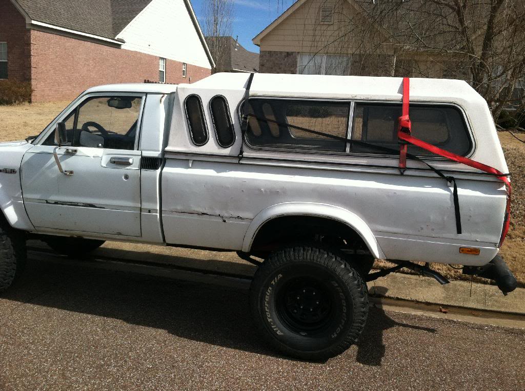

I've got the camper top if you want it before the city gets it off the street
Old Feb 15, 2014 | 03:27 PM
  #477
83Toyota88's Avatar
Joined: Apr 2011
Posts: 1,220
From: Memphis, TN
How many windows are missing? Looks like the back one is missing?
Old Feb 15, 2014 | 03:35 PM
  #478
83Toyota88's Avatar
Joined: Apr 2011
Posts: 1,220
From: Memphis, TN
What's the address? I could come pick it up tomorrow morning?
Old Feb 16, 2014 | 12:45 PM
  #479
83Toyota88's Avatar
Joined: Apr 2011
Posts: 1,220
From: Memphis, TN
Here is a picture of the topper I picked up today.
Not in to bad of shape. Missing the back window and a side window but I can handle that.

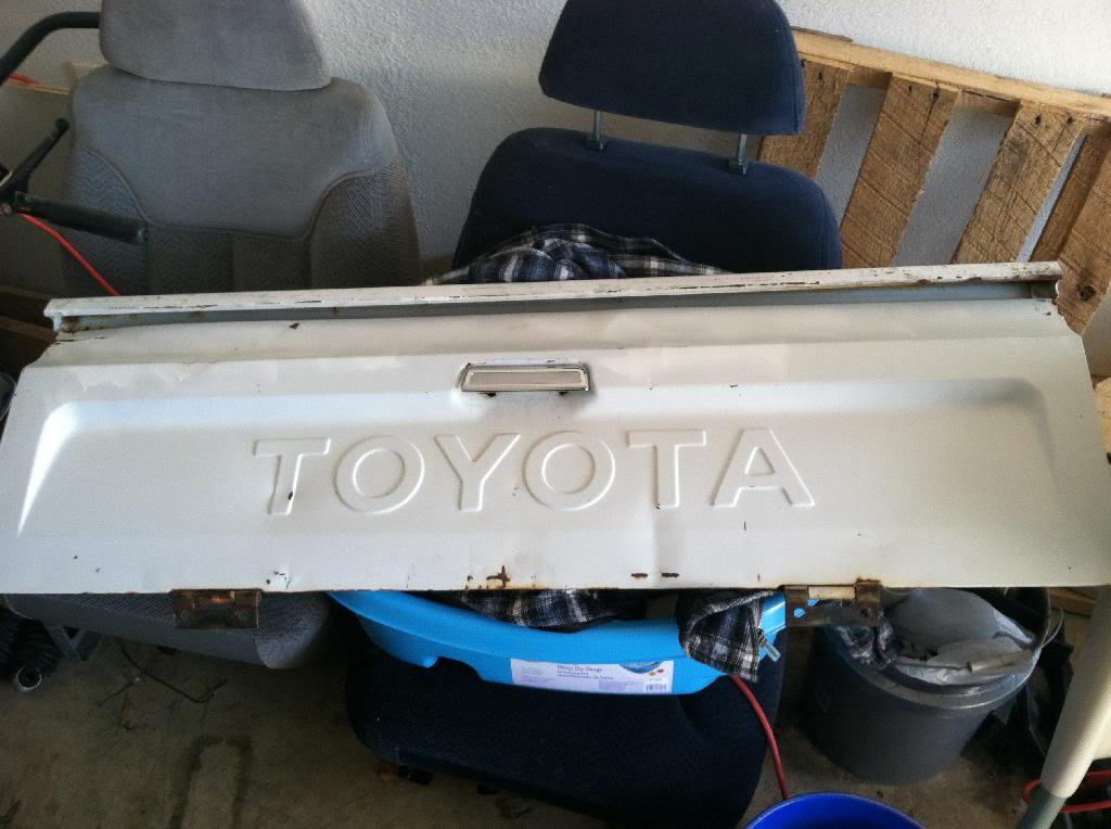

Also got me a new tail gate today. Much better shape than what I have now.

Old Feb 17, 2014 | 02:59 AM
  #480
midtnyota's Avatar
Joined: Oct 2012
Posts: 34
From: Tullahoma,TN
I like the camper top. looks good on the truck. I have one for my truck too but its 6" too short lol gonna have to figure out a way to make it longer.
