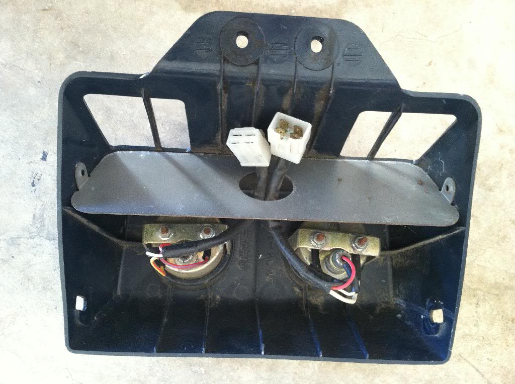

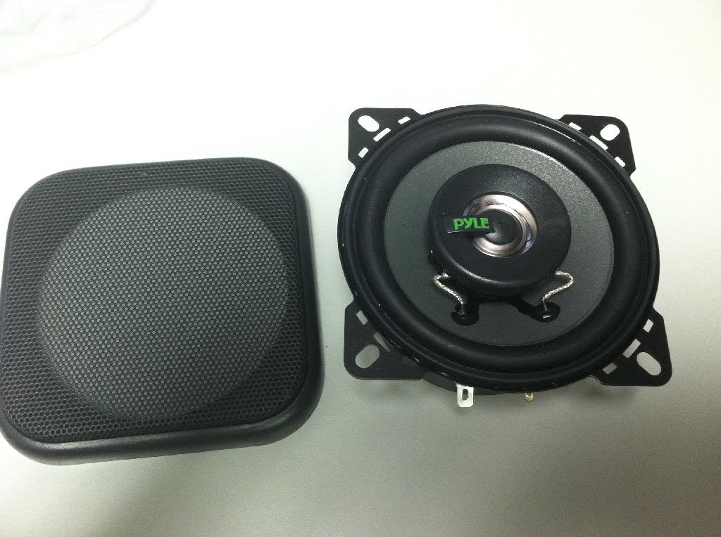

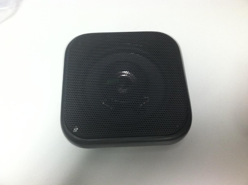

Installed my the new door speakers today. They sound good, I ended up using the stock speaker covers for now. I couldn't figure out how to use the new covers with these weird clips they came with and after I finished putting them on, I realized how I was supposed to do it. Problem is they use screws and factory covers use bolts to mount the speakers to the door panel. The speakers don't actually screw into the door frame itself. So I'm going to go buy some bolts to replace the screws with and put the new covers on hopefully tomorrow. If anyone is interested in the stock speaker covers PM me or they are gonna end up on eBay.
I also have this if anyone is interested. I'm not going to use it. PM me if interested or its going on eBay too.

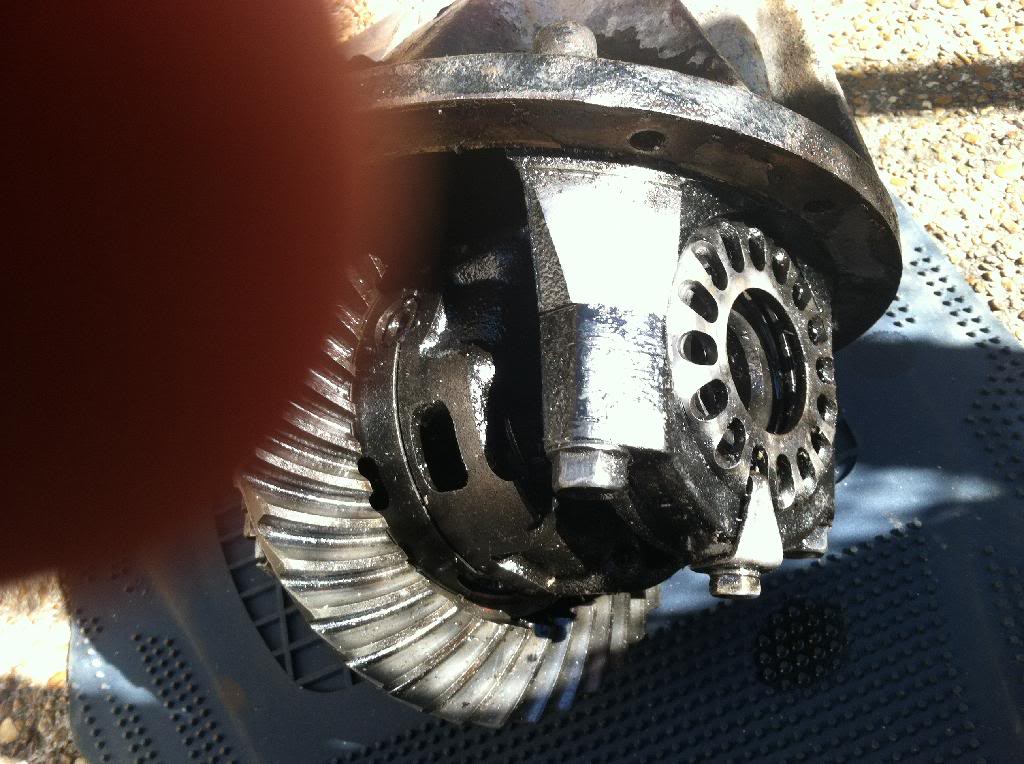

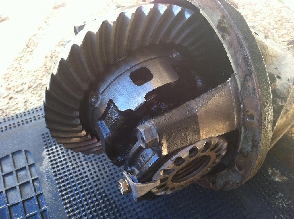

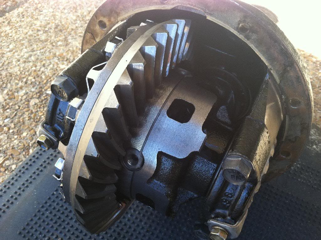

Also cleaned the new 3rd member with brake cleaner today. Looks pretty good to me.

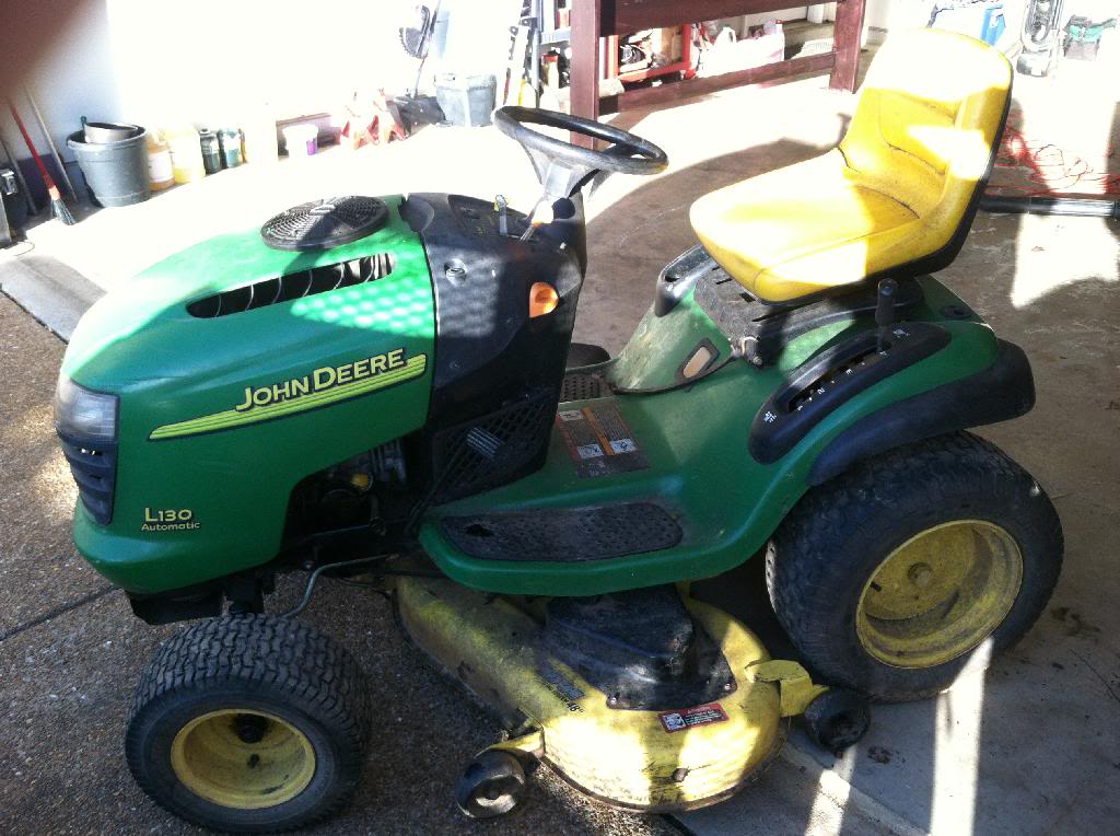

This is my side project right now.
This was also my grandfathers, same as my truck. I bought a tune up kit and did all of that today. Got a few cut wires to figure where they go and needs a new battery and a serious bath. Probably gonna put some sea foam in it.

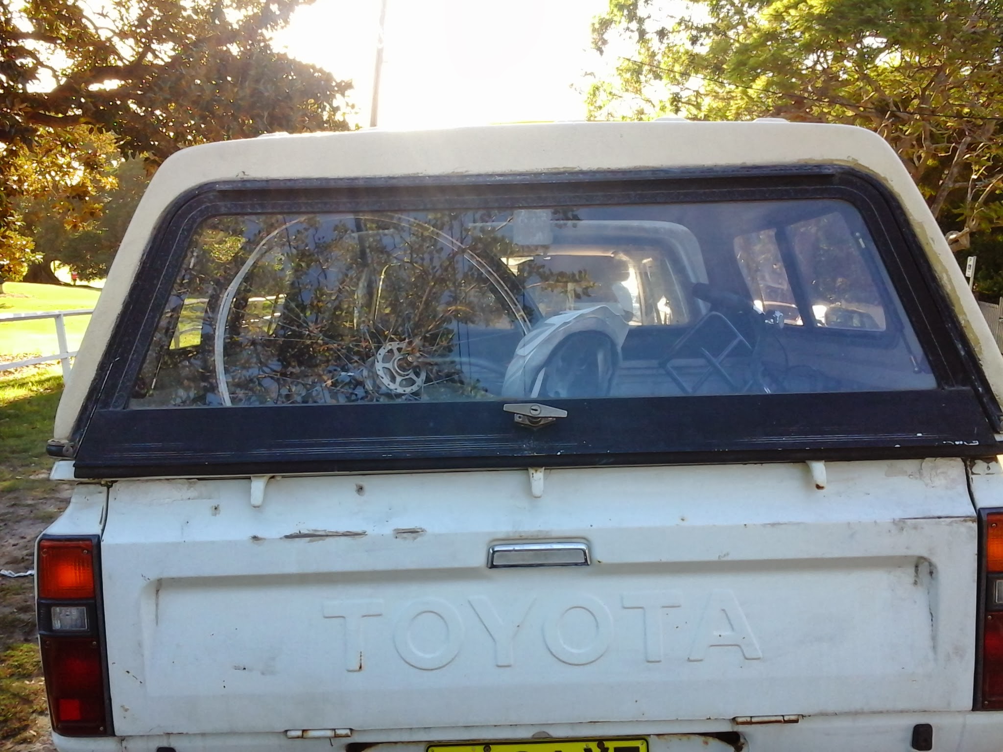

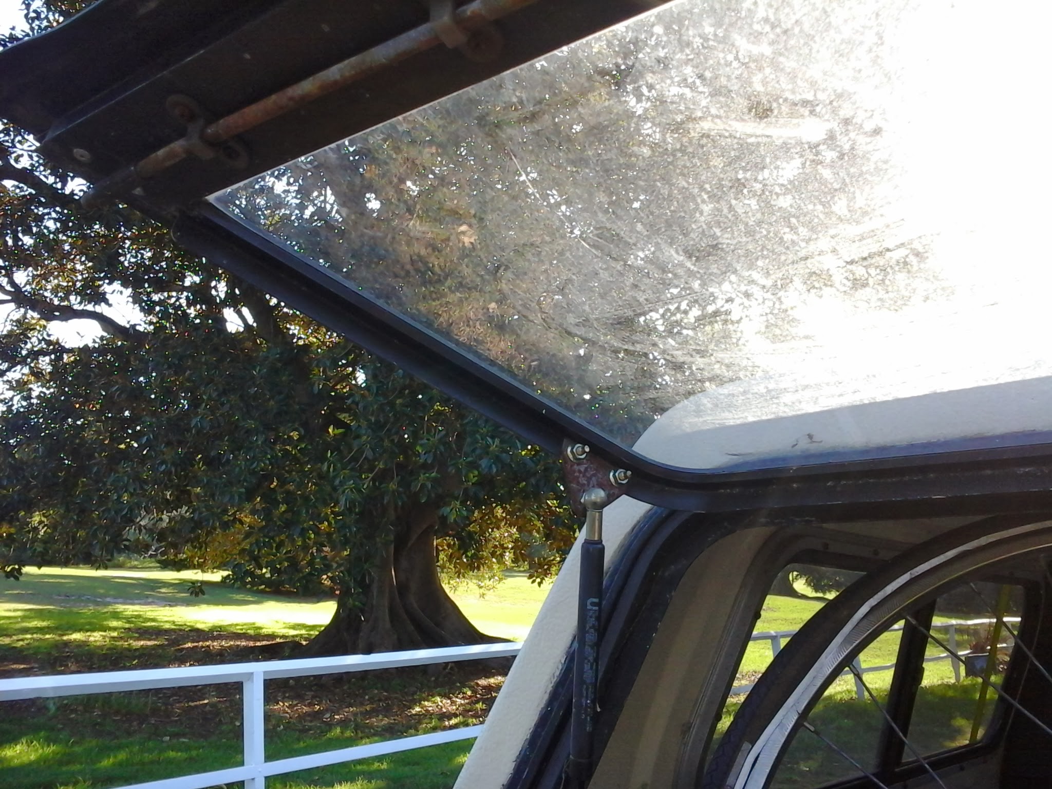

I will get around to a build thread but in the meanwhile here is 2 photos of the back window of my canopy.
Attached Thumbnails 83Toyota88's 1983 Pickup Build-Up Thread-20140224_180822.jpg   83Toyota88's 1983 Pickup Build-Up Thread-20140224_180836.jpg
Old Feb 26, 2014 | 07:12 PM
  #494
83Toyota88's Avatar
Joined: Apr 2011
Posts: 1,220
From: Memphis, TN
That back window will be hard to replace . I'm missing the whole piece. Thanks for the pictures.

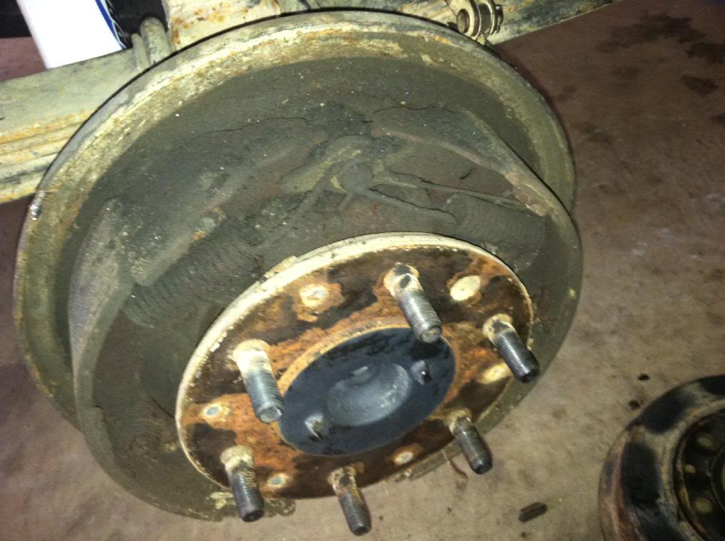

Dug into rear brakes today to get ready to do the gear swap. Looks like my parking brake might have been dragging a little. I measured the inside thickness of the drum and it's fine so I don't have to buy new ones. Now I have to figure out how to slide the axle shafts out to be able to pull the chunk out. Name:  910496AE-9961-4C3D-B70D-4A96ADAE0970_zps9gjvzl1a.jpg
Axle shafts slide out really easily. There are 4 bolts on axle housing (right behind the drum back plate) that attaches the bearing cup to the axle housing. Unbolt those bolts and the axle shaft will slide right out with a good tug. Be careful not to loose the o-ring that goes between the bearing cup and axle housing - you'll see it.
Old Mar 10, 2014 | 12:02 PM
  #498
83Toyota88's Avatar
Joined: Apr 2011
Posts: 1,220
From: Memphis, TN
Thanks for the tip on the o-ring. If my kids cooperate tonight I may try and do it today. The only other problem I see is supposedly the flange on the new 3rd member has bigger holes and bolts so I was thinking about drilling a second set of holes on the flange on the new 3rd to match the size of the existing bolts. Thinking about trying to remove that leaf in my rear springs too while the wheels are off.
