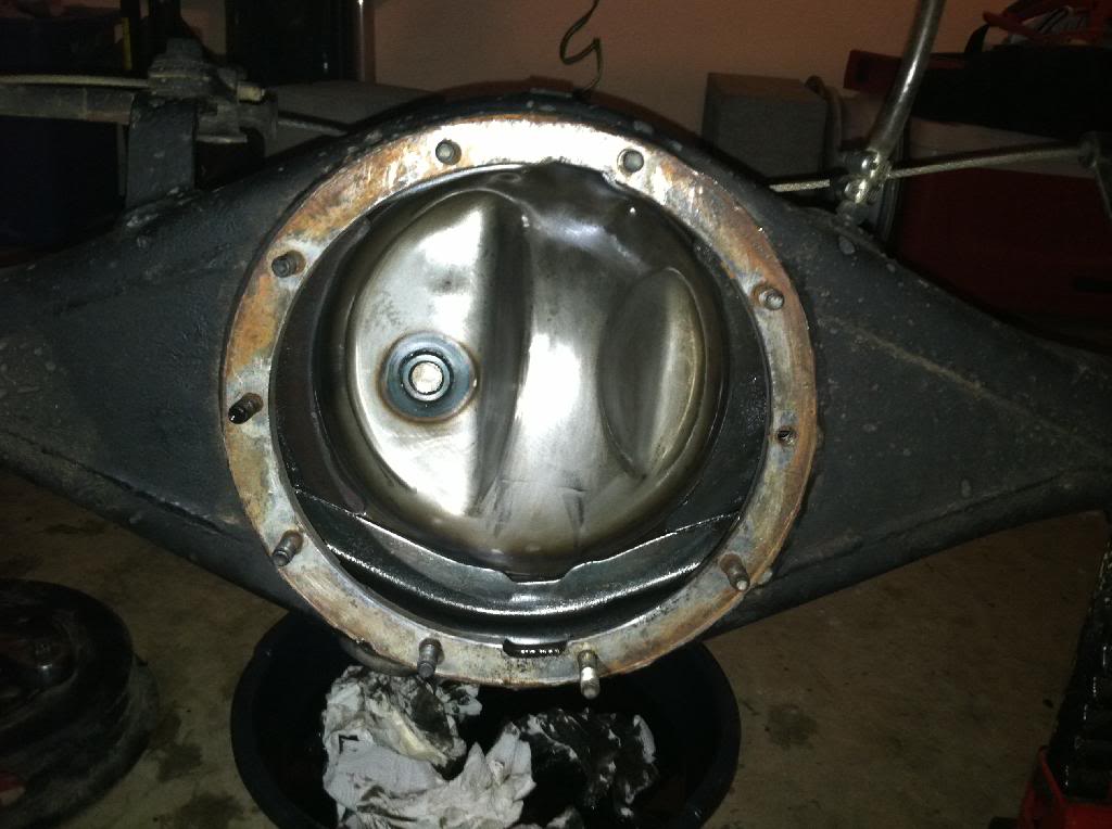

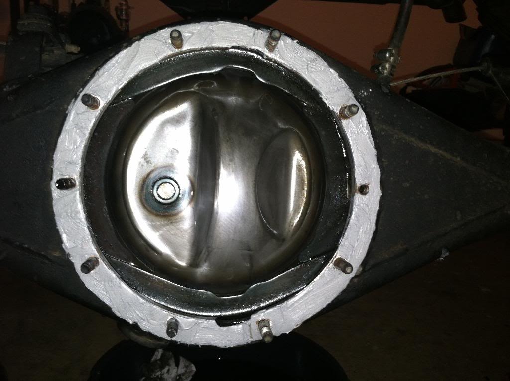

This is what I use my seals around gear oil:
http://www.permatex.com/products-2/p...t-maker-detail
Also here is some pictures
gasket scraped off:
rtv on:

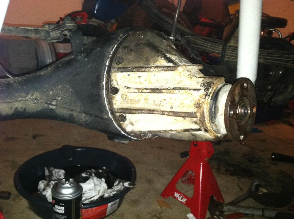

and new (to me) 3rd member:
Now I have a curious question. If I spin either of the wheels the flange on the 3rd doesn't move. But If I spin the flange the wheel turn. A friend says it is a posi-lok 3rd. How does this thing operate??

Ok not a posi because that has to have a cable to engage it. When I spin the yoke both wheels spin forward. When I spin the left wheel forward the right wheel spins backwards. Yoke doesn't move.
Old Mar 11, 2014 | 04:51 AM
  #504
kawazx636's Avatar
iTrader: (3)
Joined: Jan 2012
Posts: 3,218
Likes: 26
From: Salisbury, MD
That's typical of an Open/Standard carrier differential. If you have both wheels off the ground and turn one, the other will turn the opposite direction and the pinion will remain still. But if you turn a wheel while holding the other still or turning it in the same direction, you'll see the pinion move.

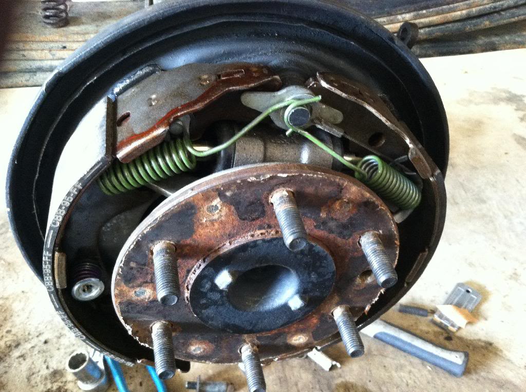

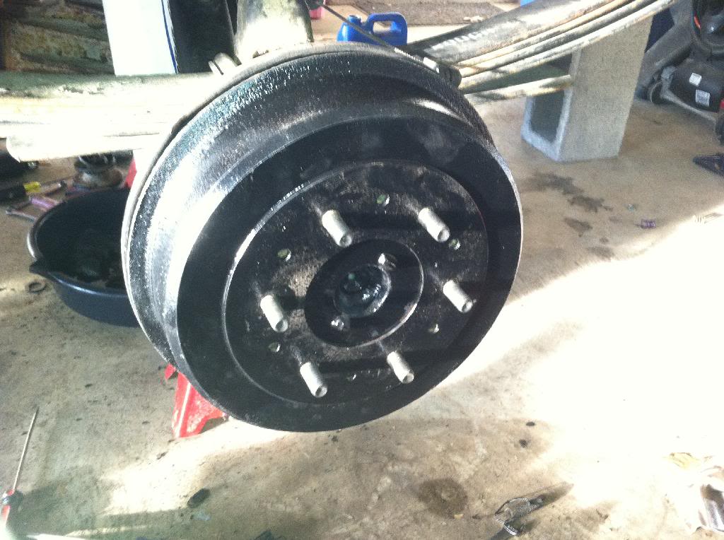

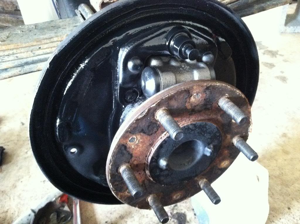

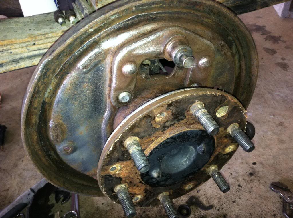

Made some progress on the drums today. Started with the drivers side and got it all torn down. Took a small wire wheel on a drill to the back plate and then hit it with the rust paint.

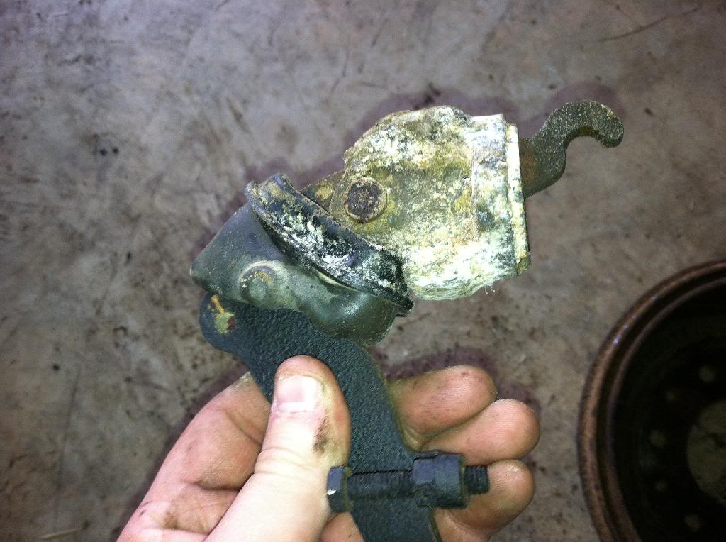

The parking brake lever was pretty much stuck in place unless I put a lot of force on it. I'm wondering if the parking brake was dragging on this side. I got it freed up and put back on.

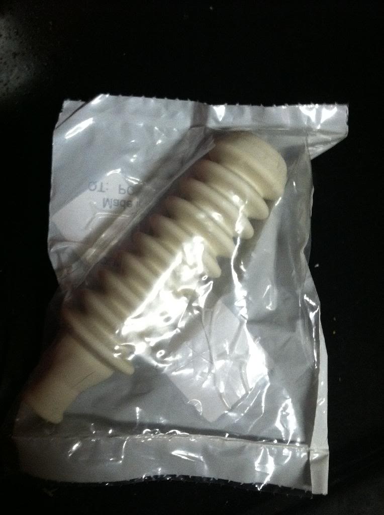

Here is the new shoes and a new brake hardware kit.
I shot the drum with some gloss black paint.
Decided to go ahead and swap flanges on the 3rds. Figured it was the right thing to do instead of drilling a new set of holes. I already had a new stake nut for it and I went and bought a new seal. Drive shaft is back on too and it was a PITA! I ran the truck while the back is still on jacks and I didn't hear any bad noises coming from the 3rd or notice any leaks.

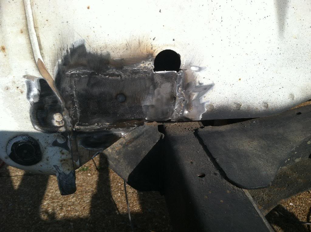

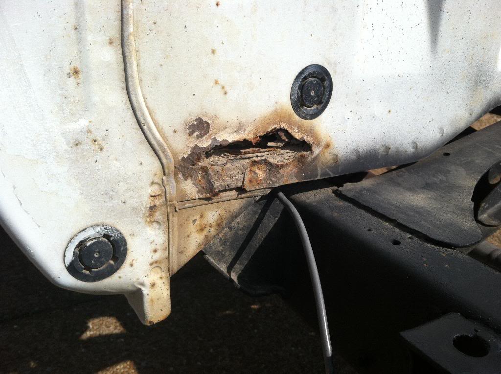

I finally worked on the whole in the back of my cab I have been neglecting.
I had some flat metal that was a little thicker than the cab metal I used to try and patch it.
I think it came out pretty good. Getting better about the arc from the welder being more constant and not flickering so much. Wasn't sure to patch the factory hole or not so I just trimmed the plug and put it back in. Might re-work my cb antenna cable to come out that hole.
I also should be getting my other bed put on this afternoon so I can work on it. I flipped my old bed off yesterday and when I did one of the panels almost broke off around the rust.

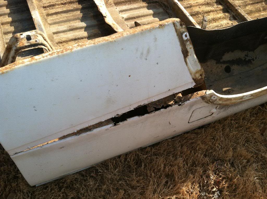

Came to a big realization today. I got my other truck bed swapped on and realized the lower panels were in a lot worse shape than I thought. I simply don't have the skills or tools to do all this major dent repair. My next thought was to swap over the panels off my old truck bed (they had minor rust repair but no dents) onto this new one but I just tried to remove a panel and buggered it up pretty good. I can't figure out how to remove them properly. This just sucks.
Old Apr 1, 2014 | 02:56 PM
  #514
gillesdetrail's Avatar
Joined: Jan 2013
Posts: 803
From: Montreal, qc
I have never seen these beds but are there spotwelds than you can drill out? Maybe take a look at toyotafiberglass' bed panels it might give you an idea where to cut. good luck the truck looks great!
That's the only thing I left to try it looks like. I have talked to Corey about the panel separation and he said they are spot welded. From what J can tell it was done from underneath. They are pretty hard to see with all that bed liner crap on the bottom side from the factory and I can't get a grinder on every single part of the bed under neath. I have looked at some spot weld drillers on Amazon and it looks like I will need a very small drill or right angle drill to try and drill them out straight because the lower lip of the body panel gets in the way of a normal sizes drill.

I think I'm gonna try these products:
http://www.eastwood.com/spotweld-drill-3-8-pro.html
http://www.eastwood.com/90-degree-seam-buster.html
Old Apr 1, 2014 | 03:40 PM

if your removing the skirts from the old bed .. why not cut wider then you need ? cut the whole side off if you can , then you can set it up into a better position , and start removing the sheet metal you don't want , getting the final product , the skirts , you do want .
