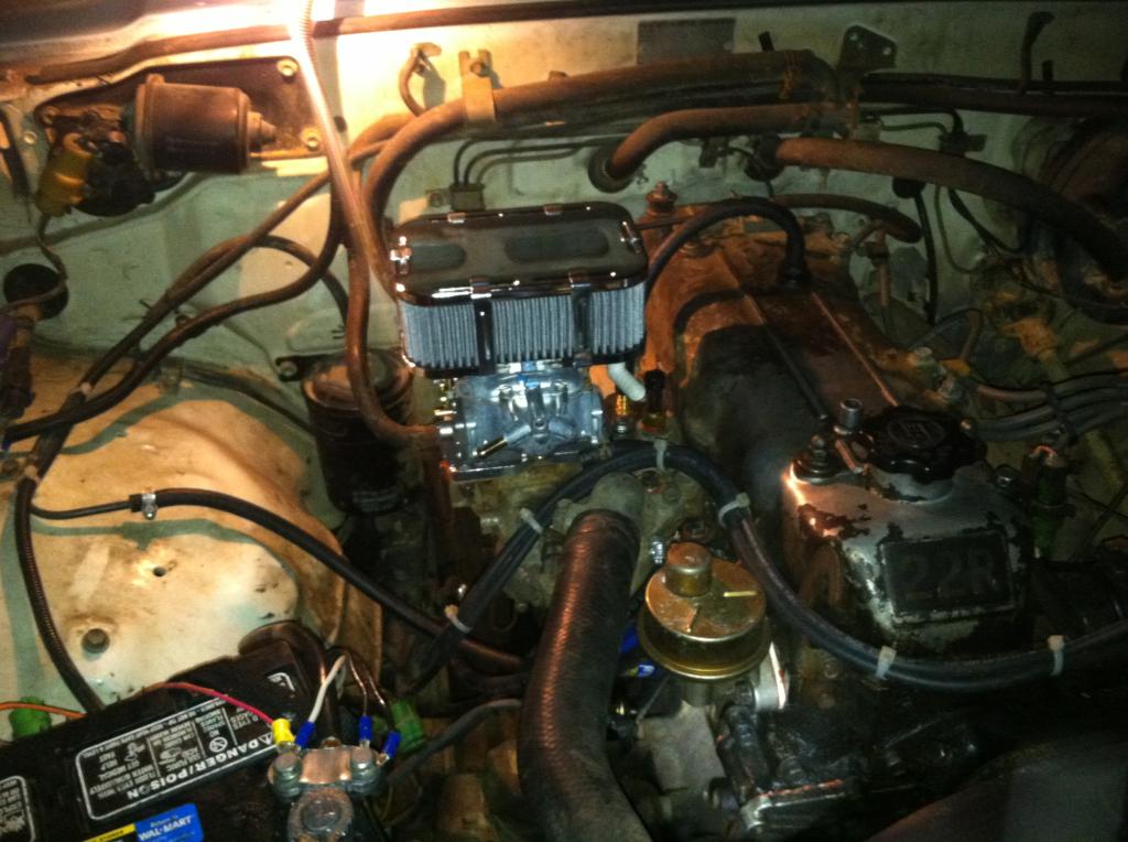

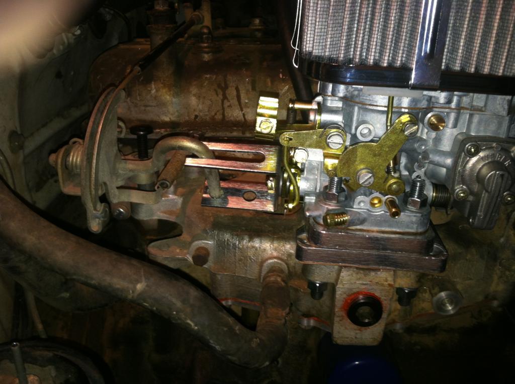

Got the weber in today. Still waiting on the regulator. I have the weber in stalled all but the fuel lines. I need to get two different bolts for the linkage assembly. The kit came with spacers to raise the stock linkage assembly but the bolts it came with are both wrong. One is too long and one is too short. I'm gonna pick those up tomorrow along with fittings for the regulator.

I think so too. I just looked through your de-smog tutorial and I need the barb fitting that goes into intake manifold. Also I noticed I am missing a plug. Where the fitting is for the gas hose to go to the weber it's kinda y-shaped. The bottom has a plug but the other side is missing a plug.
Old Oct 9, 2014 | 06:46 PM
  #548
83Toyota88's Avatar
Joined: Apr 2011
Posts: 1,220
From: Memphis, TN
Ok well I have vacuum leaks everywhere lol. I can drive the truck but if I spray carb cleaner in a few certain spots the idle will change. This biggest leak I have had to deal with is the piece that bolts onto the intake manifold where the tube connects to the rear port on the valve cover. That plate will not seal up properly. Im gonna see about ordering the LCE spiral adapter this weekend and at least fix those leaks. As for the other thing I may take if off when I put the LCE adapter to where I can see it better from all side and seal the piss out of it with some gasket maker/RTV.
I also have a block off plate that I had on there from my de-smog and I wondering If I can take it somewhere and have a hole tapped in it. Its a nice thick piece. Not a cheap, thin piece of brass.

That redline adapter that comes with the weber is known to leak, should fix it with the lce piece no need to rtv the ˟˟˟˟ out of it, just do the right tightening sequence to the right torque with a little threadlock and you'll be good.

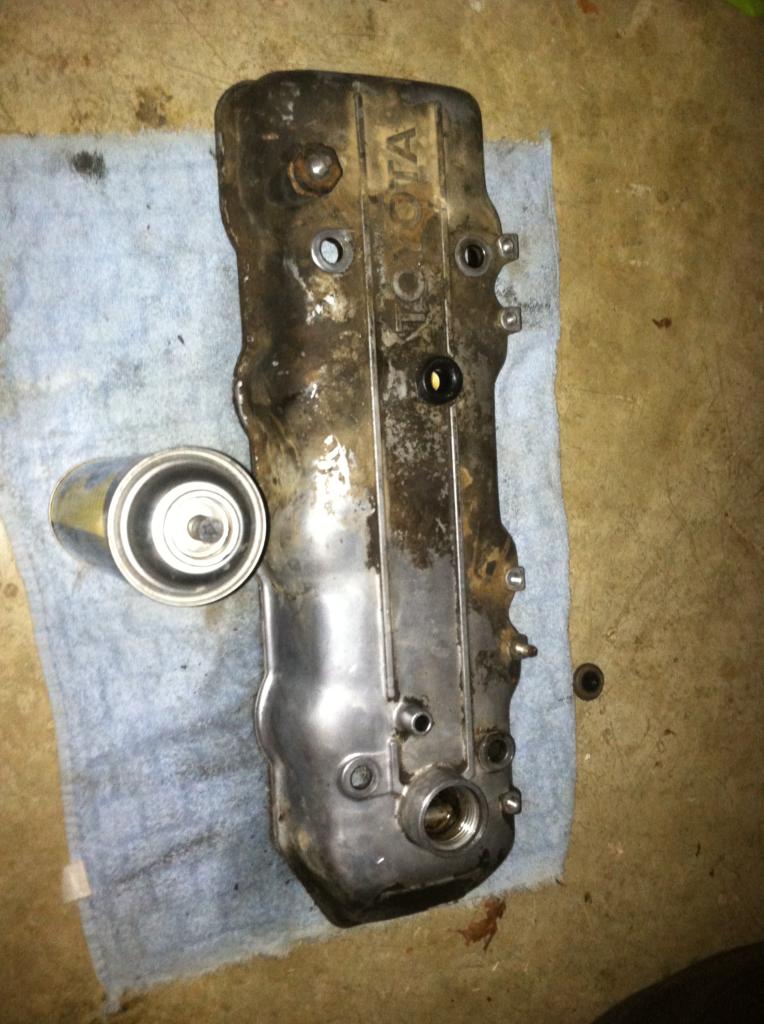

Finally decided to install the choke cable. I'm not gonna attach it to the carb until I order a new adapter and get it installed. Probably gonna go with the Trans-dapt one. I got the longer spacers for the throttle for it yesterday.

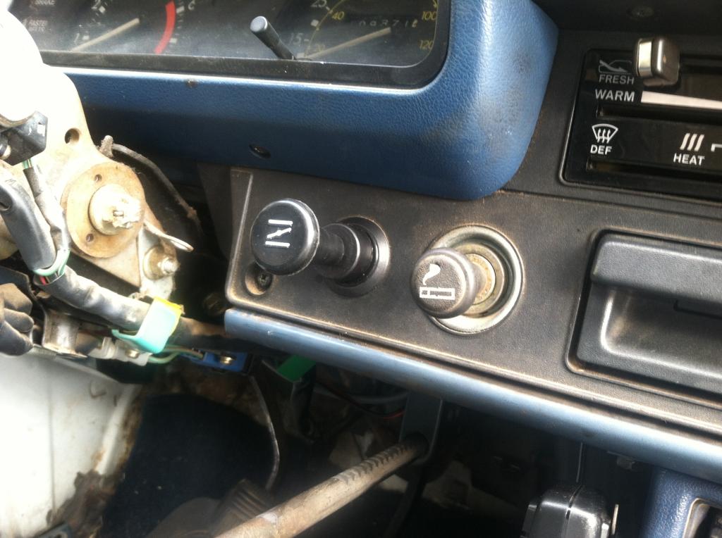

Also finally decided to paint my valve cover.

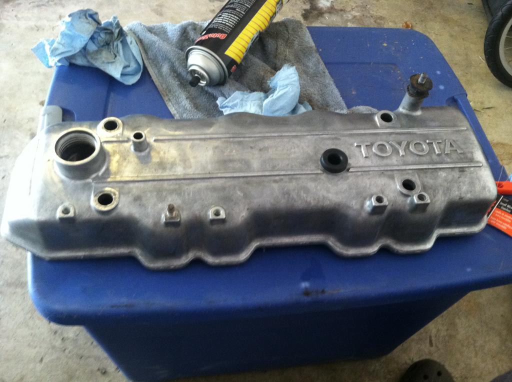

Super dirty before:
All the gunk removed. I really thought about keeping it this way.

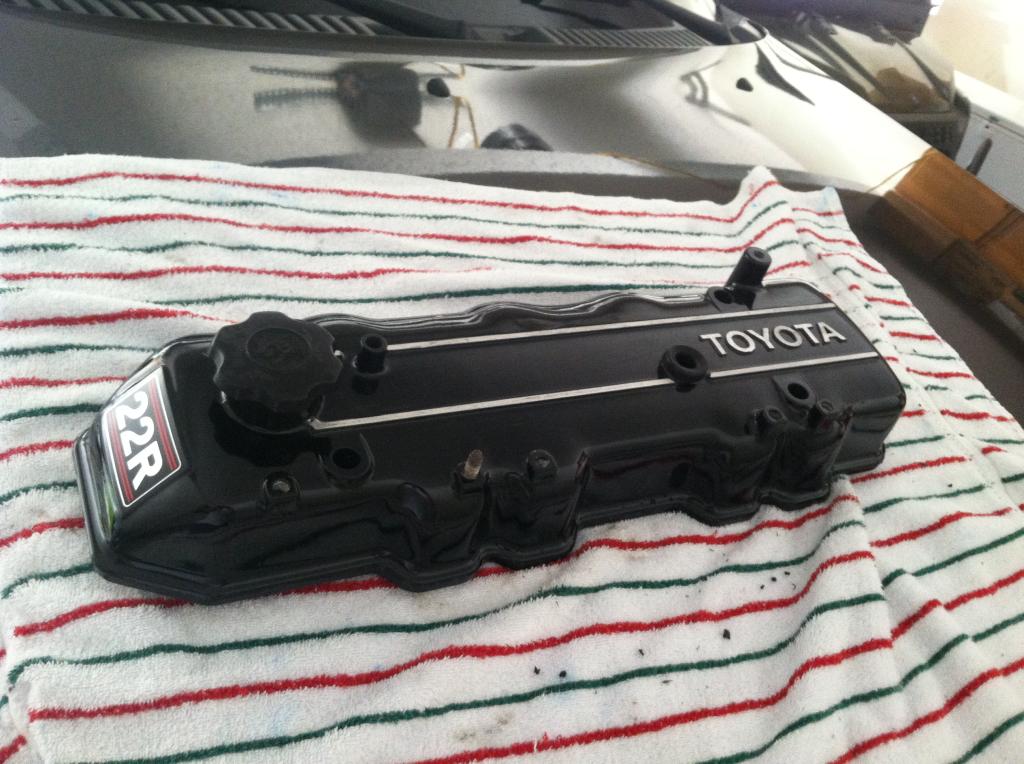

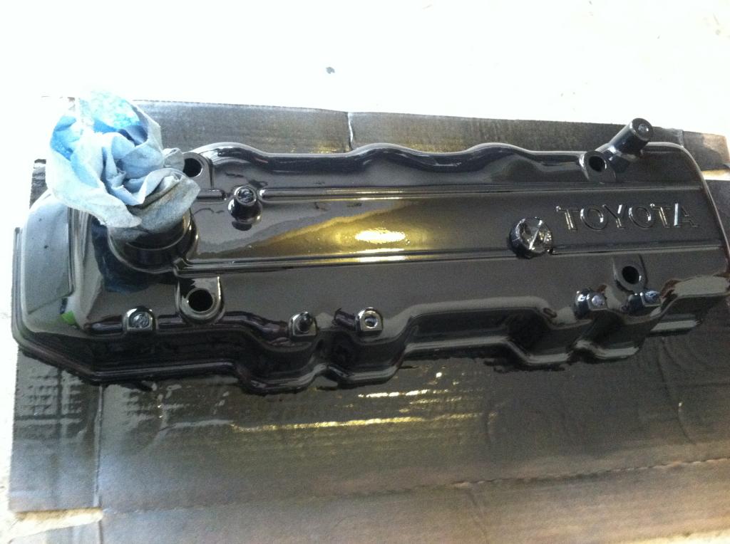

Two coats of black paint later:

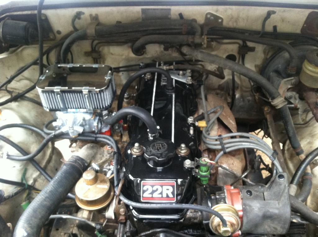

Finishing touches:
Old Oct 12, 2014 | 06:53 PM
  #552
83pingpong's Avatar
Joined: Jan 2012
Posts: 325
From: Kansas City, Missouri
glossy black
I like the black. Nice new 22R decal and exposing the Toyota lettering and lines. Good choice. Still waiting on the part for the vacuum leak?
