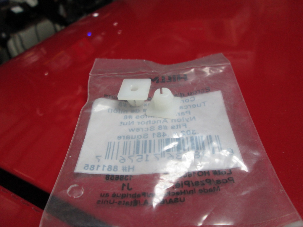

Cool! Lol. ... and, if you want the item# of the expansion nuts, I have it in pb. I even used them to hold up the brake line/splash shield I cut to fit, into an existing hole in the inner fender panel. The fit#8 screws and hold on like a death grip. ... They are the type with the lil lip that expands out once pushed in, then get even tighter as u force a screw through there. U can use shorty screws and never touch the roof..... #8-.50"?

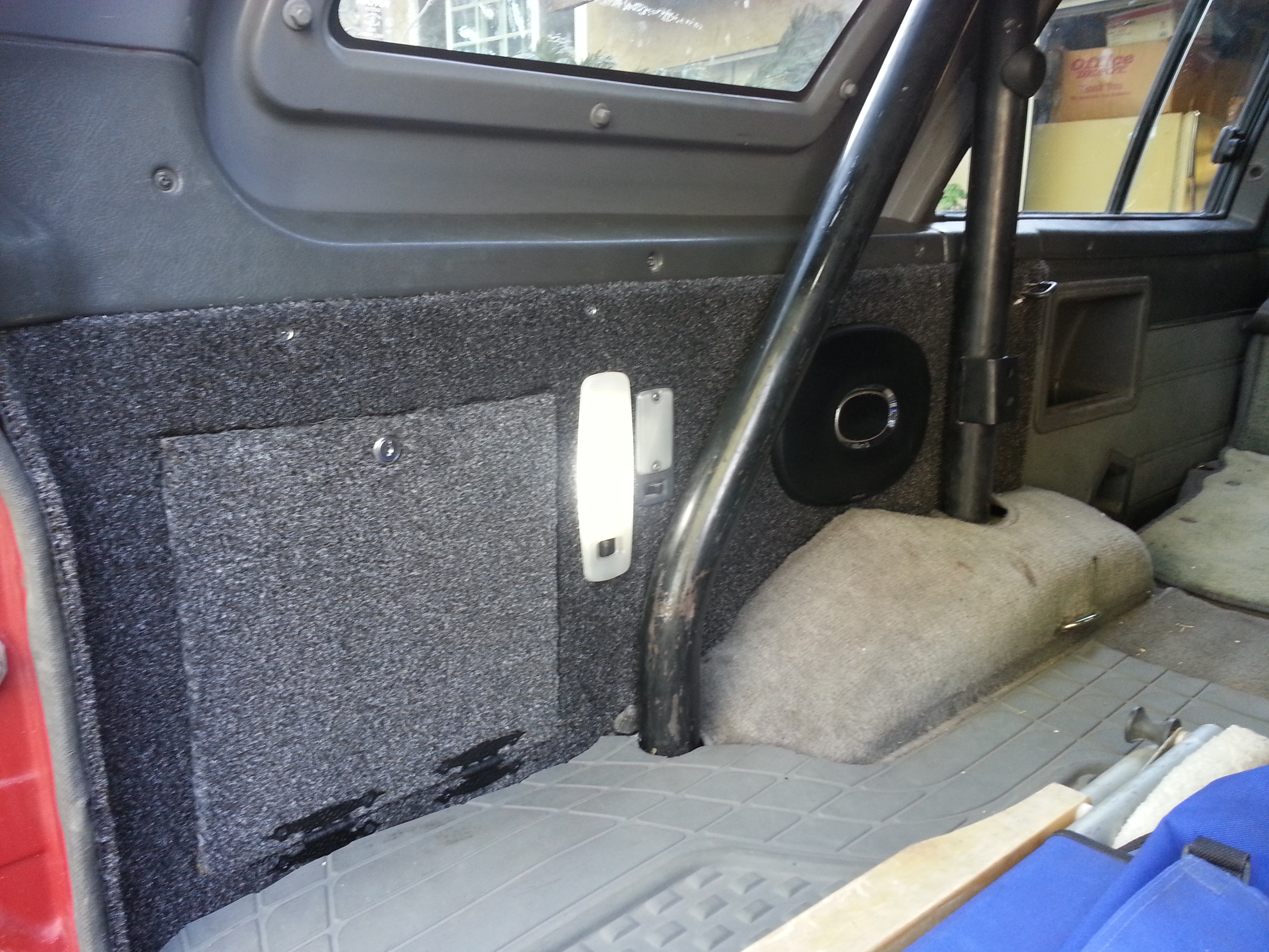

I'm sure u wanna move on, so thats it, lol. Just like this stuff, like my panels with 6x9's, held in by those nuts and take a huge rattling around town and in Tierra Del Sol already......
Those things are shockingly strong and bonus? They will flex a lil and suchn and wont make nouse as they create a cushion.
