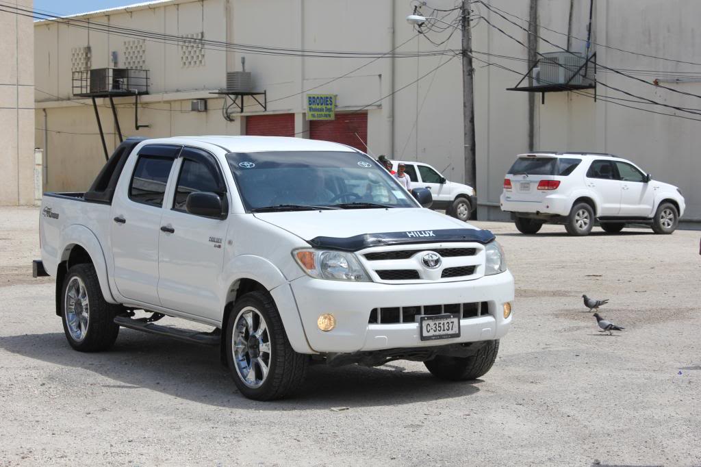

Went on a Caribbien cruise last week! Luckily the ship didn't break down. Went to Costa Maya, Belize, Roatan, and Cozumel. Had a good time but glad to be home. I found a Toyota Hilux in Belize:

Wow, that is just awesome! Thanx for inviting me! hahaa... no really, thanx for sharing, cool pix!

By the way, those Toyota HiLux trucks also come with the Turbo Diesel in those parts. Man, I would be in one tomorrow if they were here.
