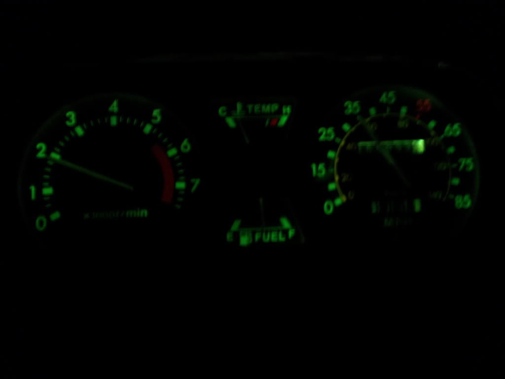

I installed a $30 tack in my gauge cluster today. Only bad part now is it is to tall for the clear cover for gauges to go back on. Might just leave it off.

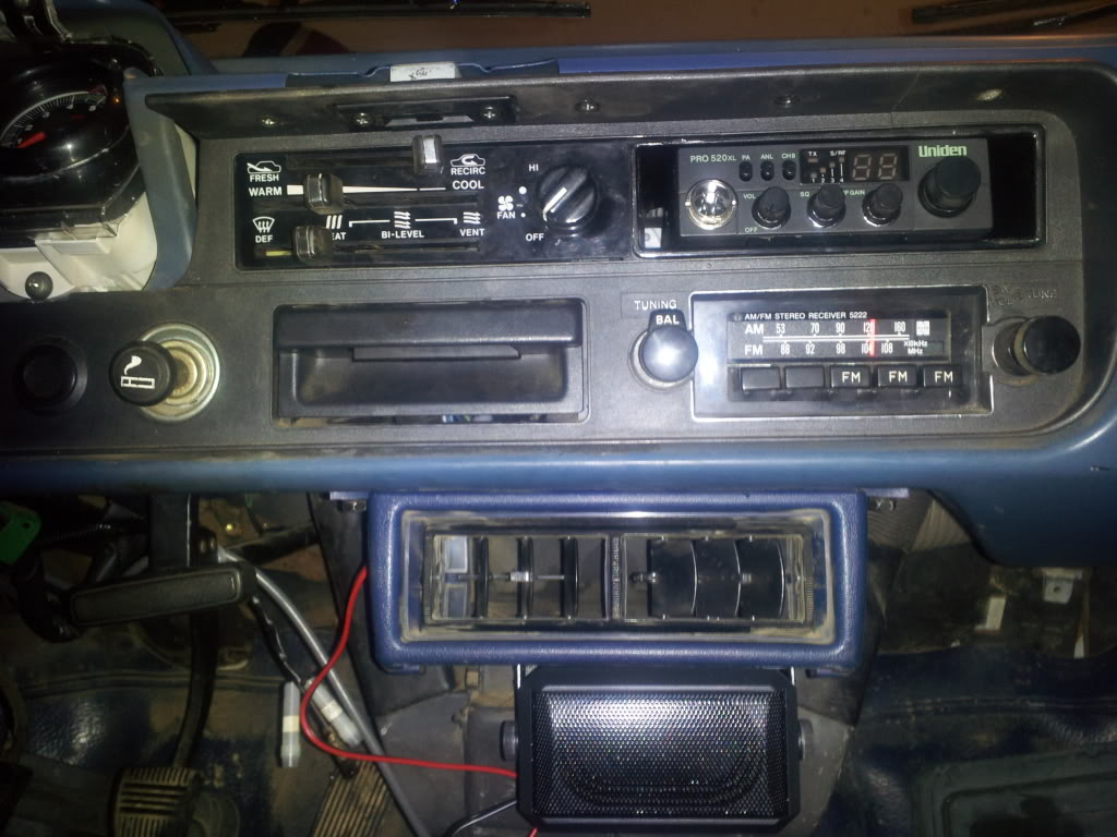

Worked on my truck tonight. I got a new cb radio from my wife for v-day, its a Uniden 520XL, and I installed it in my dash tonight. Added an external speaker for it below the air vent. I think it turned out pretty good. Need to find something to cover up the gaps on the side of the radio. Anyone have any suggestions ? Also my alternator belt got some play in it and started squawking so I tightened it back up.

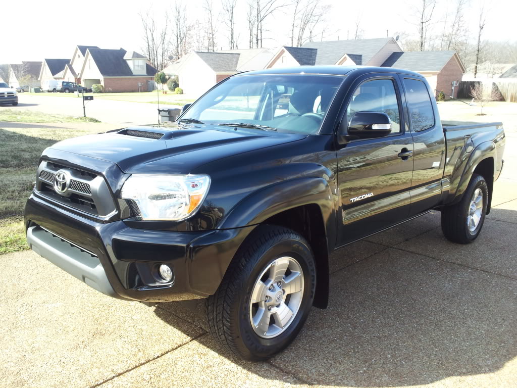

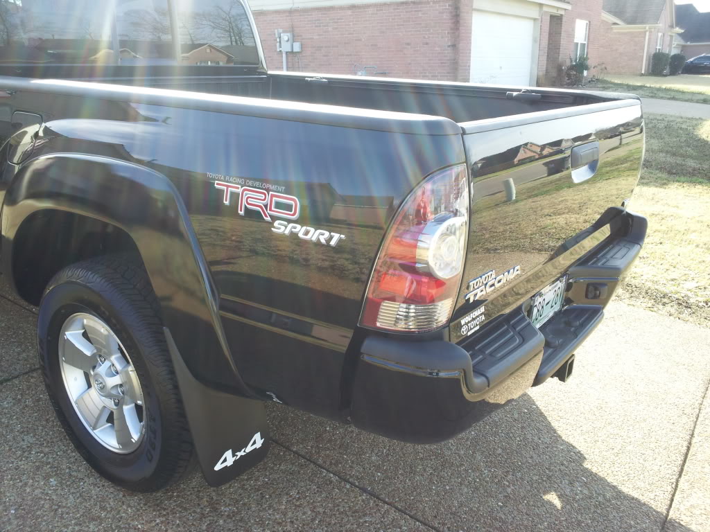

Me and wife bought a new tacoma this weekend! 2013 Tacoma SR5 TRD Sport.

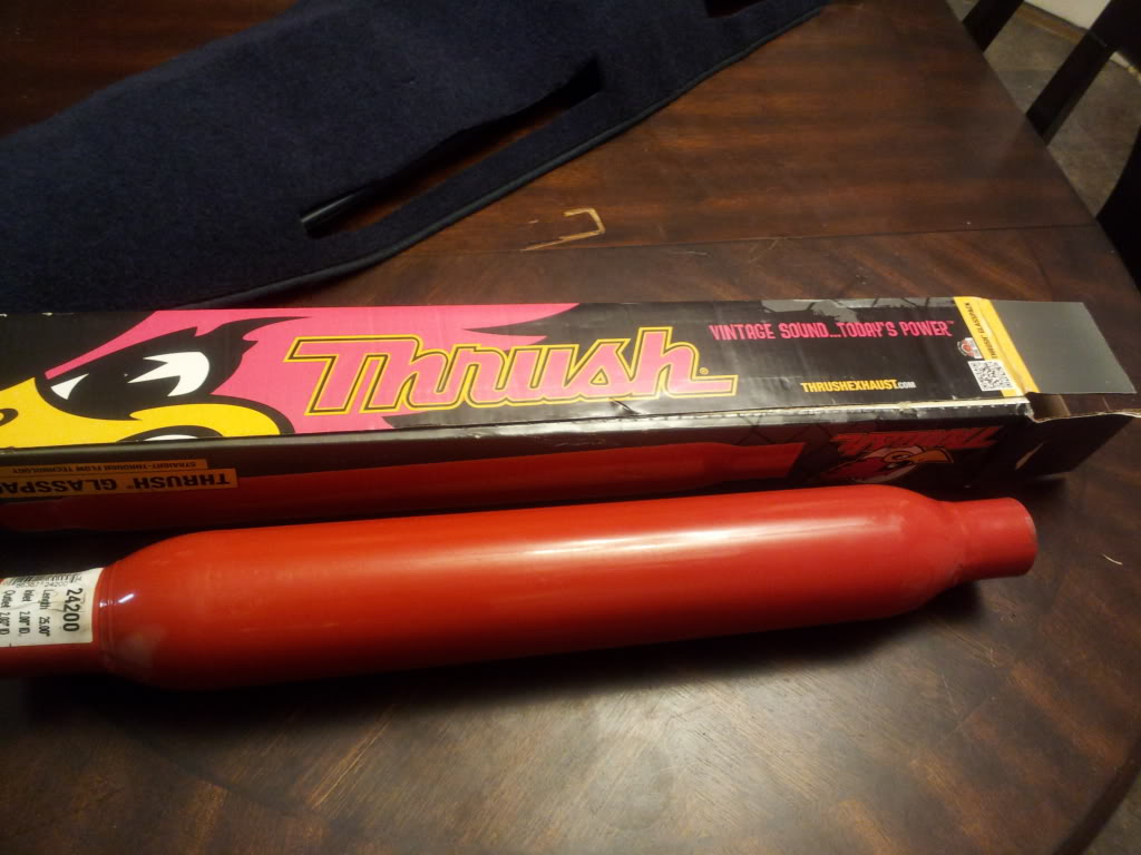

I also welded up a Thrush glasspack on the truck last night. Sounds pretty good so far but only revved it up in my driveway.

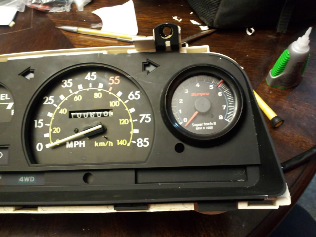

Last night I installed an SR5 cluster too. Love having a stock tachometer.

I'd like to hear what that glass pack sounds like on your truck. I was considering it, but ordered the Welded Turbo Trust instead figuring that it wouldn't be as loud. However, I've heard that people like to use that glass pack a resonator prior to the muffler.
Tach looks good! How was the install process?
Old Mar 13, 2013 | 05:08 AM
  #279
83Toyota88's Avatar
Joined: Apr 2011
Posts: 1,220
From: Memphis, TN
There are several videos on YouTube where people recorded the sound on 22R's and 22RE's. I listened to them before I bought. There were a few trucks that has a little bit of a tuner sounds (fatty pipe sound) and that's the only thing I was scared of but i didn't want to buy another regular muffler that would rust quickly like the last one. This one has some sort of red powder coat or paint on it so I expect it to last a lot longer. Right now it dumps out in front of the rear shocks and eventually I will have it all redid with a new cat on down. It honestly doesn't have a tuner sound to me, it kinda sounds like a stock muffler just a little louder. I may try and put up a video of mine.
The SR5 cluster was actually very easy to install. 83 has a nice write up that explains everything and I did it all in an hour. I still have to set the odometer back to what it needs to be but I tested everything and it works. The only thing is, there isn't a wire in the plug to hook the tach up to. So I stole the one out of the charge light since I have a GM alt and the charge light doesn't work anyways. That was the only problem I ran into. So if you run the stock alternator you need to get a pin from a harness in the junkyard or rob one from something else like I did.
