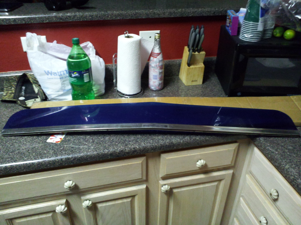

Got me an original toyota bug shield for my truck.
Attached Thumbnails 83Toyota88's 1983 Pickup Build-Up Thread-2013-01-02183949.jpg

Just checkin in, bubba.... GREAT NEWS on that all working out so far... and NICE FIND on the Yota-Deflector!
