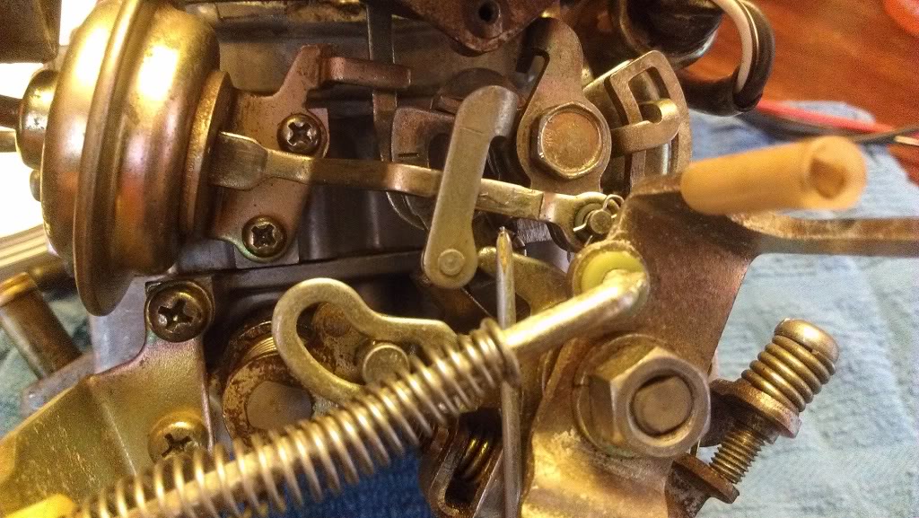

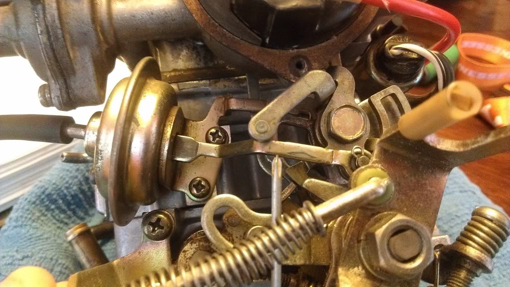

I think I figured out my choke problem. In the pic below I have a screw driver pointing to the horizontal arm for the choke opener. Right above it there is another arm linkage piece that is resting on top of it.
The image in the FSM shows that arm linkage is supposed to actually be under it. That was a PITA to get underneath it and hooked back on. Finally got it put together right.
Definitely did this putting the carb back together after rebuilding it. But now it seems to be working when I tested it off the truck. I was now able to open the throttle a little and set the choke plate all the down and it stay down. Once set I applied vacuum to the choke opener and heard 3 clicks as it released the choke back down to normal. This make senses with what the FSM says. It said the was 4 steps of the choke system. I assume the first step is the high idle engaged and every click down was the next step down.
Once the engine cools down some I will test it on the truck and hopefully it will work. Not gonna lie I'm pretty proud of myself haha.

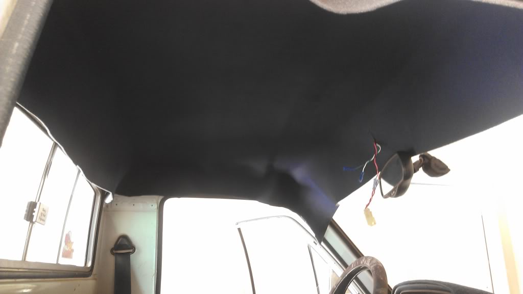

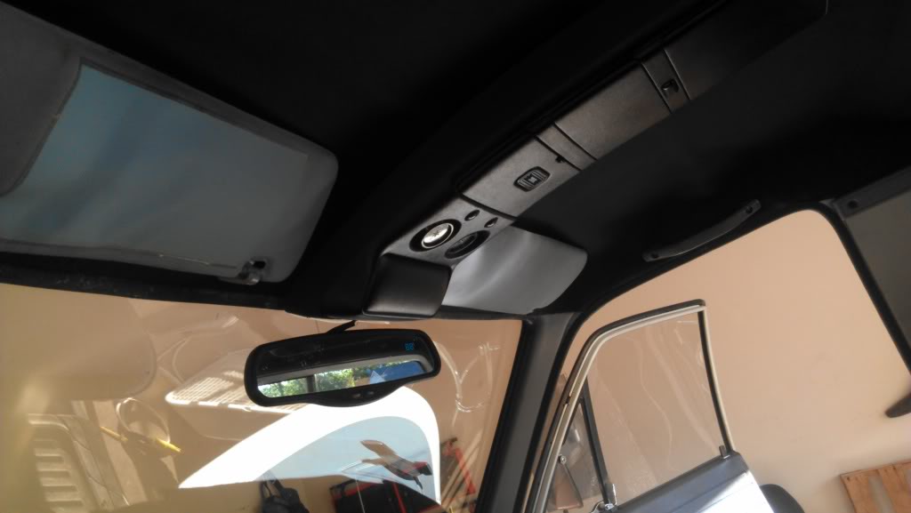

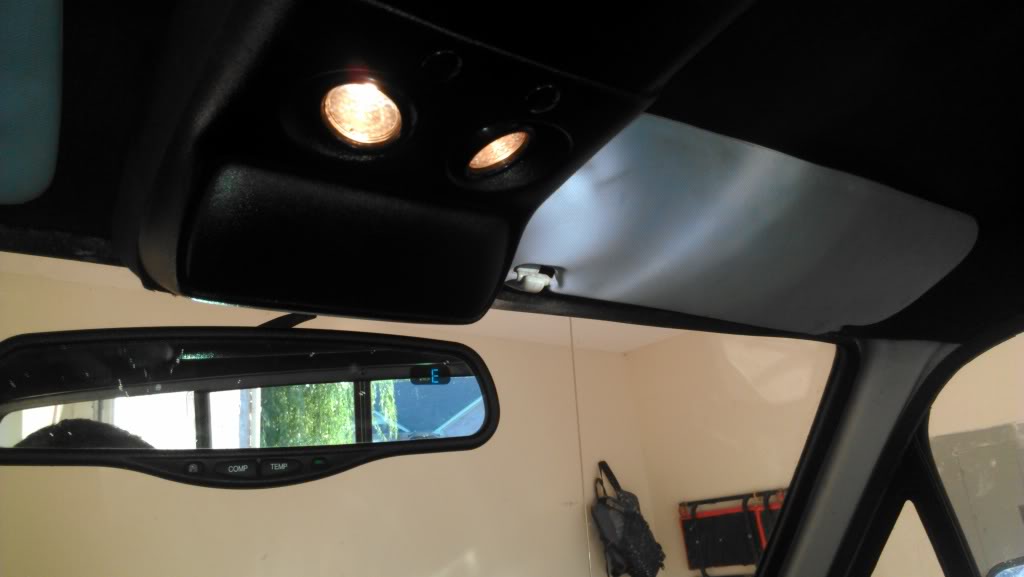

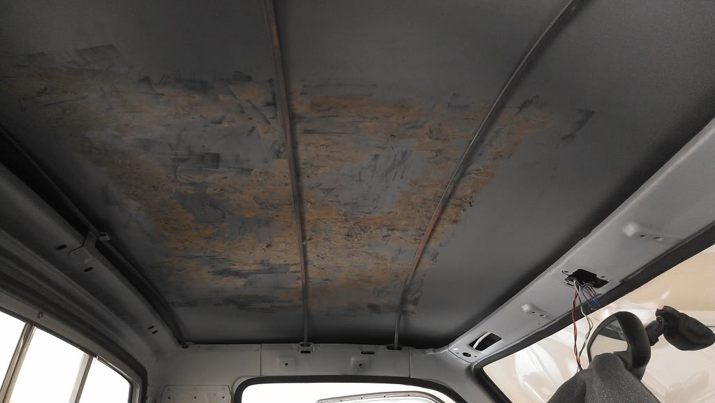

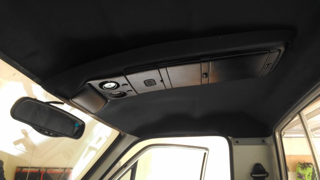

I did install my headliner today. Came out pretty good for being my first one. Messed up in a couple spots but its not that bad.
Before the headliner was in:
Headliner glued and roughly trimmed:
All trimmed and put in with the console put back in:
Visors and oh crap bar back in:
Also got my lights working:

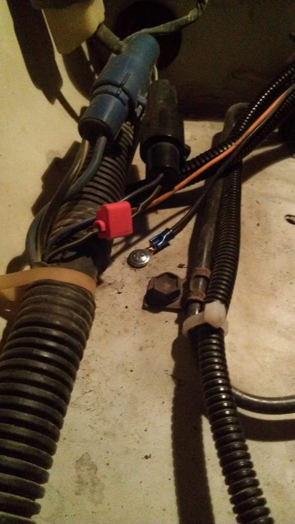

I finally installed this under the hood gravity light I got at the junkyard a while back for like $2. I LOVE it! Can get one off late 90's Chevy trucks and SUVs.
I tapped 12V from a wire powered by the ignition only so the light can't come on if I'm on a very steep hill and the truck is off.
Final product.
Its plenty bright enough to see to adjust the carb at night.

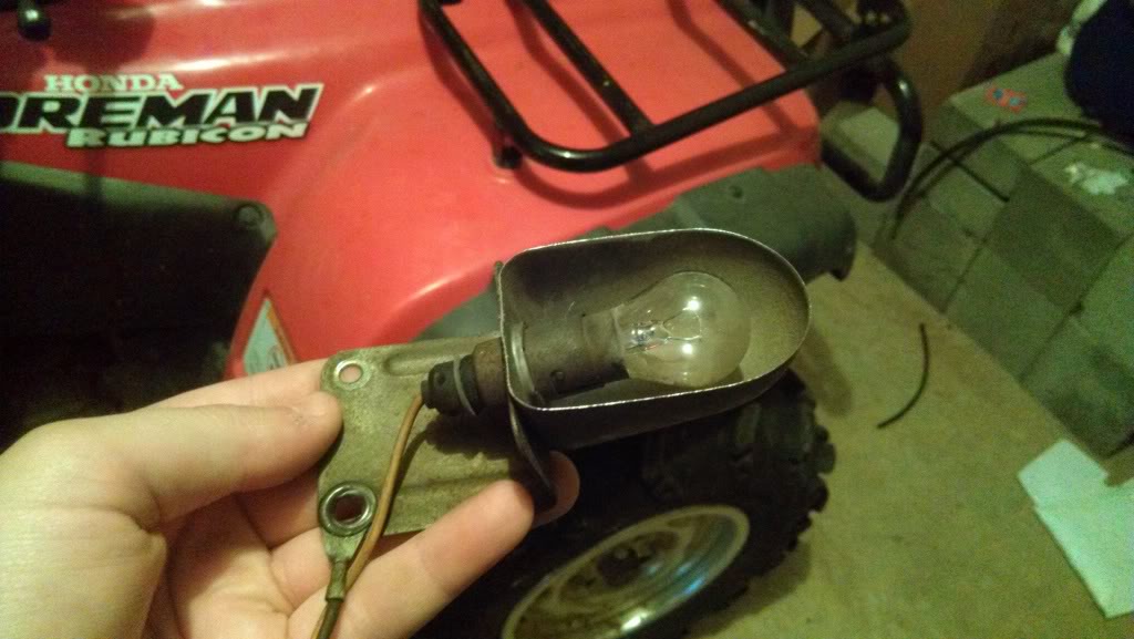

Also last night I found out there is an amber bulb that fits in the side running lights (ones that butt up the headlight), not the marker lights on the fenders. When I got the truck it had small clear bulbs in it and I couldn't find that bulb in amber. So I looked on the AutoZone app and it showed a different bulb than what I had. I was at a friends house last night when I discovered this and he actually had a pair of the amber bulbs and we put them in and I love them! I hated having clear lights. I think the truck looks a lot better at night now.

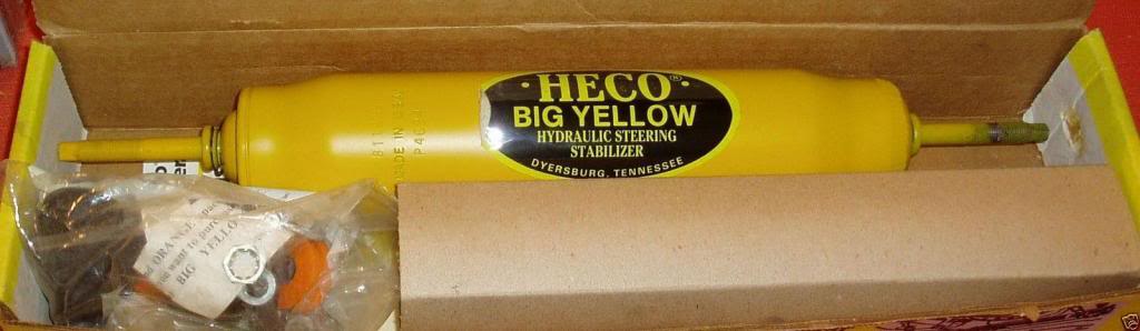

Picked this up off ebay today
It supposedly will fit my truck but it doesn't have the hoop on one end so we will see what hardware it comes with. If not oh well, I think its cool looking and it was made in a plant two hours from my house. Should make a cool collectible if it doesn't fit.
I researched it before I bought it and everyone said this was a really good product back in the day. I'm hoping some of the elder people in this community could give me some insight on it.

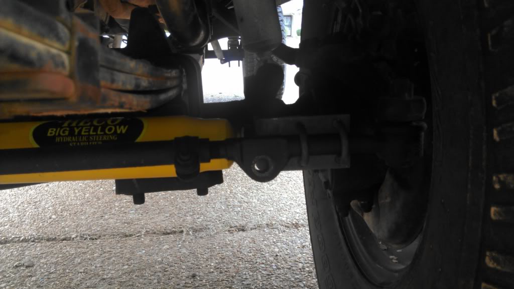

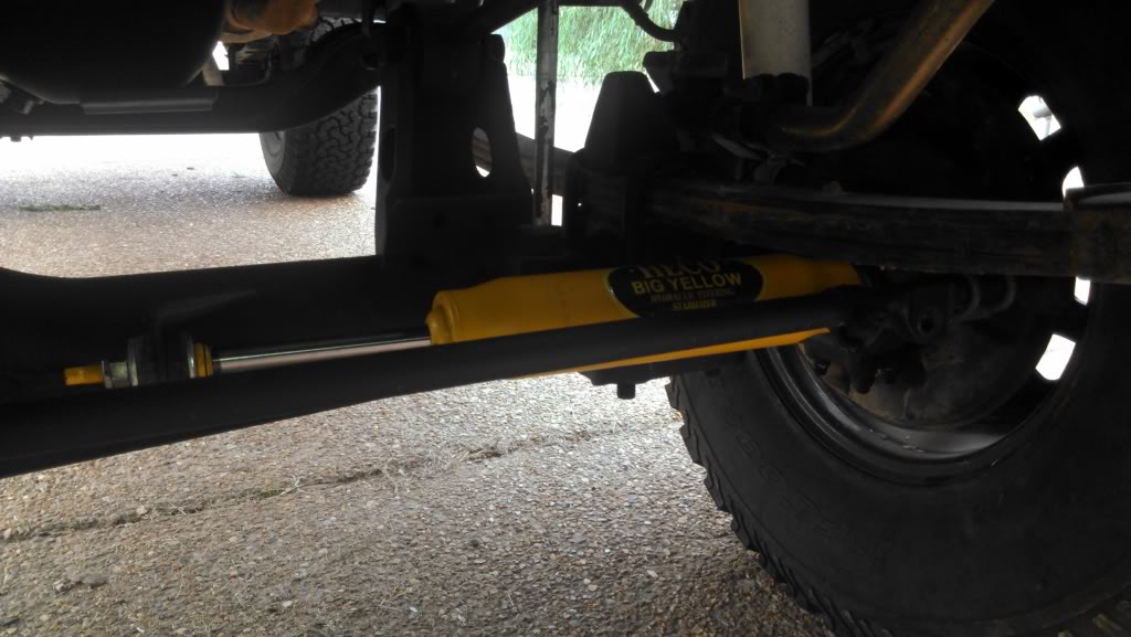

Put on the new/old Big Yellow steering stabalizer this morning. Its pretty big, about 3" in diameter. Its gets really close to rubbing on full left turn.

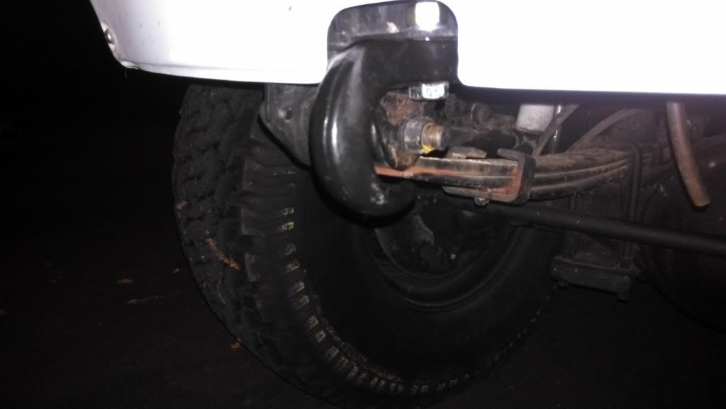

Well I finally discovered what the cut-out in the front valance is for. I was looking at trucks online and noticed some had a tow hook. Well I bought one and stuck it on with the front bolt only.
