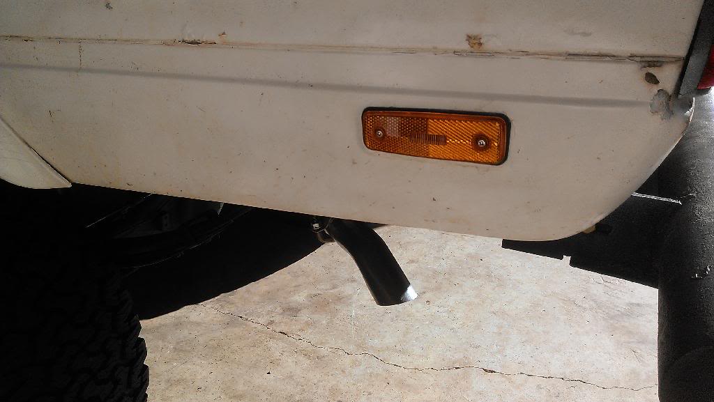

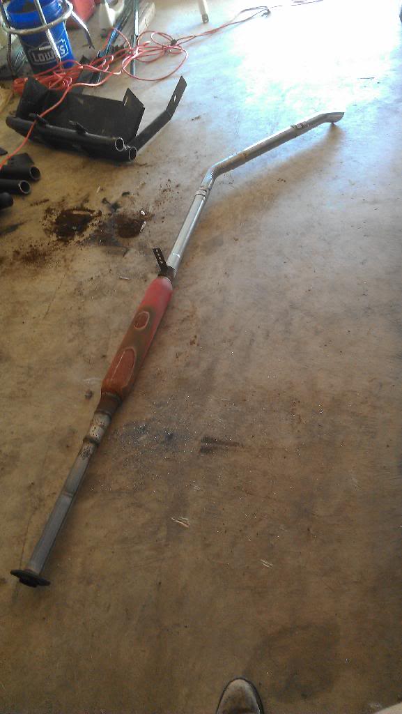

Worked on my exhaust yesterday, finished everything after the muffler. $35 in pipe + a hanger.

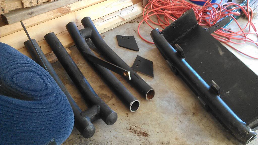

Also been working on modifying my winch bumper to put back on.

Sounds pretty good, but did you get enough clearance over your rear axle with the straight design?? I tucked mine up pretty good on my truck
Old Jan 19, 2014 | 10:51 AM
  #449
83Toyota88's Avatar
Joined: Apr 2011
Posts: 1,220
From: Memphis, TN
Never really considered that lol, just ran me a pipe. I'm not home to measure it but I would say there is 8" of clearance. How much clearance should I need?

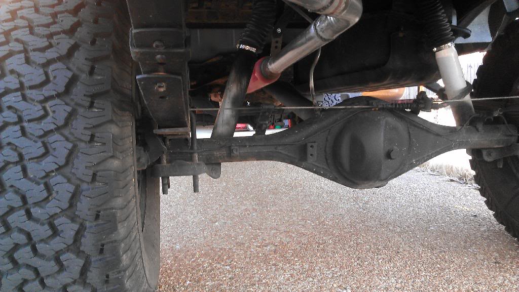

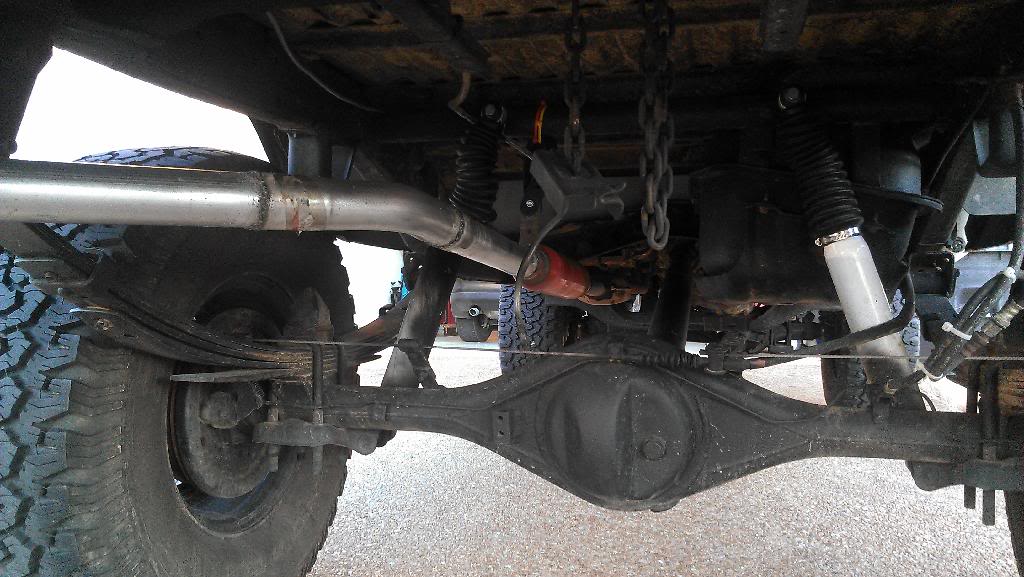

Here is a couple shots of the exhaust I think I have enough clearance for the axle but It is close to the left shock.
Please no comments on the fugly welds lol

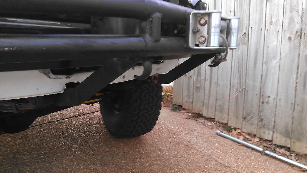

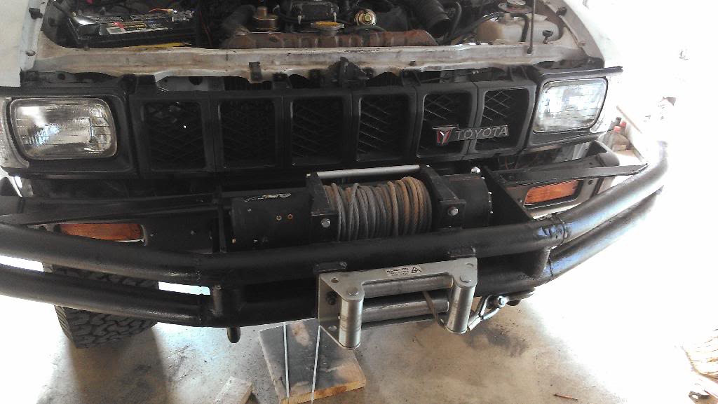

Got my winch bumper put back on today. Was able to keep the factory bumper on too
You could fab and clamp a piece of shield to the exhaust pipe next to the shock, maybe at least before you replace the shocks. That should be easy to do -if the pipe is really baking the shock (when it gets warmer outside!).
Old Feb 1, 2014 | 10:36 AM
  #457
83Toyota88's Avatar
Joined: Apr 2011
Posts: 1,220
From: Memphis, TN
That a really good idea but I think I'm ok now. Before I finished the exhaust it blew directly on the shock that went out.

Pingpong has the right idea. Since I replaced my floorpans and got rid of the factory heat shields, what I plan on doing with my exhaust is cutting some 3.25" exhaust pipe in half to make a heat shield. I'll just weld some bungs that are about 1/2" tall to my 2.25" exhaust pipe so that I can bolt the "shields" directly on to the exhaust in order to get about a 1/2" air gap between my ehxaust and the heat shield to disappate the heat. It'lll basically sit right on top of the exhaust where it runs under the cab to keep from baking me in the cab during the summer.
